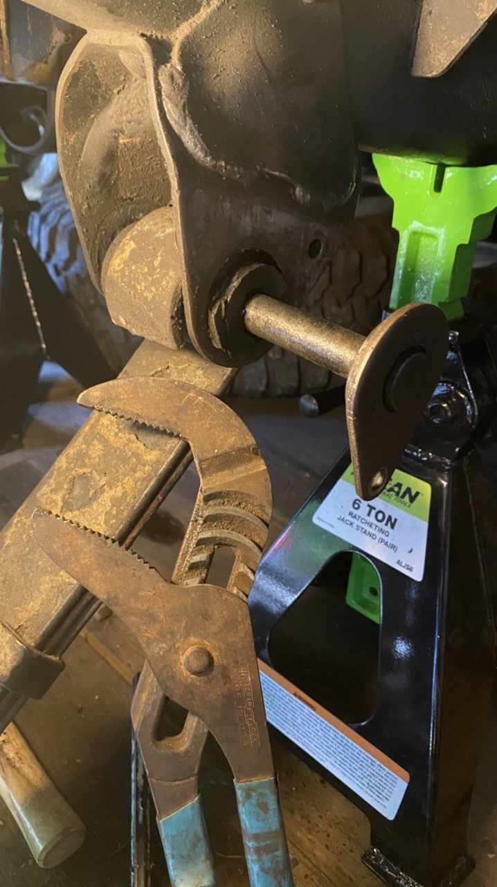

Got half done with the front spring swap. The old bushings fought me hard… had to get out the big pliers to help remove the spring pins. Happy to be replacing these with poly. Fortunately the shackles and pins are in pretty good shape and cleaned up nicely with a wire brush, rust converter, and some grease.

You’re lucky all it took was some big pliers....
