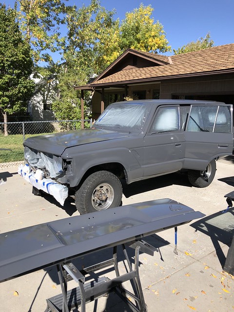

BeBe got a new paint job for her cake day. 9/29/12 was when I brought her home, 9/29/18 she got the last bit of body work and new color to cover it..
Untitled by Greg Fisicaro, on Flickr
Will post up reassembled pics today.
