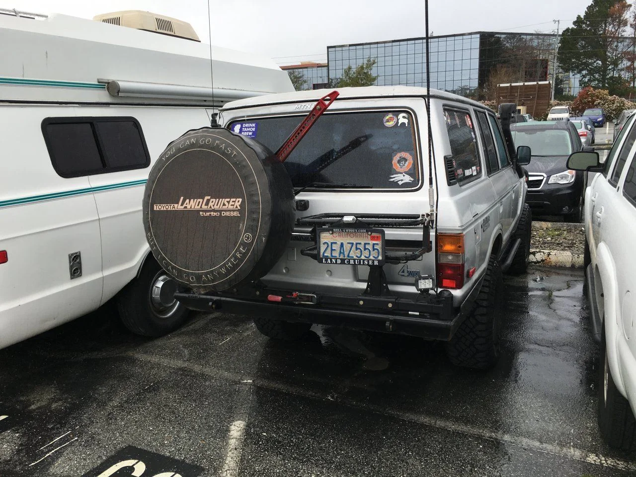

Finally got another small project done. Had ordered a Kaymar dual swing out rear bumper back in 2012. I had mounted the bumper only until I got other projects done. Got the tire carrier and jerry can holders out of storage and cleaned up. Now its coming together slowly. Need to dig out my telescope light and wire it in next...might take another month.View attachment 1220507 View attachment 1220508 View attachment 1220509
Kaymar makes the nicest rear bumpers. Wish I could afford one!
