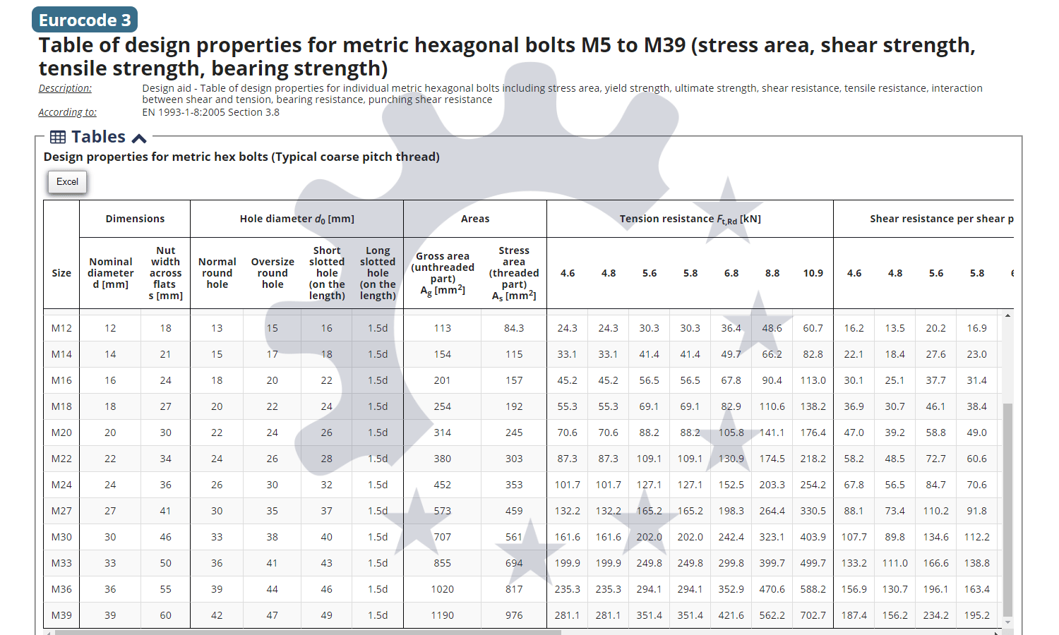

A single M8x1.25 rivut has a maximums upset load strength of 13,434 N / 3,020 lbs:
Between the rivnuts and OEM nutserts (presumably stronger than a rivnut), that results in a ultimate tensile load of 39,261 lbs per side (13 total fasteners). So you have a factor of safety of 7.8 relative to the weight of a GX.
Shear strength would be limited by the grade 10.9 M8 bolt (rather than the rivnut), which is 14,600 N / 3,282 lbs:
So, any attachment point using 10+ M8 bolts, whether rivnut or OEM nuts, should be far stronger than any GX would ever see. The sliders or the frame would buckle far before the bolts/rivnuts would become the limiting factor. I installed a test rivnut this weekend and was quite impressed by it; I see no way they could fail during normal use.
I appreciate the technical perspective! Makes me feel better about my own bolt ons as well.
No problem. I'm an engineer (albeit not structural) and never would have installed sliders using rivnuts without looking up the capacity. I'm also planning to use some smaller rivnuts for an eventual DIY rear door table; they seem to be a great product.
