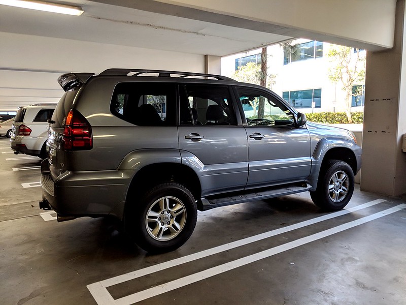

Installed the 285/70r17 Nitto Ridge Grapplers on the stock wheels.
Looks Great Gavin! What lift do you have? Any rubbing?
I jusrt installed the Toyo Open Country A/T II P285/70R17 on mine yesterday with a 1.5" lift and FJ Cruiser 6 spoke wheels. (I think those wheels have 10.. less offset that stock GX wheels, so tires are pushed 10mm further out...?)
Anyway, I have slight rubbing on front driver mud flap (passenger mud flap not installed, long story) and there is slight rubbing on the sway bar up front at full lock. I plan on trimming my mud flaps a little more and eventually going to a 255/75/17 tire, but the 285s were already on the FJ wheels I bought used so I thought I'd test them out a little.
Thank you. I have roughly a 2" lift (5100's, Eibach front springs on 2nd perch, and Dobinson rear springs, with SPC UCA's. There was some slight rubbing at full lock in reverse on something plastic but I haven't found it yet. normal driving and parking lots no rubbing at all.
