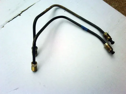

Ok guys, I was working on my brakes this weekend trying to install new stainless steel lines on the front. However, the existing flared connection from the master cylinder does not want to connect to the new SS brake line:bang:. Then other end fits fine into the caliper. I measured with a micrometer and it is a bit wide.
Can this be due to someone tightening it down too much?
WHat can I do, buy a new section of steel brake line and replace it or what?
... I measured with a micrometer and it is a bit wide.
Andrew,
Since you used a micrometer, how much is your "bit wide"? (again since you used a mic; did you do a search on the specs for the flare geometry to make a comparison?)
Plus, is this rigid SS line or flex SS? If it is rigid, could the bends be slightly off such that the threads are not engaging?
Larry, if I am reading my micrometer correctly, the expand flare is 0.2796 and the normal flare fitting is 0.2771 so ther is a difference of 0.0025 off. The wide flare is on one of the rigid ends from the master cylinder. Actually a 6 inch piece that can be replaced. I may just order one. The other side fit fine so I have a feeling it was torques too tight initially. Does that make sense.

So this is what I did.

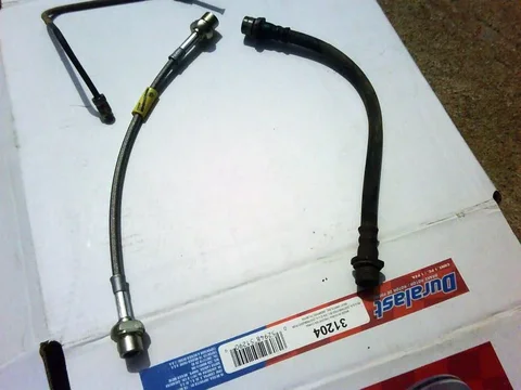

Bought the bendy brake lines at Napa and bent them just about the same.
see below
here are the SS lines

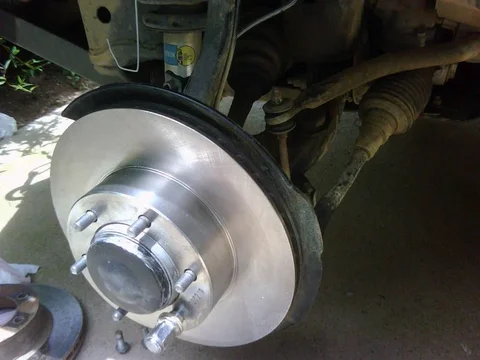

and here is the installed rotor, without the caliper on.
Princess helped with bleeding. Now need to bed them in and see how they do. I do agree with you that the pad could wear out the rotors faster and I will see what I get in terms of braking. Right now the old pads really did not do well with braking. I still have the old pads just in case. I hear mixed reviews on ceramics.
