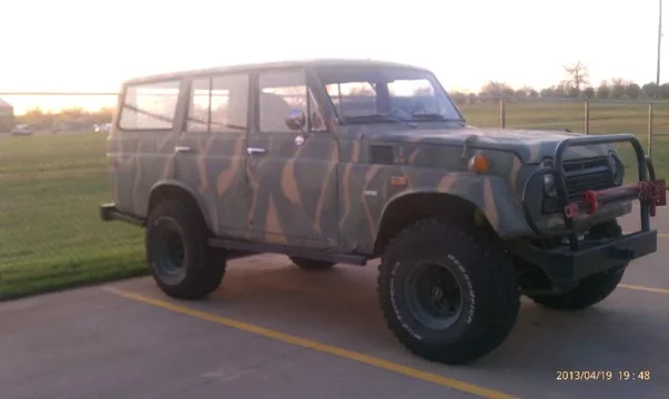

Started it and drove it to work.
It needed to stretch its legs after sitting for a month or more:
