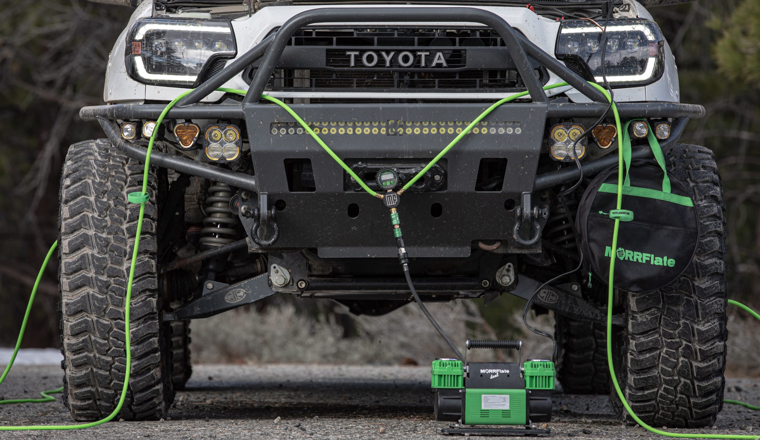

Tested out my birthday presents - MORRFlate 4 tyre hose contraption & a Viair 400P-Automatic compressor.
I was highly skeptical about the MORRFlate, but it is my new favorite toy 👍 Using the contraption I aired down all four tyres in 1 minute 45.34 seconds. It takes longer to hook up & then roll up the hoses than it takes to air down.
My old reliable Viair 90P has faithfully inflated my Taco tyres since 2007, but it takes over 20 minutes to air up to 32 from 18 and I am always the last one aired up on the CSC runs. No more! The new 400P-Automatic & MORRFlate hose contraption airs me up from 18 to 32 in 7 minutes, 38.50 seconds - Verrrry impressive!
Viair estimates around two minutes to inflate a 33x12.5 tire with the 400P, so my 285x75R16s are just about that. I also ran straight off the battery without running the engine, so in real life it should be a tad faster to air up.
All four tyres hooked up to the MORRFlate contraption
