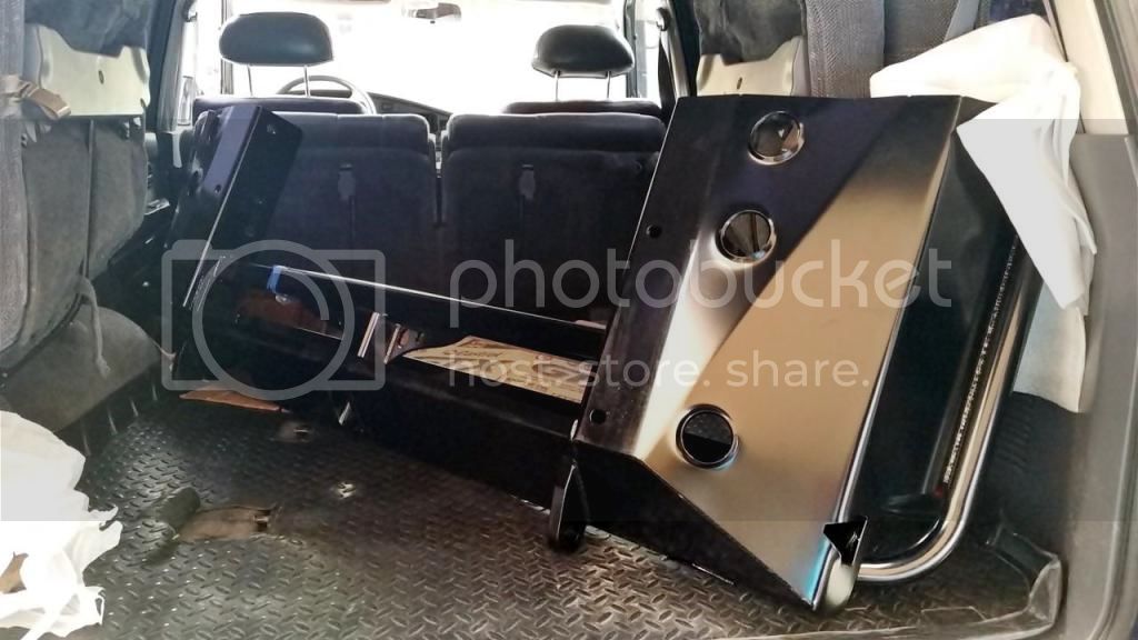

Picked this up from the spa today. Thanks Kevin for storing it and help in loading the cruiser.
What brand bumper is that?
