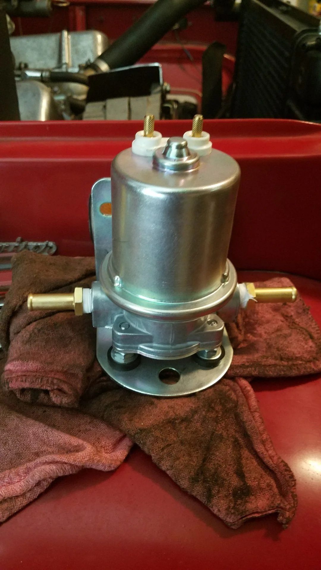

Hey there... so I am working to replace the mechanical fuel pump that is on the BBC with a Carter P4070 electronic fuel pump. I am getting ready to find a good spot to mount the pump and I was wondering if anyone has any recommendations. I understand that it should be as close to the tank as possible and located at a locations that is below the level of the tank so that it does not need to pull the fuel into the pump (gravity feed = happy pump).
My other question is wrt the orientation of the Carter P4070 pump... does it matter if it "hangs" or "sits" on the supplied mounting bracket? I have email Carter to ask this questions but was wondering if anyone has worked this out already...

First picture is the correct orientation for the pump. I don't know what your application is, but I'd find a place inside the frame rail where the fuel lines are already running and near the tank. I'd also give consideration to what other parts are in proximity to it and potential for impact.
My thought if your running dual exhaust with the V8 closer to the tank is better. Less likely to have vapor lock on the positive side of the pump. With the stock six the fuel line mounted on the frame rail opposite side of the exhaust.

Thanks for the information. I will mount it with the fuel lines on top. I just don't like the electrical wires hanging out the bottom, especially with a push-on connection. Maybe I could drill a small hole and put in come cotter pins to lock them down.
Certainly need to find a spot that is tucked out of the way from road debris.

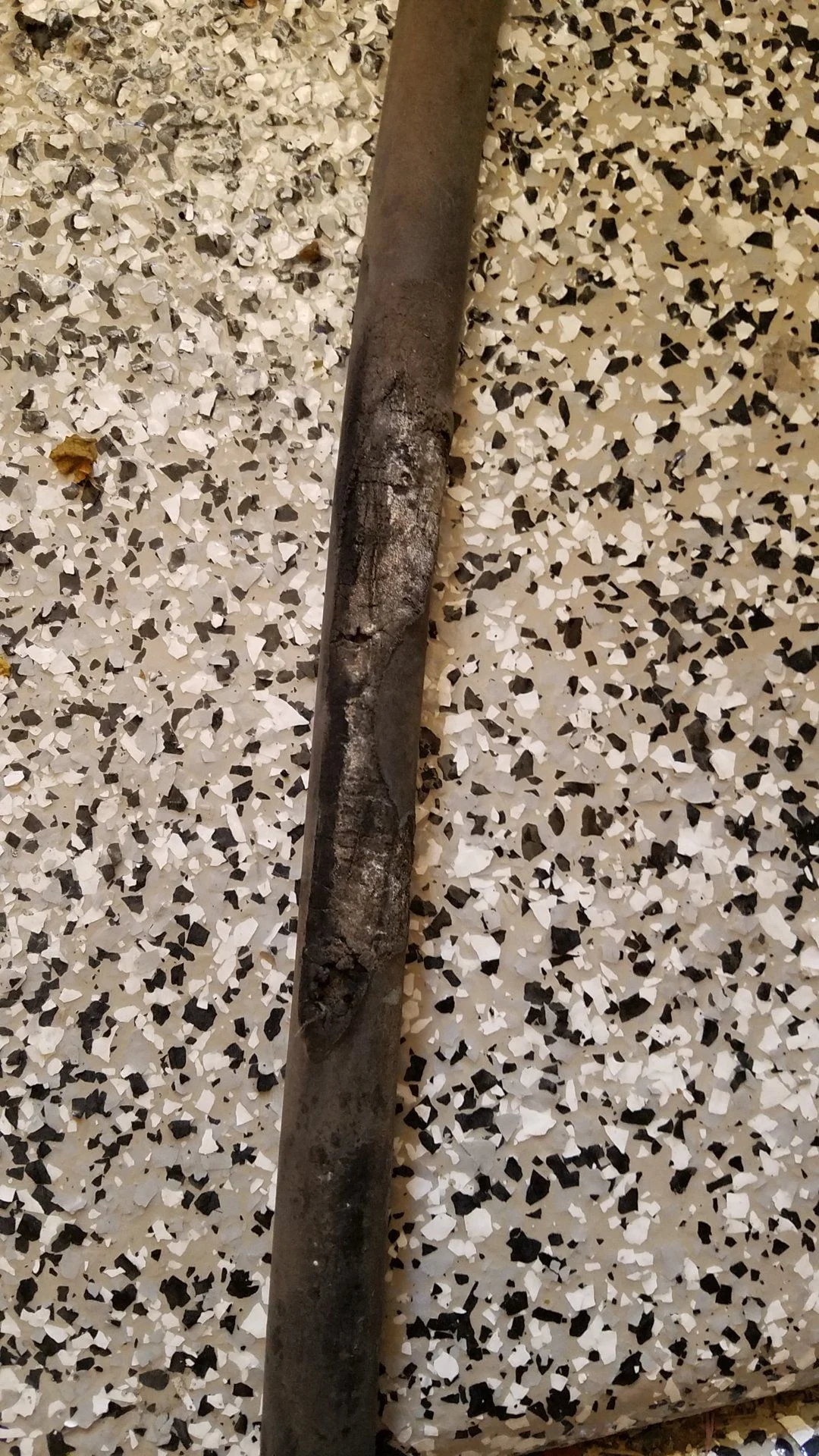

Looks like my fuel line was getting hotter than I thought...

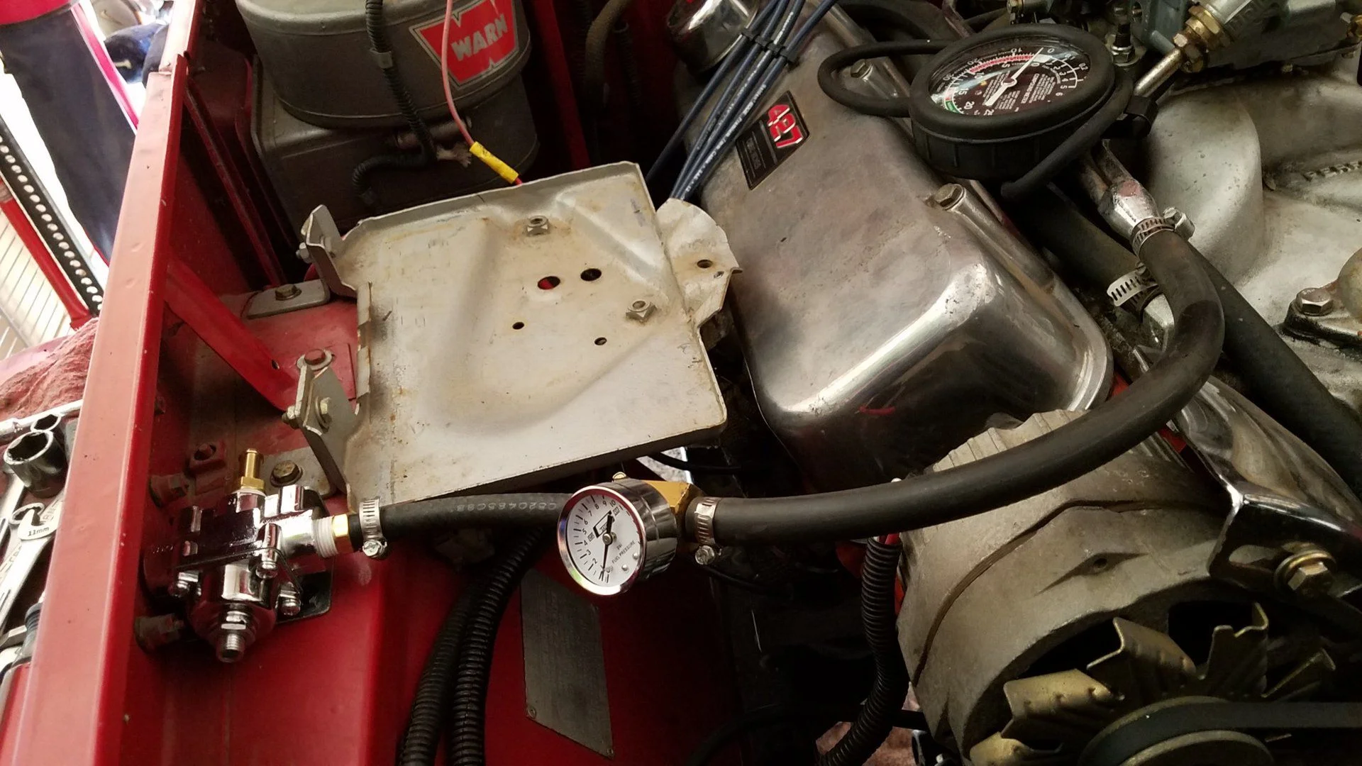

Last weekend, I began planning my electronic fuel pump wiring harness / diagram and learned that it is best served from a relay along with a oil pressure safety switch. Tried to find an adapter fitting to mount the safety switch into the block and got nowhere fast. Had to buy a brass filler plug and then drill - tap to fit the safety switch.

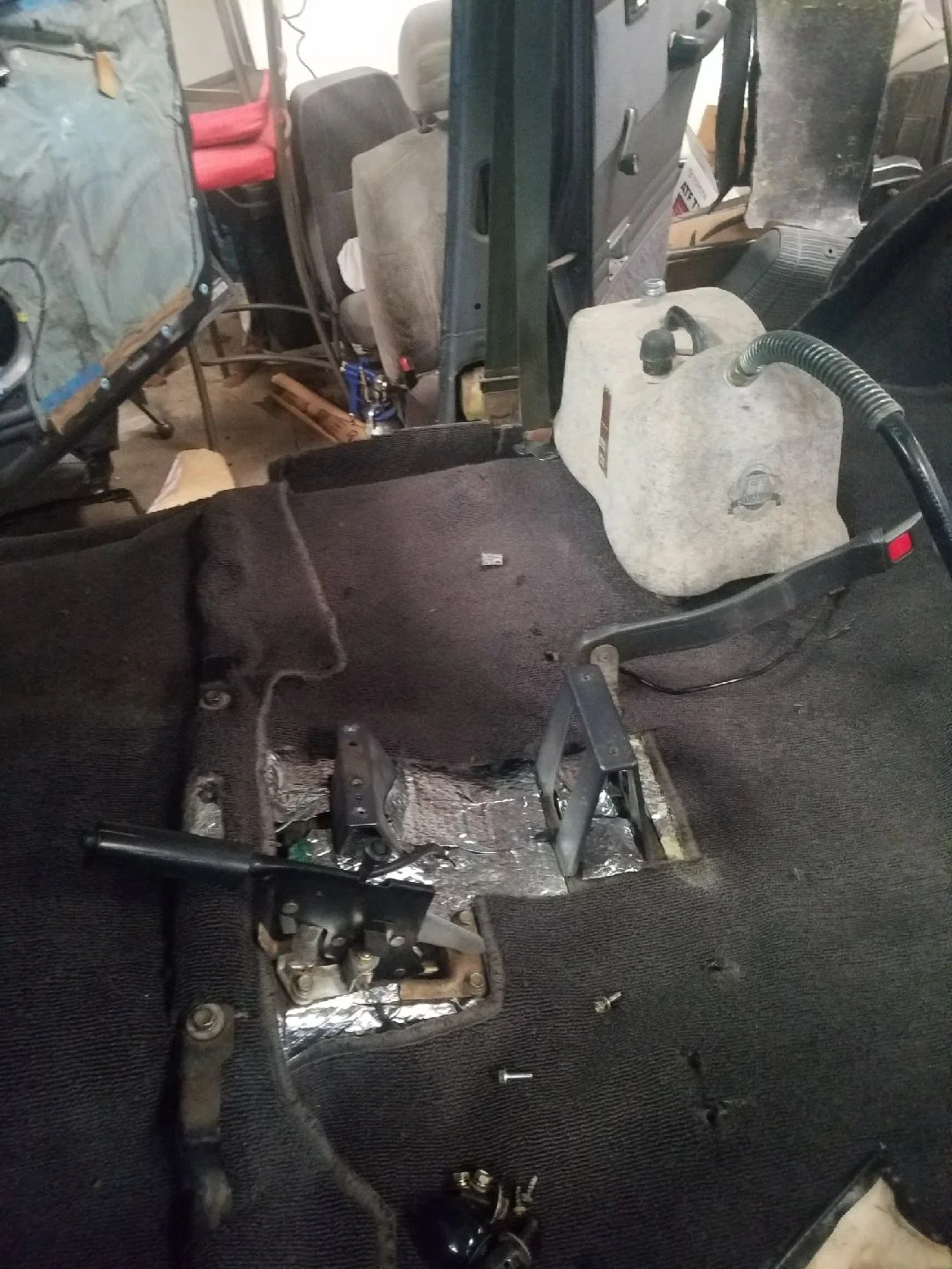

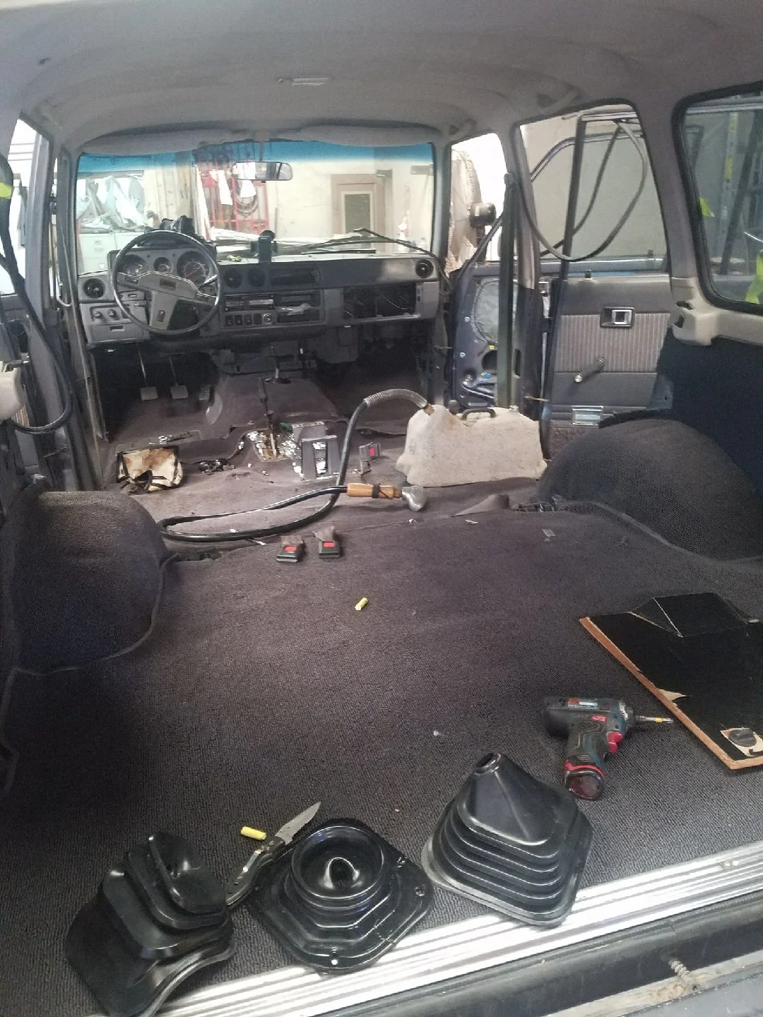

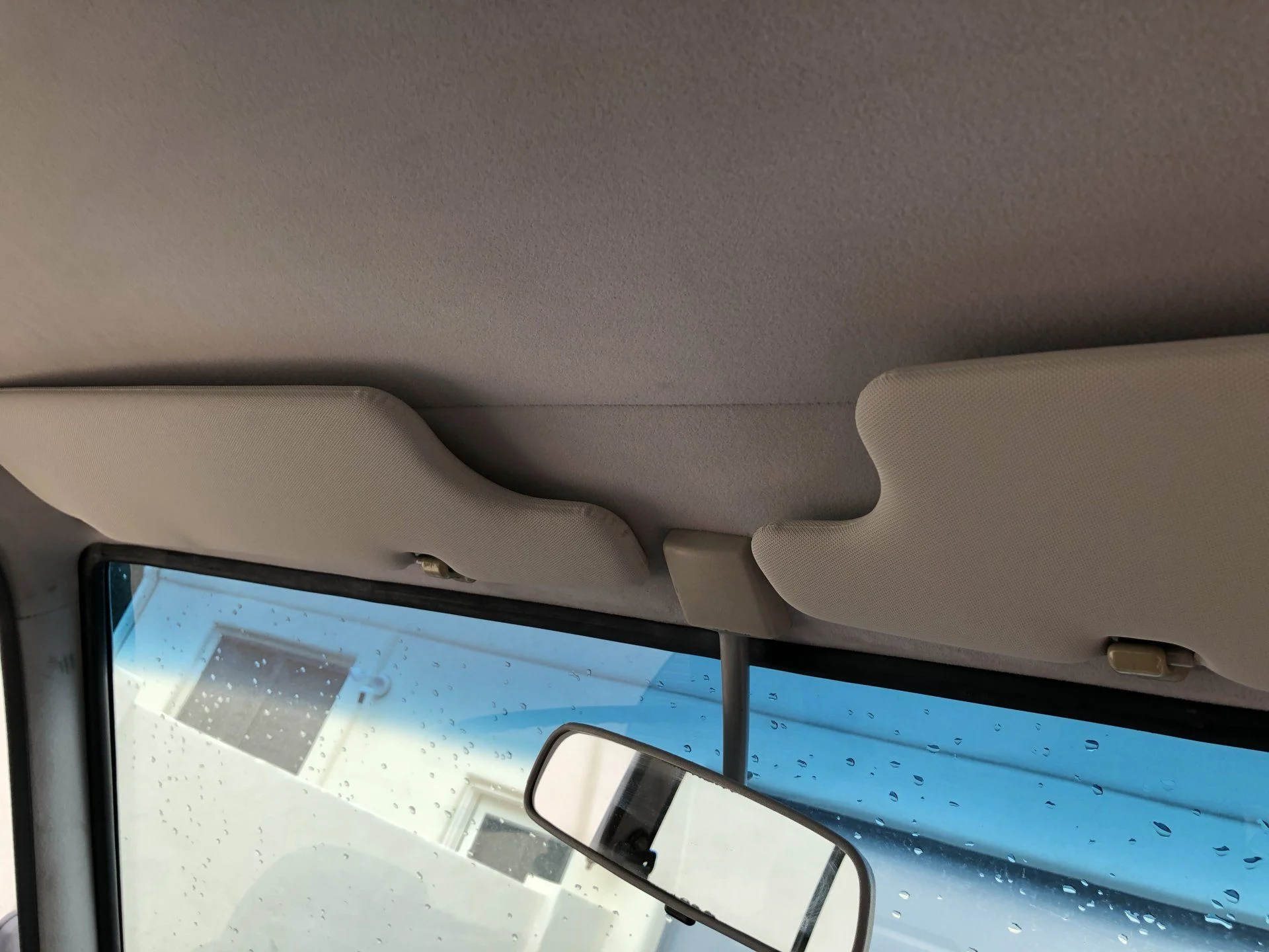

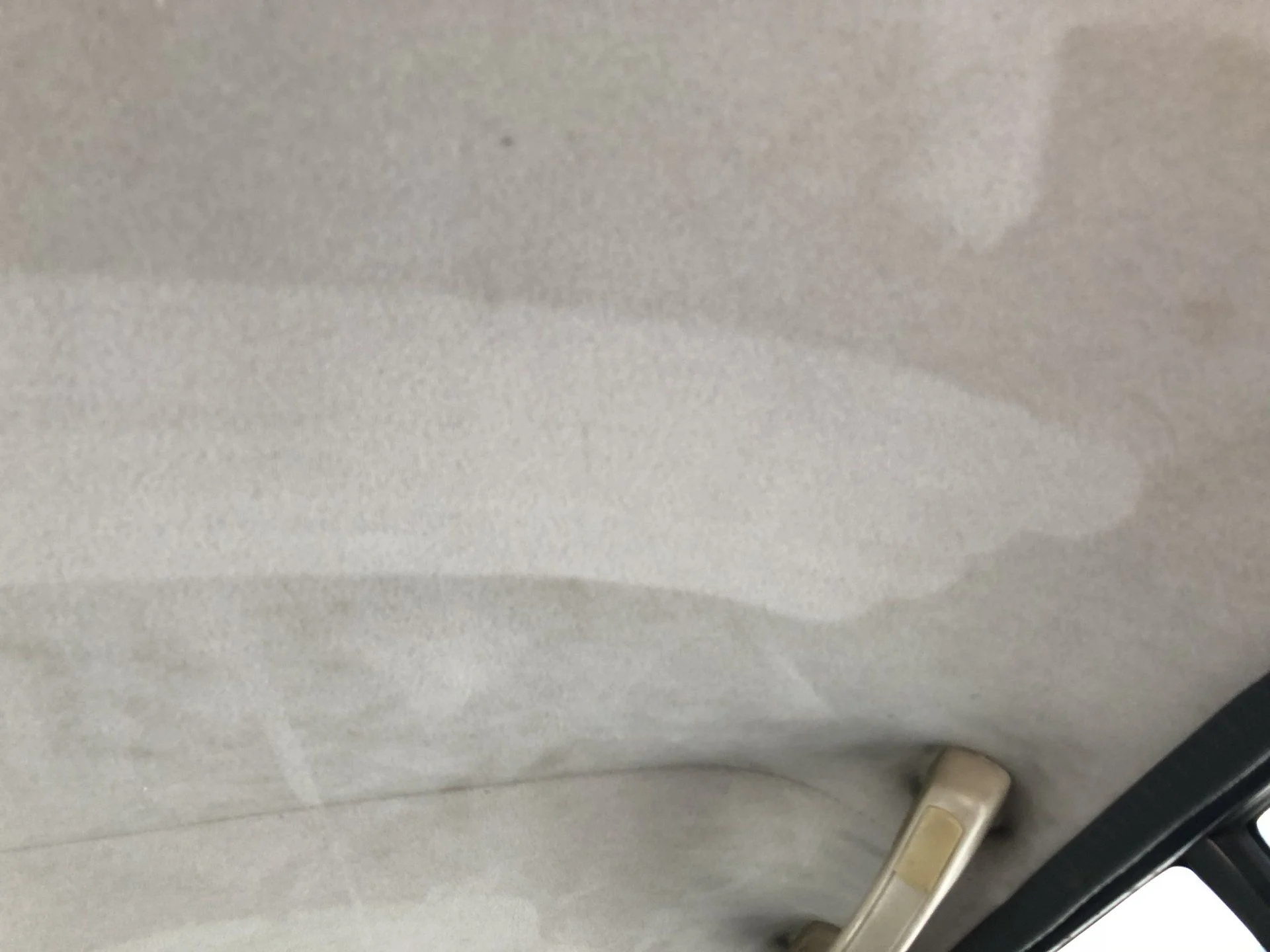

Cleaned the interior on the 60, including spending an hour to vacuum the headliner. (Can you see the difference?)
Also replaced the sun visors with the 70 series visors.
What is the story on 70 series sun visors? Something available new?
They were. I got the passenger side from CBT and the drivers side from CruiserParts.net. The visors are a direct fit, you just need to swap out the arms. It is less than :banana:, and they look great.
