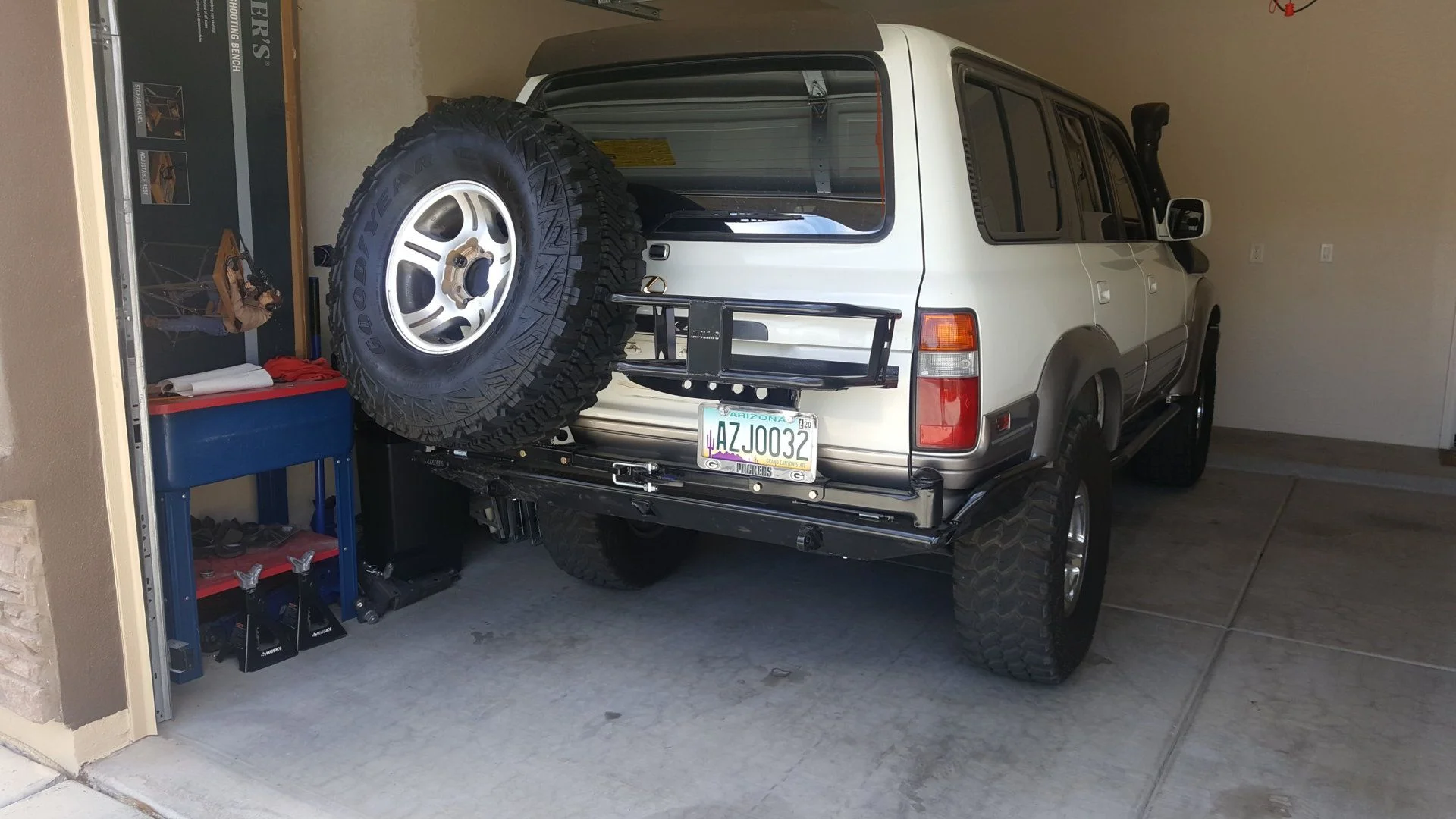

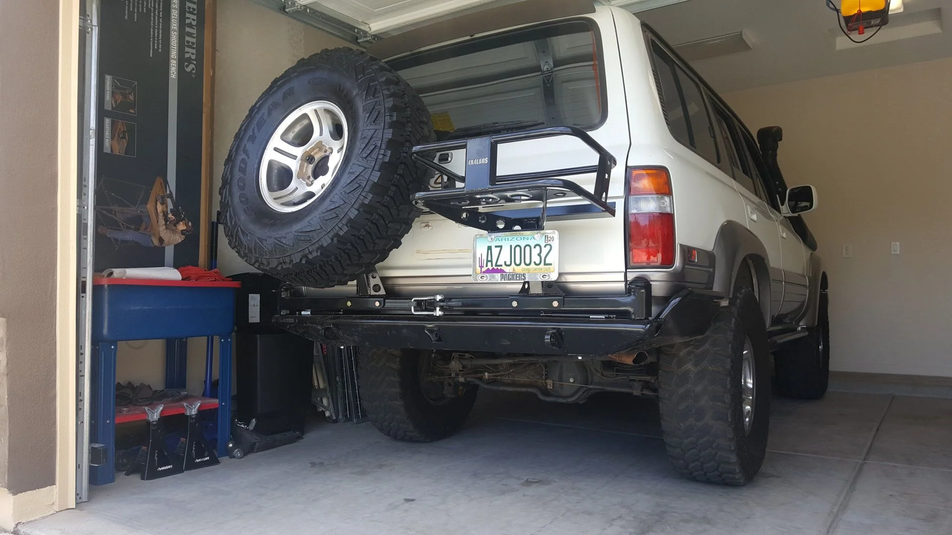

Installed my 4x4 labs rear bumper Saturday. Nice and easy install, well if you forget the part about the tow hook, bolt, 1/2" extension and impact wrench hitting you in the mouth while pulling off the hitch. :hillbilly:. Nice unit and impressive gain in ground clearance! Now just have to figure out how/what to wire to it for backup lights and license plate lighting.
Pics?
As requested!
Yes, removed by rack before the garage door header did it for me. Got a couple inches to spare now. Also use the antenna as a measuring stick, it is an inch or two higher than the roof, if it hits, I don't go!

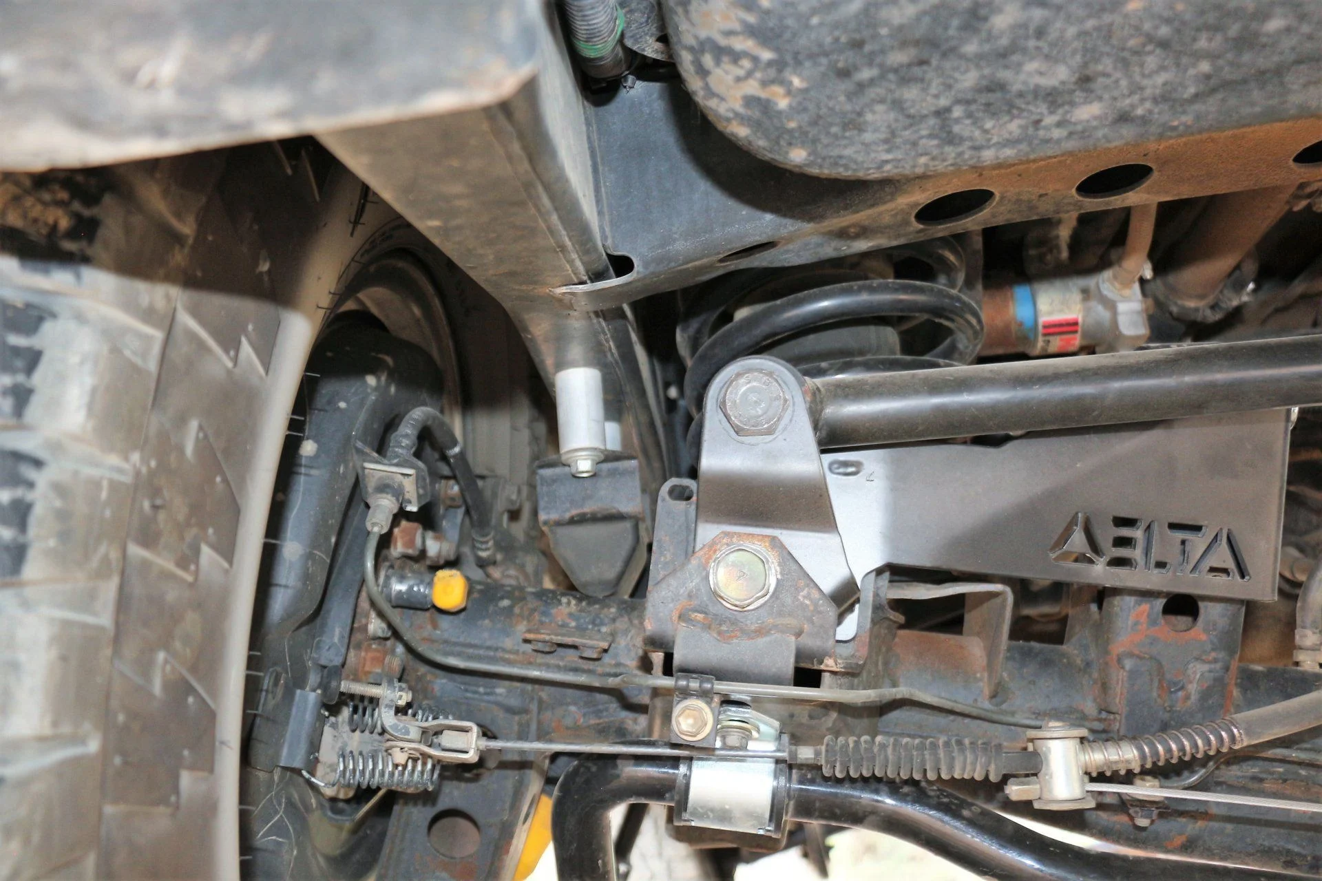

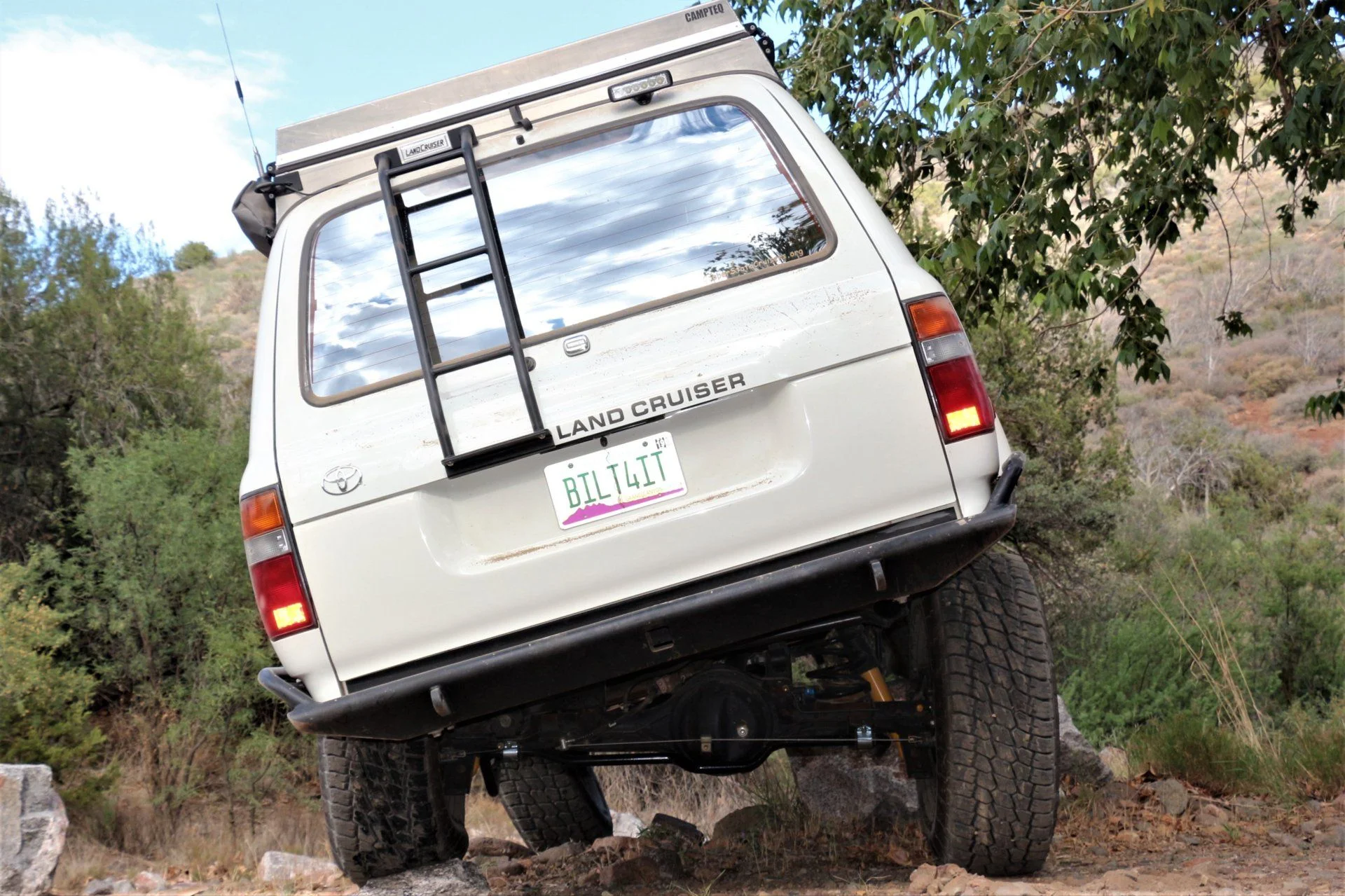

Went out testing the new Delta PanHard bracket. Excellent product now available on our web site:clap:

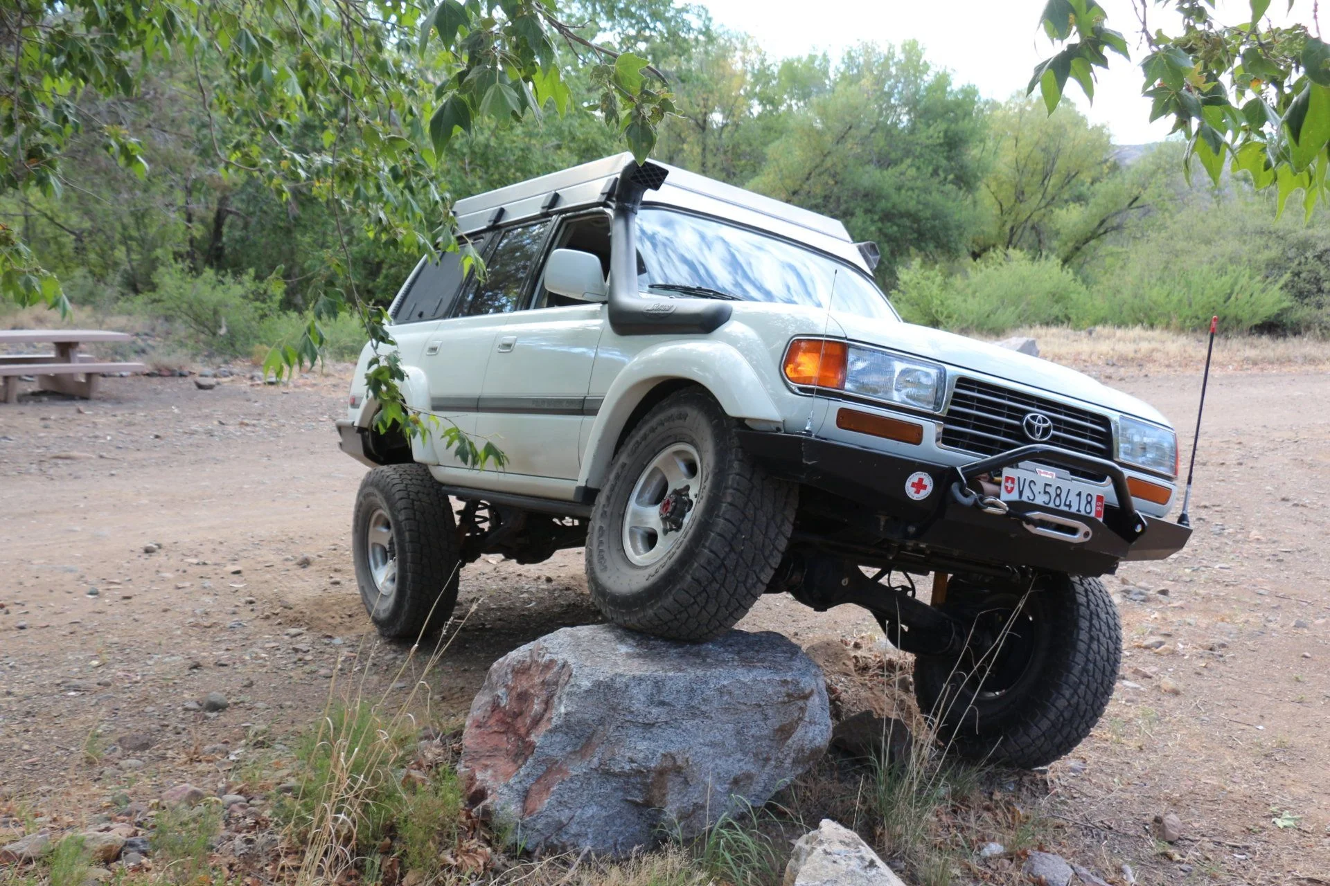

Looks like I need some more cutting on my front control arms or maybe some new @Delta VS front control arms:hmm:
Phil, do you need bump stops on one side or both? I would think you would lose a little articulation with the bump stop(s), did you notice anything? Finally, how did it drive?

Love the license plate!
Phil, does the Delta bracket bolt in easily? Wondering how much time to allot for that addition. Anything you would do or change?
I do like the custom plate.
I would estimate time to about ~45min. No other change is needed the bracket is top shelf.
From my measurement/testing bumpstop/s are not needed but the clearance will be very close if you dont run something. In many lifts the shock is the bumpstop.:eek:
I run 1.75 bumpstop on the rear and I think my set up articulates just fine.
Having your rear end not moving side to side when you hit a bump is a win. Any lifted 80 series will benefit from this bracket in terms of driveability.
