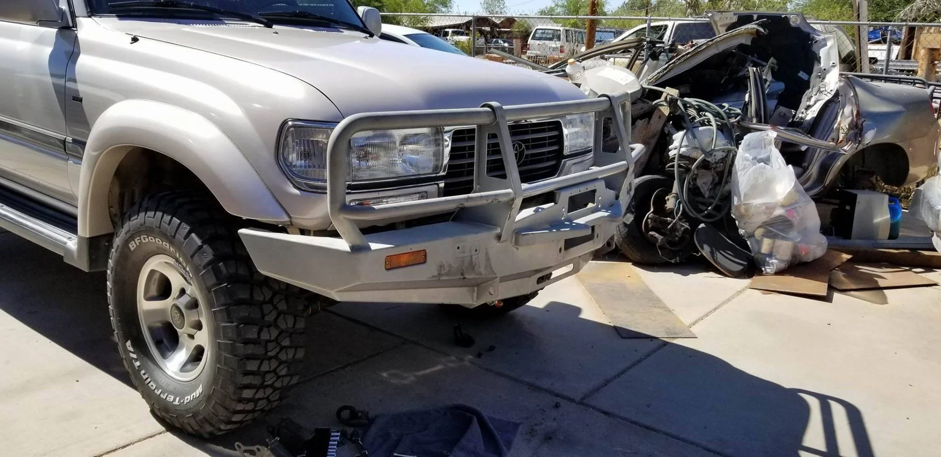

Could this be ground zero for an upgrade?

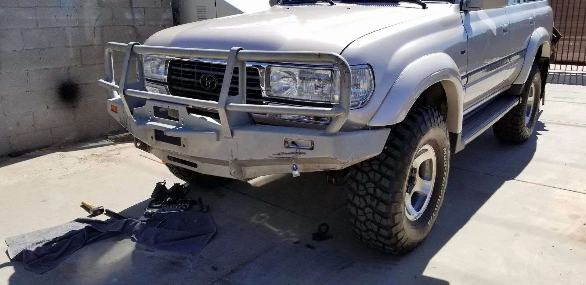

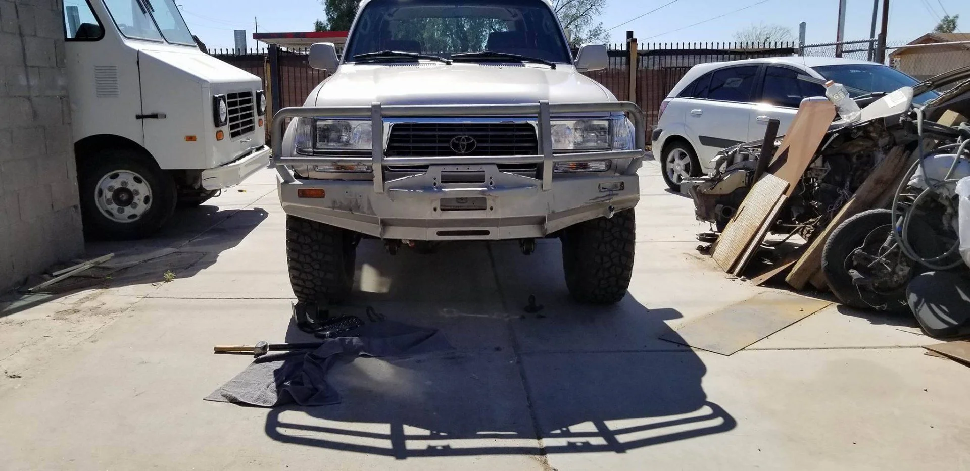

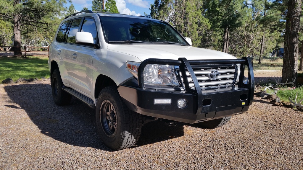

Well I got it buttoned today, still need to wire the lights. Weather pack connections are not the same so I will have to order some. Anyway it's the TJM T13.

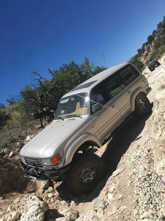

That doesn't look stocker friendly, is that in Verde valley?

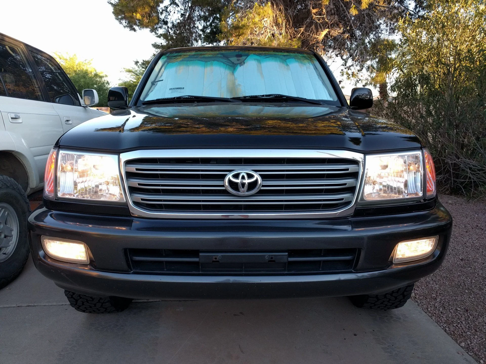

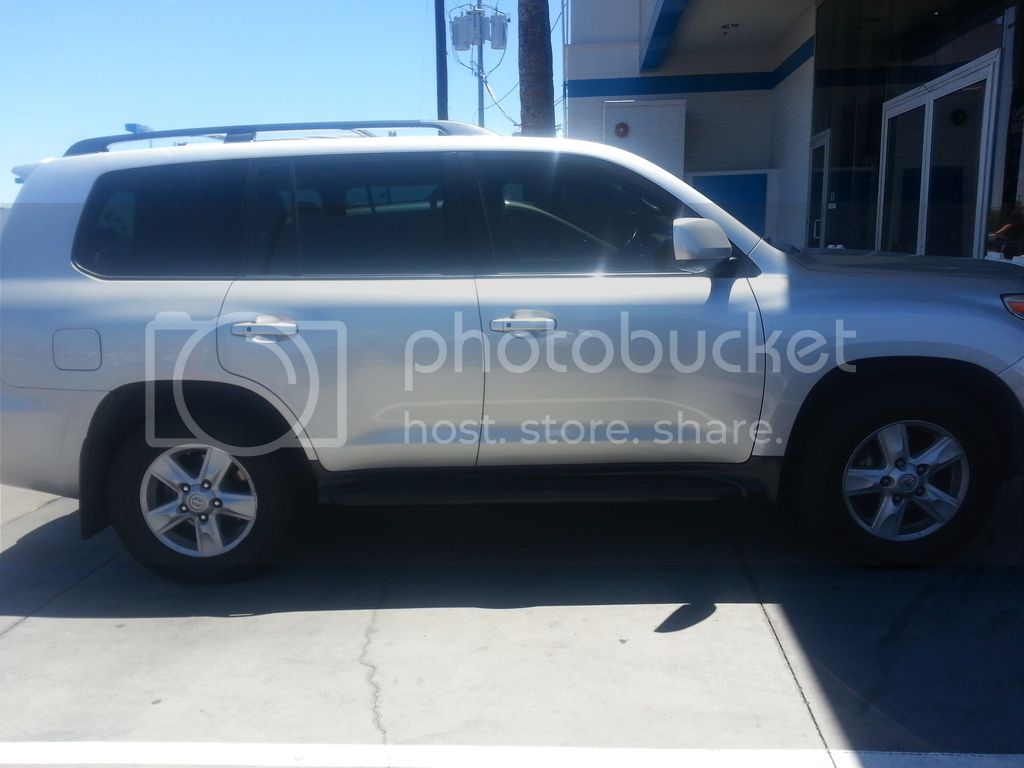

Neither one of the fog lights worked on the 100. The passenger side was clearly burned out.
So I swapped the housing out with a new one. Thanks @Abigail !
Driver's side still didn't work and housing looked fine. Checked the bulb in the passenger side unit and the bulb was good. So I checked the wiring and it wasn't getting good voltage. The bulb harness was "spliced" by twisting the stripped wires and wrapping in electrical tape. I'm assuming this was from a body shop that repaired a minor front fender bender on that side. I fixed the splice with some crimps and heat shrink. Plugged in the bulb and everything worked great. So I finally have fog lights.

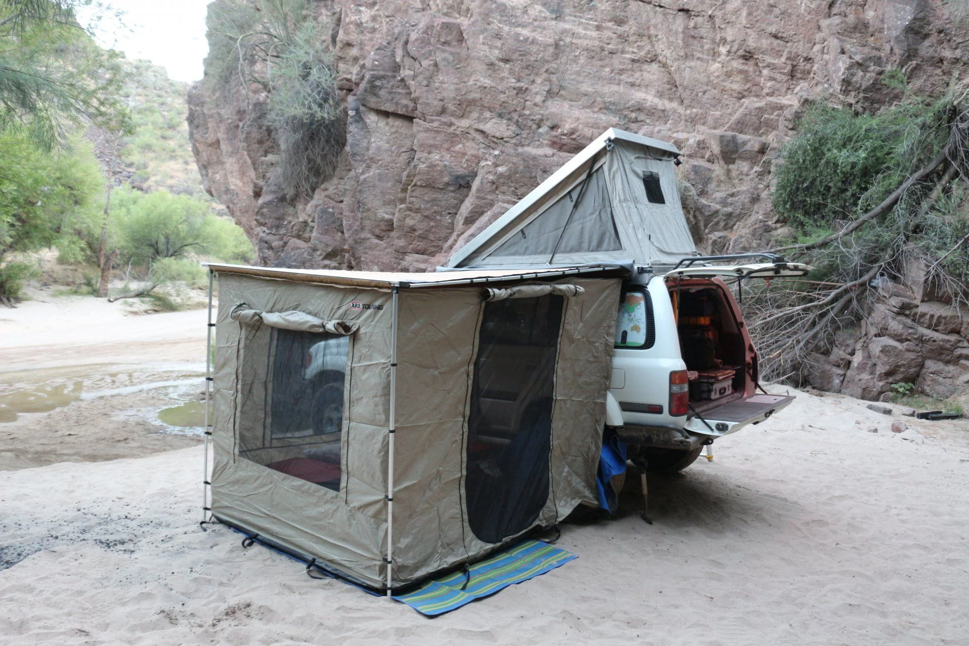

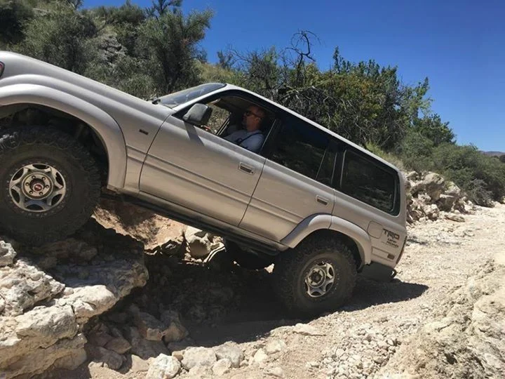

Left Sam the wonder dog at home and took the wife camping and wheeling on the Hassayampa River.
Tested the ARB awning room, the room goes up super easy and fast. The take down was just as easy and stored in the original without any issue. All in all its nice and was wife approved but does not work with my set up do to the limited and difficult access to the Flip up windows and second row door access. So if anyone is interested in an ARB awning room used once let me know.
