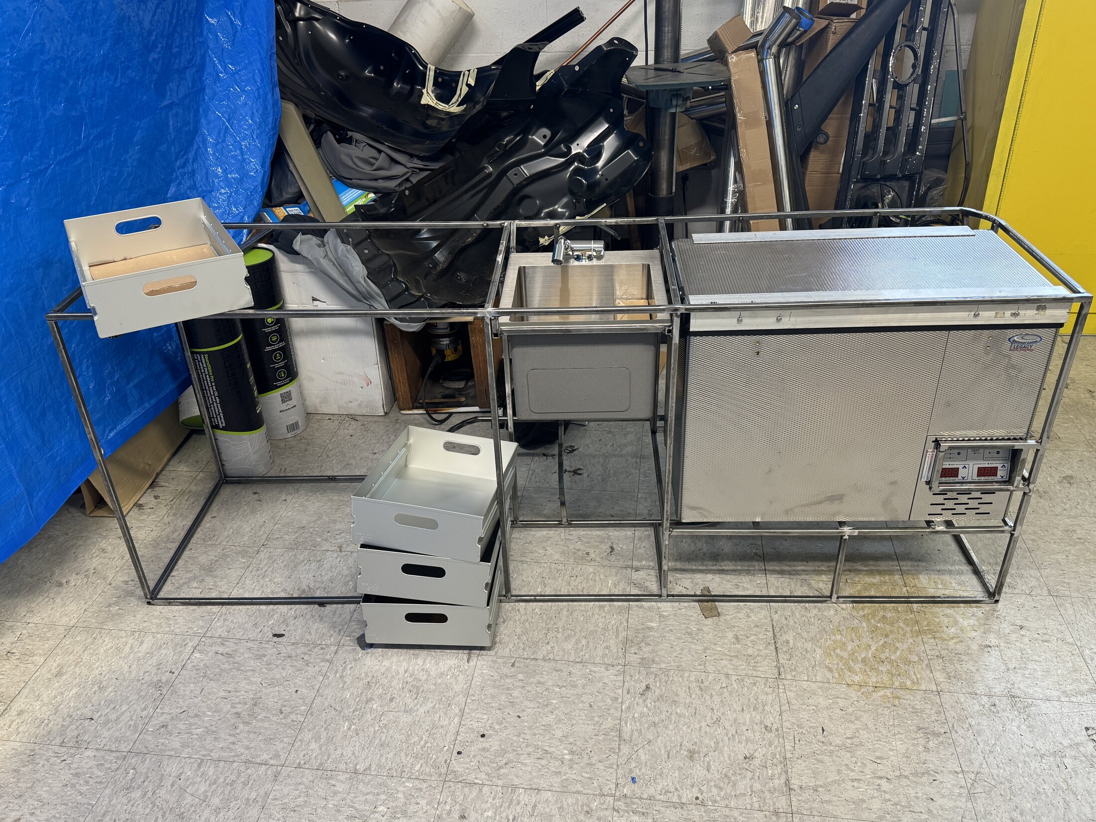

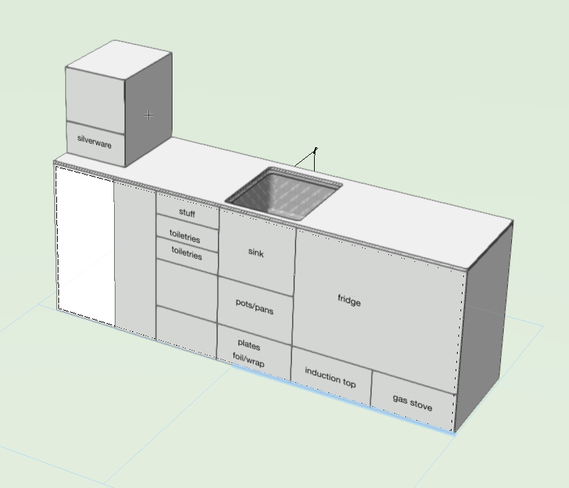

Got the 14" soft glides (amazon!!!) and the aluminum drawers for the galley. Drawers are the trays from the flight attendant trolly. I double stick tape the glides and then attach with small screws. Then Sike to the faces whatever finish material. Aluminum, Blyboo, etc. Got also the drawing with the layout for the galley. My beautiful architect wife...
The front part behind the passenger is not yet laid out internally but the top small cabinet will have the electrical control panel facing forward for easy access. The 4th aluminum tray will sit inside so I can access it also from the outside gull window. No glides so we can pull it both ways.
I removed the latches and hinges from the fridge and attached 2" L aluminum so I can Sika the Corian®. Hinges will be outside and be able to separate the top so we can pull the fridge from the top for service. Latches outside as well.

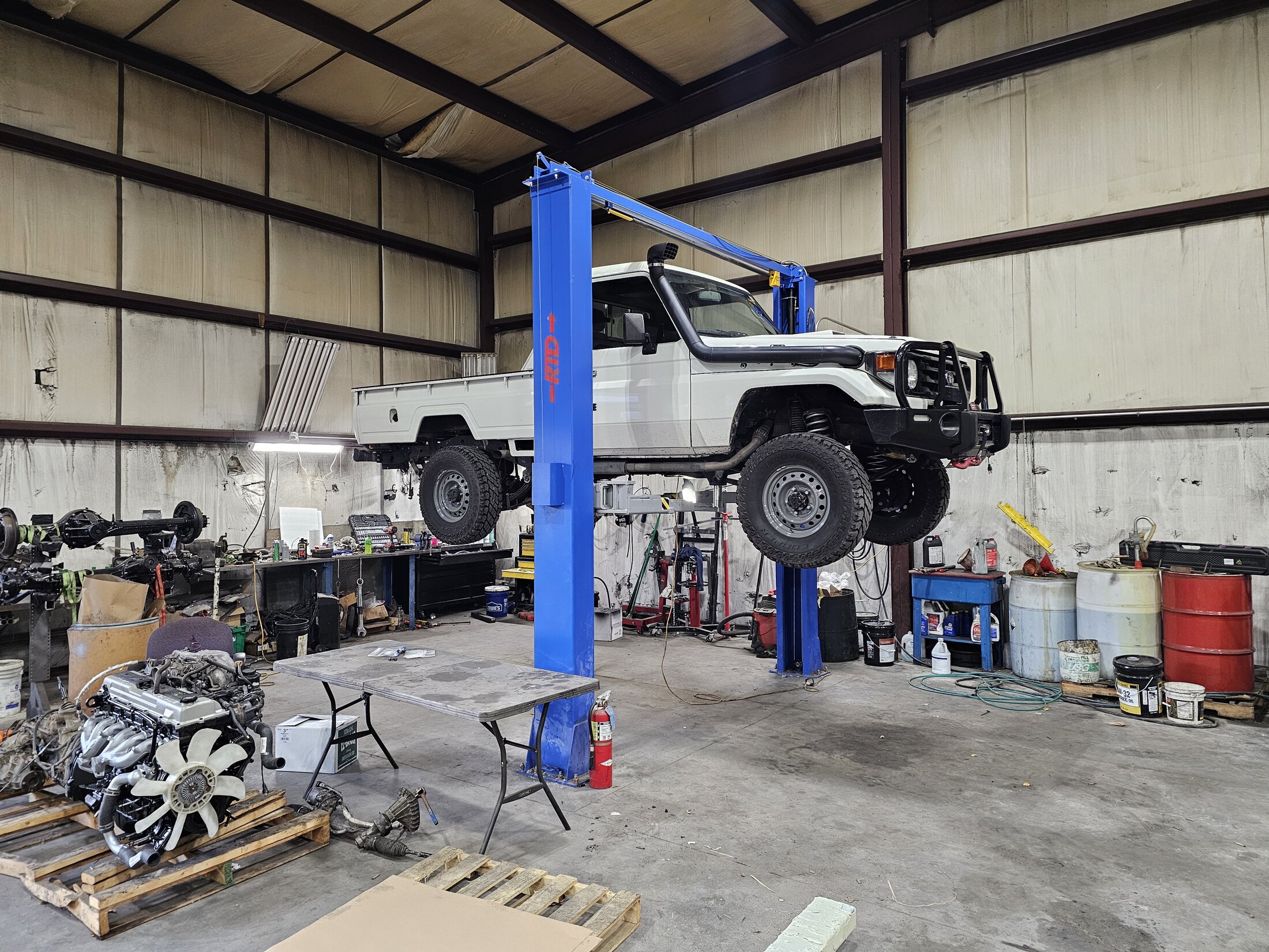

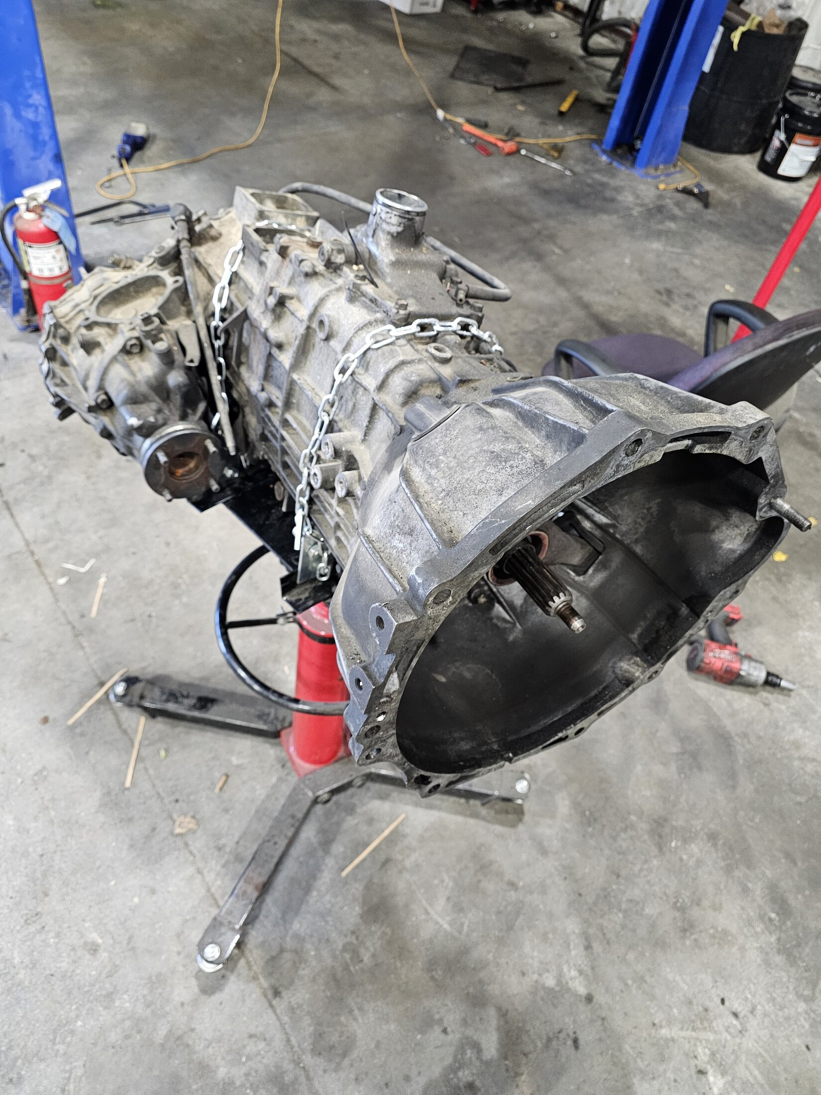

We got the 79 on the hoist this morning. Transmission was out by early afternoon.

where did you get the galley trays?
They're linked in the his post, click on 'drawers', it takes you to an Etsy page, looks like ~$110 for 4.

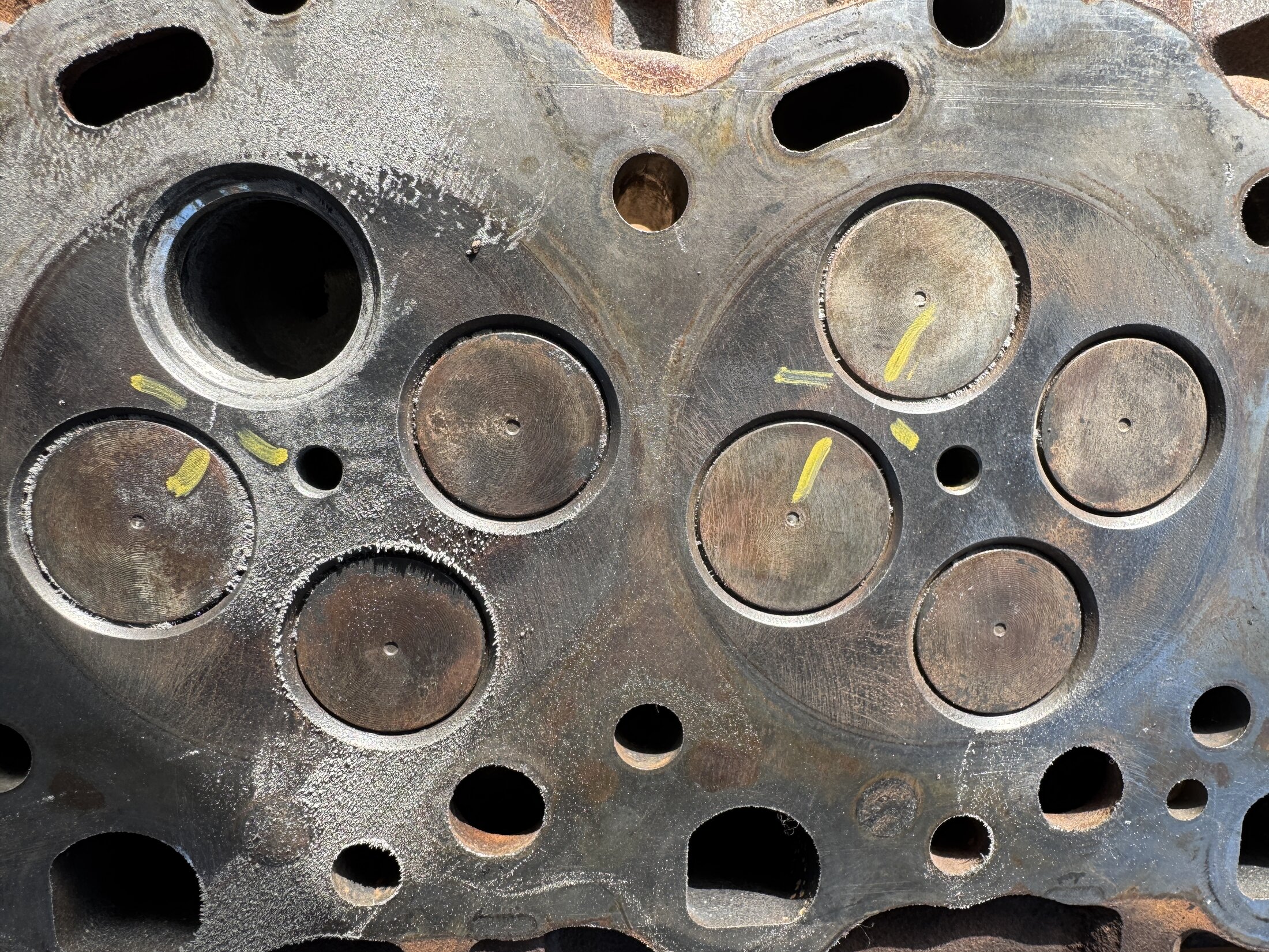

What are you doing about the head? If these are minor cracks that are common, they can be repaired. I used a shop in Oakland CA, that has been doing diesel head repairs for the last 50 years. They had CAT heads that were 7’ tall standing. They repaired my 1HDFT that had 2 minor cracks and rebuilt it like new including valves, seats, seals etc. $1000. I ended up doing this after spending $3000 on a new head (1HDFTE) and all the parts. Figured a spare FT head someone of my friends can use.
By the way, most of this damage could have been avoided with an efficient intercooler. My humble experience is that on all my cruisers reduced EGT by 200F average.
Photos of the damaged head and rebuilt.

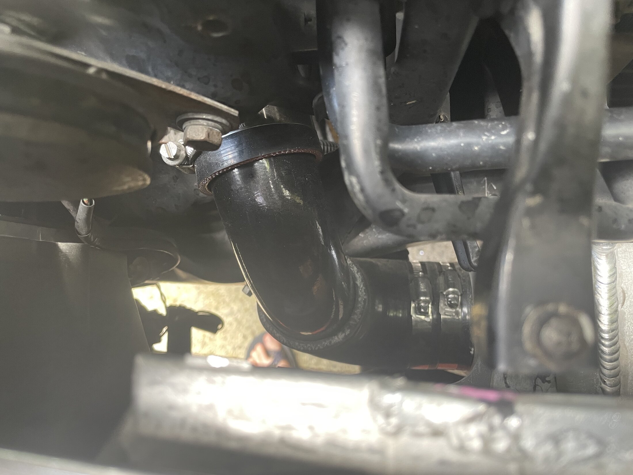

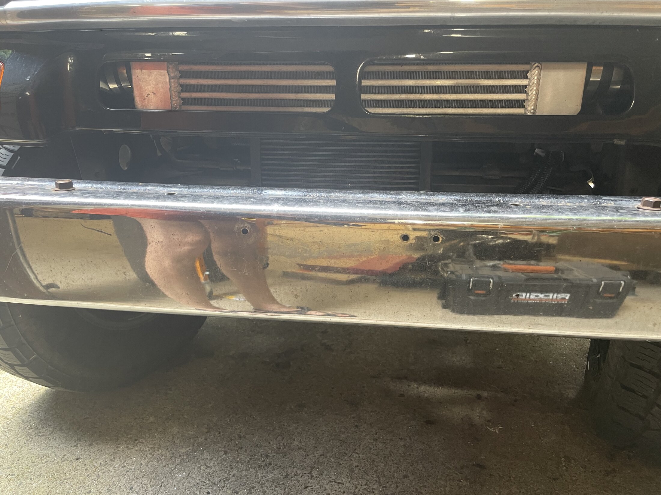

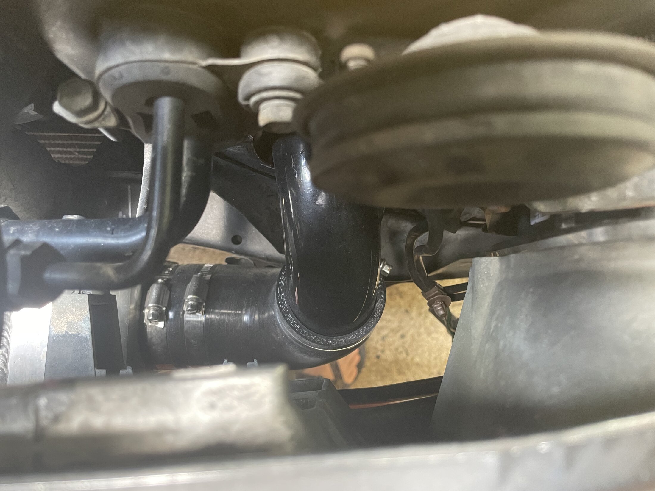

I’ll second the suggestion for an IC. It was not too difficult to route the tubing for a FMIC. I went through the radiator support with two holes behind the stock horn locarions. I went with an IC that left enough room for a future winch. EGTs under boost are down by about 300 F. It is now difficult to get EGT over 1000. whereas before I could easily get to 1300+ if I did not back off. I also irun a new blue fan clutch with 30K CST oil and a 72 C thermostat. Coolant temperatures rarely exceed 185 F at the outlet neck on the head, which should be the hottest point. Finally I run an air bleed valve at the boost sensor, which lets me trick the ECU into adding less fuel under boost. It makes less power I’m sure, but not really noticeable in daily driving. My priority is temperature control for longevity. Hope those help.
