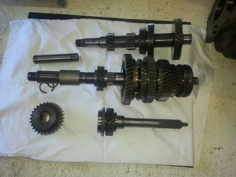

Finally started re-assembly of my spare H55f for my BJ74. Got stopped because I'll be buggered if I can find the 1st gear thrust washer locking pin.
Hopefully this should be a good thing once re-assembled, new 1-2 synchro hub, new synchros for 3, 4 and 5, new later-style 3-4 shift sleeve, marks 3.05 gears for the transfer case, rebuild kits through the gearbox and transfer, new bushes and shift shoes for the transfer linkage. Fingers crossed it all goes together okay, finally gets rid of the vacuum transfer so I can get a new dump pipe made inside the chassis rail.

Also attached are some pics of the gearbox and transfer rebuild mentioned above. Also found a moment today to spin up the output shaft in the lathe and linish it down to 40.000 (actually ended up around 39.995) for the needle roller conversion which is part of the marks kit.
