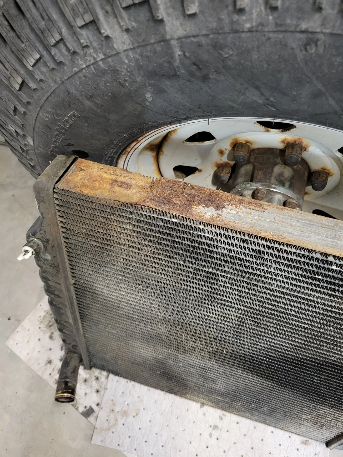

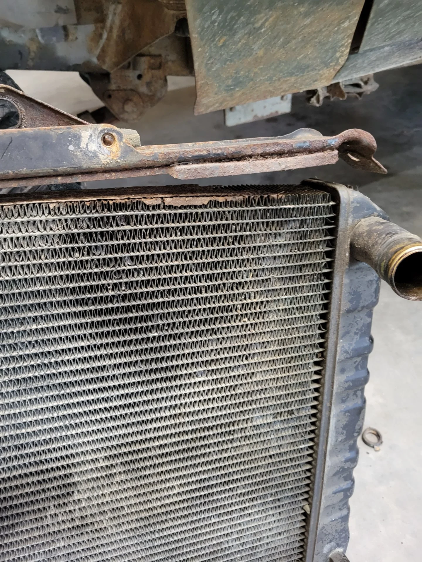

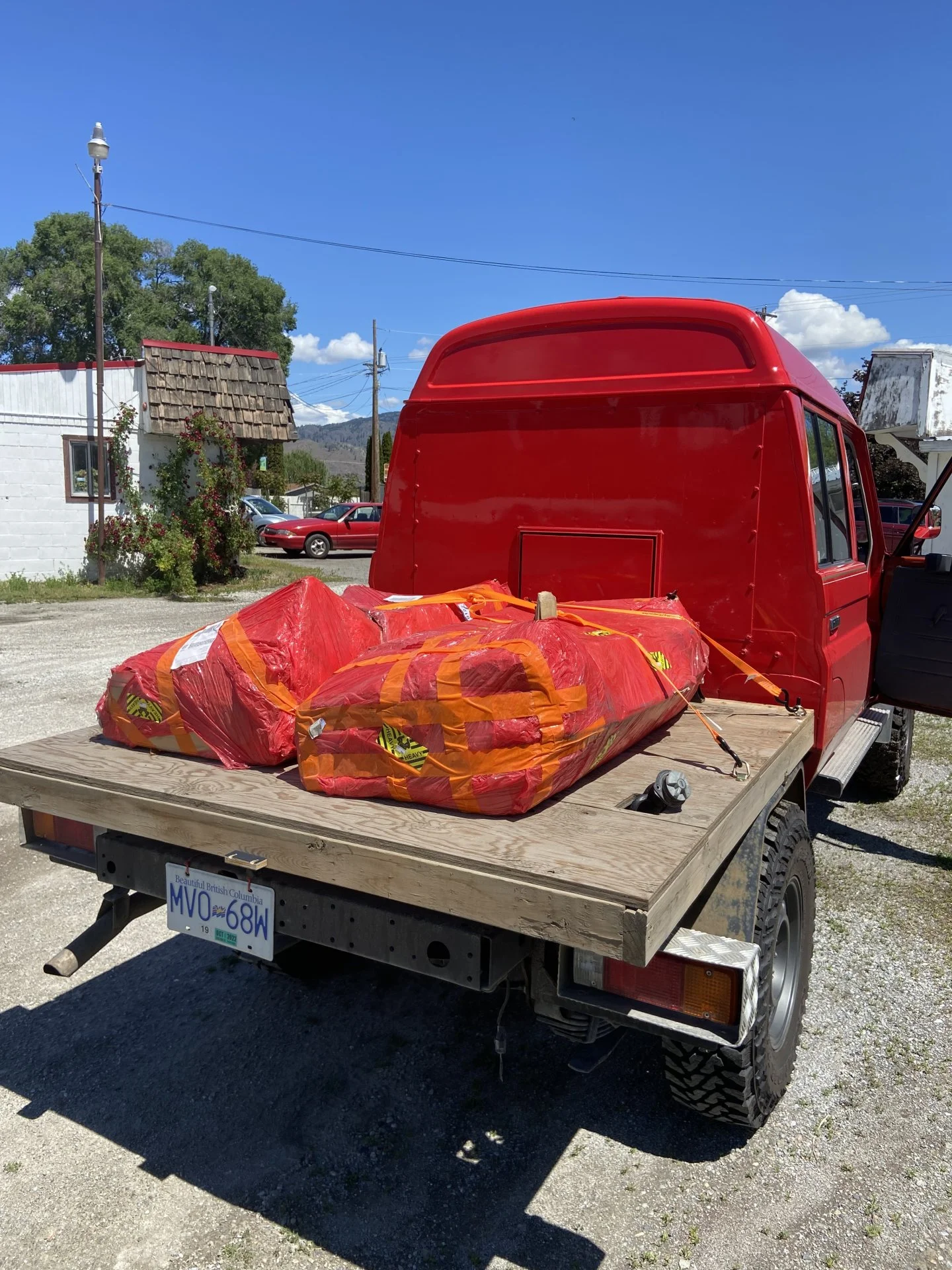

Yesterday I swapped in a new radiator from a jeep yj into my pzj 75 , worked out really well . And I'm only into it for about 60 bux , this old truck is well beyond wore out so I can't justify spending alot of cash on it . The old rad was rusted out on the sides and wouldn't hold coolant anymore , now its ready for another load of wood .

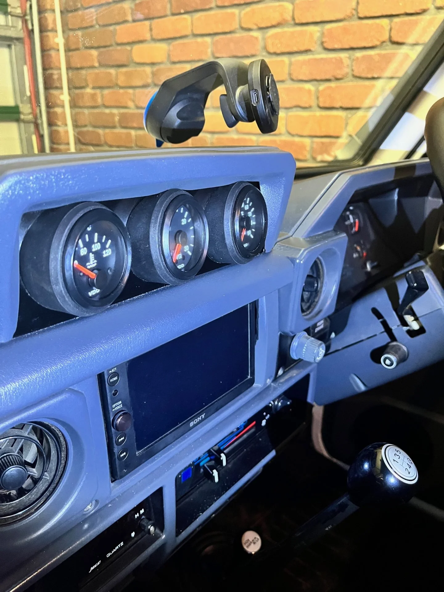

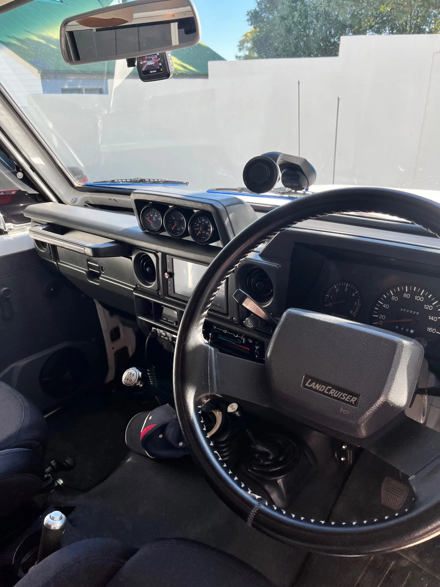

Fitted some angled spacers behind the gauges on my dash pod so they would face the driver a little more ( you can reverse them if you drive on the wrong side of the car) I also fitted a new Aisin 80 series brake master cylinder as the aftermarket generic one I started leaking. I can actually lock the wheels up now.

Info available for that gauge pod?
SAAS SGP1209 Gauge Pillar Pod, RHD Troopy '85-'09, Dual
This is what fit my my hzj77. I got it from cruiser brothers, but you can also get them off eBay (Australia), and I think cruiser outfitters may have them too. Just make sure you get the right one. I initially bought the wrong one.
