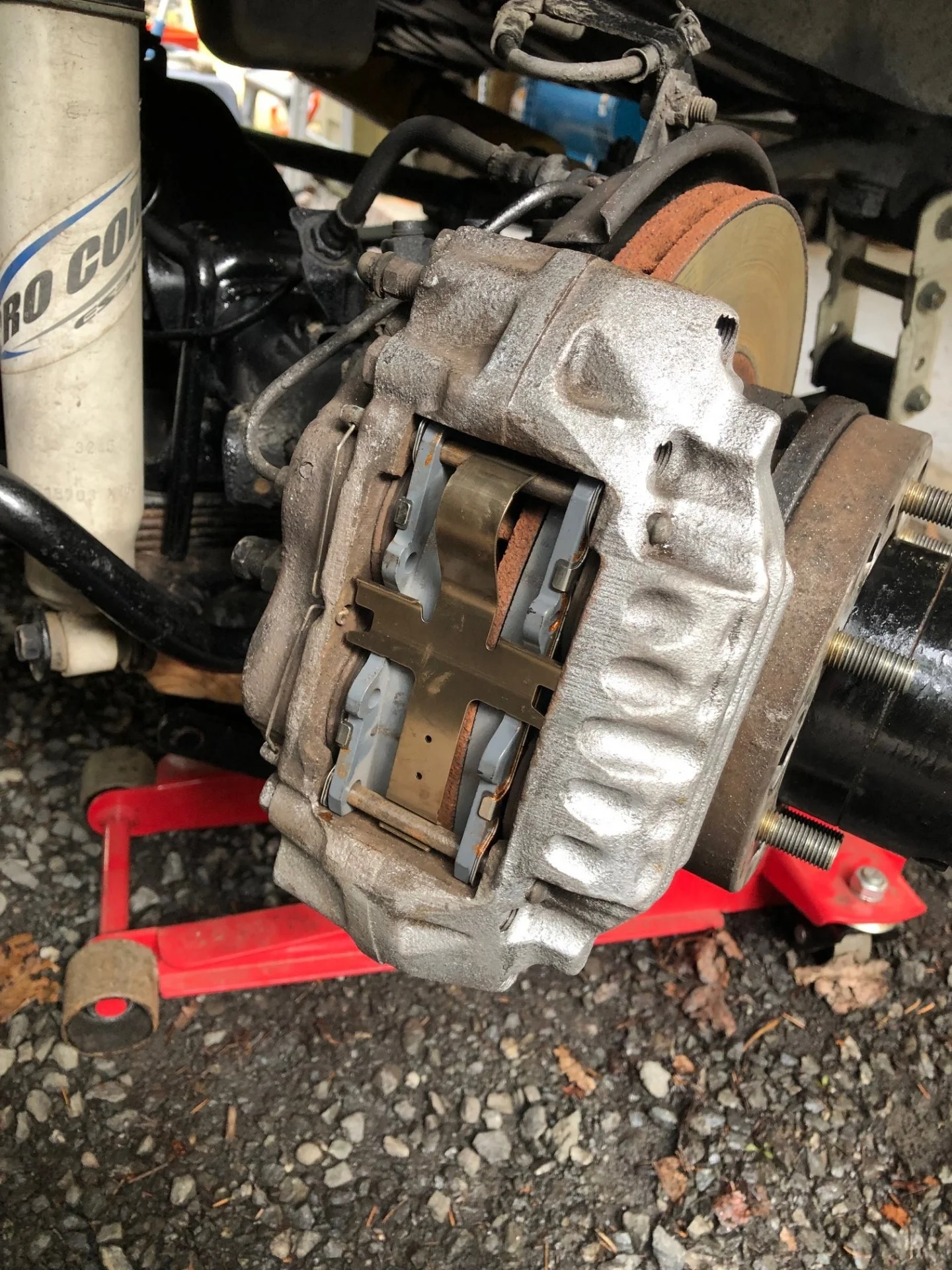

HZJ77 front brake pads. I wrench on a lot of different vehicles. GM...Chrysler...Ford... but it never ceases to amaze me of the genius and the thoughtful design of the Toyota engineers. The way in which the pads can be replaced without having to pull everything apart is just...elegant. I'm a little embaressed, but is it ok to say that I actually enjoyed working on my brakes tonight?
