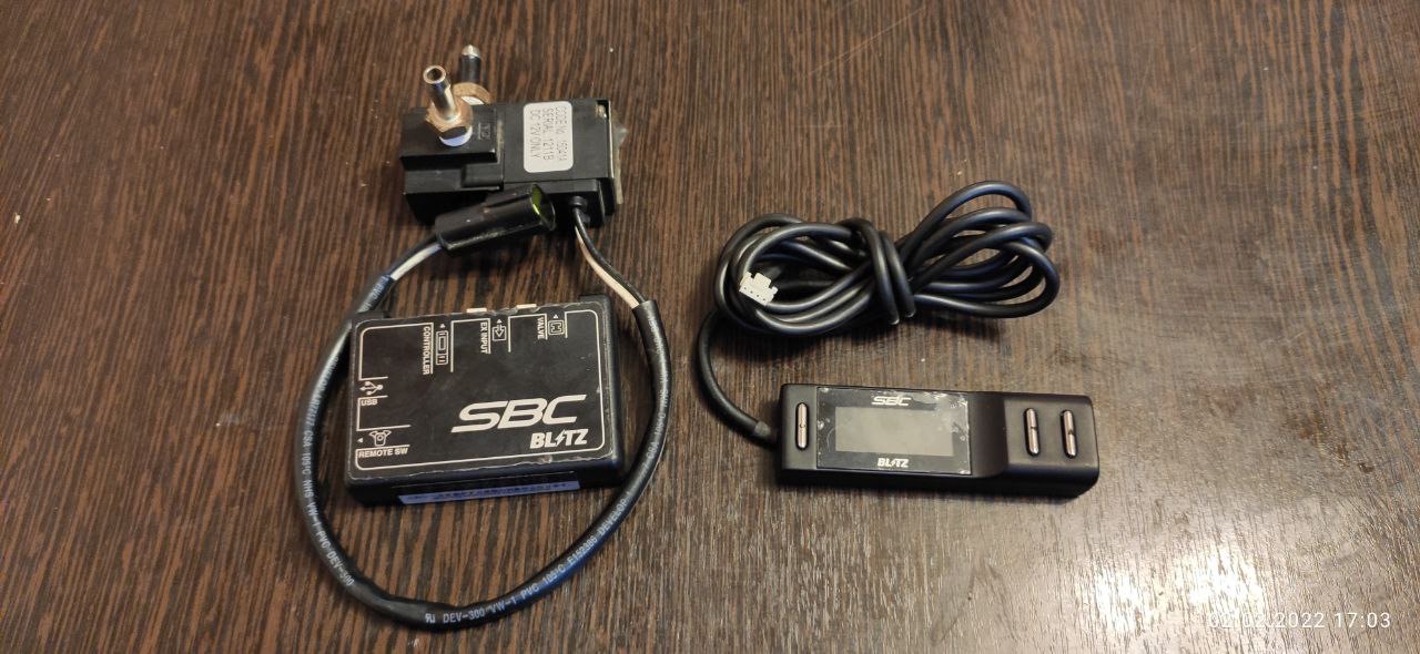

First time I use cheep Chinese manual boost controller
Later I remove manual and install JDM Blitz SBC Type s.
Electronic boost controller works better then manual

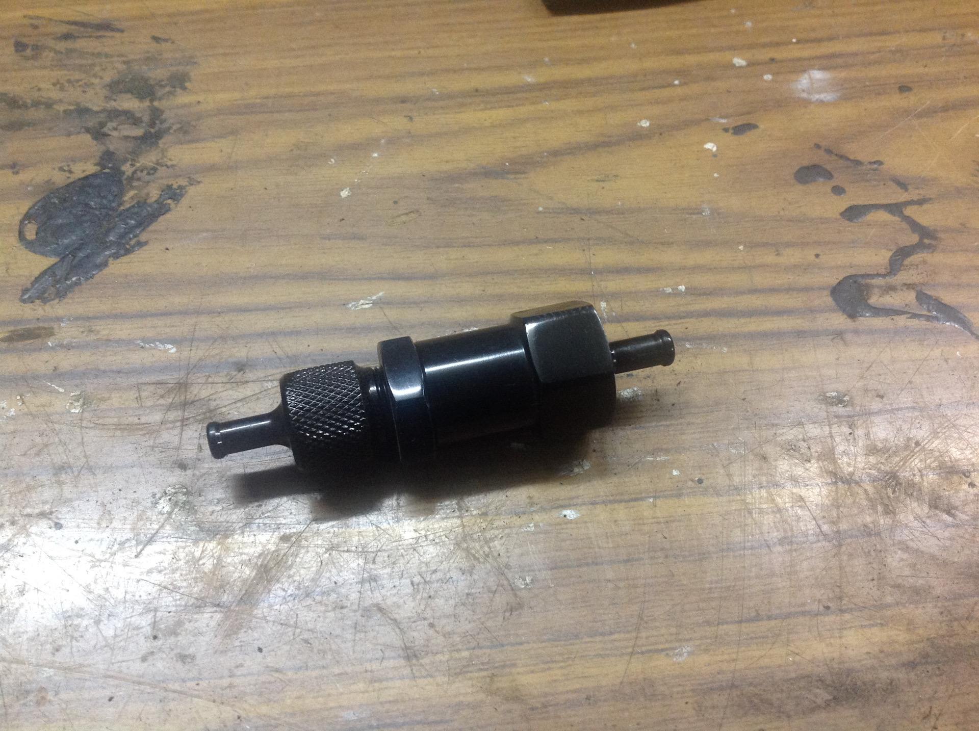

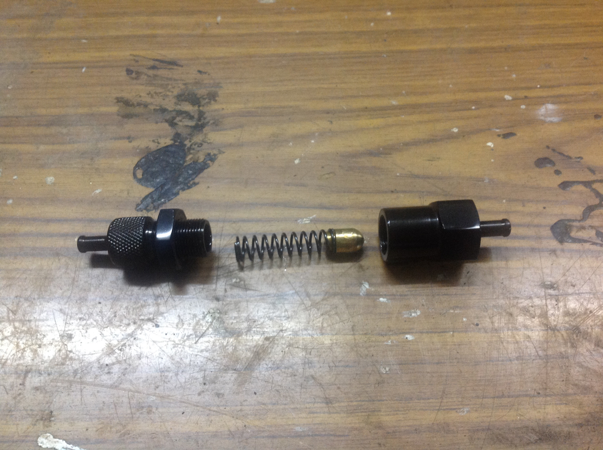

Just linked in to this, they have changed the shape of mine but this is it.
Basic manual ‘set it and forget it’
I am also having a problem controlling boost. I have a basic MBC like the blue one on the first page. It doesn't seem to change the boost no matter what setting I have it at, until it is fully closed. Then of course the boost will spike up to 18 or so, and come back down to around 12psi. I don't know if I have a wastegate issue or something else going on. It is driving me nuts. Considering just tightening the wastegate arm.
None...... Yeeeee haaaaaaa! VROOM VROOM!!!! 25 psi 3B
go fast bits manual boost controller
I had this controller before or something very similar. I had the same issue you describe. The controller was useless, so it got tossed and swapped it for the Dawes and I have no issues setting the Dawes. Per a post above, I'm not sure if they are still making their MBC though.
