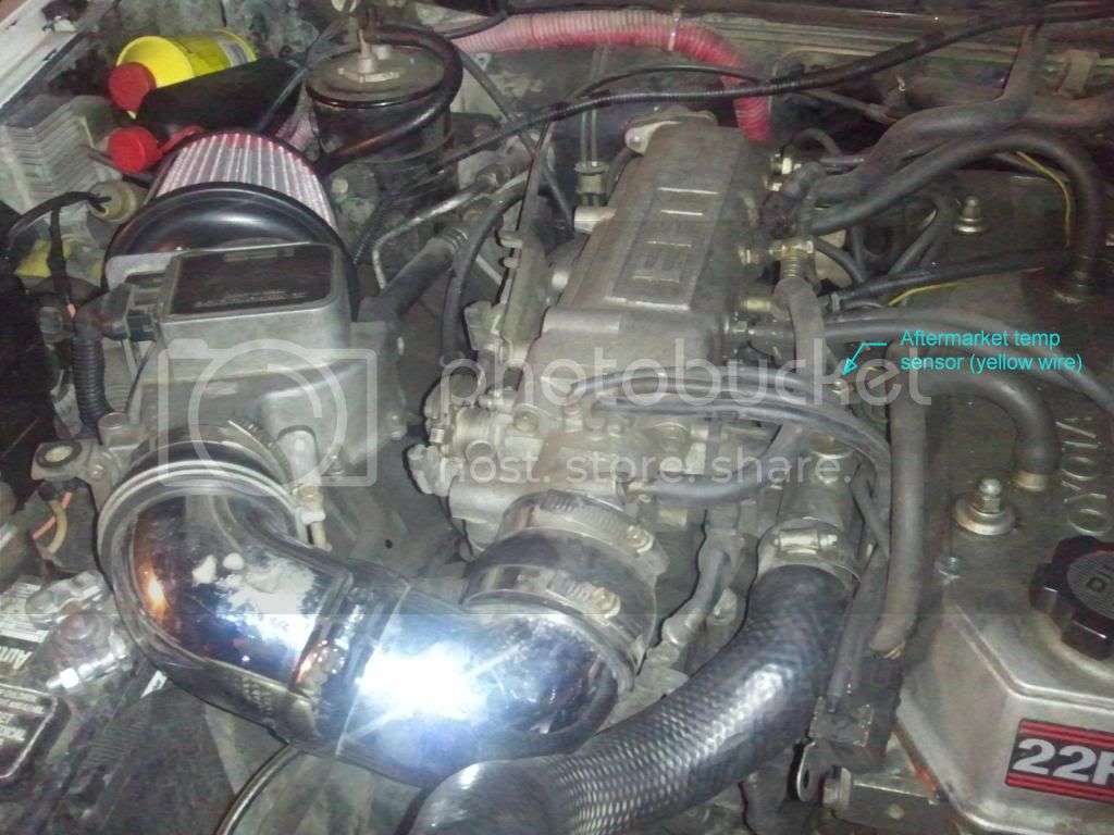

i am currently looking at what to put on the drivers side havent seen many pics but you do have to relocate the afm and air box...
one work around i have seen is add a cold air intake and run it on the passenger side back toward the firewall
they had a group 34 where the stock air box was cant seem to find the pic atm
