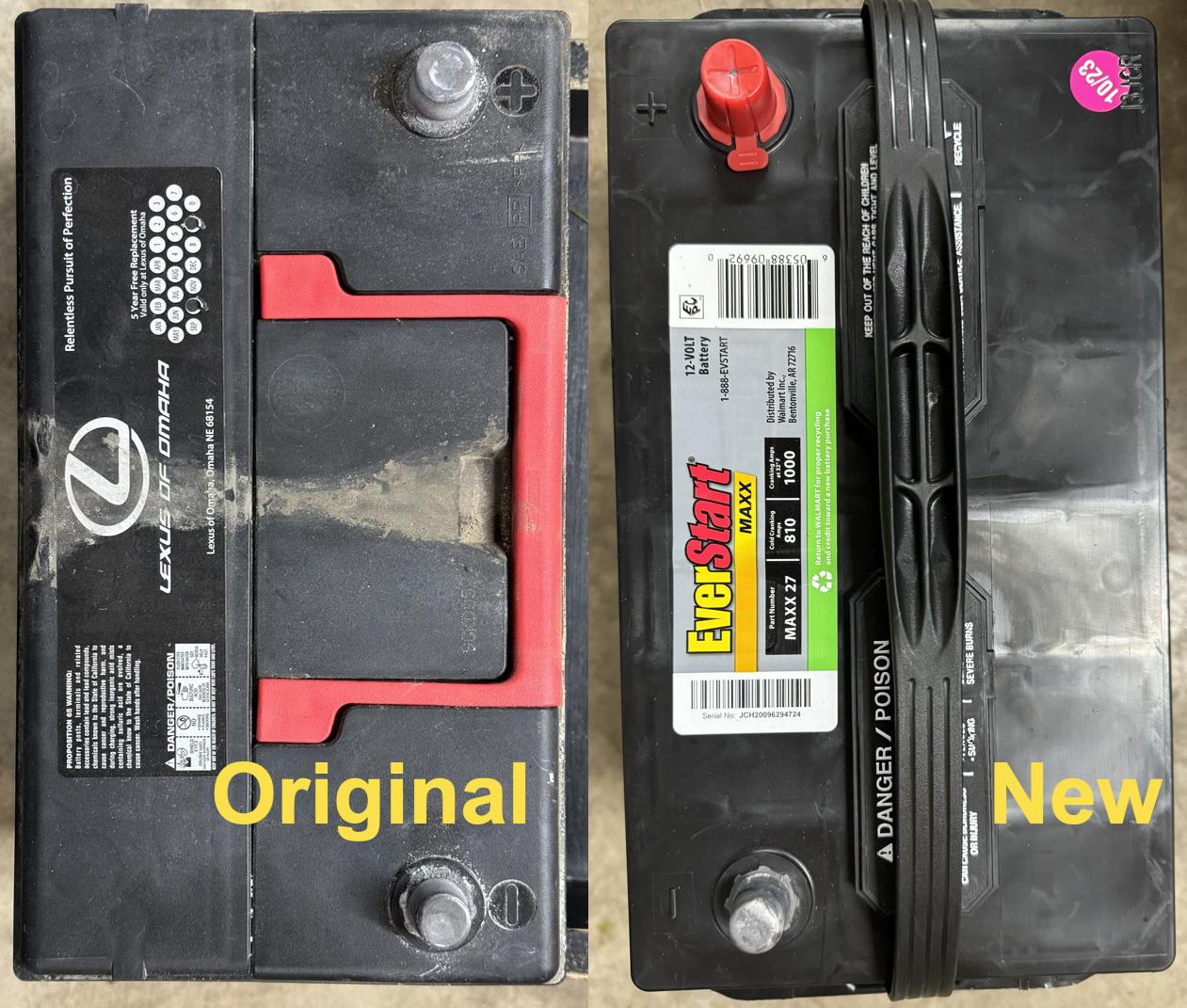

Okay, I have a dumb question. I ended up in purchasing the Everstart 27F from Walmart since I kinda need it fast. However, I found that the two terminals are reversed. What are my options? The cables are too short to reach on the new battery.

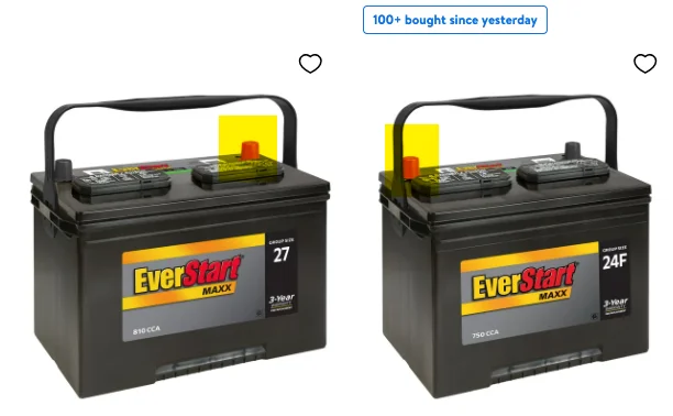

Okay, so maybe the 27F is incorrect. I'm looking at Walmart's site and it showed that the 24F has the positive terminal on the left just like the original.

You bought an EverStart 27, not a 27F - that's why the terminals are reversed.
I suggest returning the EverStart 27 to Wal-Mart and exchange it for the correct EverStart 27F.
HTH
P.S. The EverStart 24F has the terminals on the correct sides, but is a smaller capacity battery. In a pinch you could install the 24F, but I would not view it as an optimal solution.
I think I know why...it seems like Walmart don't carry 27F. I saw 27 and forgot that I'm missing the "F" part. I searched their site and couldn't find 27F.
I just searched their site as well and found no 27F batteries,,,
