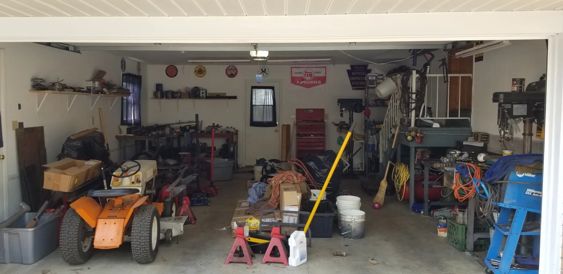

finally getting back to a sense of normalcy around the new castle. the house has been sorted for some time now, but i never could find enough time to do anything with the rental garage....this past week ive been going hard at that and was able to make great forward progress...the old place is pretty much empty, most everything has found a new hiding place in the new garage, the last major step was moving the 60series frame, and that happened yesterday. the boxes are a place set for the kid i need to build in the back yard. for the most part things are ready to happen here now.

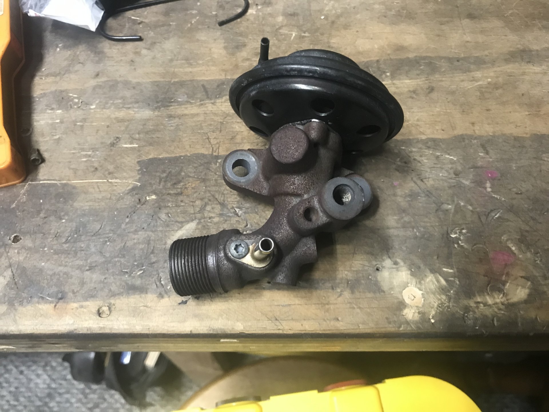

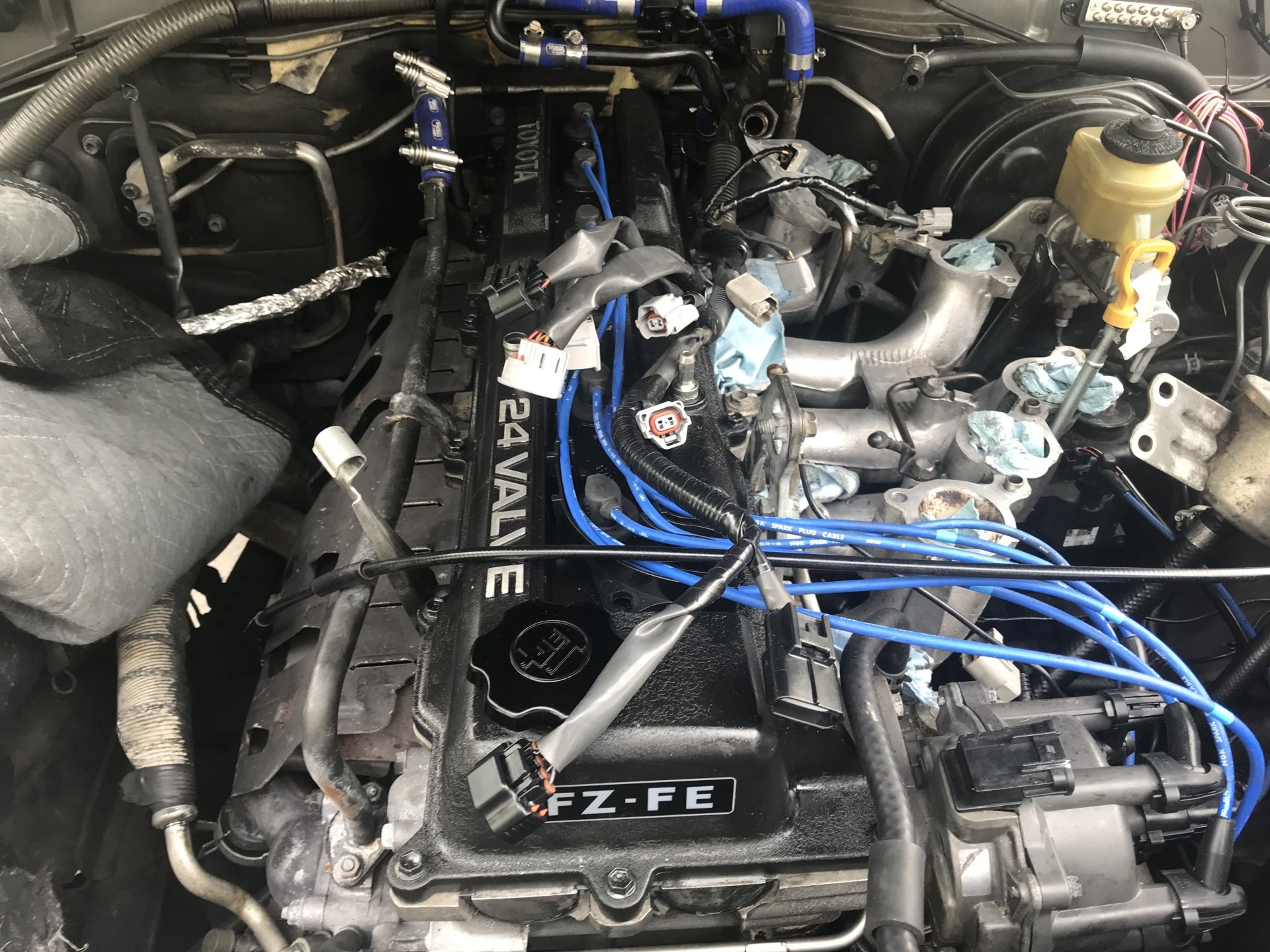

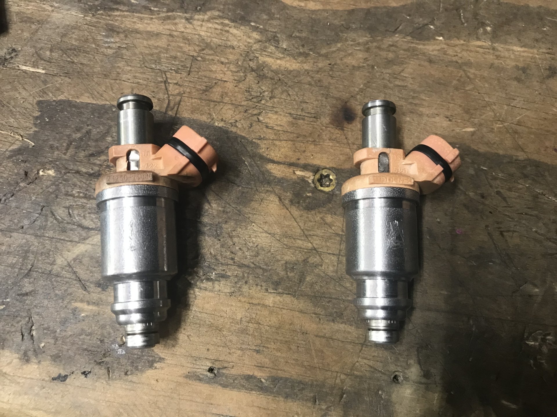

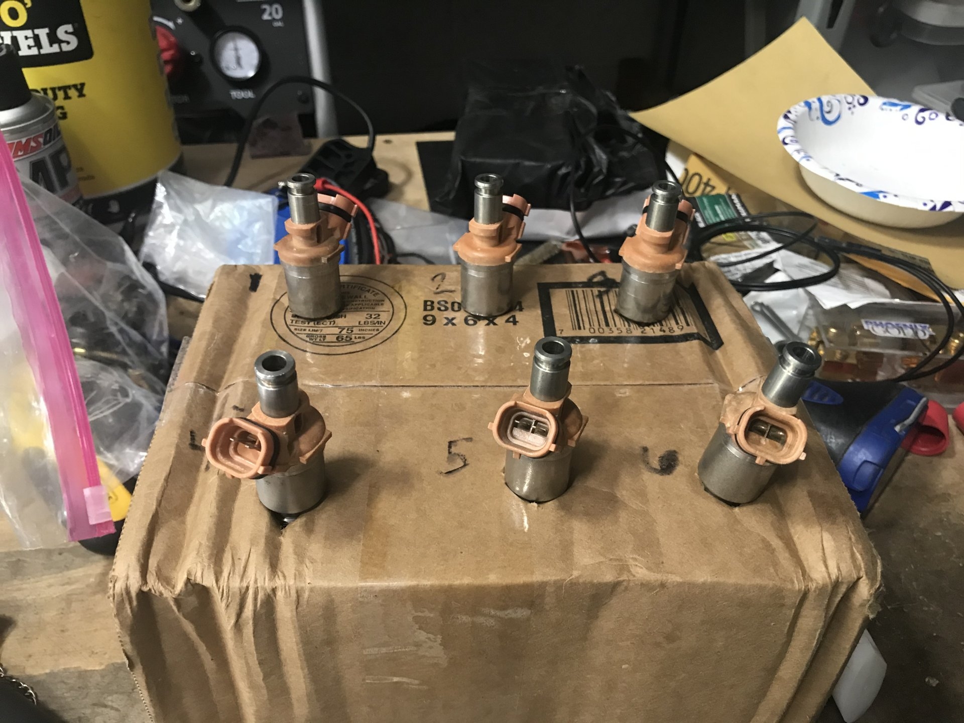

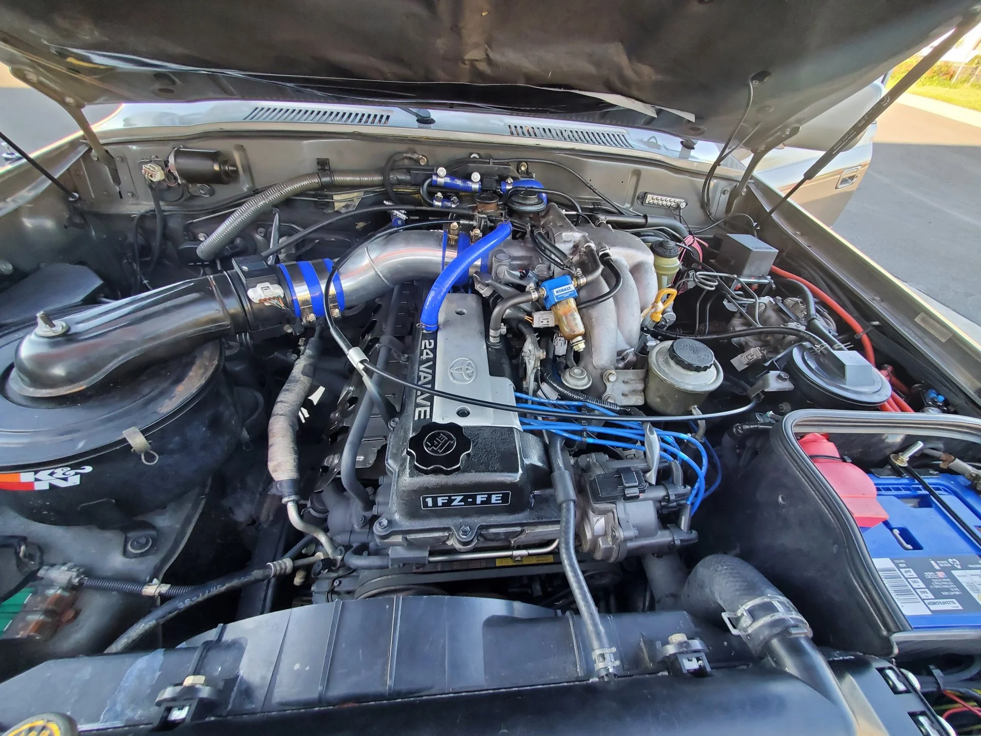

Working on the 80 this week. I was planning on replacing the valve cover gasket but ended up braking every connector I touched. Then one thing led to another and removed and cleaned throttle body, intake manifold, VSV, and ERG. I ended up removing the fuel rail and injectors and purchased an ultrasonic cleaner from HF that help clean the injectors and ERG.
Working on the 80 this week. I was planning on replacing the valve cover gasket but ended up braking every connector I touched. Then one thing led to another and removed and cleaned throttle body, intake manifold, VSV, and ERG. I ended up removing the fuel rail and injectors and purchased an ultrasonic cleaner from HF that help clean the injectors and ERG.View attachment 2668215View attachment 2668216View attachment 2668217View attachment 2668218
Received all parts to complete the top rebuild on Friday (12 hole injector kit from Osidetiger's 12 hole injector upgrade, PHH #2, and new fuel filter). I wanted to take care of the pesky maintenance items now since I had the upper plenum off. I know there were people on the forum that tried the injector upgrade but they showed no improvement but I can tell you this pig can get up and go now.

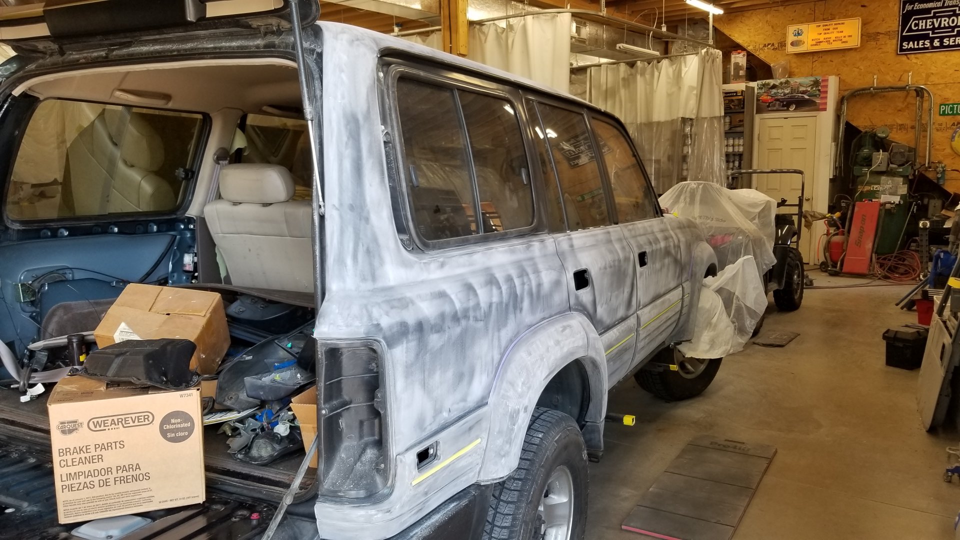

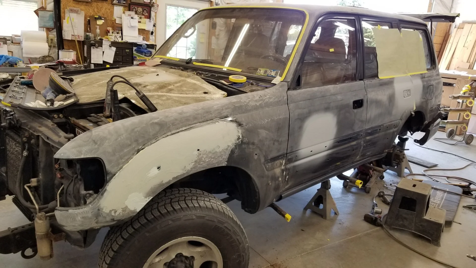

A work in progress ... thank goodness not by me.

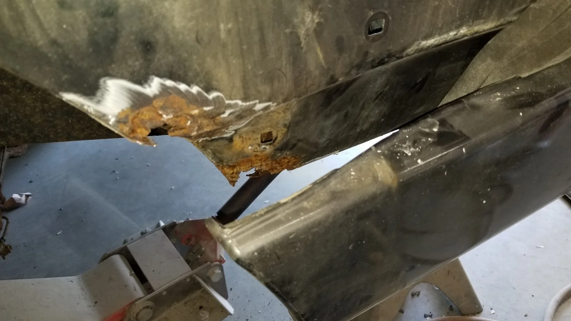

Only one nasty spot on the DS of the rear tire well.

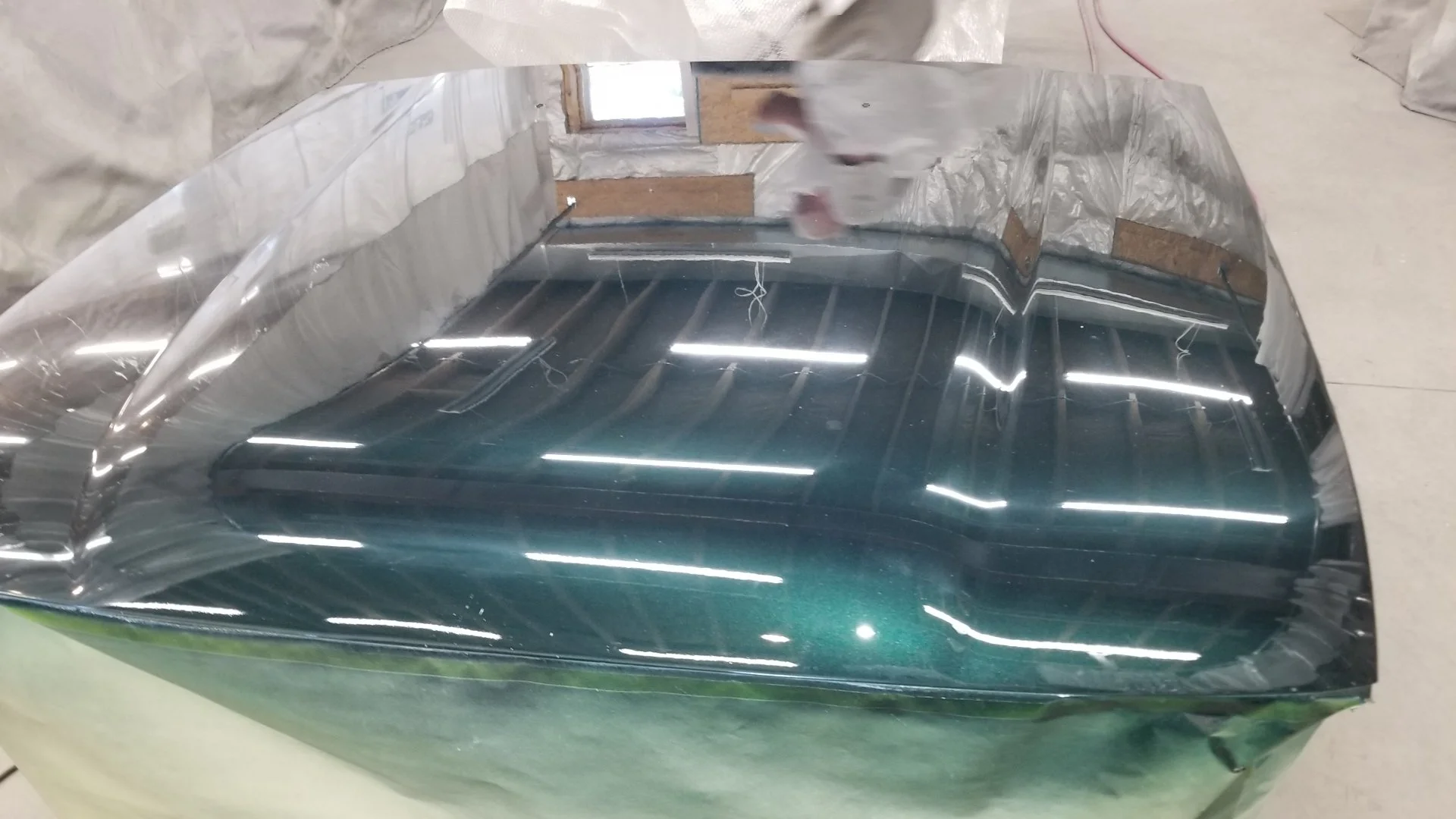

Hood painted ... still needs sanding and buffing. Man the green looks bright.
New window mouldings and weather strip gaskets all around when the paint is done. Roof rack is off with no rust and no broken screw mounts for it. Thinking it is going back on to keep the rig as stock as possible, but thought the rack had some thin rubber under the mounts. Not sure what to do about that. Open to ideas if anyone has them.

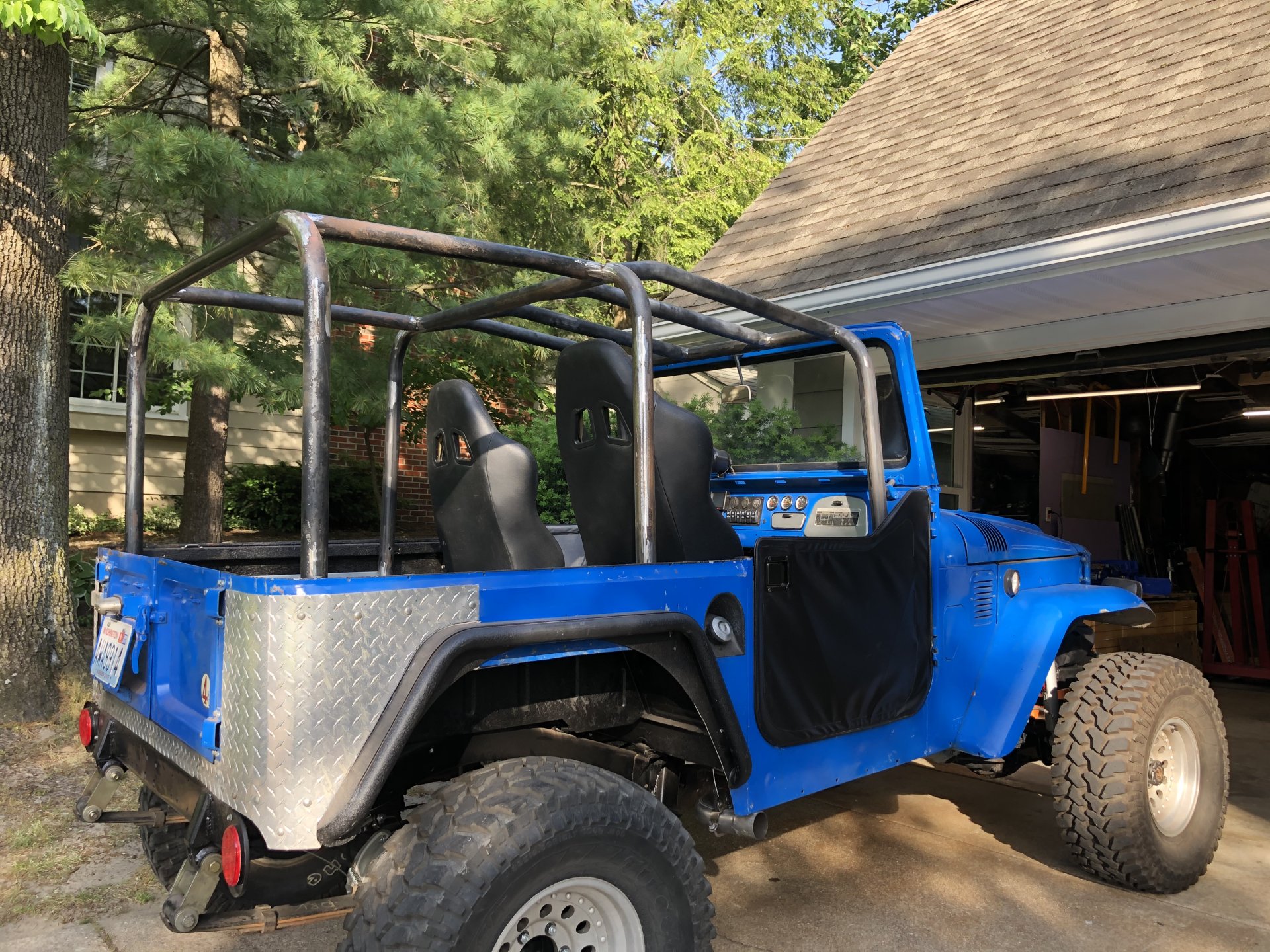

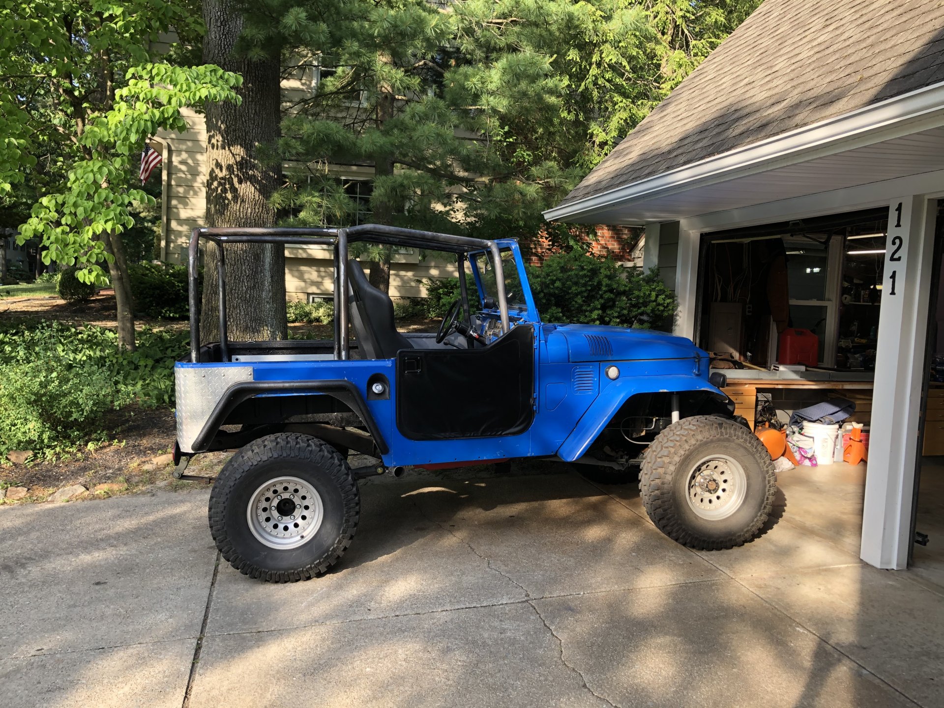

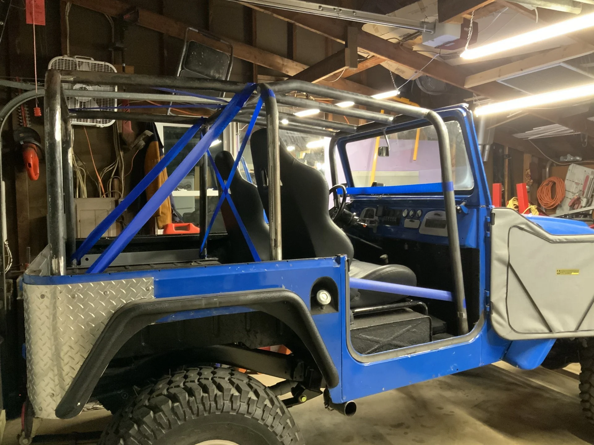

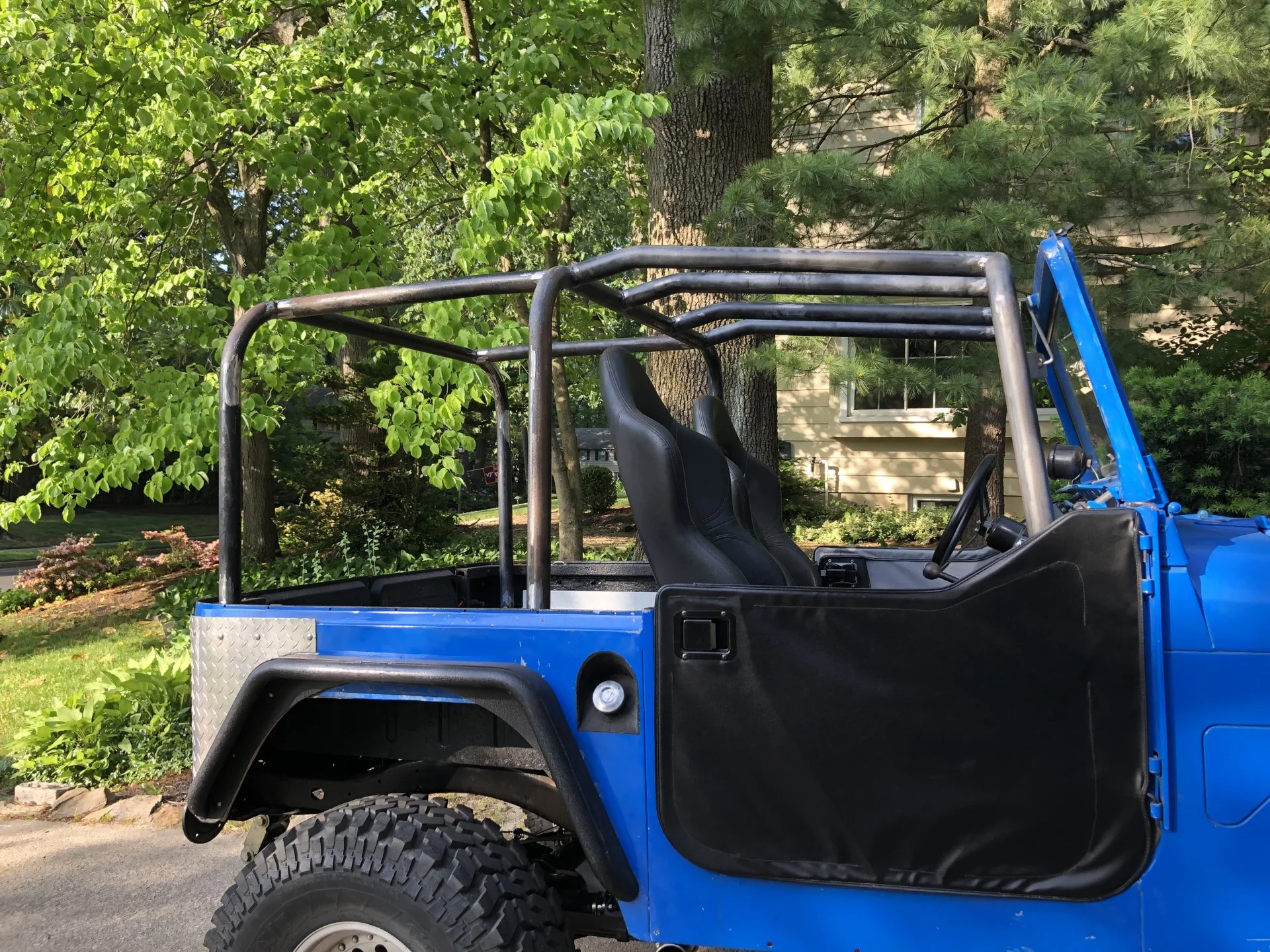

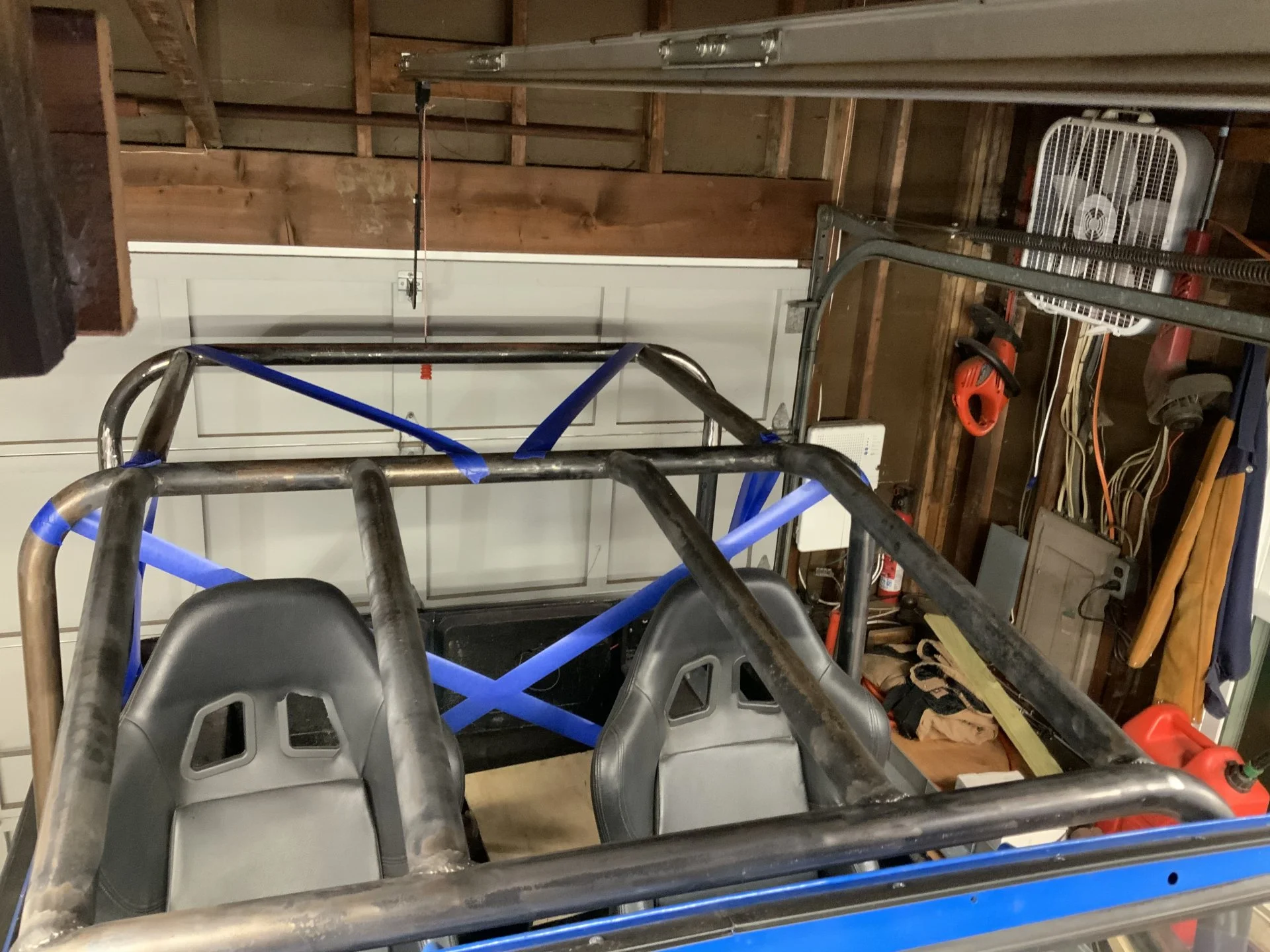

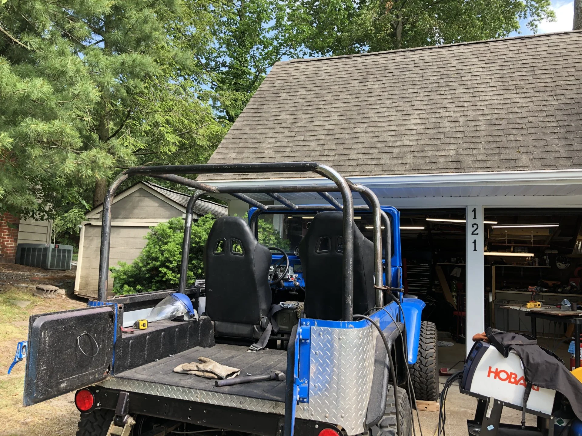

Cage. More room for kids. Took my cage, cut the back off, took another B pillar hoop from another I had, made it the rear hoop. This is just the start, going to have roof cross bars for the rear, x brace behind front seats and mounts for seatbelts, dash bar, and B to C pillar diagonal. Maybe door bars.

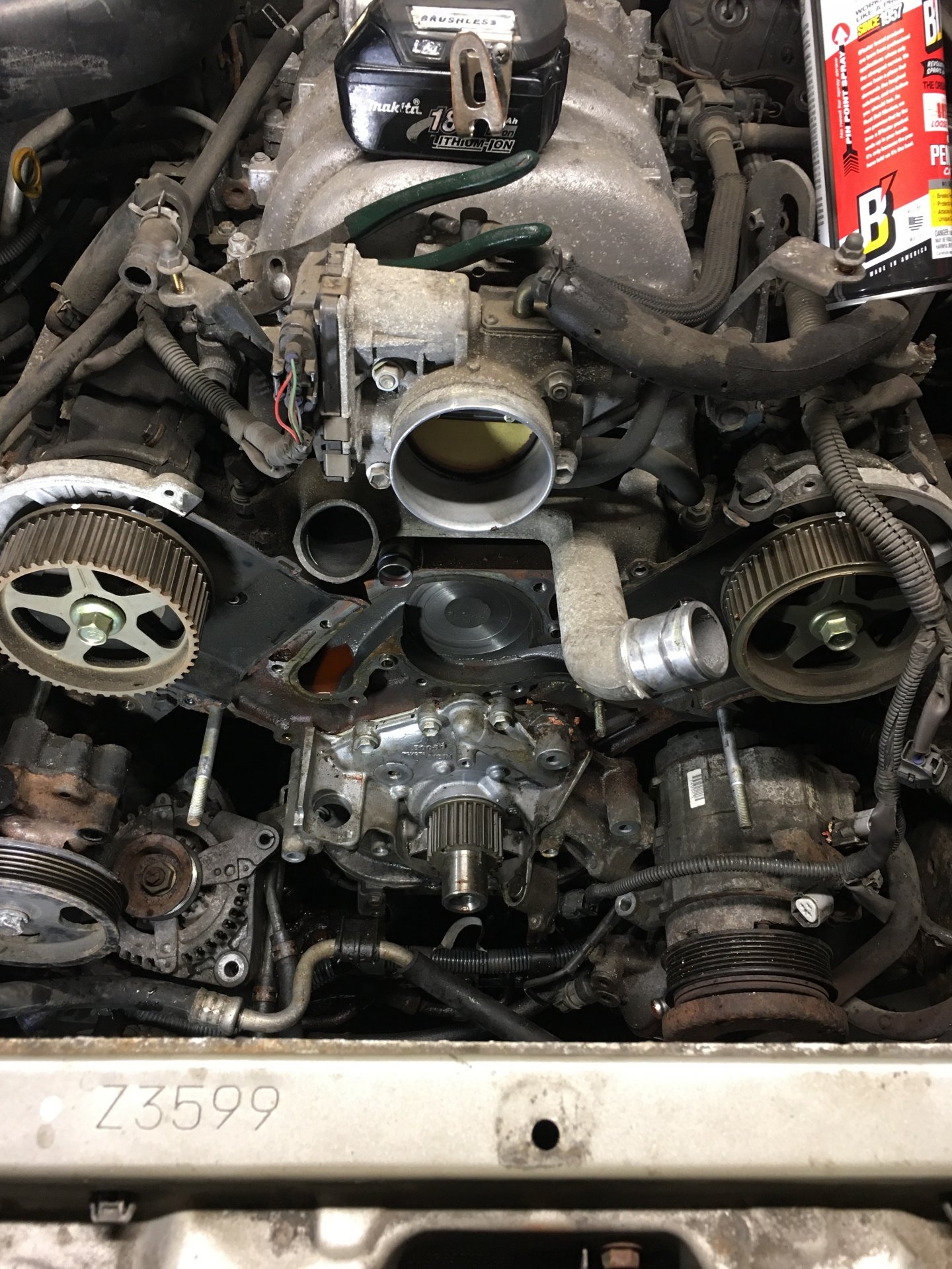

Changing a Timing belt on my v8 4runner. At 190k belt looked like new, the water pump had some dry coolant residue on bottom already, otherwise I could have drove another 100k without a problem

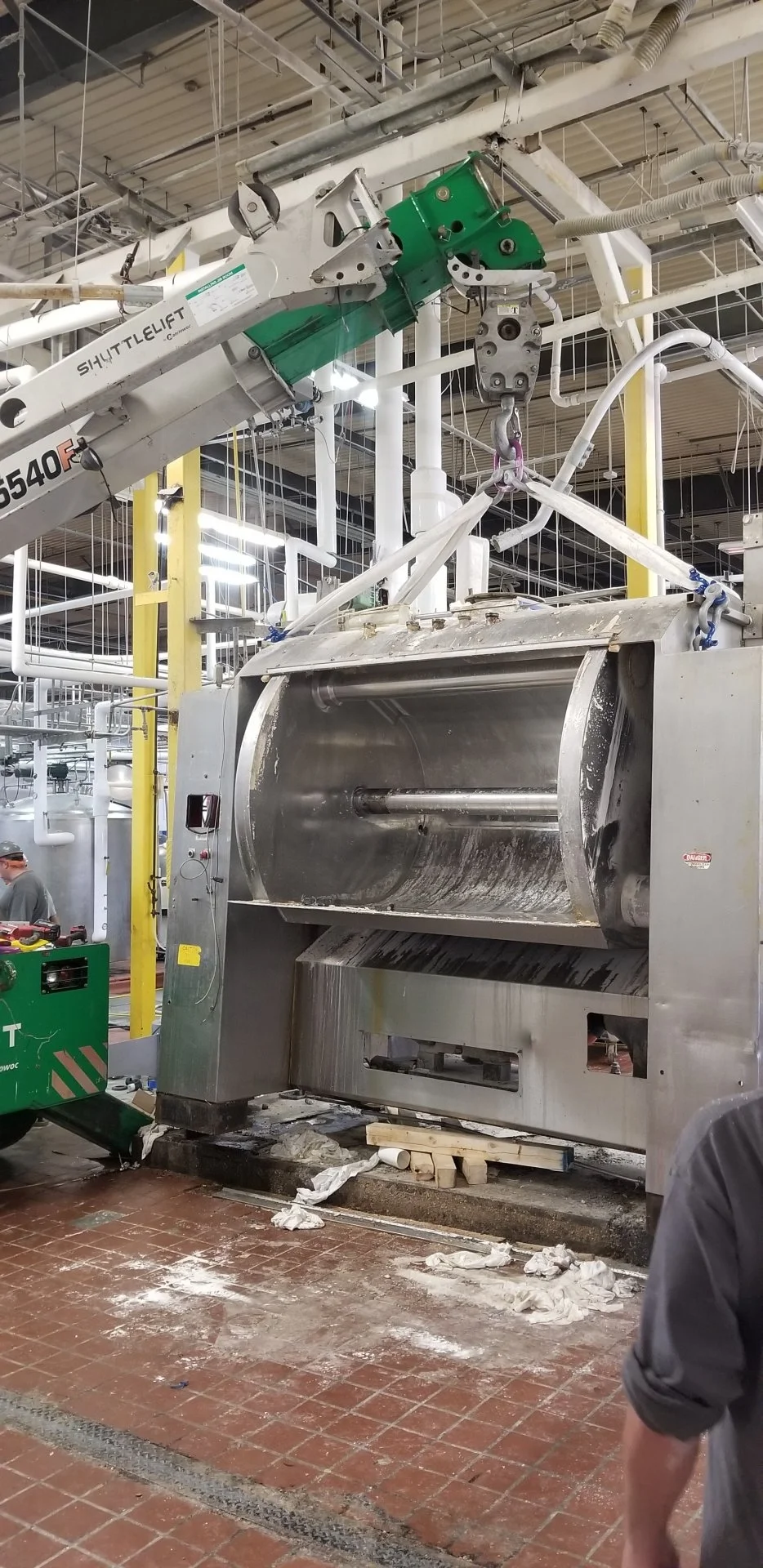

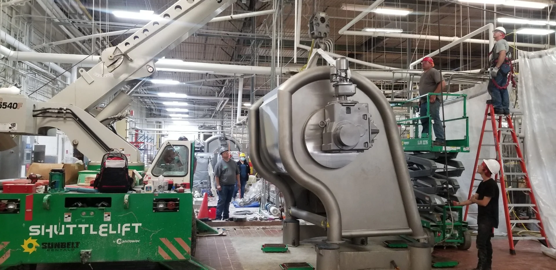

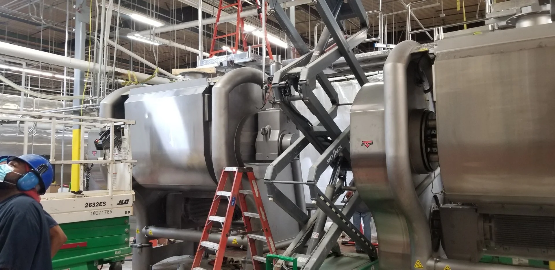

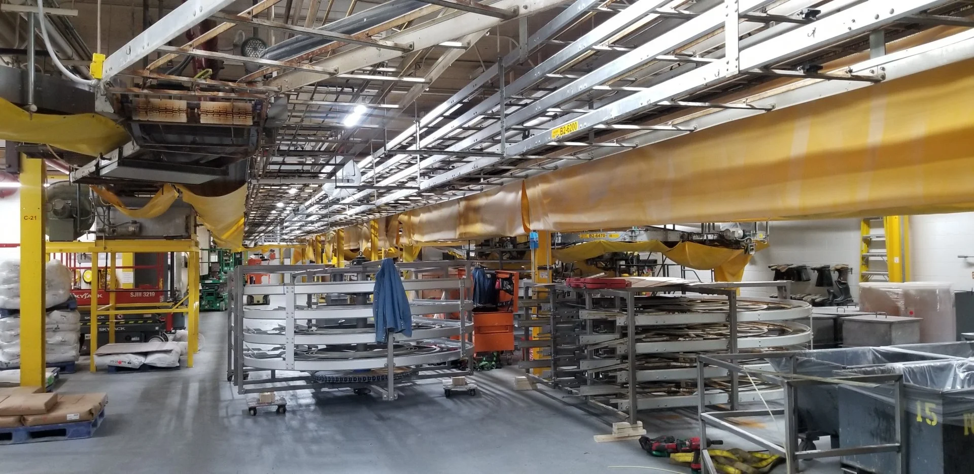

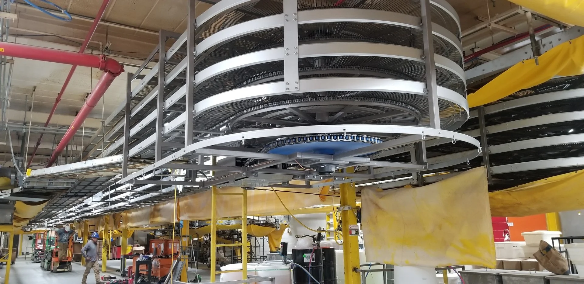

A bread line mixer upgrade job in Mississippi to a bread line cooler rebuild in Wisconsin....with any luck I'll be back in PA the end of this week.

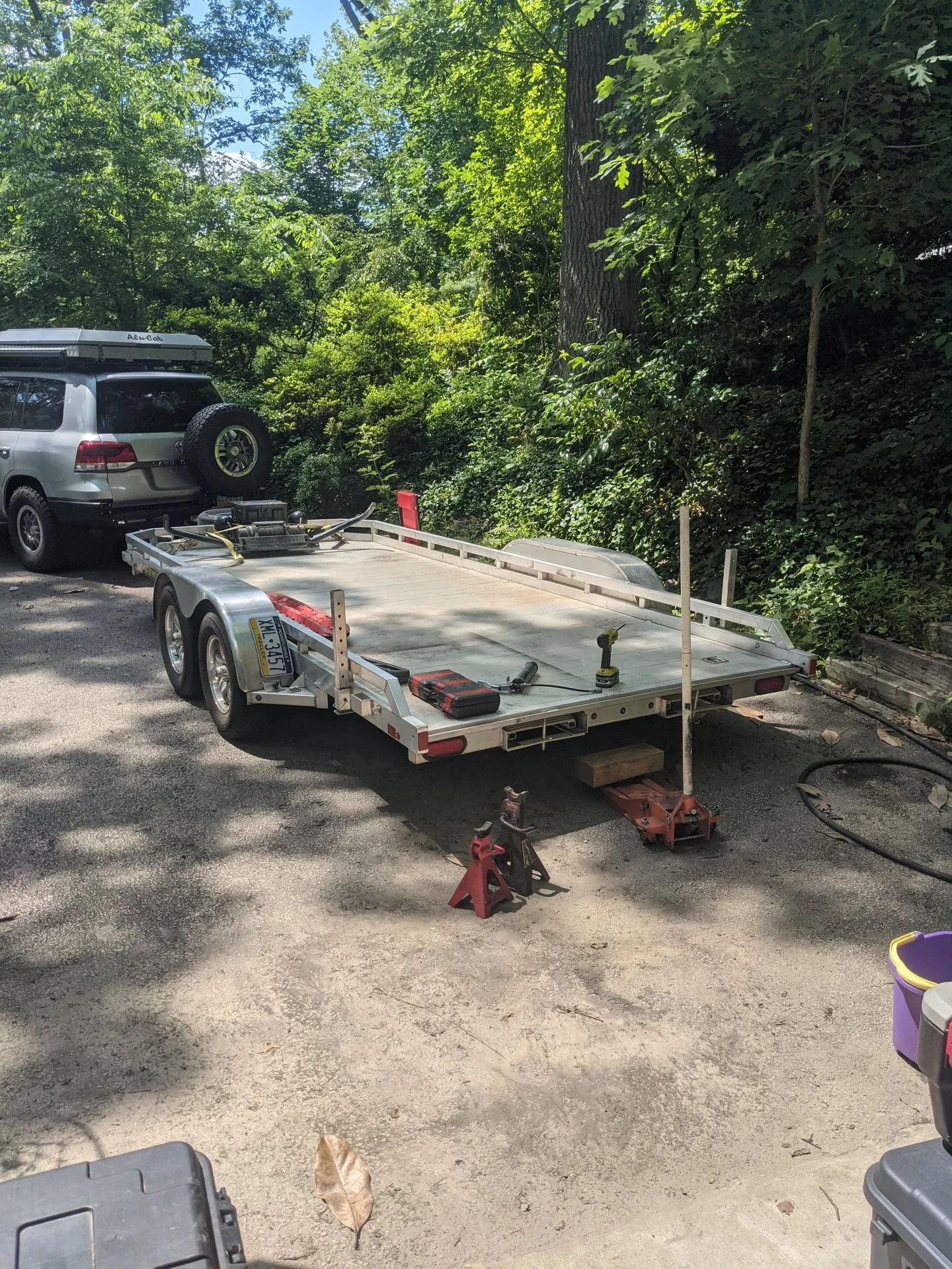

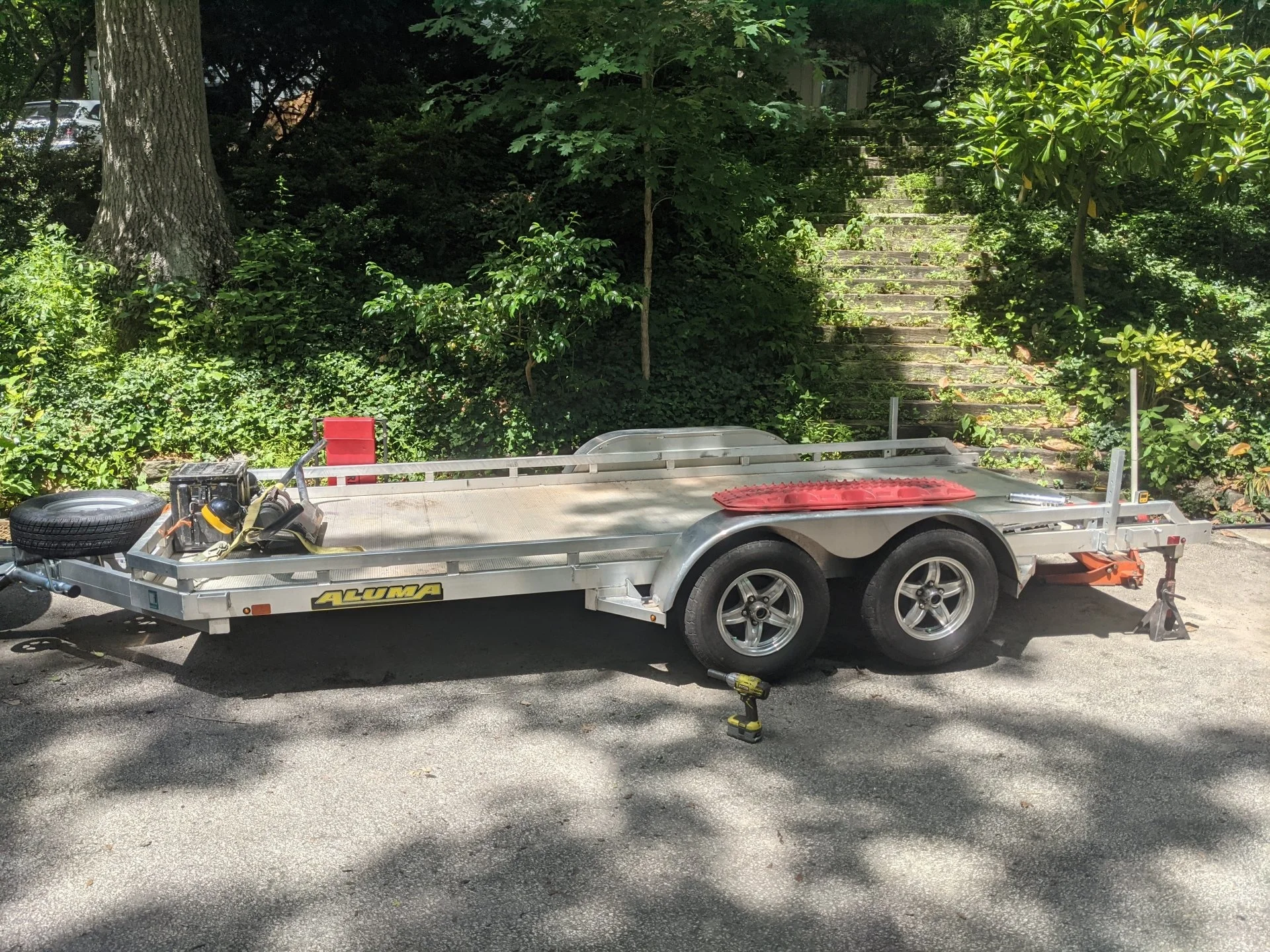

A little trailer maintenance.
Rotated and balanced all four wheels, lubed wheel bearings, adjusted all four brakes.
Had a nasty vibration anywhere over 70 mph. Psyched to see how it runs now, all four wheels took some weight, one needed much more than the rest.
