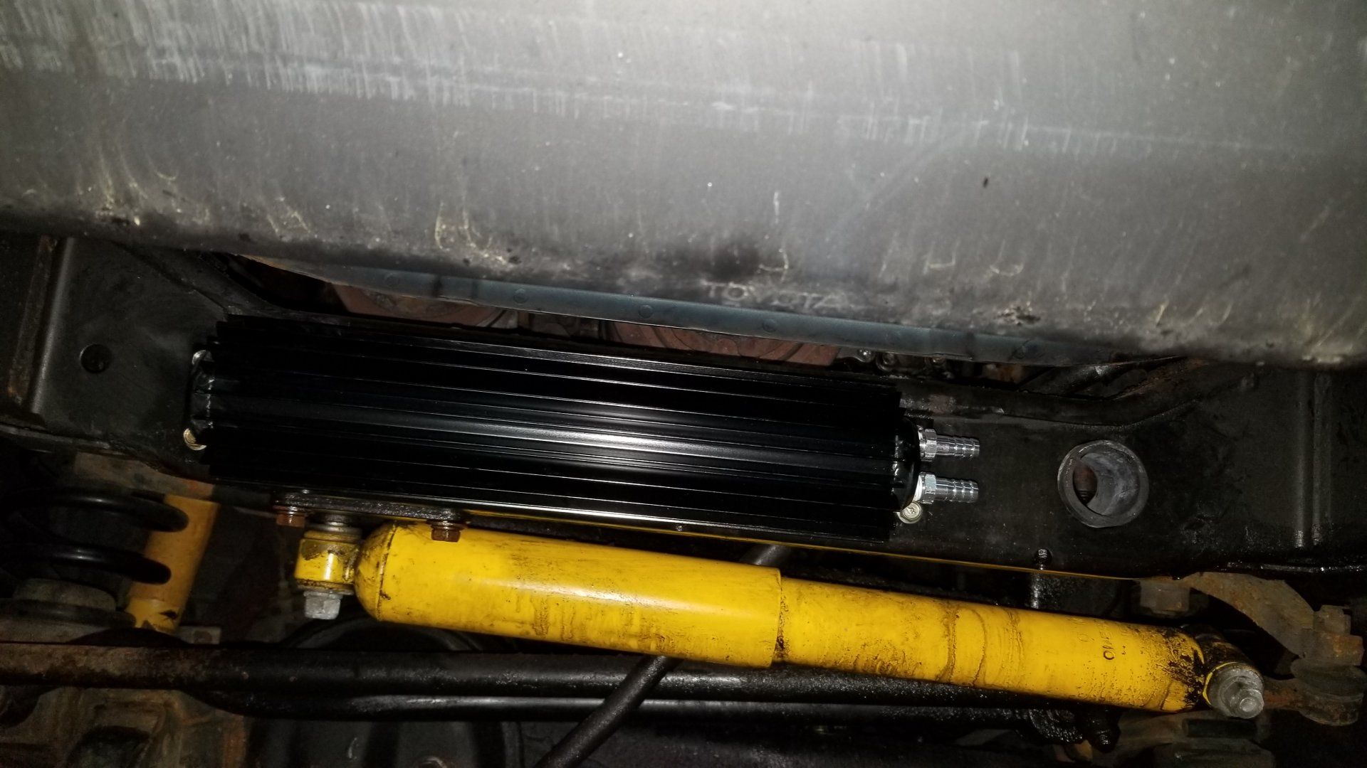

Paperclip PS cooler bit the dust ... inexpensive replacement
Drilled and tapped holes for mounting. Please excuse everything being covered in oil ... at least it isn't rusty underneath.
Mounted
Was going to run some hose through the holes in the cross-member, but scrapped that idea

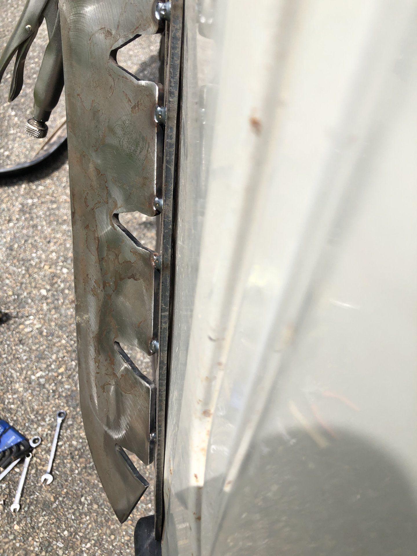

Quick lunch-break test fit today - Off with the old, smashed flare...drilled the rivers to reveal a nice, super clean fender cut by the PO. :hillbilly:
Fit up the new flare - mostly to check it for flatness in relation to the body. I’m mostly happy with it aside from the front leg. Any other gaps will likely be absorbed by the fender welting that will go behind it.
This is the worst of the warp I haven’t been able to bend out so far:
It’s about 1/8”...too much but I think if I mount everything up on 2x4’s with a “gap” in that center section, I’ll be able to pull it down some...I can probably cut a couple tacs as well to help.

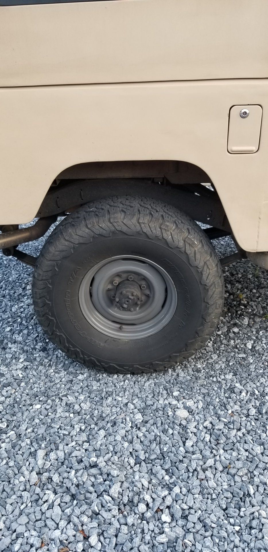

looks good send it.
you should move the rear axle back 3/4" or so., it would look better in the opening.
it's easy enough to do.
looks good send it.
I'm really torn on moving the axle. I know the hardcore wheeler types like the added wheelbase and centered rear tires, but the goal for this truck was always light wheeling under a mostly stock look guise. I assume moving the axle means de-riveting the spring hangers and welding them farther back? Any other options (like flipping the springs or something that are less permanent?
Ultimately some beefier tires might help fill in some of the space as well. I really like these KM3's - but these 7.5R16's (which should measure around 32") actually measure out to about 30.5."

Moving a solid axle a small amount is easy. You have multiple holes in the spring perch that line up with the pin in the leaf pack. Hardly even a 6 pack job.
yeap a new hole in the perch, easy as pie. i forget how much it can actually go, it's a solid 0.75 maybe even a full inch.
i have mine moved back.
Wow that’s incredibly easy. A lift and u-bolt flip are hopefully in my future - that seems like a good time to do that.
I guess that probably doesn’t do anything for shackle angle really, the springs are in the same place, the axle just sits farther back on them? I imagine that changes the shock positioning a bit. Any effect on ride/road manners or is it basically unnoticeable?
Road manners? It's 50 years old. ;)
if anything i would guess it changes(soften) the spring rate, as the load is further from the fixed point....a longer wb takes road bumps better...dont know if an inch longer is enough to make a difference though..
