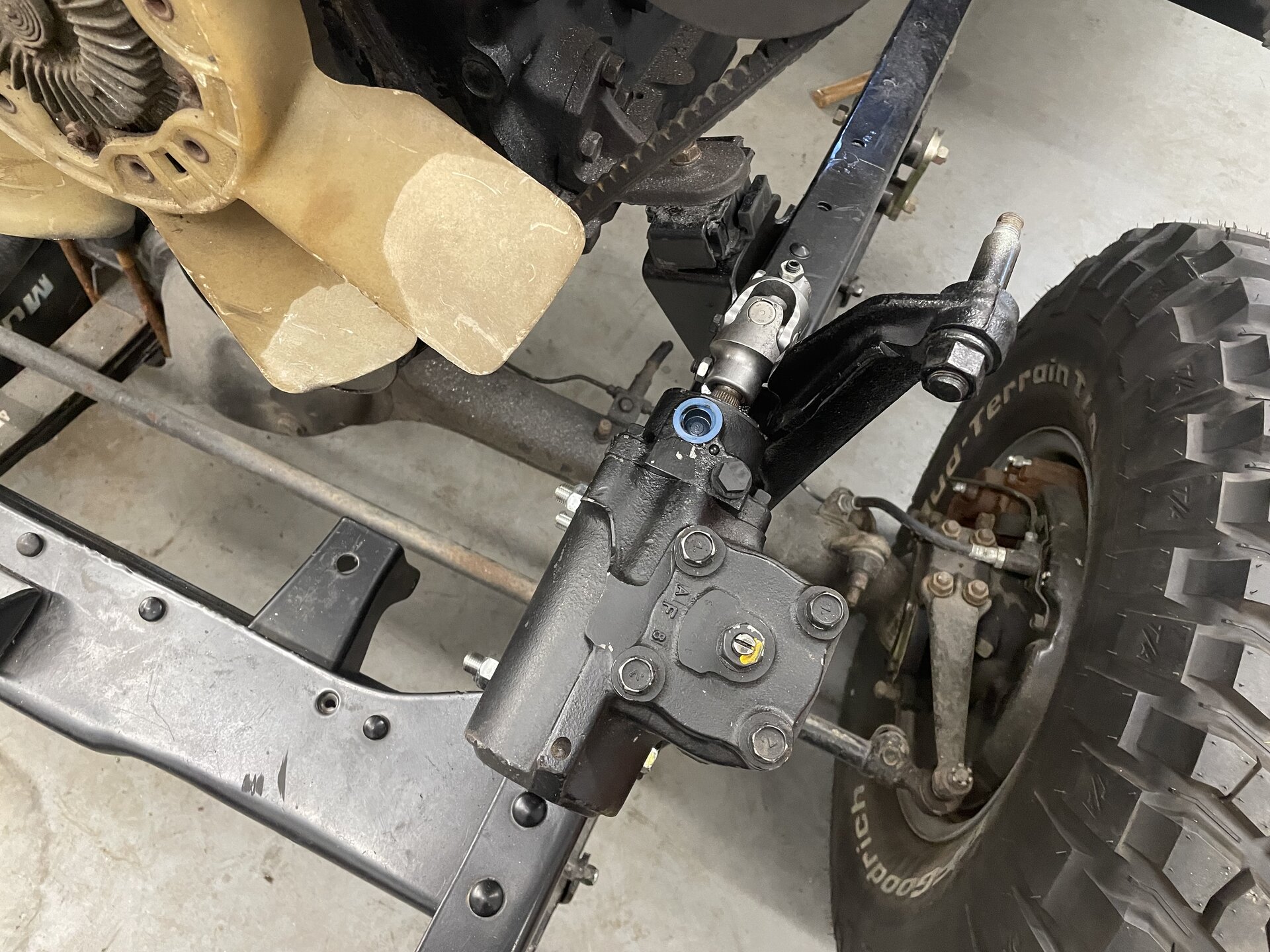

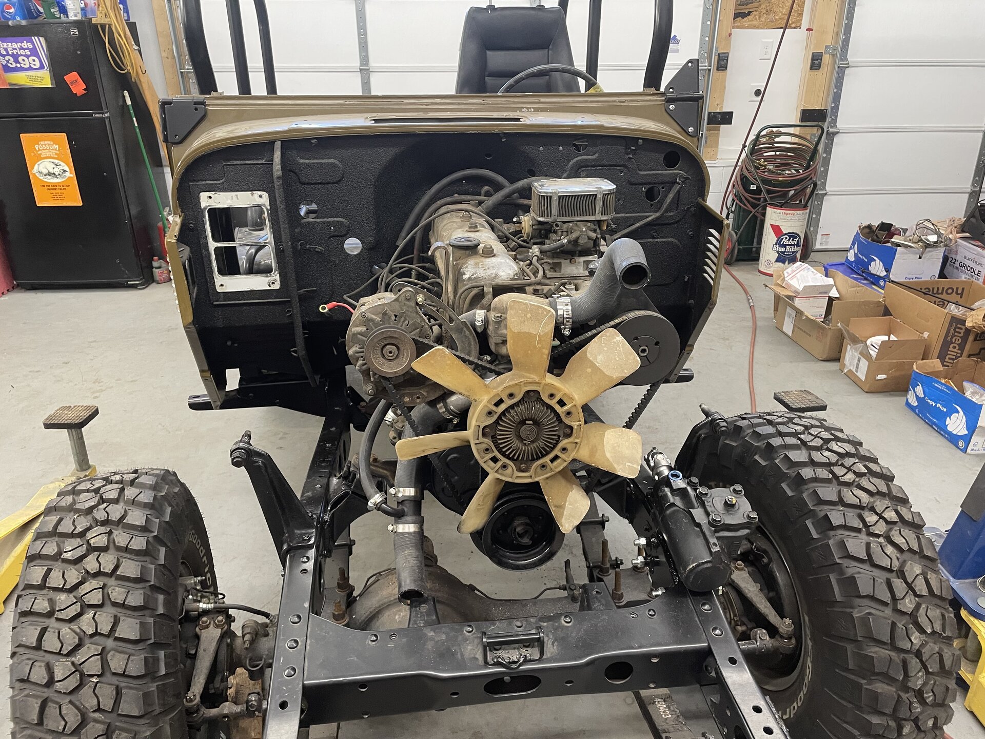

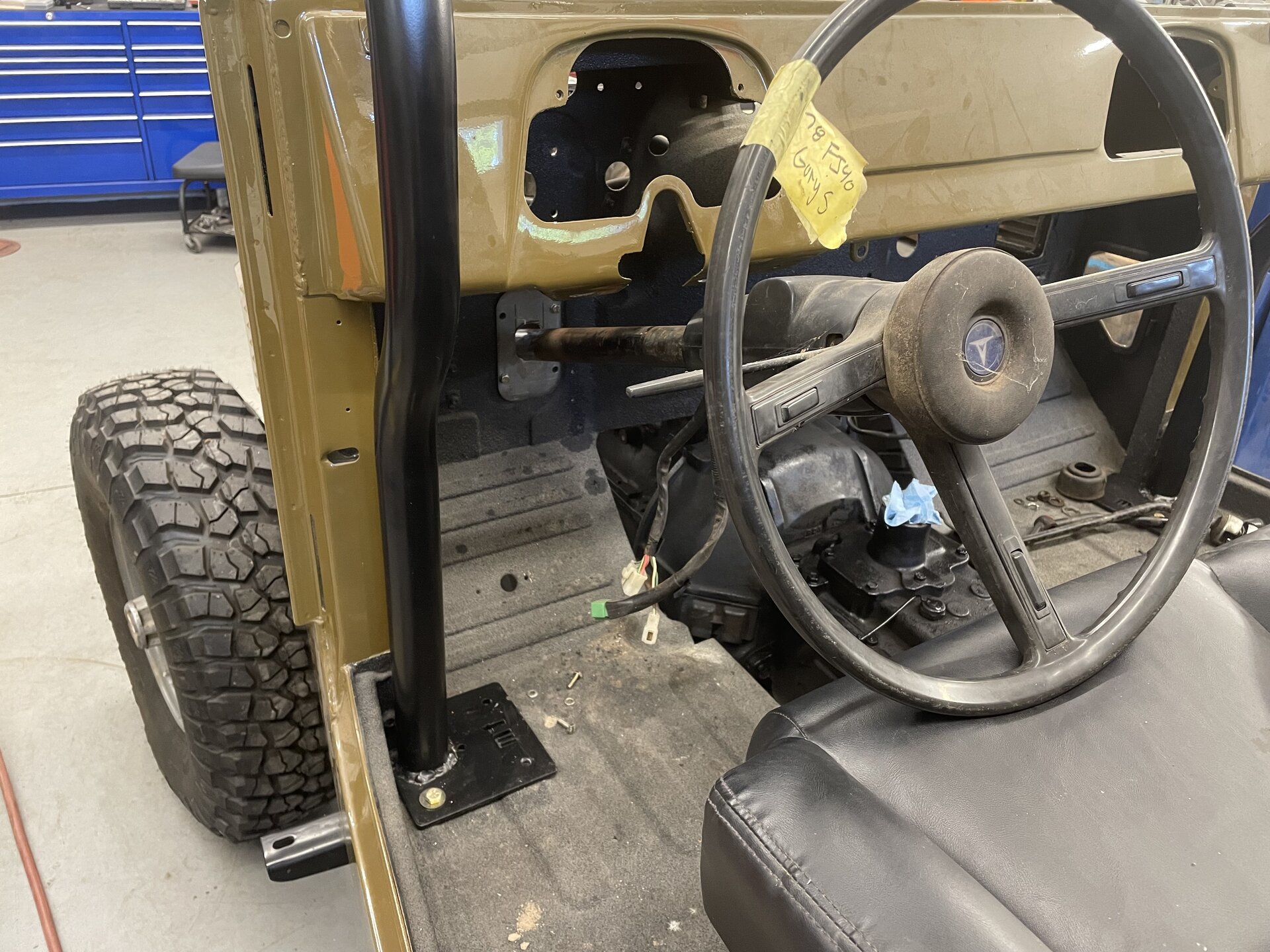

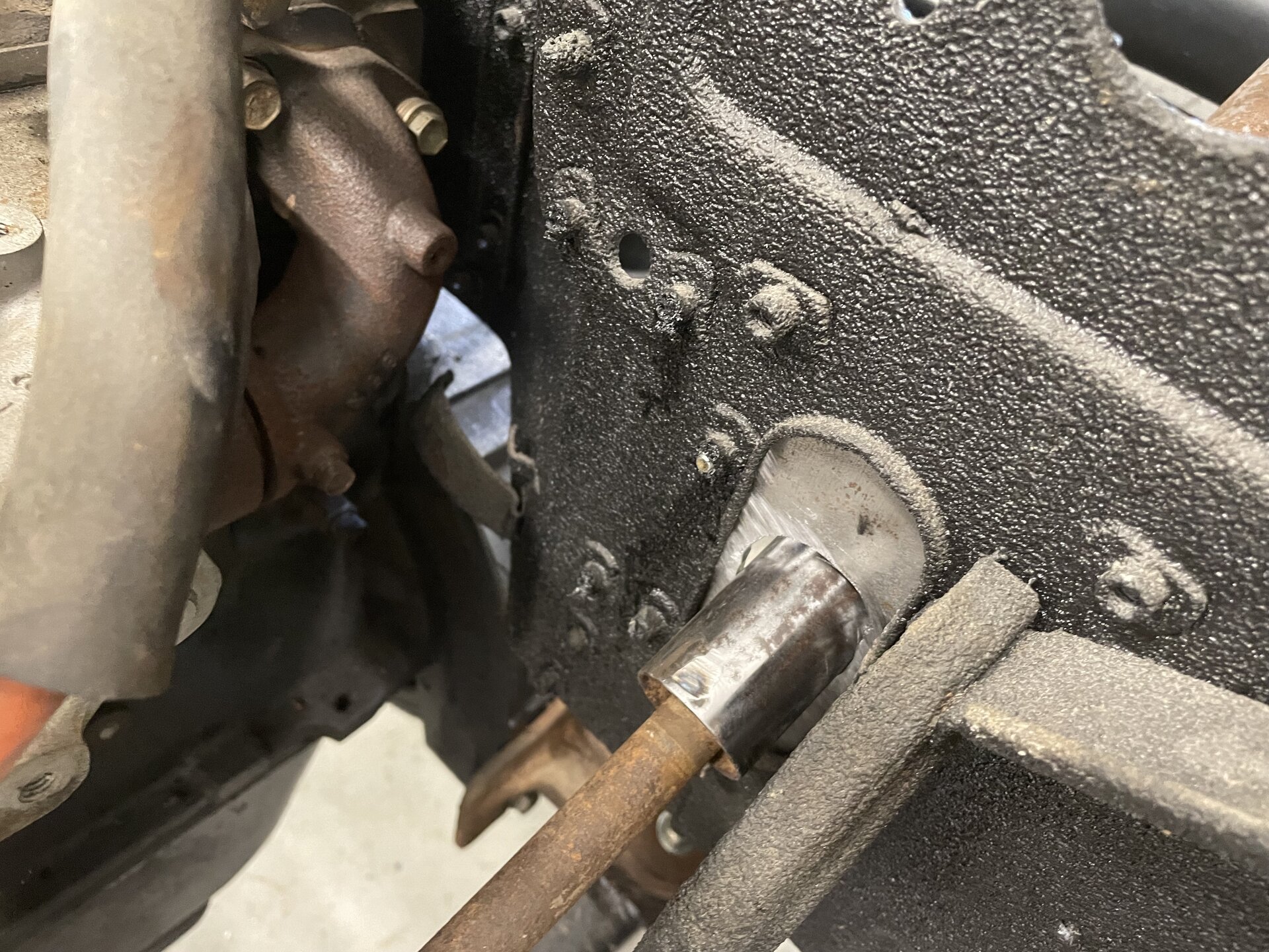

Drivetrain back in, ps box mounted and I worked on modifying a 78 steering column to a 72 firewall. Little bits at a time.
