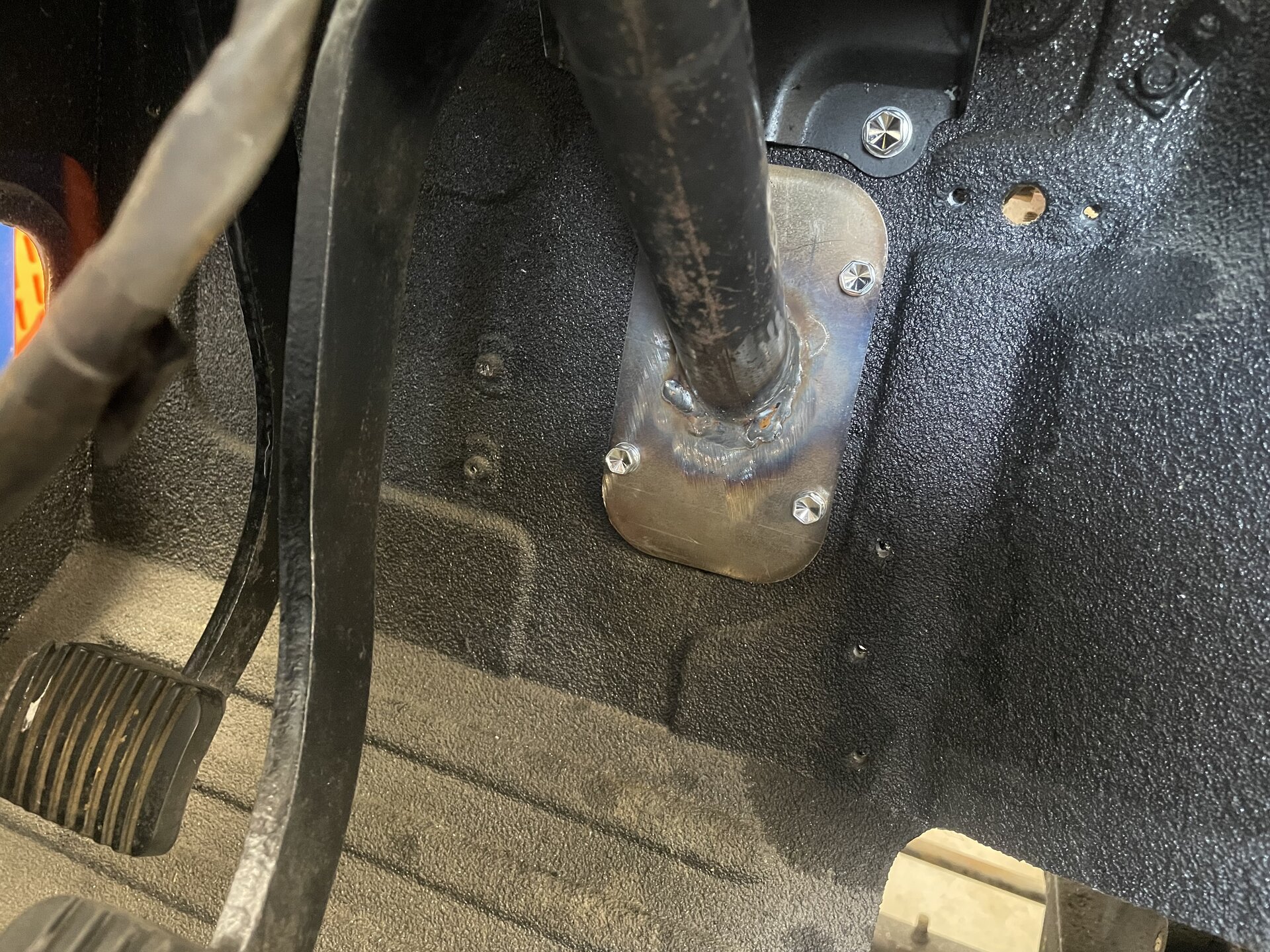

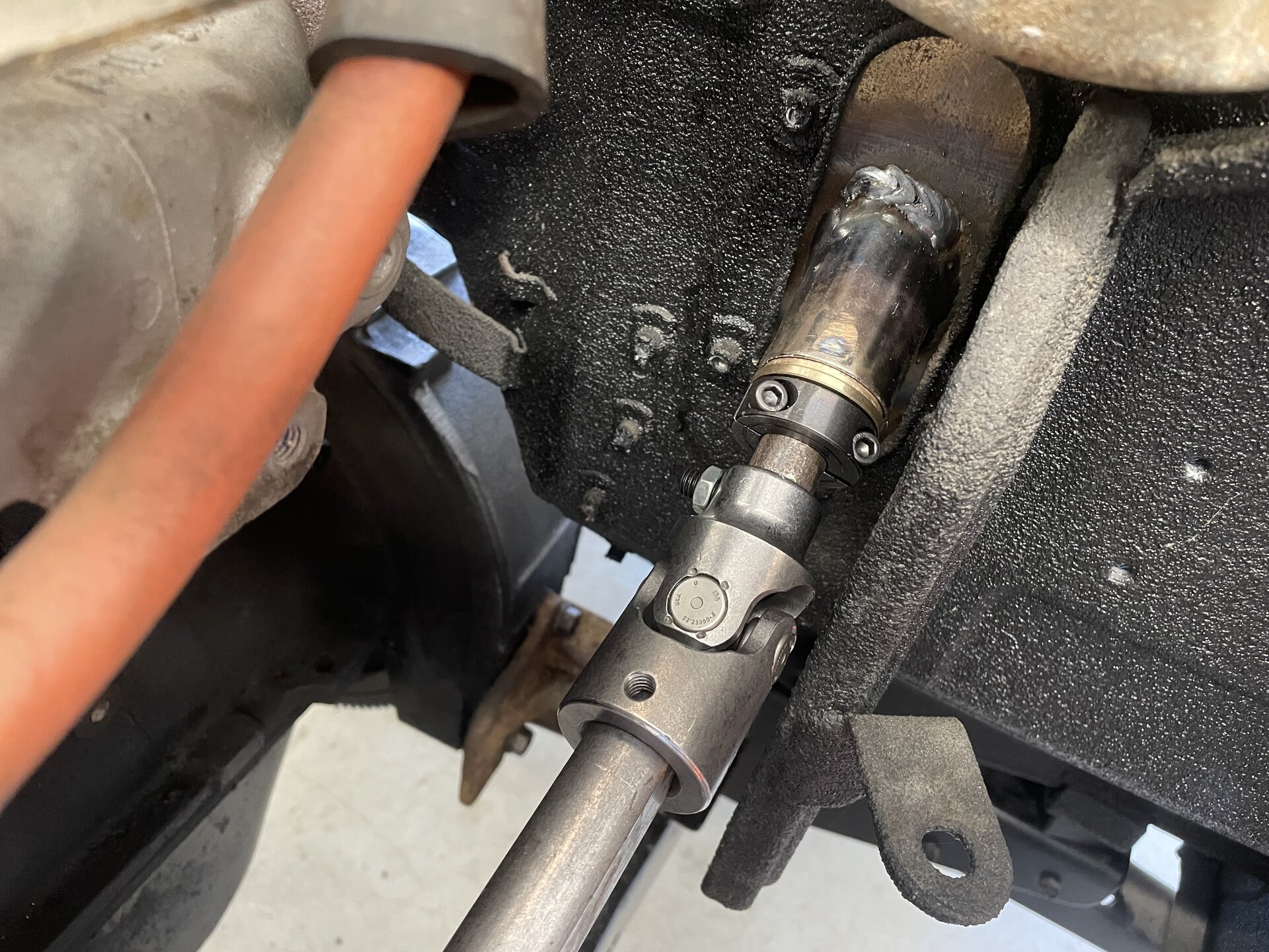

Still plugging along on the 72. Power steering all mocked up. Need to blow apart for paint

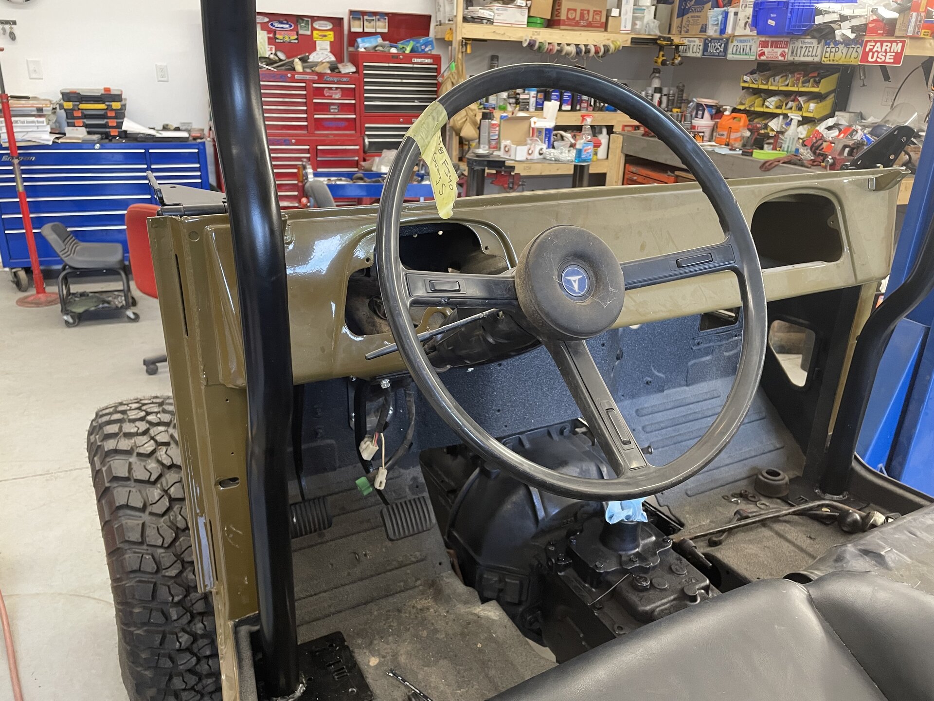

Installed a 78 column in a 72 body. With a 60 series box. A little cut and paste to get it to work.

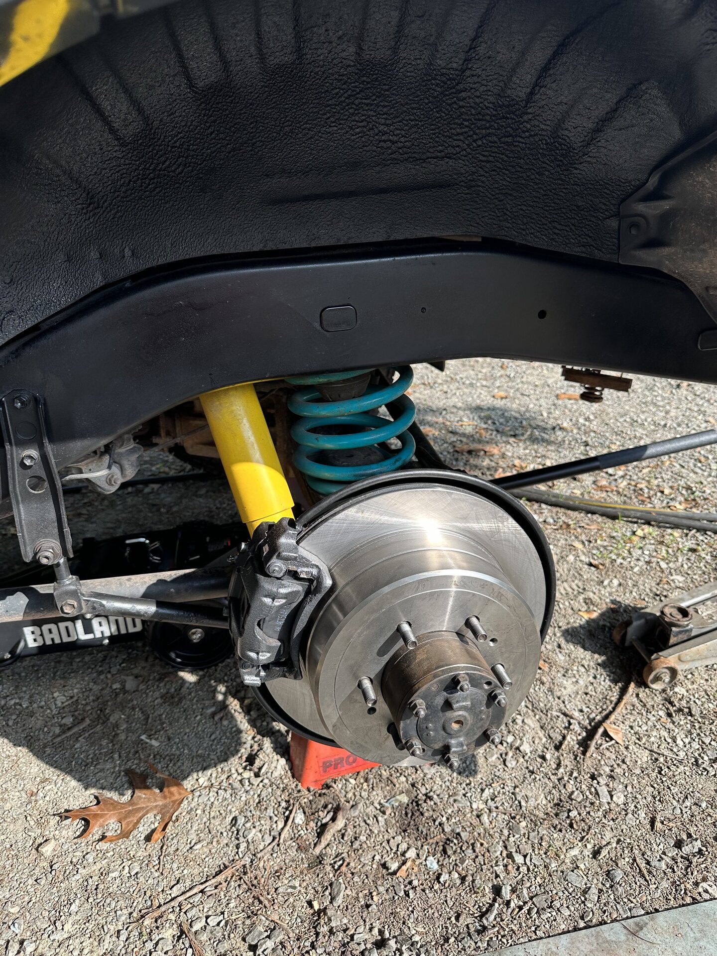

Was able to wrap up the driver side rear wheel bearings and brakes today. Went ahead cleaned and painted some parts so took a little longer than anticipated but looks way better. Had the brake parts sitting on the shelf for a year now so it was time to install them.

The before:
The after:

Look great dude! Yeah the story of my life. Something that should only take an hour turns in to 4 because I start cleaning and painting.....
oh tell me about that badlands jack. I see it has some bigger wheels on it. Motor sports kit??

Just picked it up because I got tired of using my other jack with blocks, to jack up the axle. Comes with those tires and height attachment. Since a fair amount of the wrenching I do is on a gravel drive way, because my garage is a storage unit, I thought it would be better than the typical floor jack.

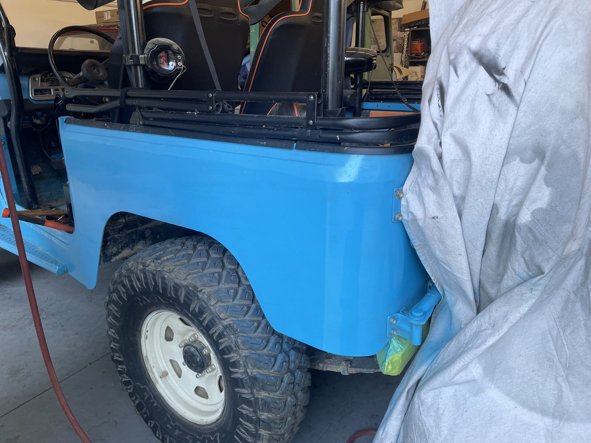

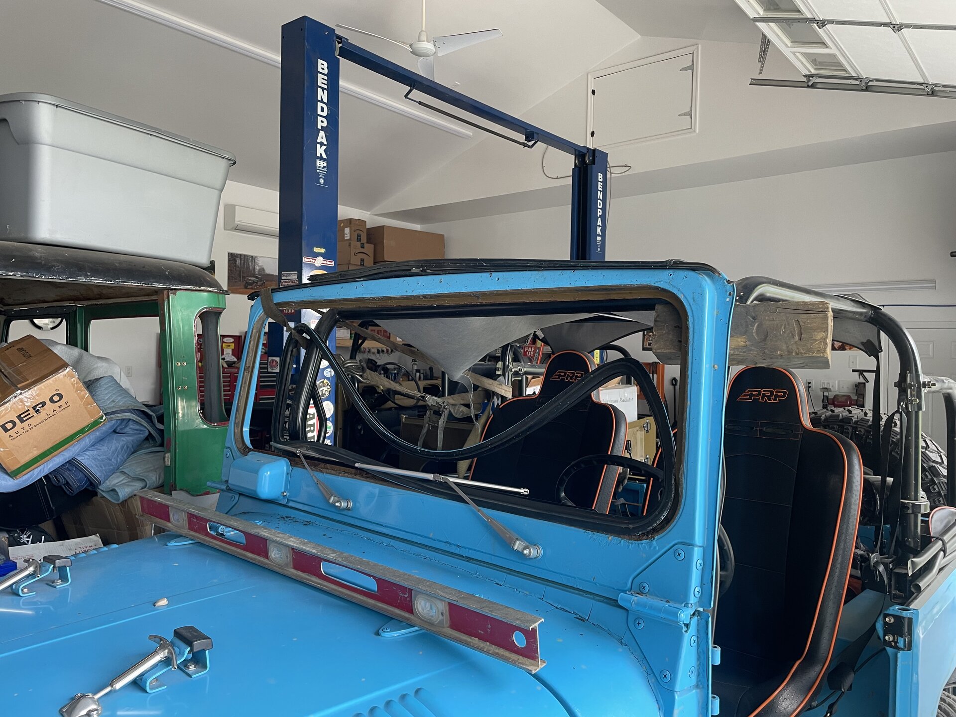

I slid into a tree in WV and messed up my top and windshield. I was able to pop the glass out and wheel the rest of the weekemd. After a quick wash pulled it into the shop and tweaked the frame straight. Now need to get a piece of glass and I will be back in the game.
