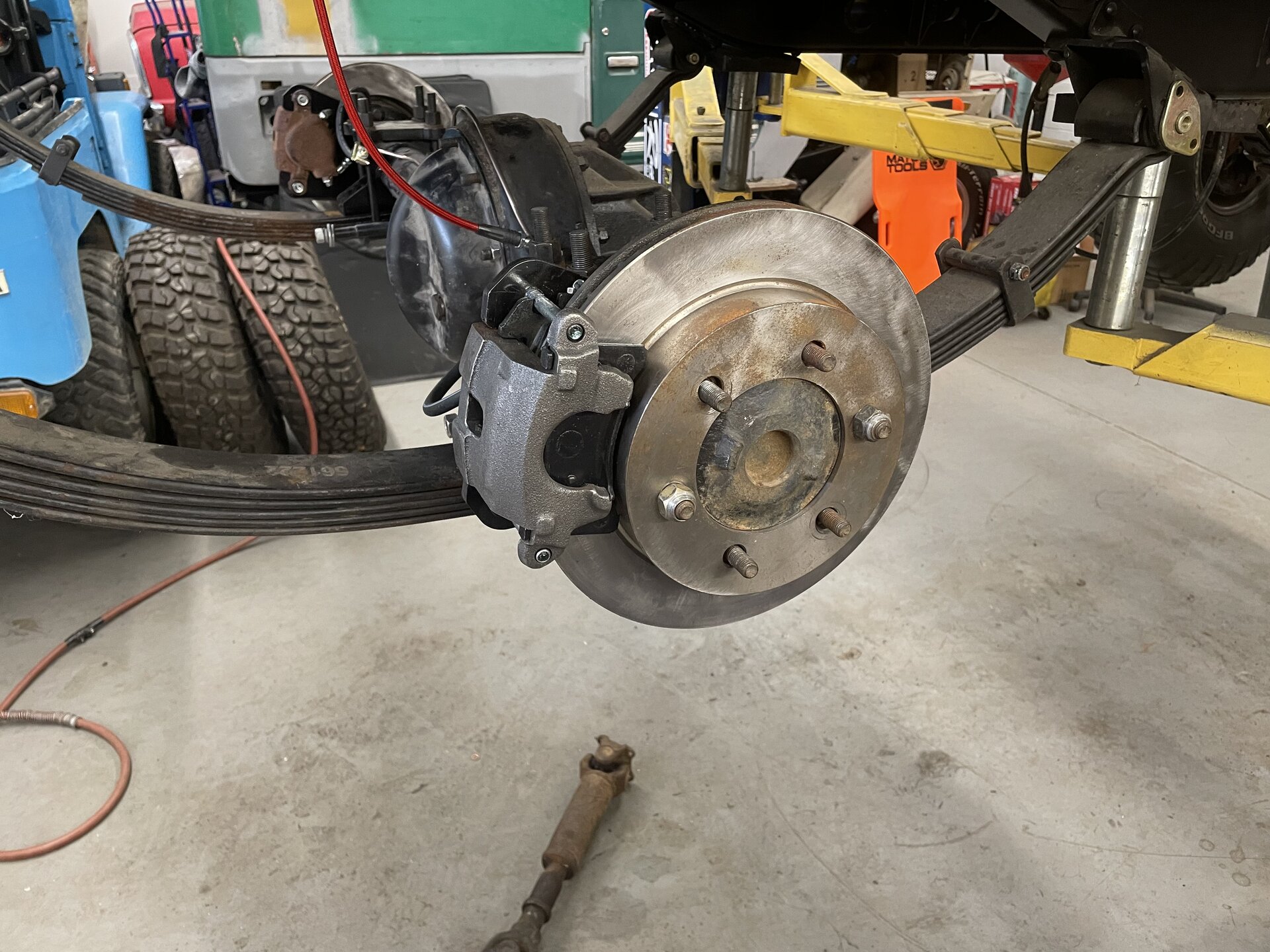

I got some stuff painted on the 72 as well, still slow progress...

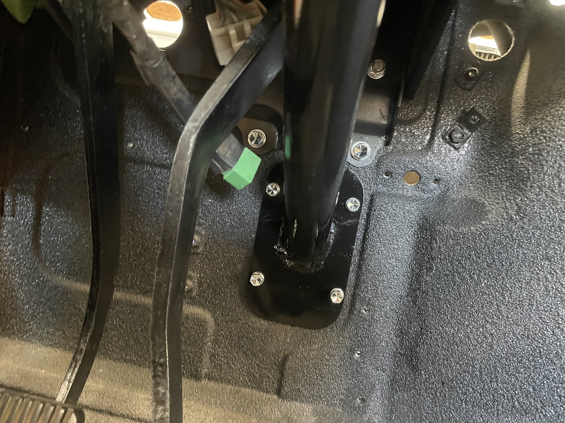

Waiting on couple parts to get here, turbosmart boost controller, new power steering fluid reservoir and 200 series airfilter. Turbosmart is to help me with tuning my hdj81. I've got it tuned for safe EGT'S but next is fine tuning to AFR. After GSMTR noticed leak at power steering reservoir. Then with the dusty conditions at GSMTR figured it won't hurt to replace my airfilter in my PDI airbox. This coming weekend I hope to install kilmat around my shift console and front floor board. My left foot gets hot on long trips (my exhaust runs on inside of frame rail).

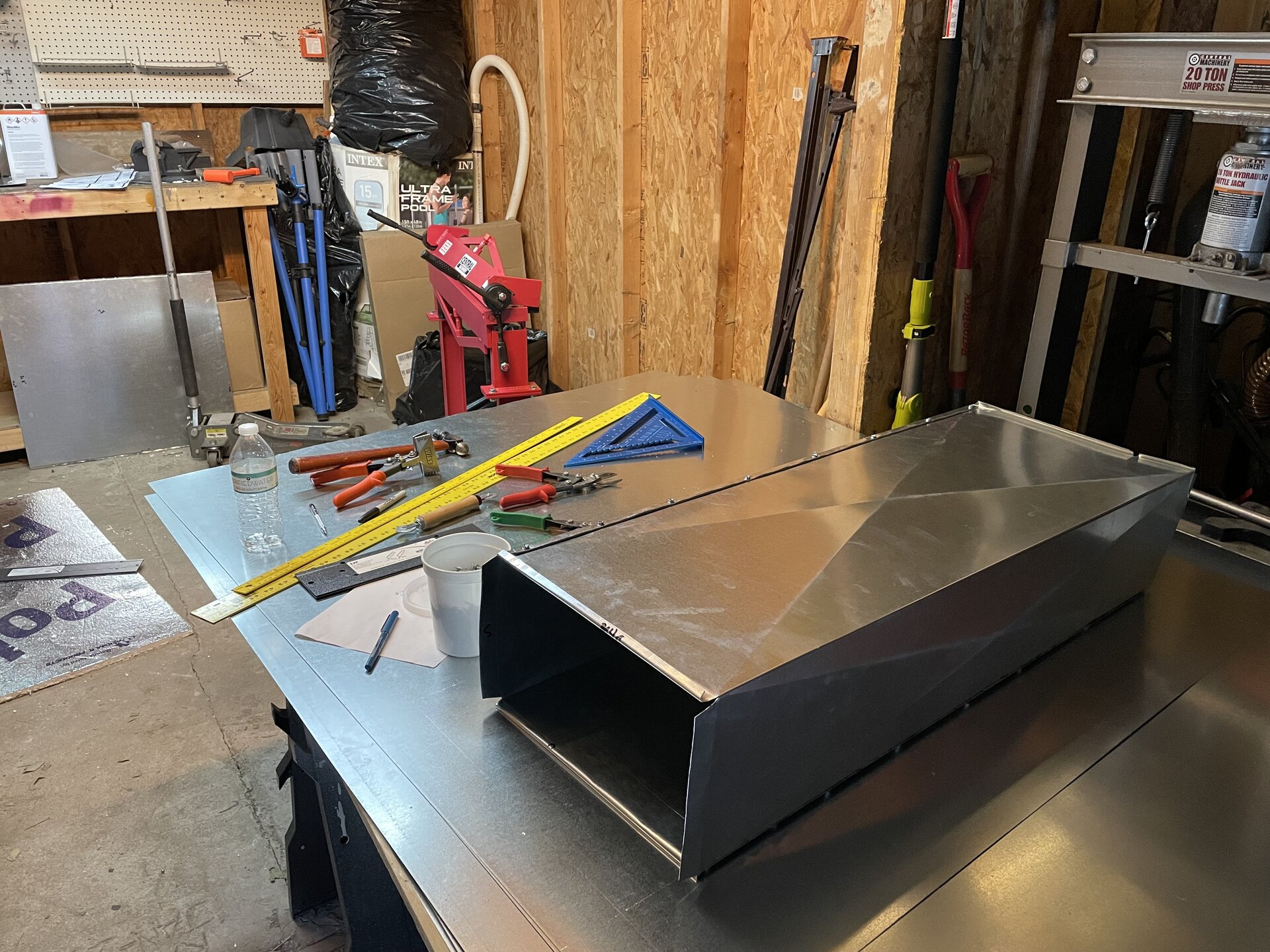

Built some ductwork to wrap things up before drywall Monday. Slowly getting there with some help from my friends

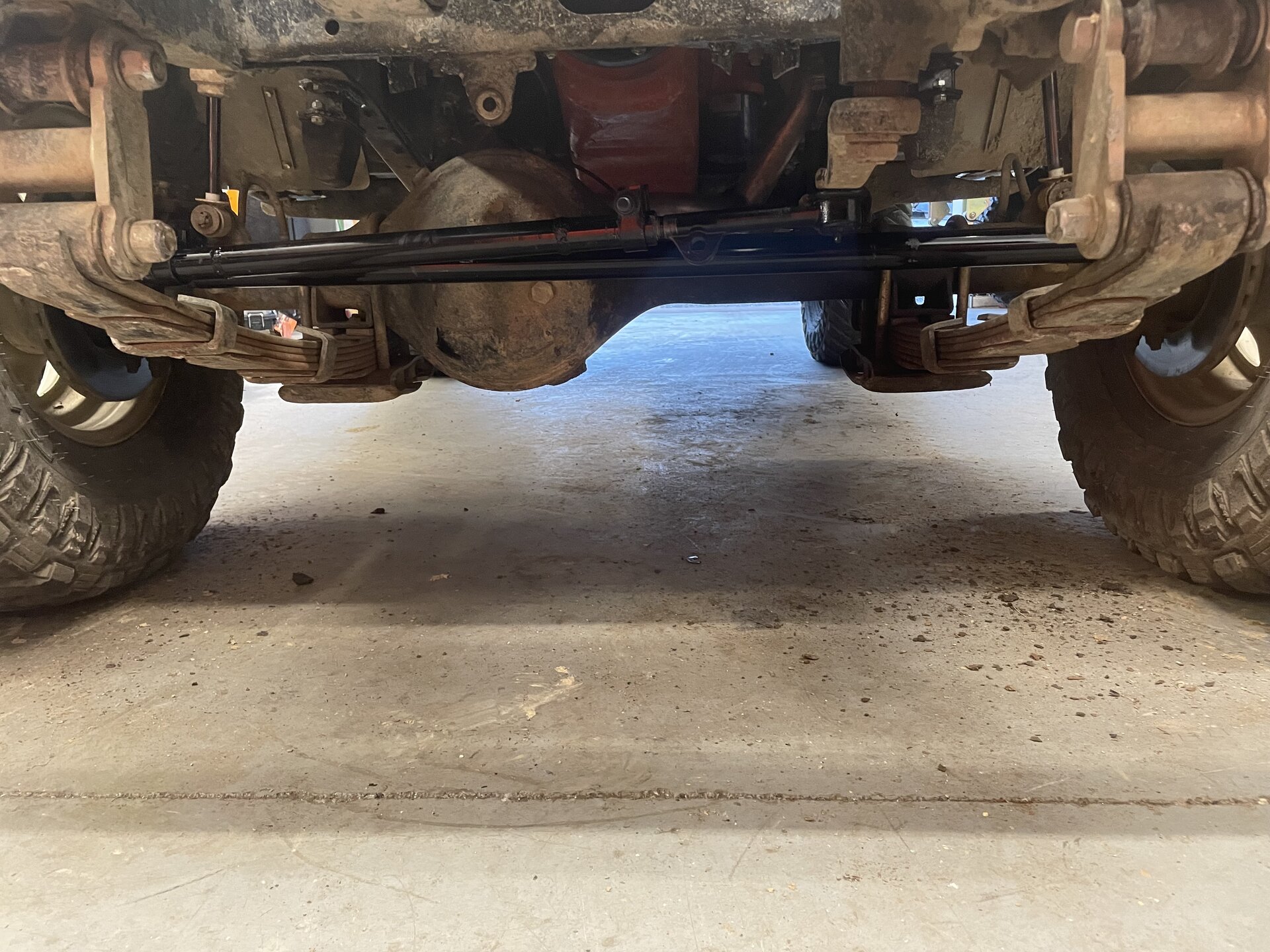

More prep for SAS. I decided to rebuild my steering linkage. 1 1/2. .250 wall DOM and 1 1/4 .250 wall. A miz of 21mm and 23mm tie rods for mini truck and 60 series
