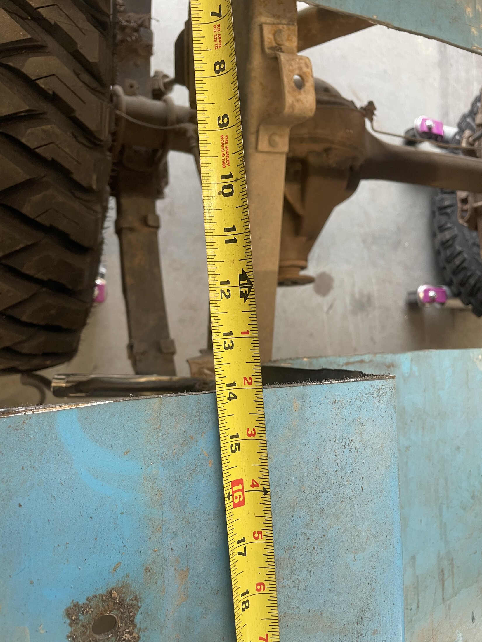

Thats one way to stretch it. 10"?Man behind the curtain

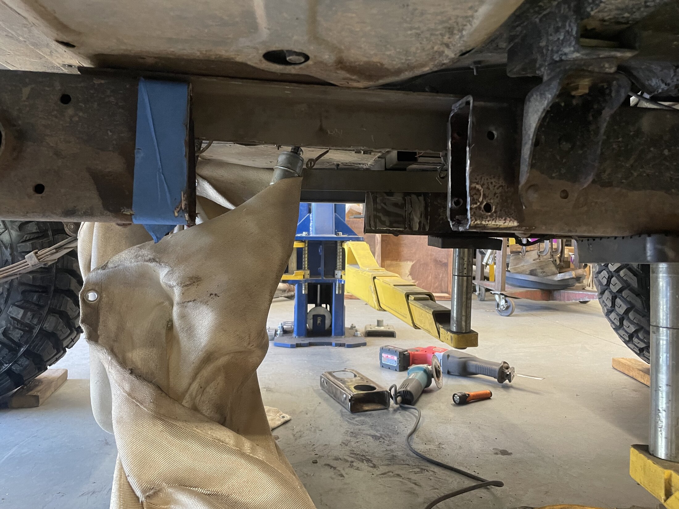

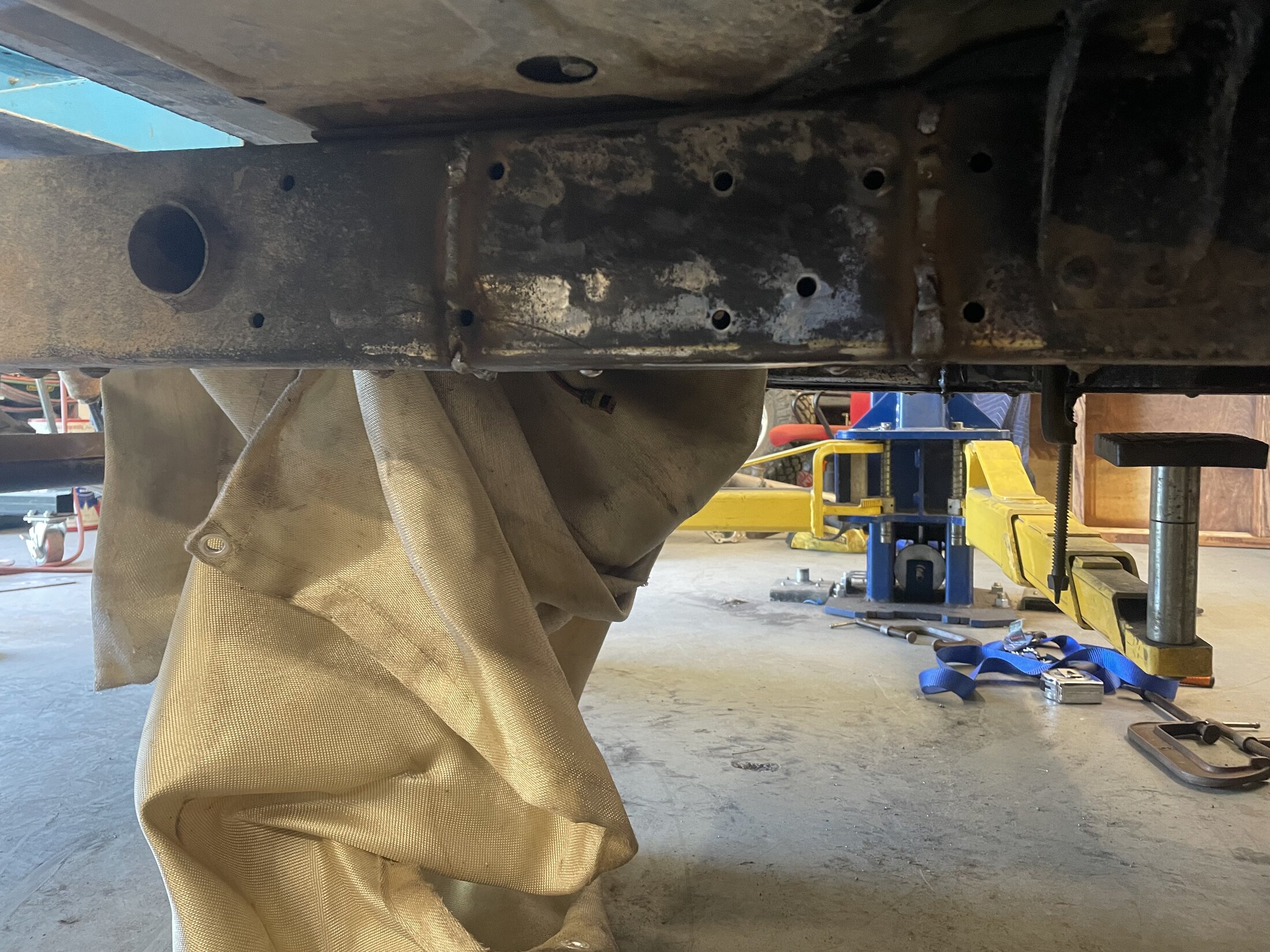

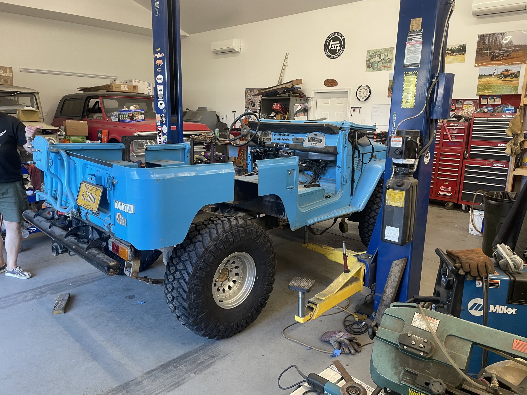

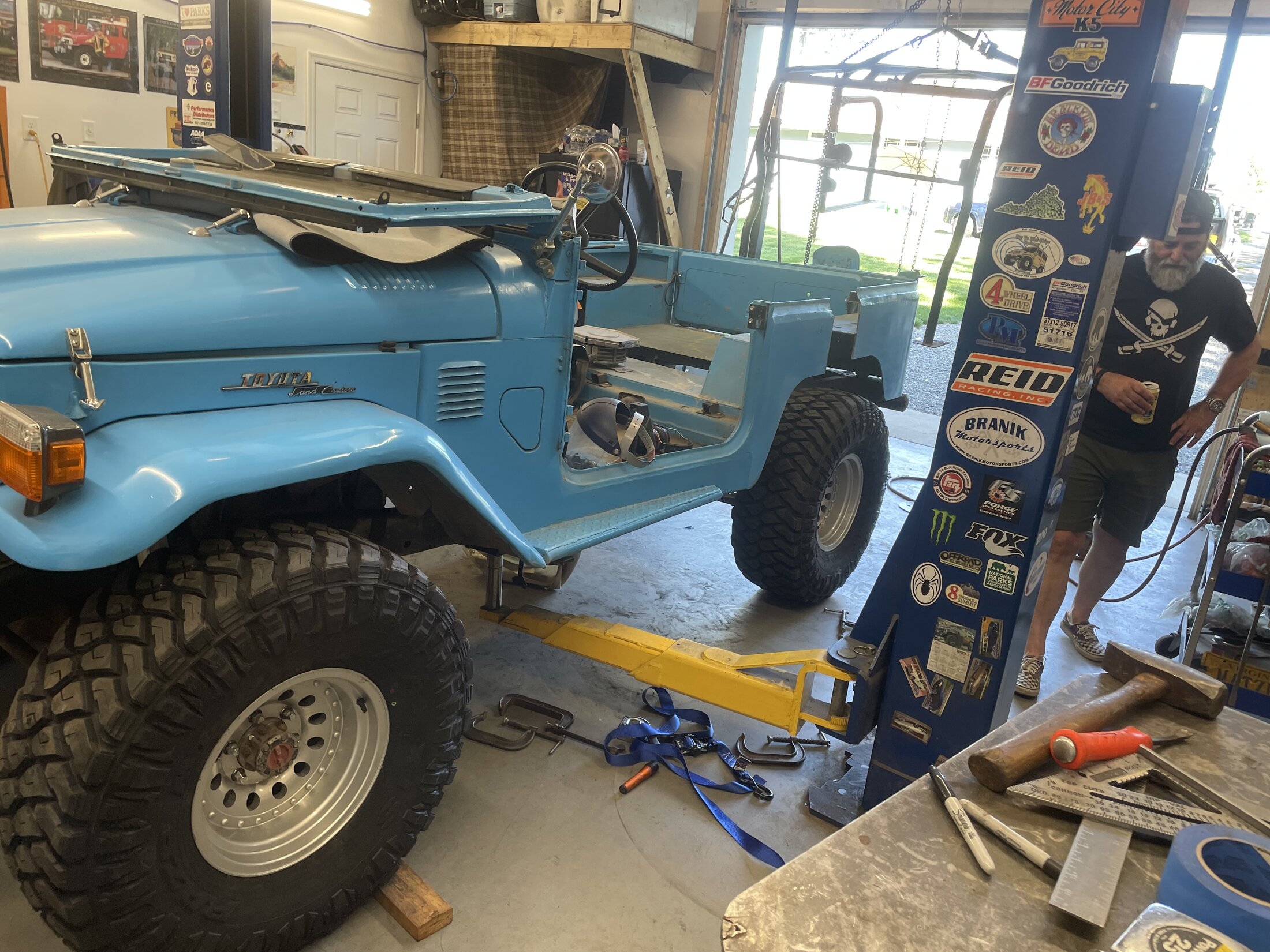

With the help of @Land Shark I did a little cutting. A lot of measuring and a little welding today.
Yep. Just like my other one.Thats one way to stretch it. 10"?

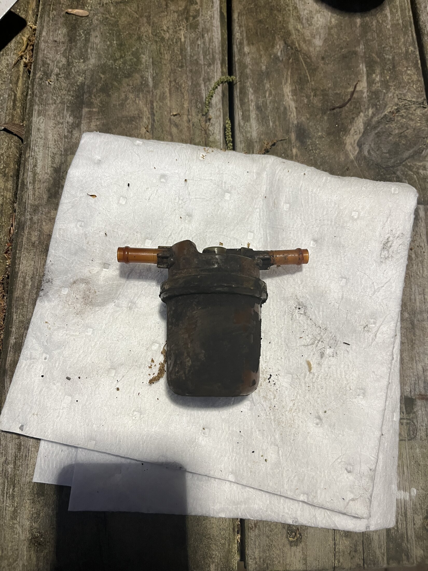

Great to have a nice win like that everyone once in a while. See how easy it is!! @davidp14Changed Retro’s fuel filter. Was having loss of power and stuttering test drive was good all “peppy” againView attachment 3896258
To be fair my fuel filter is super easy to get to. like waaaaaaaaaaay easierGreat to have a nice win like that everyone once in a while. See how easy it is!! @davidp14

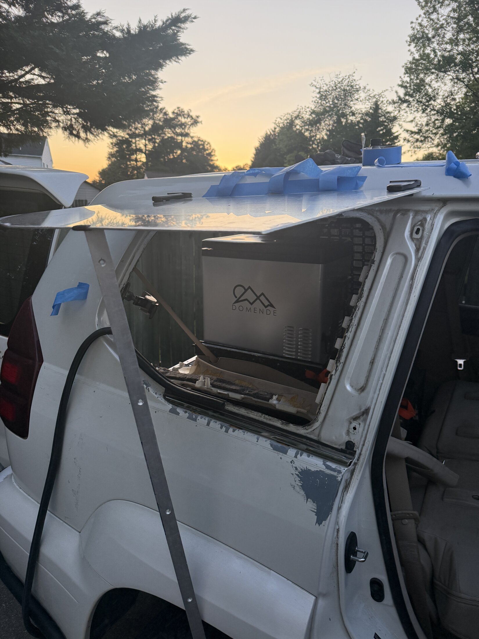

No wayyyy!! Super cool can't wait to see itBeen wanting to do gullwings on the gx for a long time and will make sure they’re done before Potts incase I need to grab my recovery gear again.

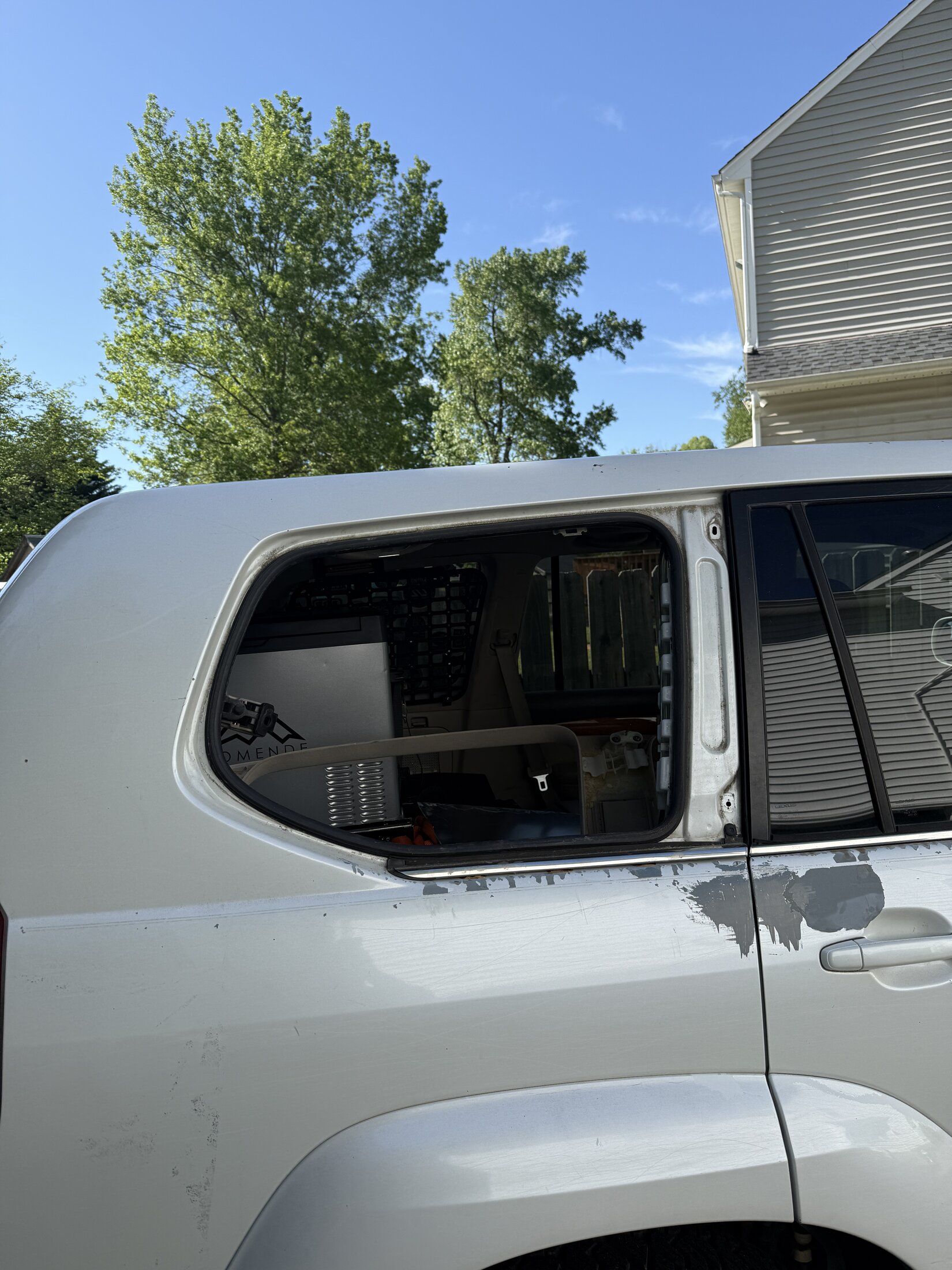

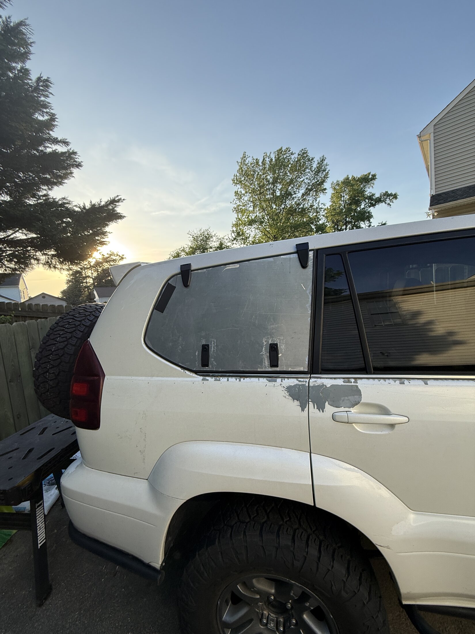

The white!?! Looks niceGot off early and slammed these on
Yes sirThe white!?! Looks nice
Top looks good! I had welded in some angle bar and huge barrel hinges on my rear gate so it folds in half even with my sides in my case.Made a road trip down to NC and picked up a BJ44 hard top for "one" of my stretched 40's.

If you're not done with frame alignment, I'd like to see how you do that
Oh man!!
Straight edges, ratchet straps, go-jacks, tape, and a lot of head scratchin! It is all butt welded but will have fish plates on all the seamsIf you're not done with frame alignment, I'd like to see how you do that
