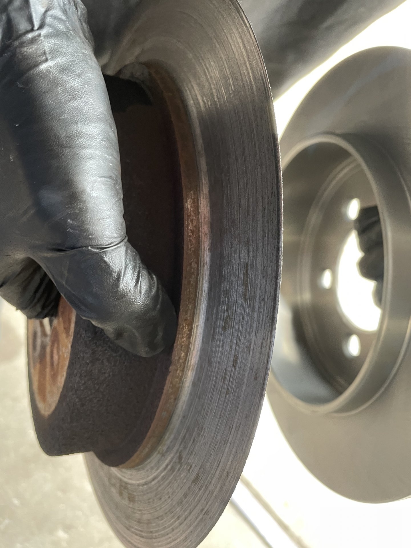

Customer complained of brake noise...
Normally they break before getting that thin but yes this one is special :)
I always thought those photos you see on the internet with brake rotors were spoofs until I found this on a neighbor's car when I took it apart...
She had also complained that her brakes were noisy...

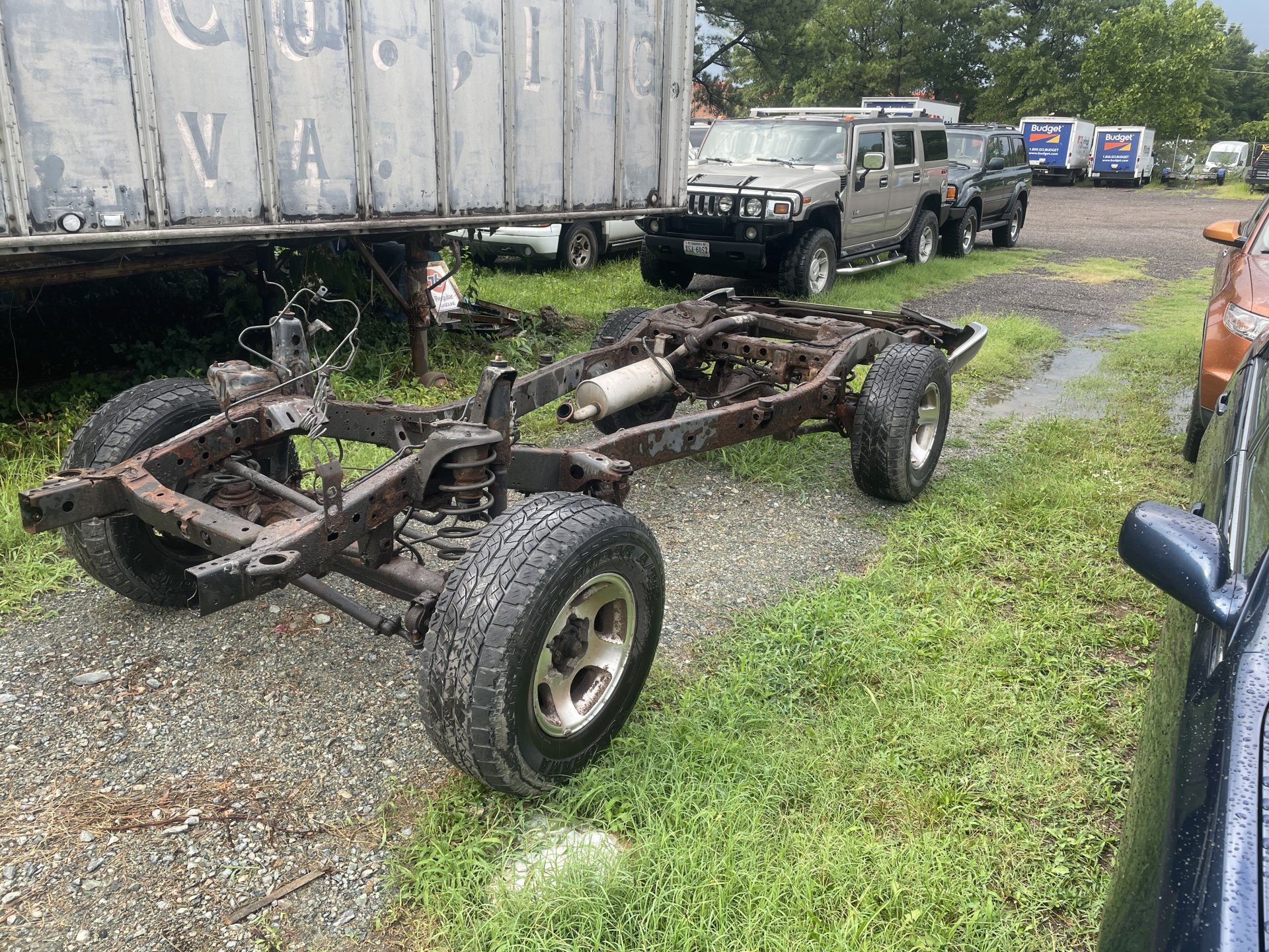

Pulled the drivetrain out of my parts truck. Anyone local need 80 body parts let me know. I am about to let most of it go with the axles!

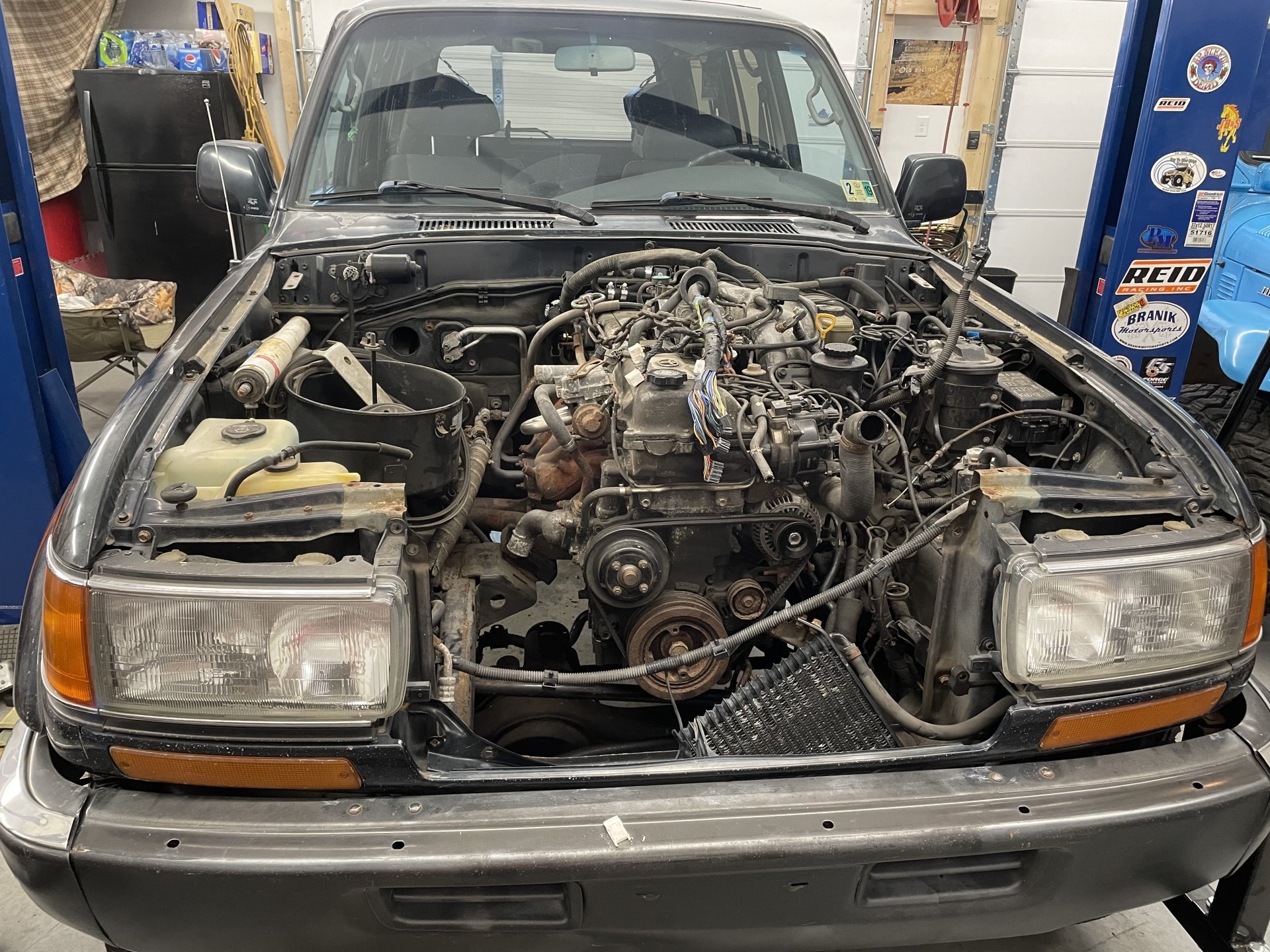

Much easier to reseal oil pans with the engine out. I also have a lot of good parts to put on when the engine goes back in.
And it is in!
I replaced all the heater hoses and valve at the firewall before putting engine back in. They shorted me one hose😡. At least I can get to it easily with engine in.
Did I mention this is going to be for sale????😎
Finally getting back on this after stripping down the donor truck. Looks like something!

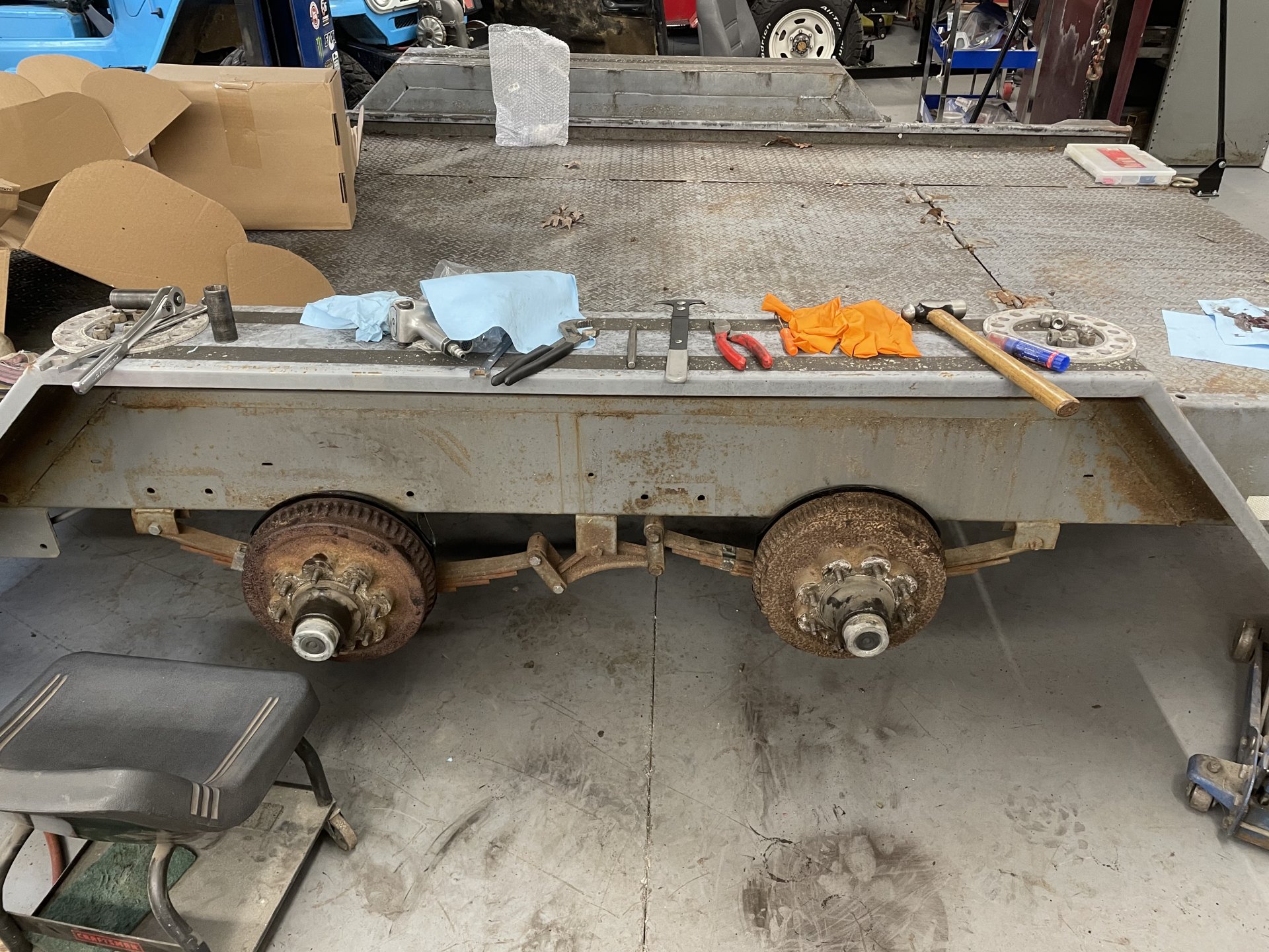

I took advantage of the heat and humidity and installed new brakes on my small trailer, repacked bearings and installed new seals. Man I love the A/C in my shop.
Why yes, those are 8 lug!
I keep telling people to buy the extra wide lifts. This is why, trailer fits between post and extra room to open doors. Trailer fits well below a car too.

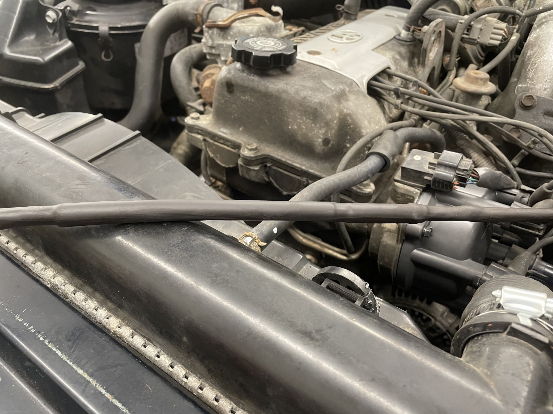

A little trick if you have a cable that the sheath is coming off. Use a long piece of heat shrink to cover the exposed metal. I bought a 4 foot piece off Amazon.
