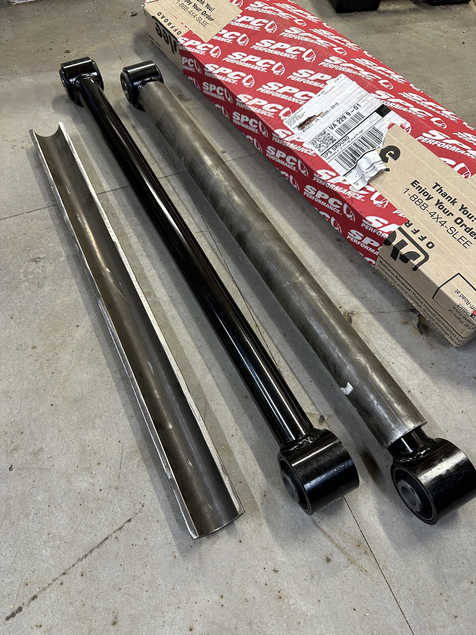

Well at relic run I put a slightish bend in a rear lower control arm. Was on my mind to reinforce the RLCA but hadnt gotten around to it. Today I picked up a piece of 1/4wall DOM and cut it in half to weld to a new set of SPC links for the 80. Have a couple dance recitals and a “May the 4th” party to host this weekend but hoping to find the time to get them on.

On to some pics of the mock up.
If you do plan out the night you work on this post it up I would be interested in watching you weld it up. Also planning to do a rear swing out and would like to talk about it with you after your recent experience. Already have the swing out part just have to weld the spindle to the bumper and figure out the latching system.
