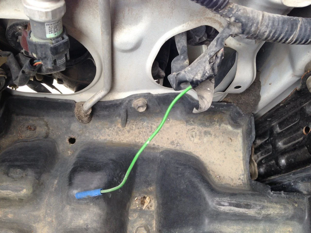

Began the engine removal process and discovered a couple of loose ends. What do these go to? The first one is a green wire with a blue bullet behind the drivers headlamp and the second one is a loose gray connector to the right of the oil filter. Thanks!
That green wire definitely doesn't look 20 years old...
Green wires (green yellow, green black, green red, etc.) in the headlight area are signal bulb wires switched to hazard or turn signal in a 96 fzj80...look for a plug on the engine block for the dangling connector I don't recall which one it is but there are a couple in that area...also given that connector if attached to a loom (hard to tell from pic but I think we're talkin the same) can't reach further than the wire so it's around there somewhere it that makes sense. On a separate note that connector looks strangely clean and brand new. Hope that helps good luck.
There's a fog lamp switch on the dash, but no fog lamps. Don't know if that's related or not. Also, can tell a brake controller was removed.

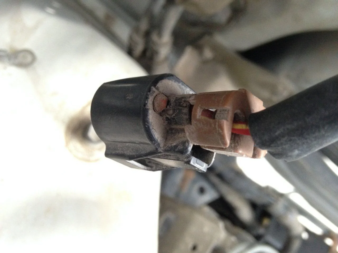

Here's a couple of better pics of the gray plug I'm wondering about:

Also, this plug is hanging out above the driver's kick panel. What does it go to?
Thank you! That's it right above the oil filter slightly to the right. I wonder what sensor that is and why it was disconnected?
There is two knock sensors in that area. But those are in the block.... Can't recall what those other sensors are.
