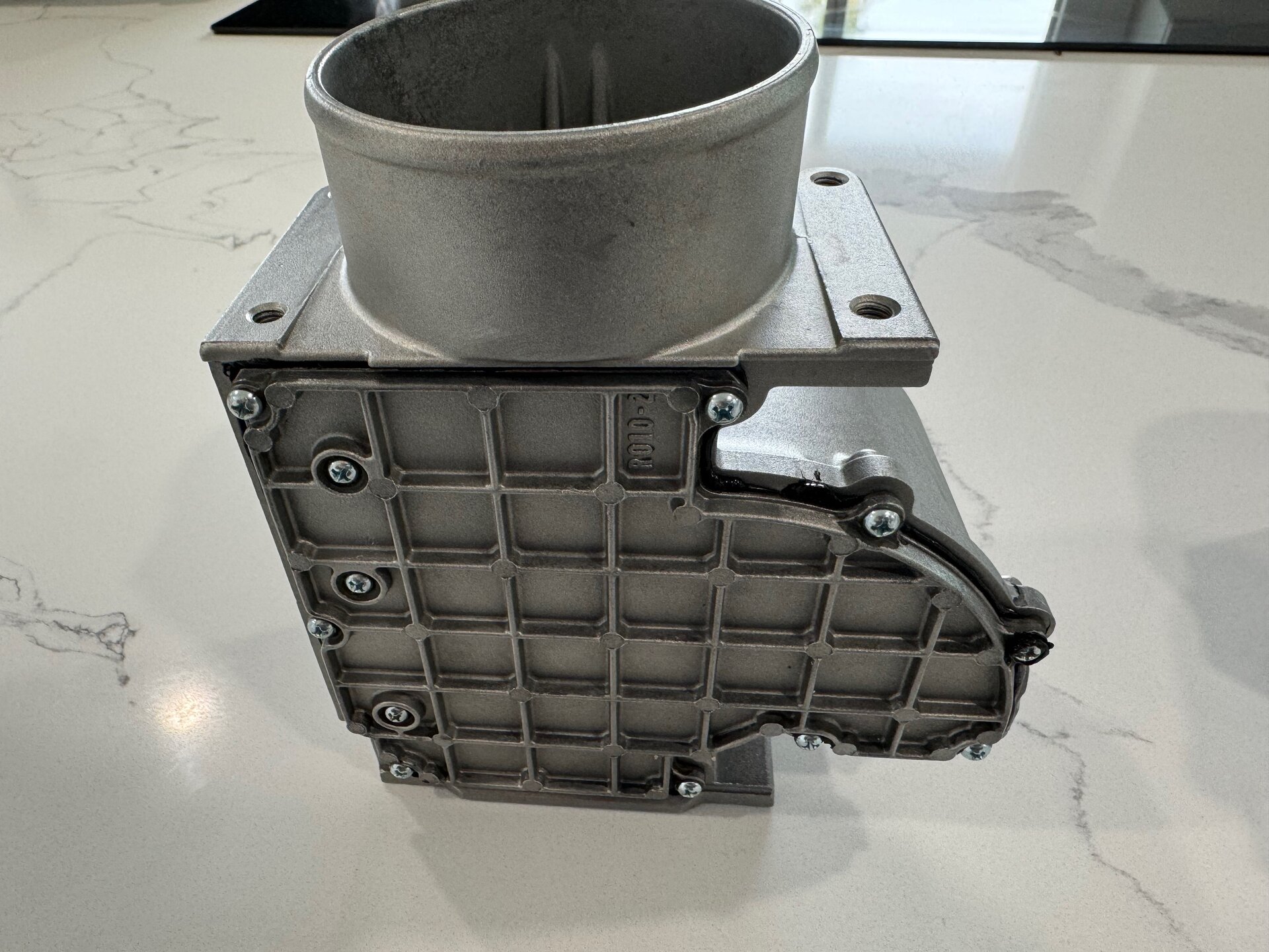

Ordered two VAFs from ebay for my '94. One of them is chinese new part and the other is supposed to be (and seems to be) remanufactured OEM. Next to each other they are obviously different. Each was $99. Not sure the best way to test them off the truck, but my plan is to use one of them while the original factory one currently on the truck gets sent out for a rebuild or whatever. Thought folks might want to see what the two primary ebay options look like. Some photos:
It's basically some potentiometers that are adjusted by the barn door.
I have a pdf somewhere of a troubleshooting guide for a bosch VAF on a Digifant2 volkswagen cabriolet and similar. It gave an idea of what the resistance should be between different positions on the connector through some positions. These would be different for each application.
Regarding "use a bmw one" there may well be a bmw VAF that will bolt on but you can be sure it will behave differently. There have been a lot of guys who turbocharged old 1.8L volkswagens who 'fixed' their lean running condition by swapping on a VAF from a BMW with a somewhat larger engine, which caused those cars to run rich instead. Some people's children, right?
But another concern with an aftermarket part would be whether the spring resistance on the barn door is - whether it moves the same for the same air as the original.
