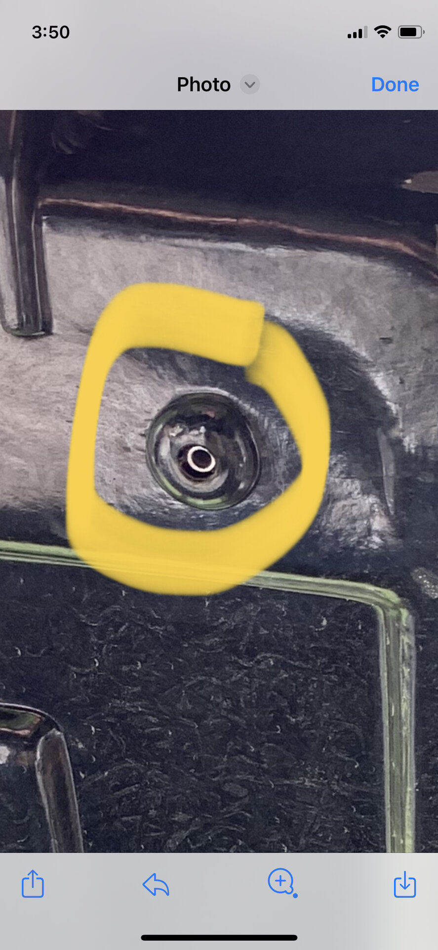

There is holes towards the back of of the sunroof tray that have rivets or something up inside them that were leaking on mine. I used some windshield urethane to seal them up.

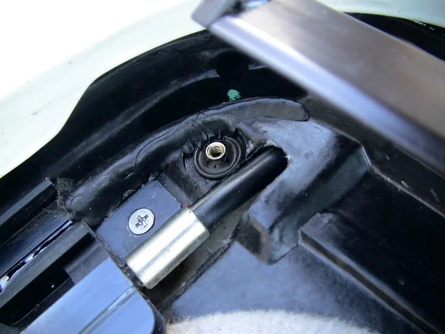

There are also two cable covers, front corners of the sunroof assembly held in place by one screw each. Water can work it's way from the drain pan (if overfull) to those screws and down past the screw threads. Fix is to put a dam (wall) of butyl rubber (Window Weld ribbon sealer) under the cable covers and use a thread sealant (or a dab of the butyl rubber under the screw heads) before installing them. The cable covers themselves can get warped which makes it more difficult to seal them up so you can attempt to flatten them out using a heat gun carefully.
First photo shows cable cover removed (note open screw hole) and the "dam" of butyl rubber I added:
Bottom photo shows the buyl rubber squeezing out after reinstalling the left cable cover. The front left drain hole is to the lower left in the photo (not visible), note how close the edge of the cover is to where the water runs toward the drain:
