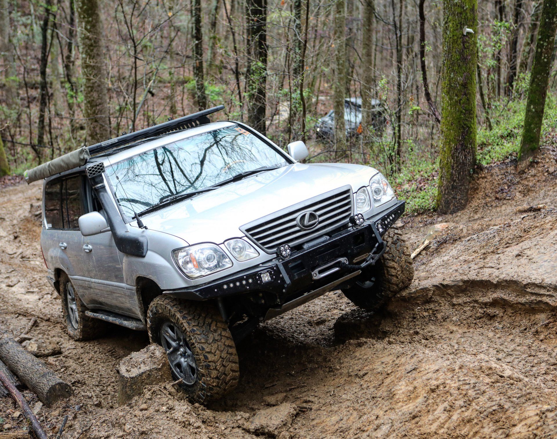

Long story shortish, I went to Windrock with @ga12r1 to do some scouting for some stuff that may be happening later in the year. Well, he LOVES trail 30 and that was the first one we did one the first day and that where I blew my diff. I can’t remember the other person who blew a diff on the same trail...on the same obstacle...because Lee loves that trail, but I think we both can claim it’s his fault. 🥴 Anyway he did save my bacon and helped (actually did all the work) in pulling the front drive shaft and drive flanges and I am driving it home today. A 10 hour drive!

At least @ga12r1 got a good picture before it blew.

The conditions were terrible. It’s that thick and slippery crap. Plus a very good incline into that big ass rock with a stump on the right side in the perfect place to catch the rear passenger tire. I did have fun the next two days riding shotgun in Lee’s pimp 200!
