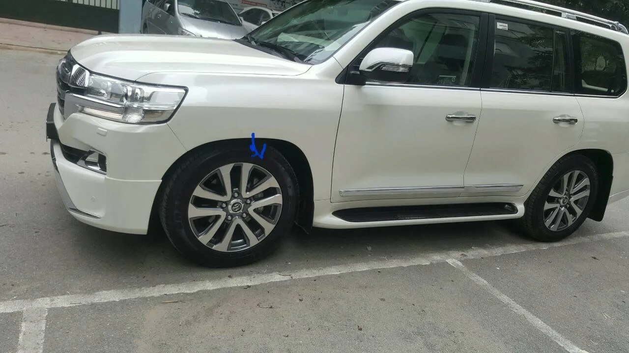

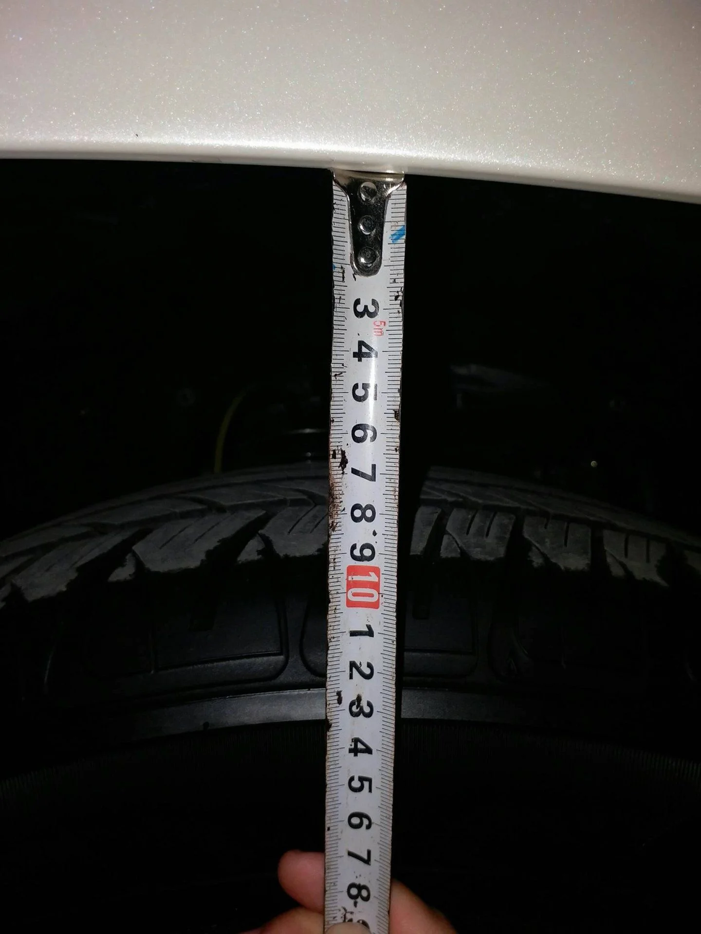

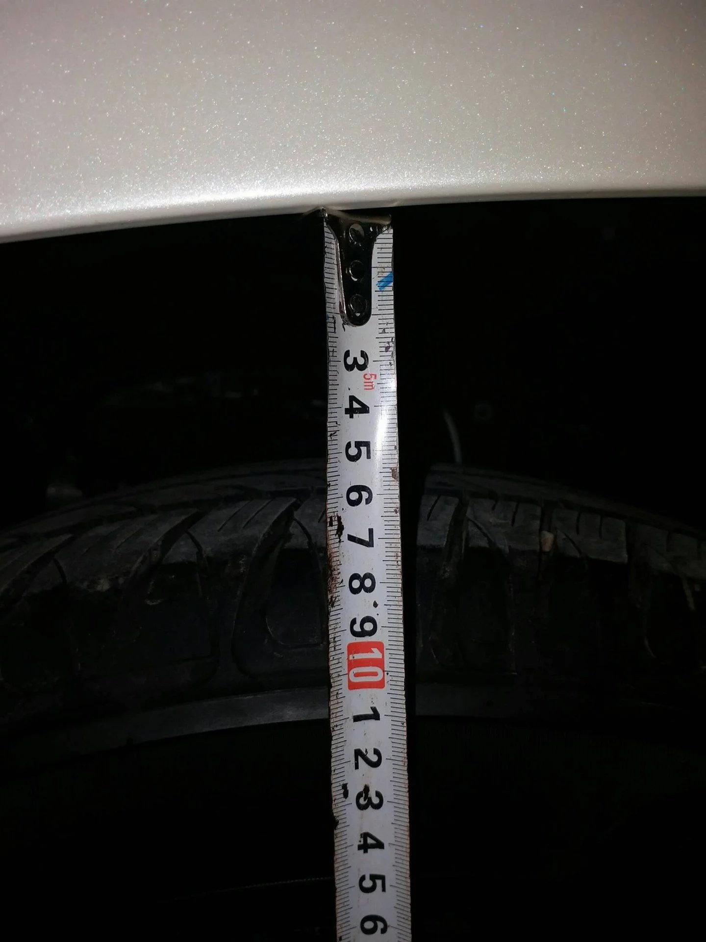

BTW, I also noticed that the front ride height of LC200 is uneven from left to right, with the right front side of the car sits higher than the left one. Do u guys think it's normal?

How uneven is the front? The AHC has a sensor in each front wheel well towards the top. As you slide the nut downards in the adjustment channel the truck heigh will go up. The rears are opposite, to raise you slide the nut upwards. As mentioned above I used this method and maxed out all the sensor adjustments to give mine a bit of a lift.

Thanks, it's about 1 inch difference. Not sure if it affects the cornering attitude, or it's way too subtle.

Uneven height ride? Any signs of impact on the front rims? This is a Lexus it should be smooth as butter.
Any signs of the front end being repainted,both fenders,bumper.
With the steering wheel centered does both tires fit symmetrical in the fenders besides the height?

Hmm, I think it should not be that bad :( I bought it brand new, tires sit symmetrical and other than these two minor issues, its ride is perfectly fine.
