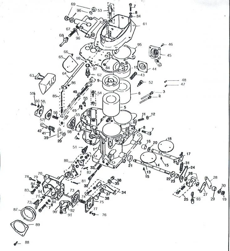

some more weber literature....it was in my tool box....alil dirty sorry :)
