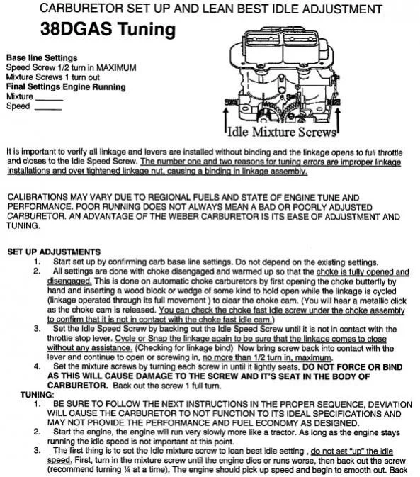

At one time I was quite good at tuning Weber carbs...so I figure i'll share some knowledge and maybe some of you can have some good insite also...because lets face it ...there are many weber questions :rolleyes:
Some info i'll pull from other sites and i will note that as i go along.
These are observations and can be used as a base to start at:

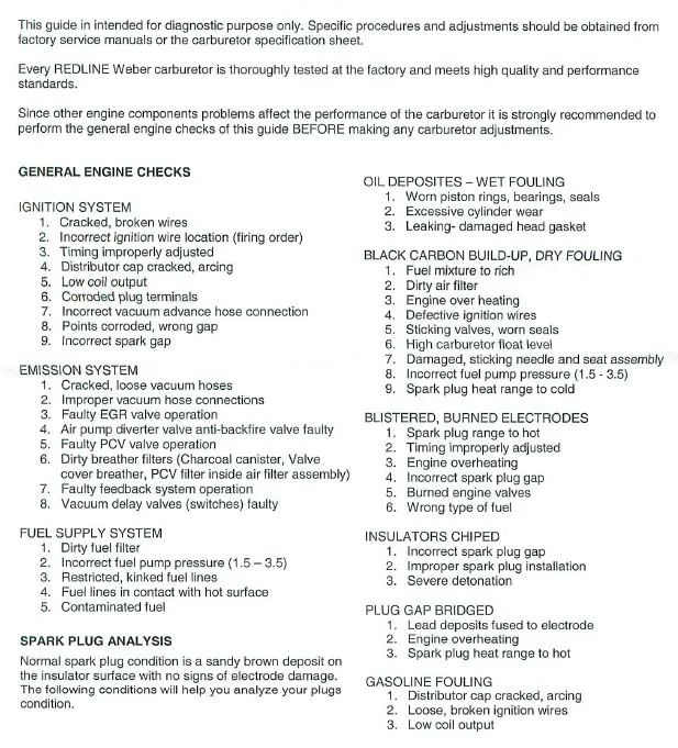

These carbs have fixed venturis so the choke size is not an issue. The pump jets are also not a problem. Do not mess with them. If you have a flat spot or hesitation when you first take off then it is likely that the idle circuit is too lean. If you know you have the idle circuit right then the primary main jet is too small. Increase the main jet size 2 steps at a time. (150 main is a 1.5mm hole...Main jets are in steps of 5. eg: 150, 155,160,etc.) Keep checking the plugs after driving it for a few minutes (Do not let it idle when checking the spark plug color for the main jets. Drive the car above 2000-3000 RPM for a few minutes then shut the engine off before letting it idle then check the plugs. If the car then transitions fine but hesitates or falls on it face when the secondary is opened you need to work on the Secondary main jet....

38/38 DGES
These carbs have fixed venturis so the choke size is not an issue. The pump jets are also not a problem. Do not mess with them. If you have a flat spot or hesitation when you firts take off then it is likely that the idle circuit is too lean. If you know you have the idle circuit right then the main jet is too small....Increase the main jet size 2 steps at a time. (150 main is a 1.5mm hole...Main jets are in steps of 5. eg: 150, 155,160,etc.) Keep checking the plugs after driving it for a few minutes (Do not let it idle when checking the spark plug color for the main jets. Another good option is to install a Halmeter AF30 Air Fuel Ratio Gauge to help you with tuning. It is fast and accurate and will take alot of the guesswork out of it. This is a particularly valuable tool for cars that get track use so that you make sure you do not lean out and put a hole in a piston...

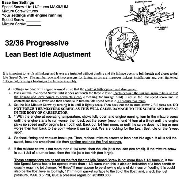

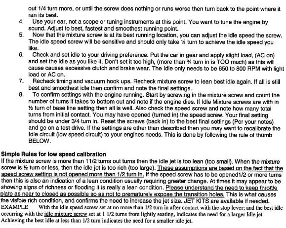

32/36 adjustment
I am now fine tunning my rig.
I just replaced the main jets...running really well ( for those that dont know me i just put a 60K mile engine in with a redone head) stock weber was set for 155 mains I went to 142 (i had a set laying around) I am at sea level. I was running 135 for my 430,000 mile engine before replacing it.
the mixture screws are exactly (edit:just under) 1/2 turn off baseline...which is one turn...so to full in i am out 1 1/2 turns ....just right :)
I was running 10mpg with the 155's ....now with the 142's If I dont like the fuel economy...i can tweak it just a bit more and put a larger air correction jet...i have in now 180...i will go to 185....we'll see how it goes :)
