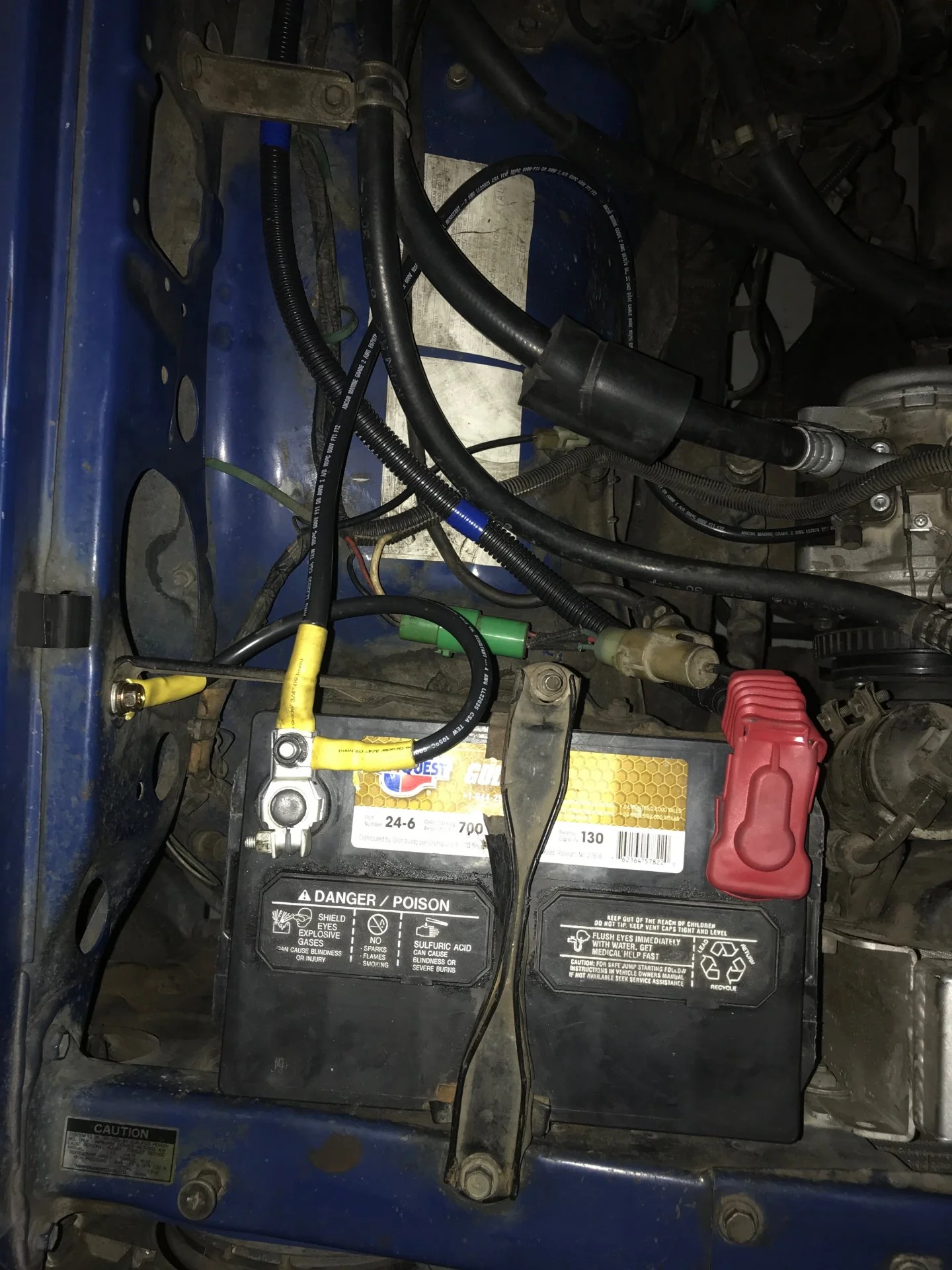

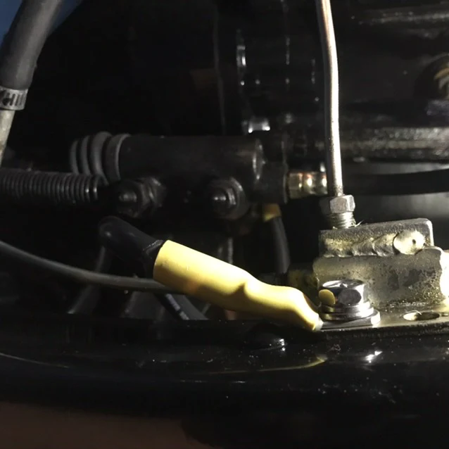

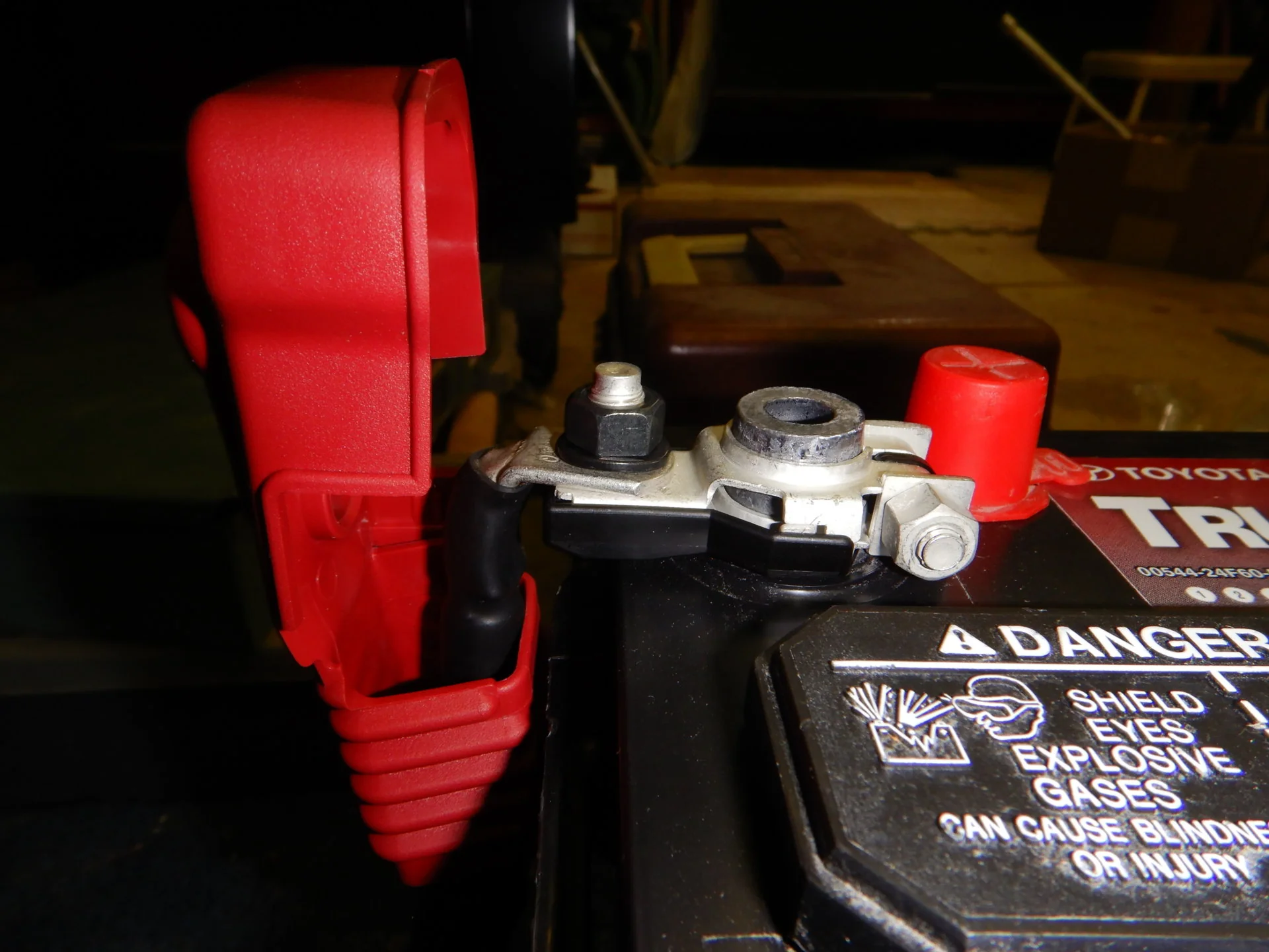

I was planning to upgrade to the fj62/80air cooled alt. In prep for that, I ran a 2awg 12" lead from + on the passenger side battery to the charge terminal on the alternator, then one from a good body ground to negative(battery tray diagonal bolt to fender). Both wires are in parallel to the stock harness.
I am running about 14.2 volts now, with my old tired alternator.
These leads just barely fit, if you route them properly.
In case someone wants it below are the wires I ordered. They fit with very little slack.

Had a spare 2awg black cable from old project, and added a ground to 2nd battery.

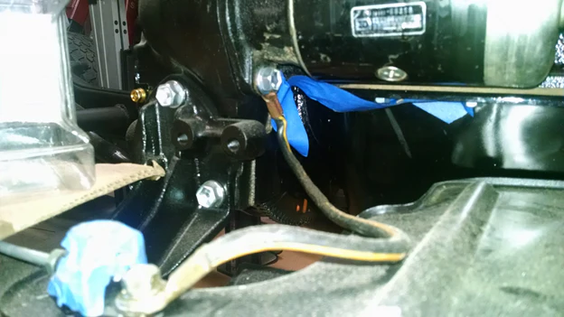

Next to put ground from - on starter to bolt on the fender, doing this added years of trouble-free service, from an already unreliable starter on my FJ40.

Using 0/2 cable for grounds on my 60 and replacing my fritzy fusible link that had burn marks in it (pics in my thread) yielded me 14.1+V at idle now which I'm thrilled with from my 55A alternator. New grounds are a good idea for any of these trucks at this age.
@caladin Big cables make a huge difference, don't they! People go replacing the alternator right away, when most probably don't need to. Open up those cable sizes and let the alternator breath! I've upsized all my grounds, as well as the positive cables for the starter and the alternator - most of those came from @Fourrunner , he makes a really good kit. I haven't done it yet, but I'd also like to run a larger cable from the battery/alt to the fuse panel in the cabin. Toyota used 12awg for that, and I really think it could benefit from being larger (and having less resistance).

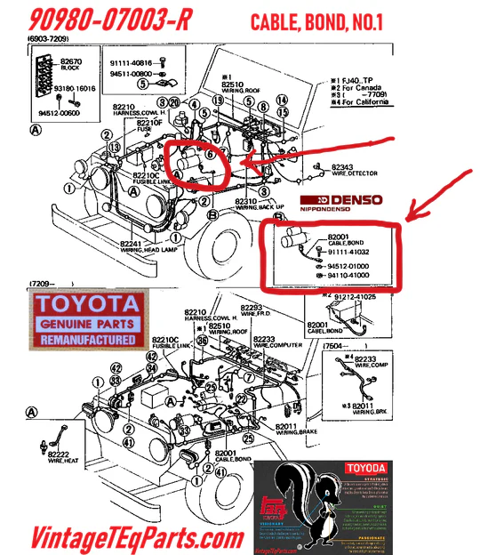

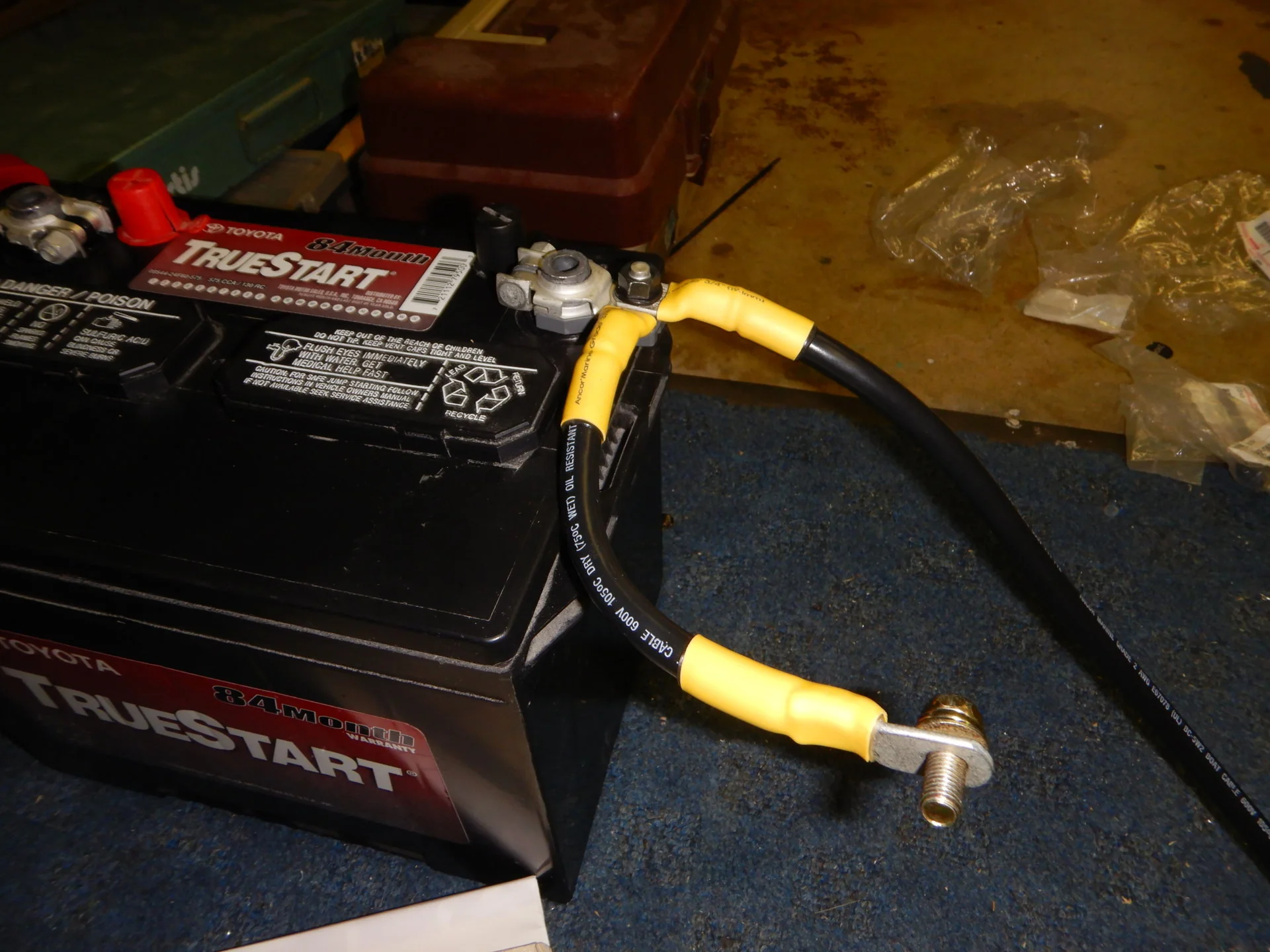

i hand assemble all my Battery Cables and Cable Bond No. 1 out of ANCHOR Marine Grade 2 AWG its a SOLID SAE 1+ next step up in side spec. from the FJ62 set up ...
the rest of all parts are OEM TOYOTA General Service Japan. spec. ones ....
Tinned-Fine strands ANCHOR brand is the US Military Go-To Product , also out on the high seas with the USCG & Navy ...
my
B+ Positive has the added my rugged SNOW-VERSION GRADE spec. applied heavy duty tough as Nails ,with the Super heavy duty style of Corrugated Loom end to end
NEG- GROUND i color key in YELLOW with ANCHOR adhesive lined shrink in lock step with OEM TOYOTA
link to 2awg 12" marine grade cables on Amazon.
12" fit without much slack, to the passenger side battery, which is what I wanted. I didn't upgrade to marine grade, just put the link here for those who follow.
