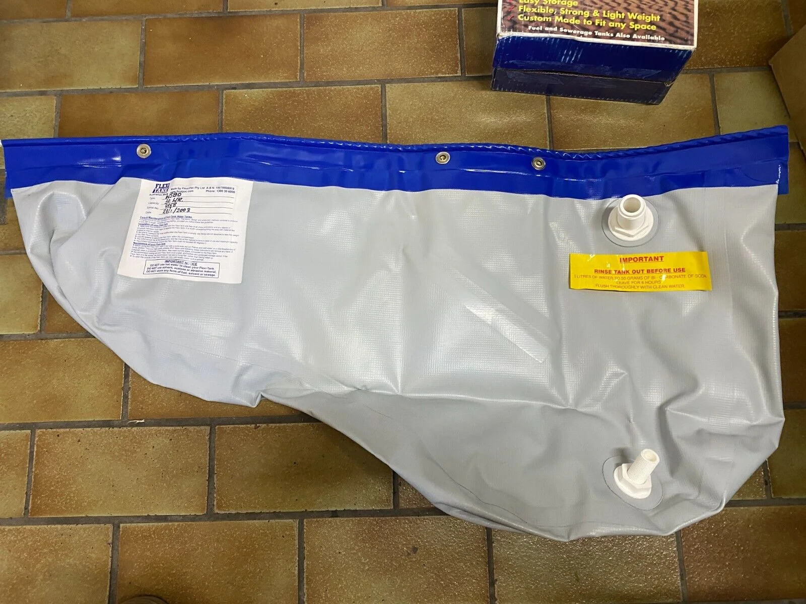

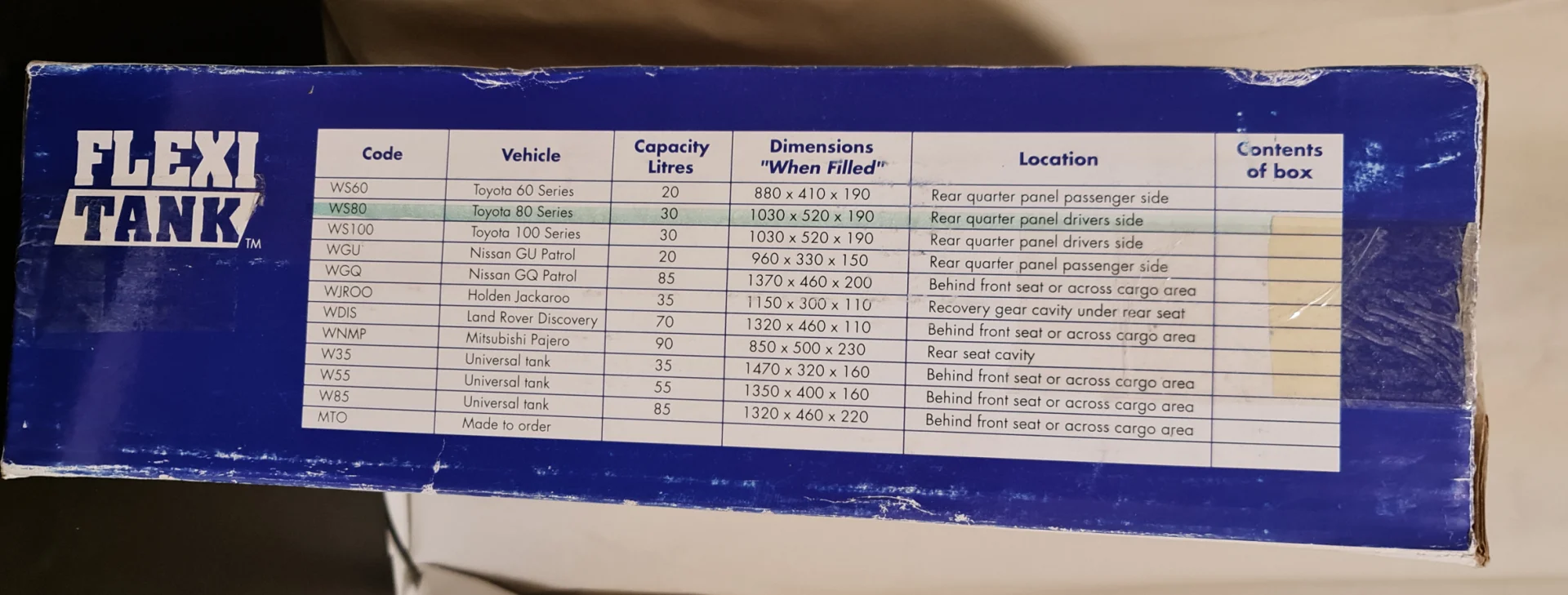

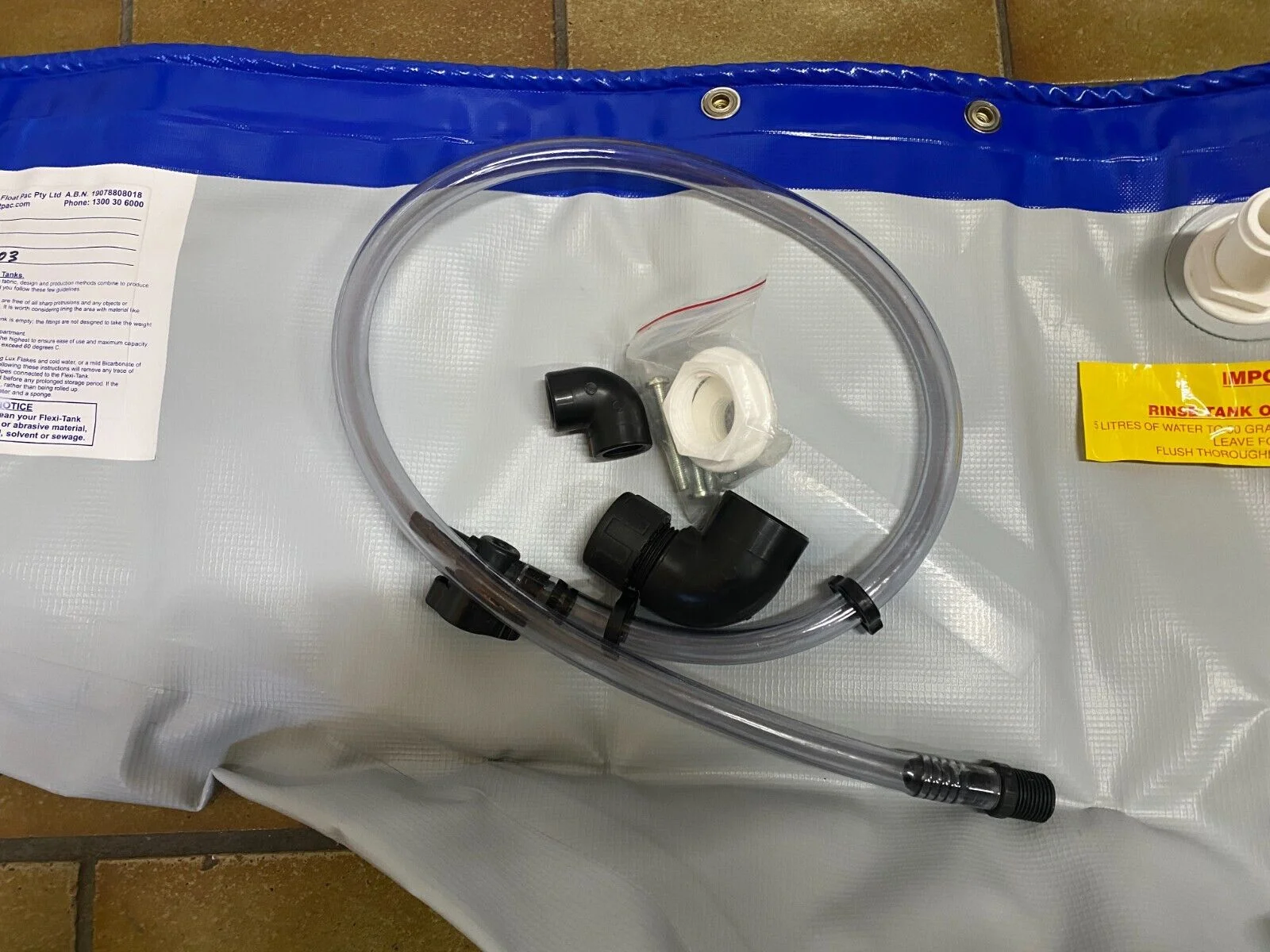

One thing my rig isn't setup for is anything fancy when it comes to water storage. We chuck a water jerry can in the back for longer trips, but I've seen a few rigs where people had a pump rigged with an onboard water source, which gave them easy permanent access to water, and low pressure flow for washing things off, which seemed like a good idea to me. I was interested in getting something that fit into the driver's rear quarter panel, and lightning struck the other week when I saw this on ebay and bought it on the spot:
It's 20 years old, but brand new in the box and never used. Looks like it's been out of production for some time. It was apparently found sitting on the shelf in the back room of some 4wd supplies store and listed on ebay. It fits in the rear right quarter panel, which is exactly where I wanted to fit something, and provides 30L (8 gallons) of storage. It arrived in the mail today, and I'm keen to have a go at fitting it when I have some time to spare.
Anyone gone down the route of on-board water storage on your 80, or seen a cool setup from someone who has? Any pics or tips to share?

The kit you have looks like a good one, and 8 gallons is just about the right amount for a weekend trip, or to augment other water supplies for longer. Given its age, I'd fill it up and check to be sure it's still water tight before you go through the effort of mounting it. Also, I'd have to clear out the spare parts (radiator hoses, belts, et al) that reside in that space to use that. Watch for any sharp edges and maybe worth running some split rubber hose across any seams to avoid chafing.
As with any kind of water solution, making sure it's 100%, dead-nuts resilient is important - be cause the last thing you need is to get where you're going and find out your water is sprayed out on the ground for the last 100 miles...

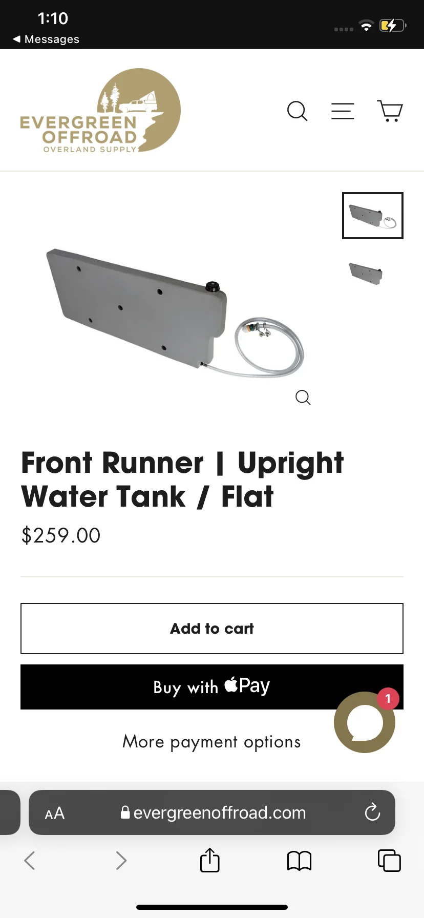

I was on planning on adding a Front Runner slim line tank behind the front driver & passenger seats some time ago, but when I went looking for the vendor recently I had a hard time finding it.
@mudgudgeon maybe you should pass along your set up to Roger ? Unless you plan on bringing it. But could work well for them.
Look at Ironman America, they sell them for under $200 and they have sale now.

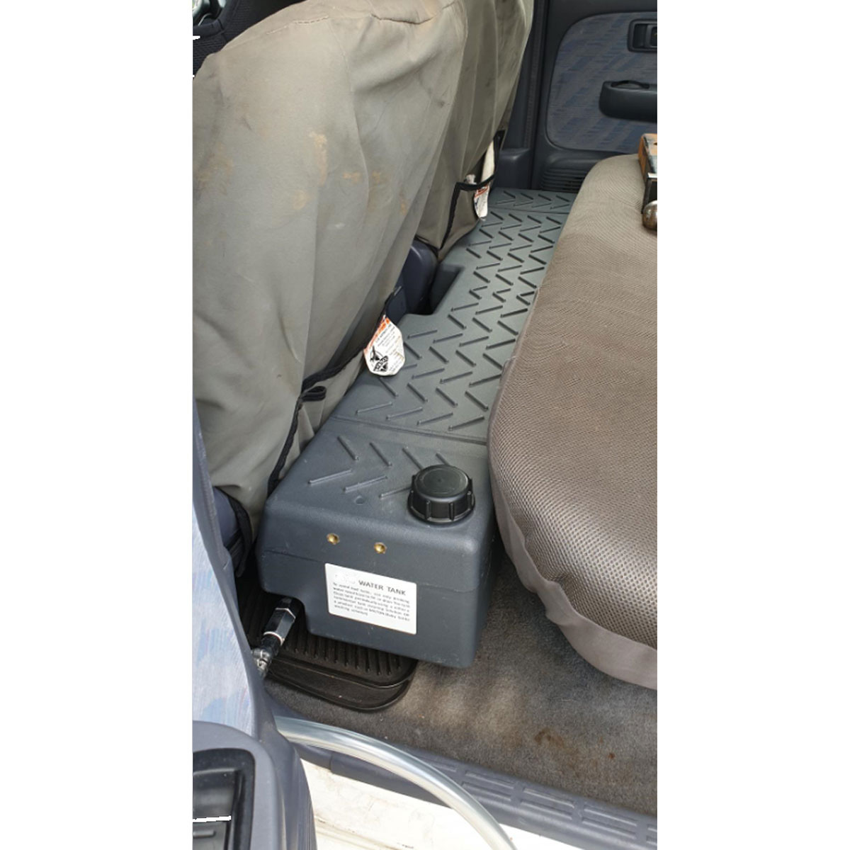

There's also the thread about a black plastic water container that goes on the floor behind the front seats, but I can't seem to find it and I think the sloshing would get annoying.
Several people have had them on here back in the day. I remember reading complaints of sloshing sounds and difficult to clean.
This would be my issue as well. Cleaning would be a total PITaS

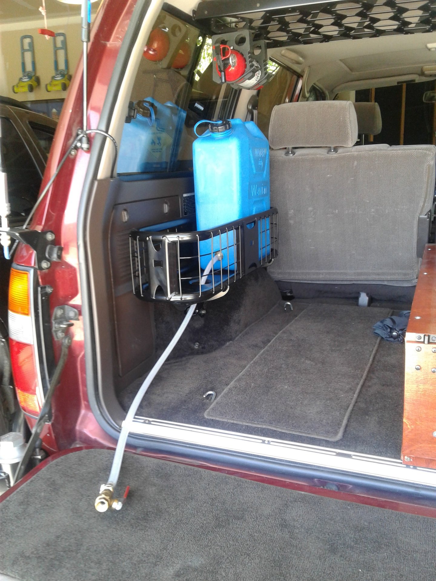

4x4 Labs 3rd row cargo basket (great shop!) with a Wavian water jerry can tapped with a hose and spigot. Works great, easy fill, easy clean, and stays out of the way.
This is my exact setup. Those Labs racks are super versatile.

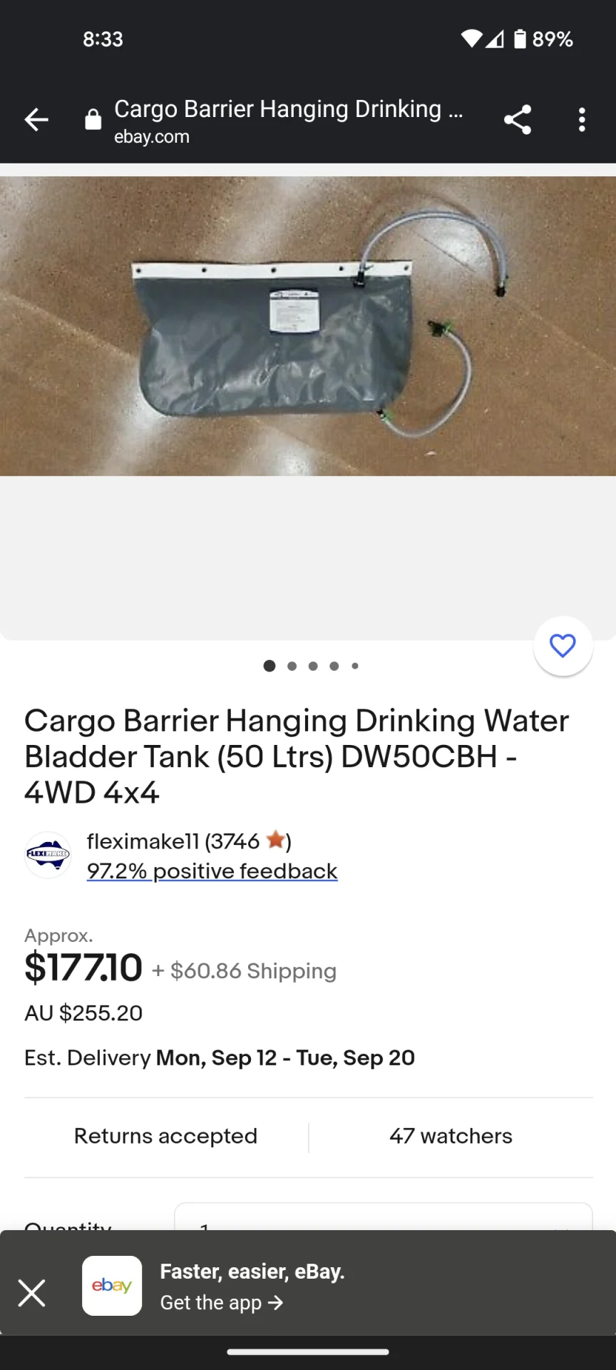

I think the company still exists and makes all sorts of bladders. I got one off ebay (shipped from Aus) that lays on the floor in the 2nd row. Huge capacity if needed and keeps the weight pretty low/centered. I'm a huge fan. Good purchase.
Sample item from ebay below. I got the 60L version.
Nice. I've used a similar setup for years, but without the fancy rack.
