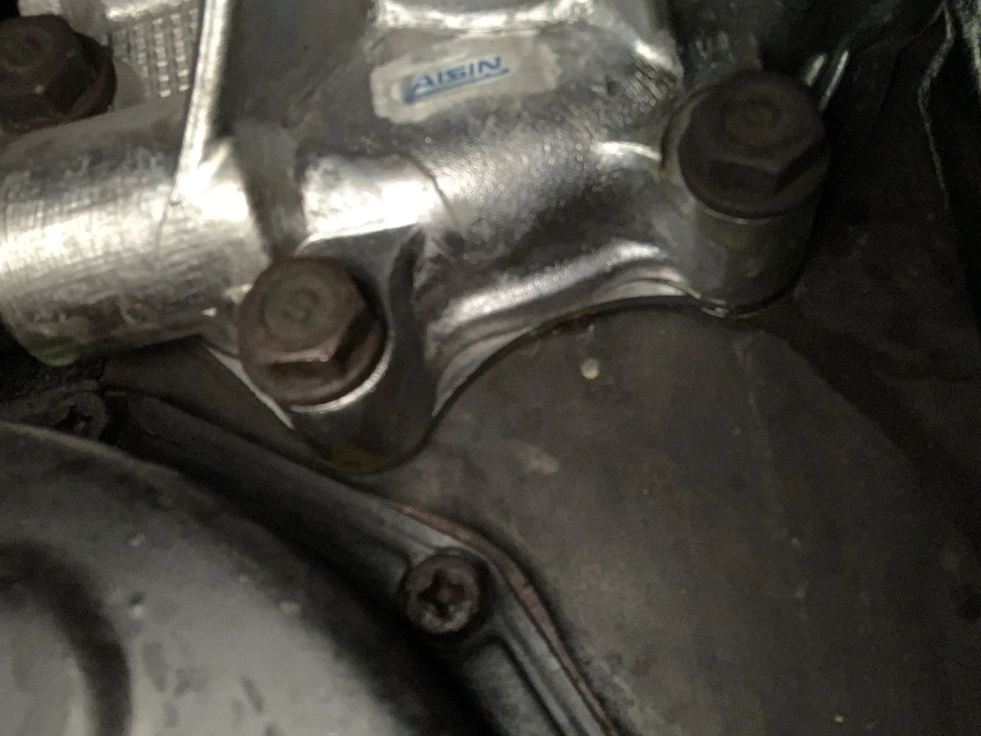

Freshly rebuilt ‘78 2f. New Aisin water pump. Just got through break-in.
I have a small coolant leak that appears to be coming from one of the bolts on the bottom of the water pump (see pic). Bolt is tight, but I put a little more umph on it tonight for good measure.
Anyone have any tips for fixing?

It doesn’t matter how much you tighten it, if the threads don’t have gasket sealer. That bolt threads into the water jacket in the engine.
Remove it, put Permatex on the threads and put it back. Cheers

Your diagnosis proceeds on the assumption that because you can see coolant dripping from the bolt, that THAT is where it started.
Did you pull the backing plate from the water pump and reseal it before you installed it?

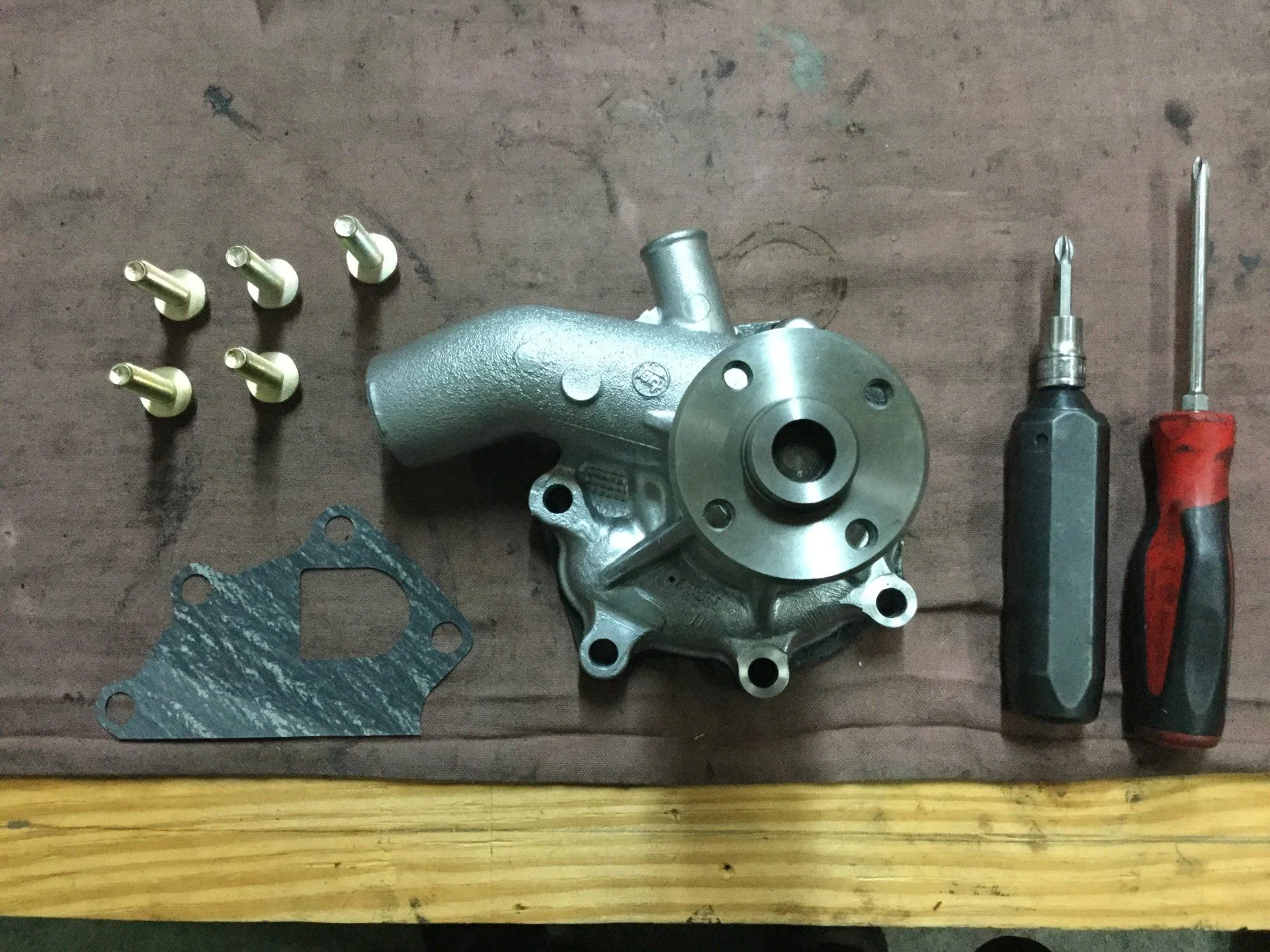

Once the pump is in ur hands it should be obvious. the Phillips countersink screws on the back side of a new pump are almost always loose, in addition to the loose hardware I personally like to wet the gasket with a light film of rightstuff and give a few love taps with my hammer impact driver just before mounting the pump.

also the old spring washers were re-used it looks like from photo ,
i guarantee they were flat like a saggy leaf spring when re-installed ,

addionally , the AISIN kit comes with a 2nd gasket a FULL ring around the entire water pump type , what this also installed by @Freeborn
im not sure i saw that mentioned or discussed above ?

Thanks for all the tips, friends. Circling back here to update/resolve the thread...
In the interest of saving time, I ended up taking the vehicle to the shop around the corner to get things sealed up. (Don’t worry. One of the owners has owned several 40s and knows exactly what he’s doing.) It turned out that most of the bolts on the water pump were loose-ish. They ended up putting on a new gasket and sealing with an RTV sandwich for good measure. Also put the requisite sealant on the bolt threads.
The result: Completely leak free...so far. 😉
