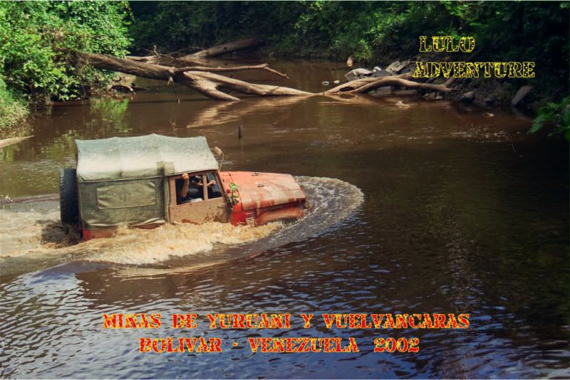

if you do go too deep then get a tug out no big deal really... the lid on the air box was not attached properly before the run... duh.
