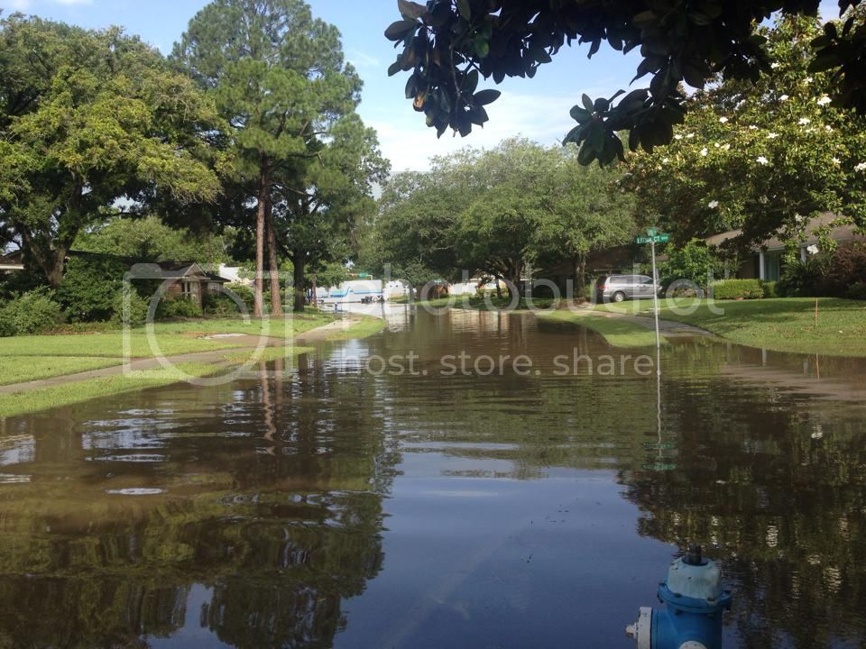

Hey guys, had a quick question about water crossings as I stare Hurricane Matthew in the face and am required to hit the roads tomorrow to go to work. I sincerely apologize if this question has been answered elsewhere. I did a quick search but couldn't find a good answer and am a little short on time due to storm prep.
Been a creeper here for a bit but have yet to say hello so quickly will mention that I bought a 2006 LX about 18 months ago after being on safari in South Africa and our guide (while driving a Range Rover) said he wished he had gotten a Landcruiser because "those things will go anywhere." Had known I wanted to trade in my RWD 4 Runner for a 4WD but wasn't sure until that point what to go with. I found this LX in excellent shape and could not be any happier with the purchase. Looking forward to slowly getting some upgrades. Thanks to everyone for all the great info here.
That brings me to my question, she's still stock (no snorkel obviously) but has functioning AHC. Roughly what water level should I feel comfortable braving assuming all other parameters such as significant water current or obstacles are not an issue. Not going to be a cowboy here but would like to be able to get to and from work safely and as quick as possible but definitely don't want to ruin this baby.
Ironically here's a pic of the rig's only "offroad" trip staring at a small mud puddle that I decided not to cross since I was the only vehicle, Michelin tires, no winch or maxtrax, and the 4 month old baby asleep in the back. Yeah, I have some work to do.

Thanks so much for the all the great info. I was definitely unfamiliar with the placement of the electronics for sure so that is very helpful. @bctlex good point about the unseen debris. Definitely plan on being super careful and not braving any swift moving water but if it's a short push through 18" or so of water to get to my house it sounds like I should be in pretty good shape. Thanks again guys!
