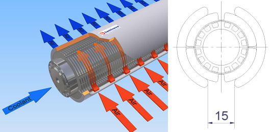

The base of the project is (3) Laminova 39.5 x 392mm cores I sourced off ebay:

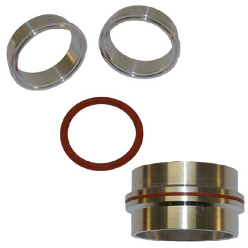

They have two parts (that form a functional unit) that I'm particularly interested in. The first is a set of pipe ends I'd use to connect the intercooler to the intake manifold:

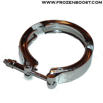

the second is the clamp that holds them together:
My vision is to mount the intercooler over the head, between the supercharger outlet and the intake chamber. These give me a quick release on the intake end to remove it for completely open access [unfortunately I think I'm stuck with bolts on the other end]. Does that sound reasonable? I know it's not terribly clear, but will hopefully make sense as I add build photos.
