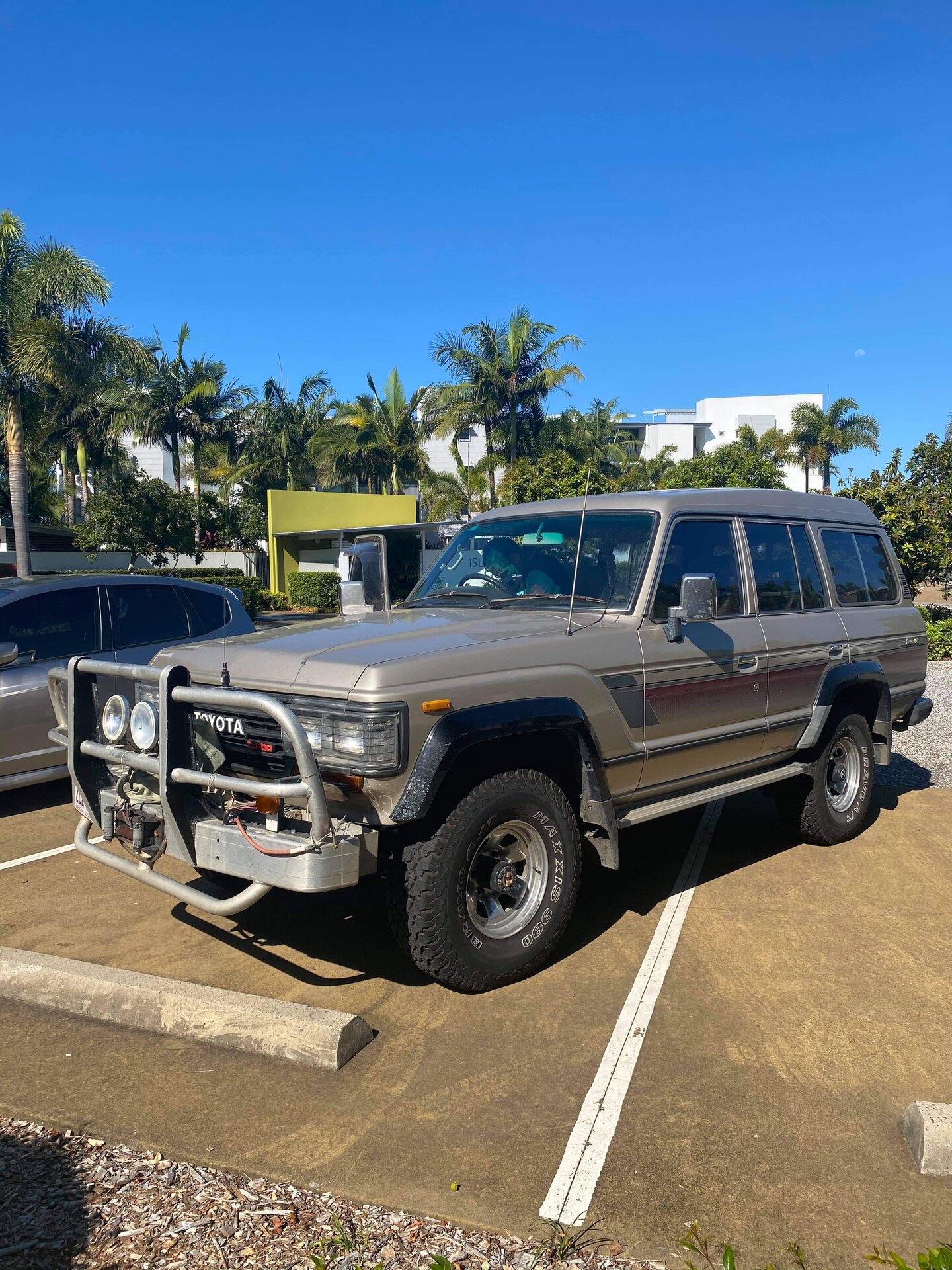

Hey everyone
I have a 1989 Toyota Landcruiser HJ61 12ht sitting at 410000 km
I still have a whole lot to learn and a lot of work to do, but here is an introduction to the work thats been done so far for those interested:
The cruiser has
fully reconditioned gearbox
new exedy heavy duty clutch
reconditioned clutch booster
new master cylinder
New Terrain Tamer e-locker with diff overhaul
C/W and Pinion kit
new swivel hub kit
new axle bushes
new wheels bearings
new front brake rotors and calipers
new rear brake drums
new tough dog suspension @ 370.000 km
new tailgate lift struts
new alternator
Now, a few issues that I'm aware of and need to work on so would love some advice on:
There is no water coming out of my window washer jets. I have checked the hoses and the reservoir itself - nothing is blocked. The pump makes its normal noise as if it's trying to push water out, but it doesn't seem to be working at all. Any idea how I could fix the problem or if I am going to need to find a new pump altogether?
Does anyone know how to remove the pump from the reservoir?
steering box needs attention: There is a bit of play in the steering.
Couldnt seem to find anything - Is there a video anywhere on how to tighten? the steering box? Is this something I could do myself or would it be best to get it done by an experienced mechanic?
Thanks for reading/any advice!
