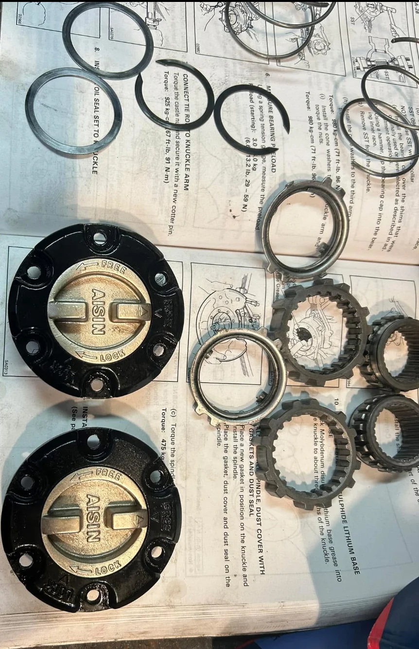

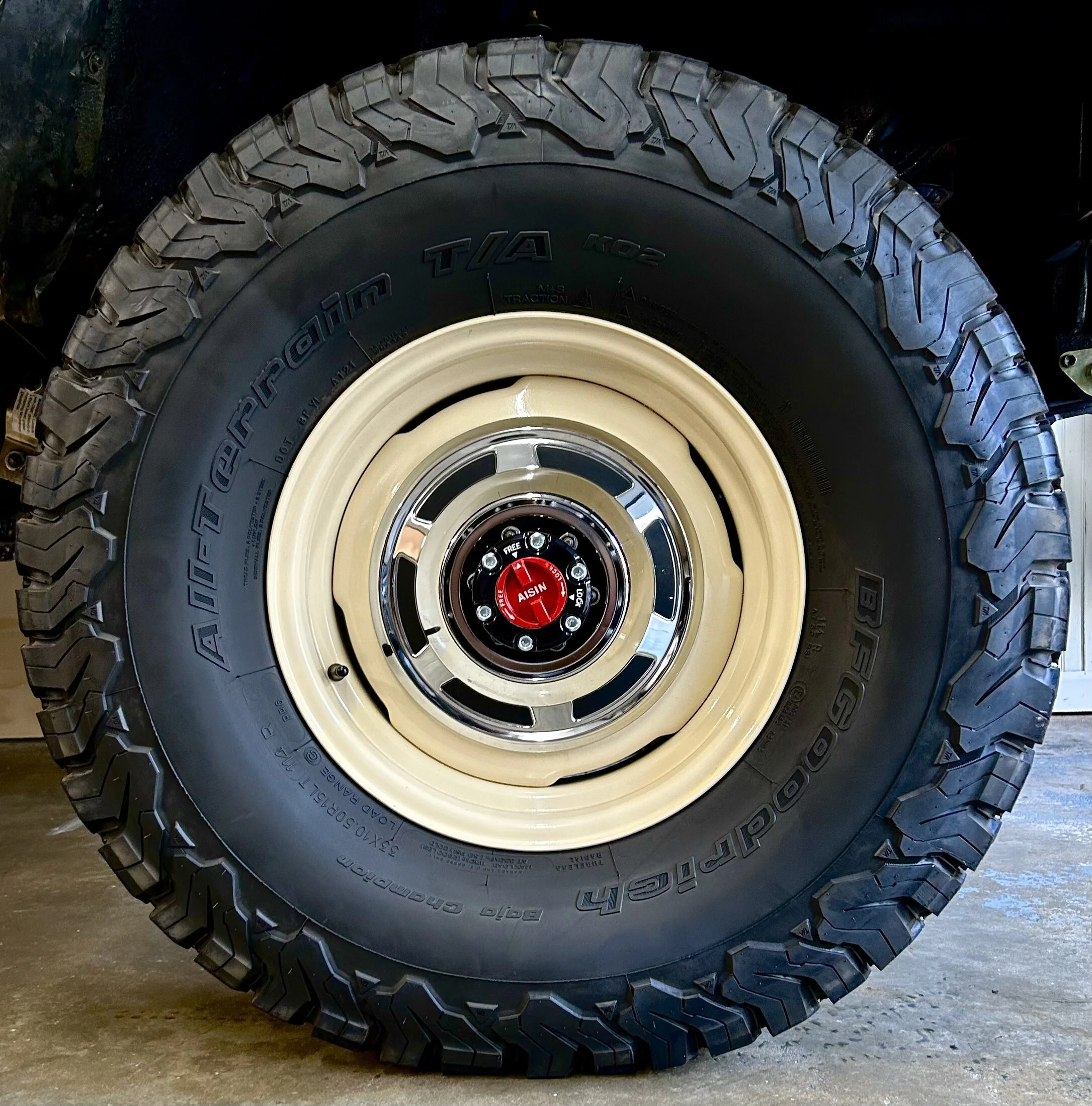

I thought my Aisins looked fine. Dugan (owns ACC Garage) disagreed. Patty was there for something unrelated. Dugan said "Your hubs looked like crap and I was bored."
So, some media blasting, some powder coating, some paint, some new hardware... Okay, he was right. And no - he didn't charge me a dime.
