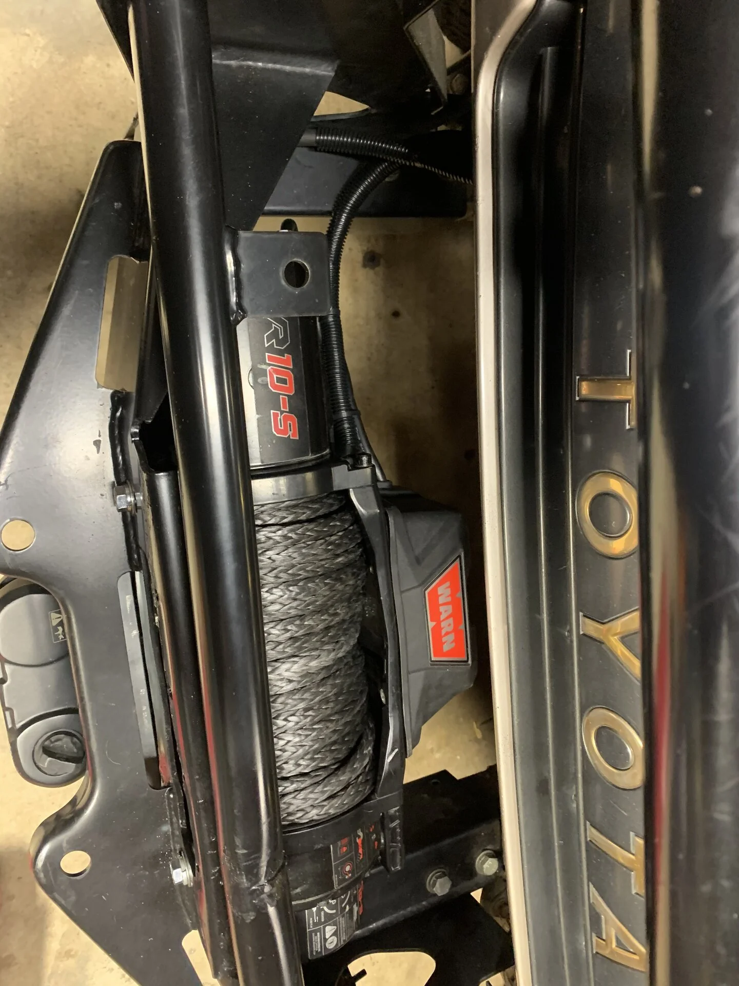

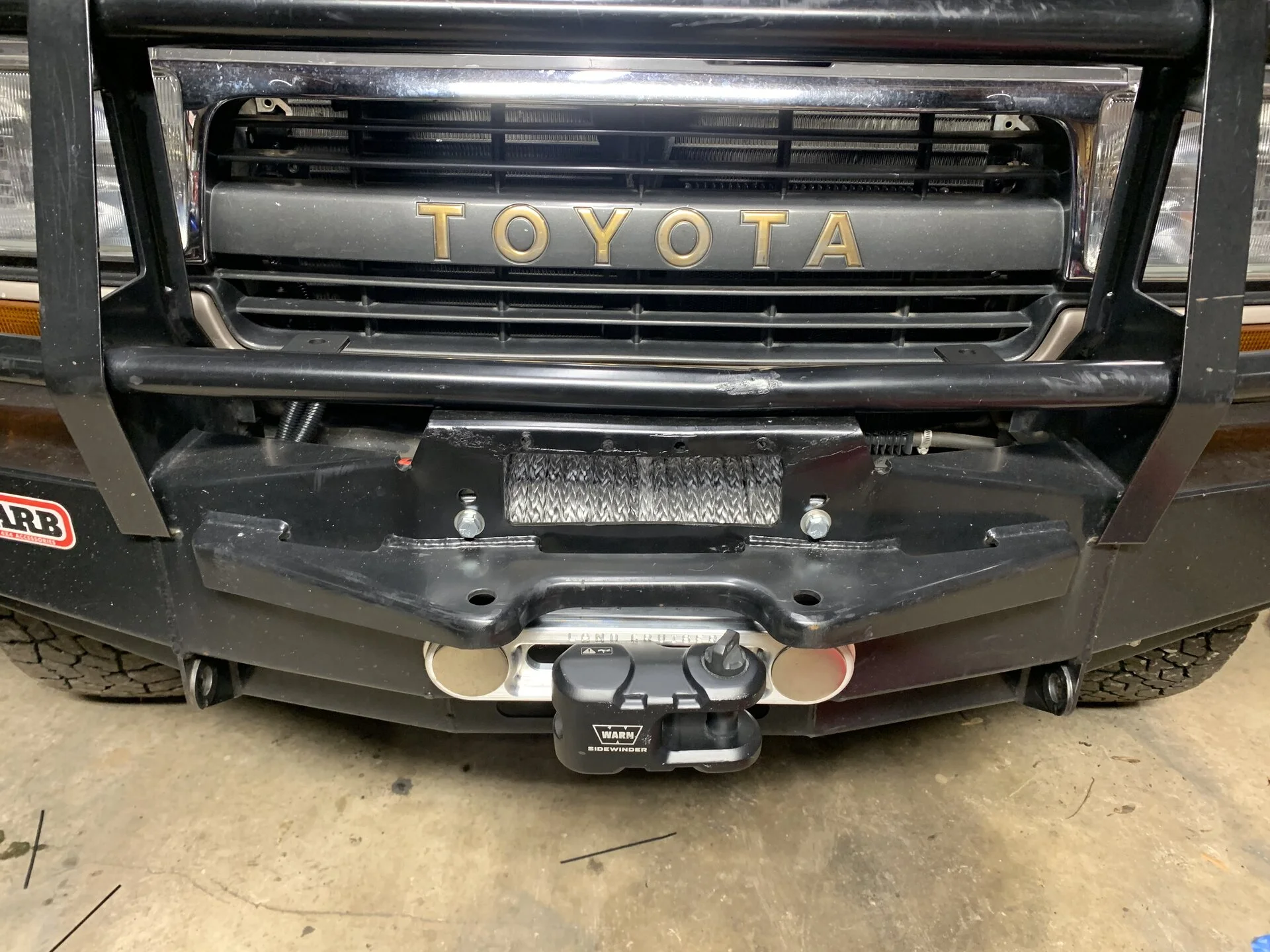

Mine isn't an EVO but the standard vr10-s is about the same dimensions. I mounted it to my ARB just had to use small spacers on the feet of the winch to get it to bolt up. I left the control box mounted to the "top" of the winch as it fit fine and I have had no issue using it like this
Hope this helps
This might help.

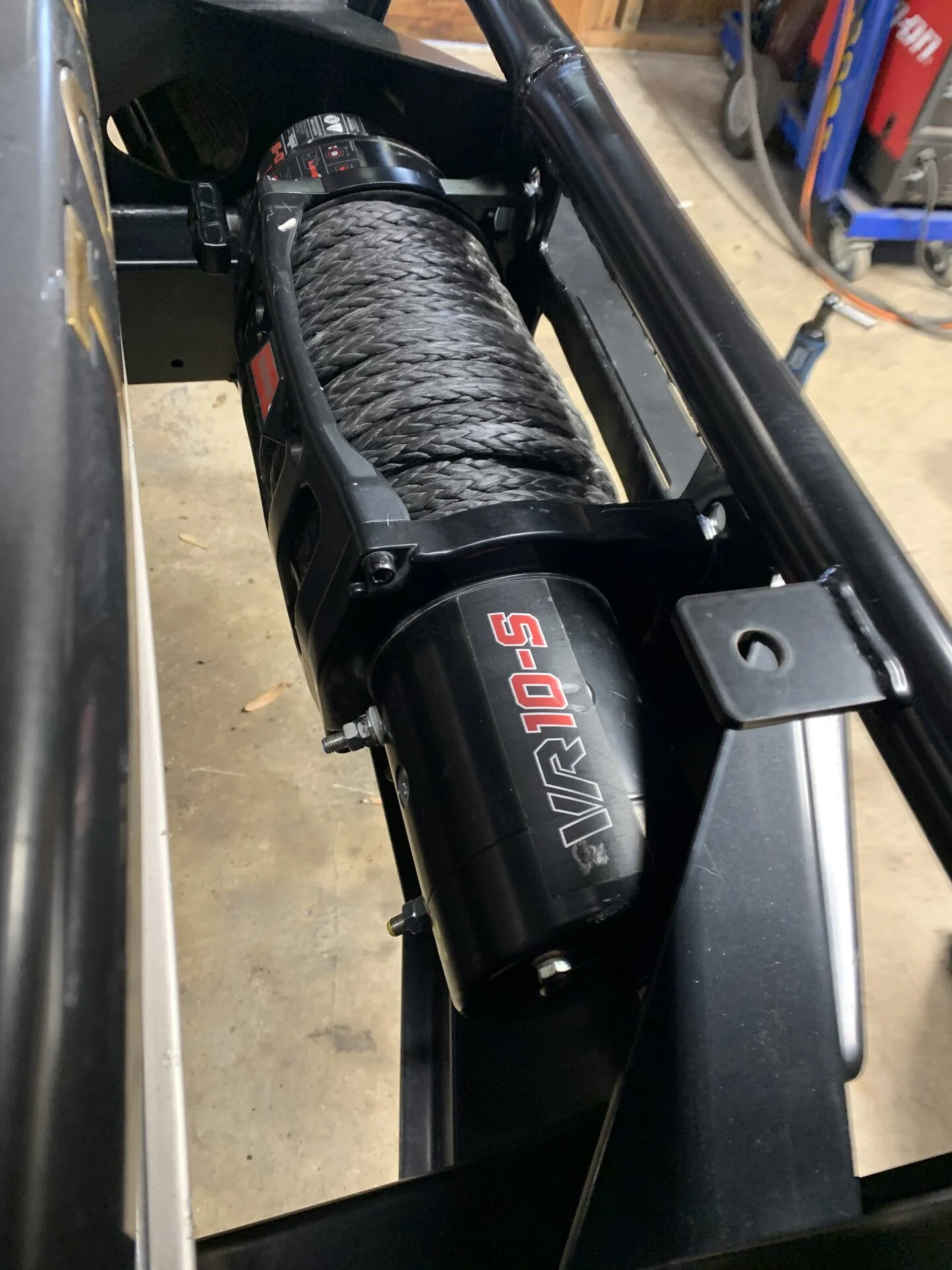

I have this combo. I had to mount the control pack on just the bottom two holes. I also needed the adapter kit from ARB (the thick plates) plus a bunch of washers, as well as the Slee offset fairlead.
Thank you all very much for the fast responses. I got all the info I needed to complete the install! I suspected that the spacers needed to be close to 1"...
