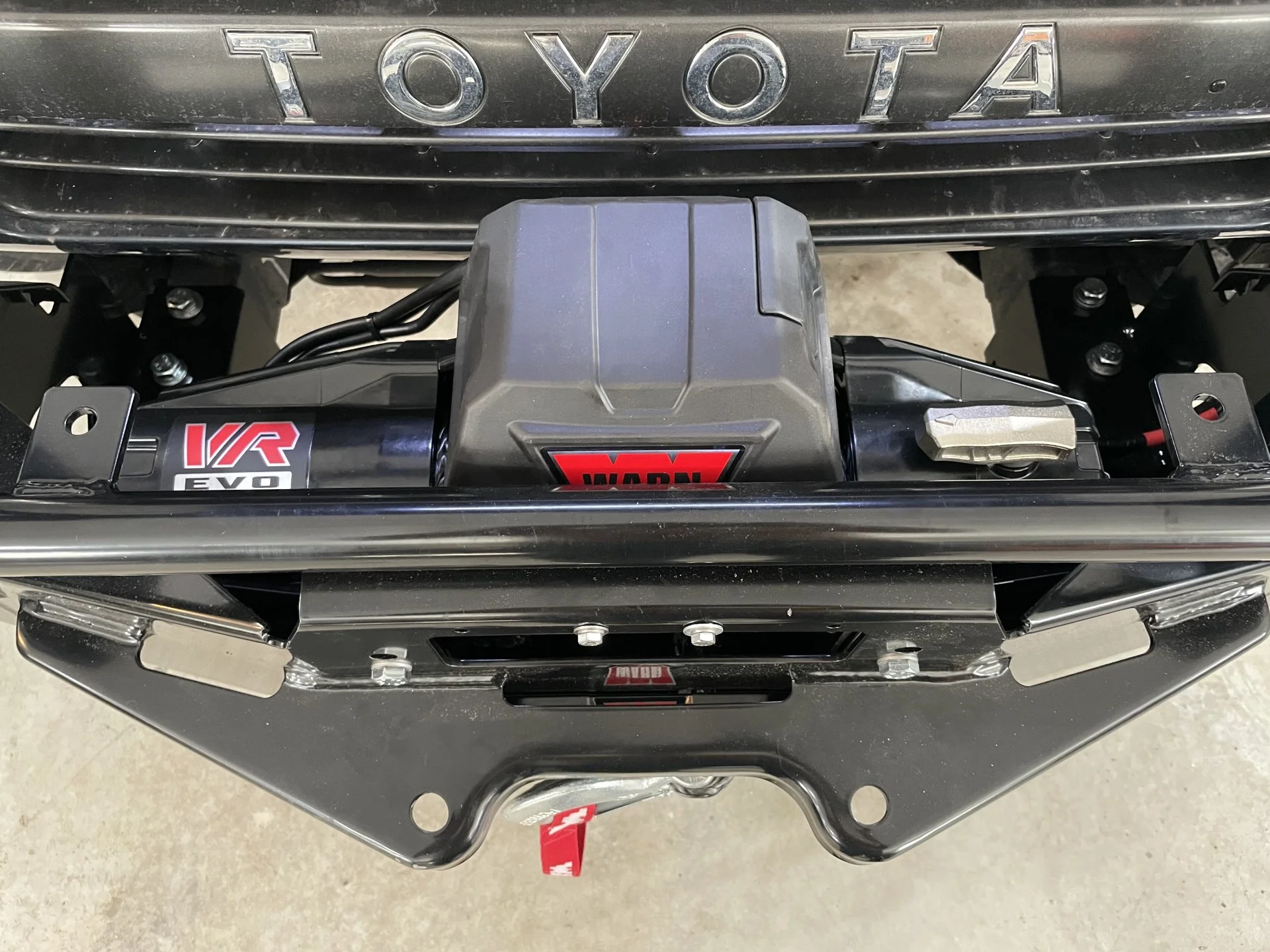

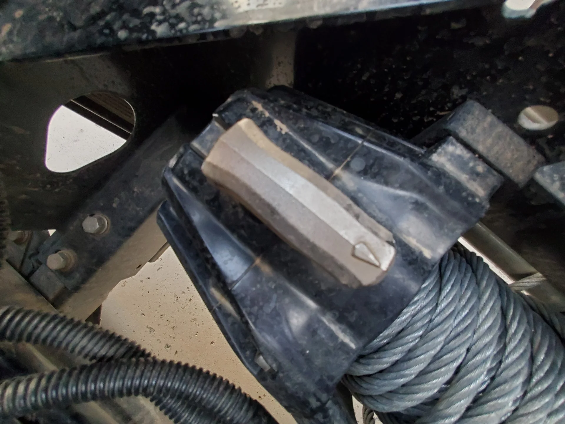

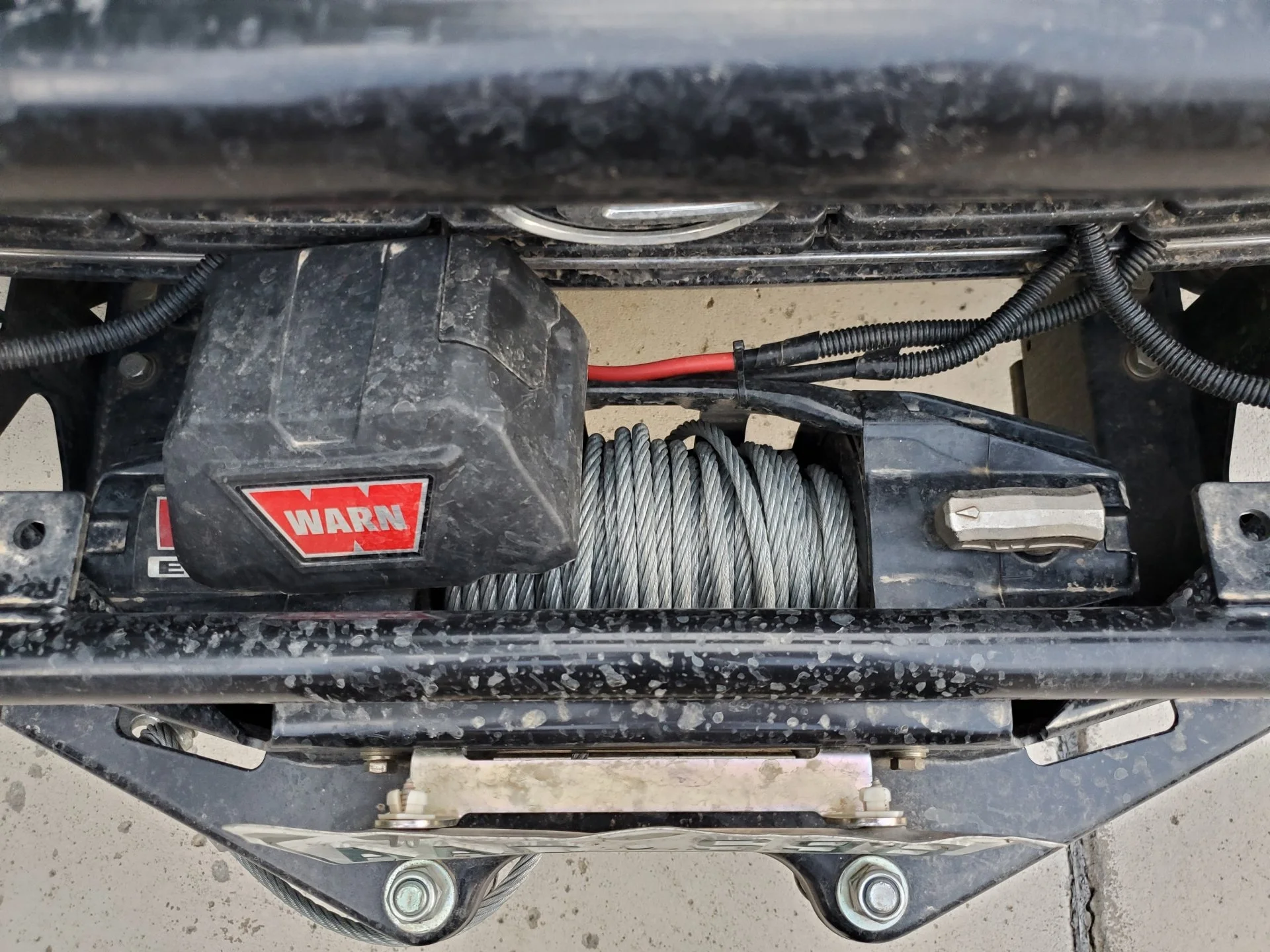

I have the VR Evo 12k mounted with 3/4" spacers. Still need to come up with a more permanent mounting solution for the control box, I haven't decided if I want to hide it under the hood yet.
Pay extra attention to which way you clock the handle, I rotated it wrong the first time around and had to redo the whole install.
Hope these photos help 👍

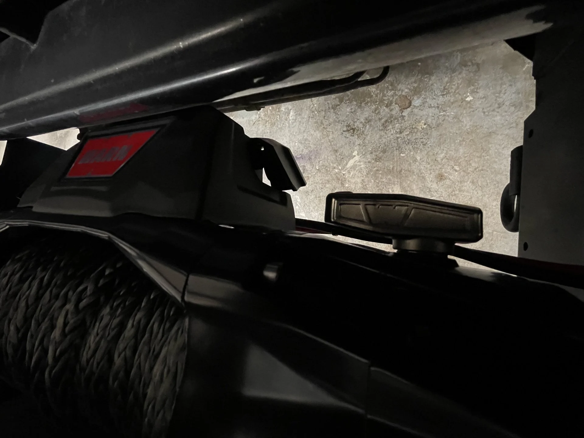

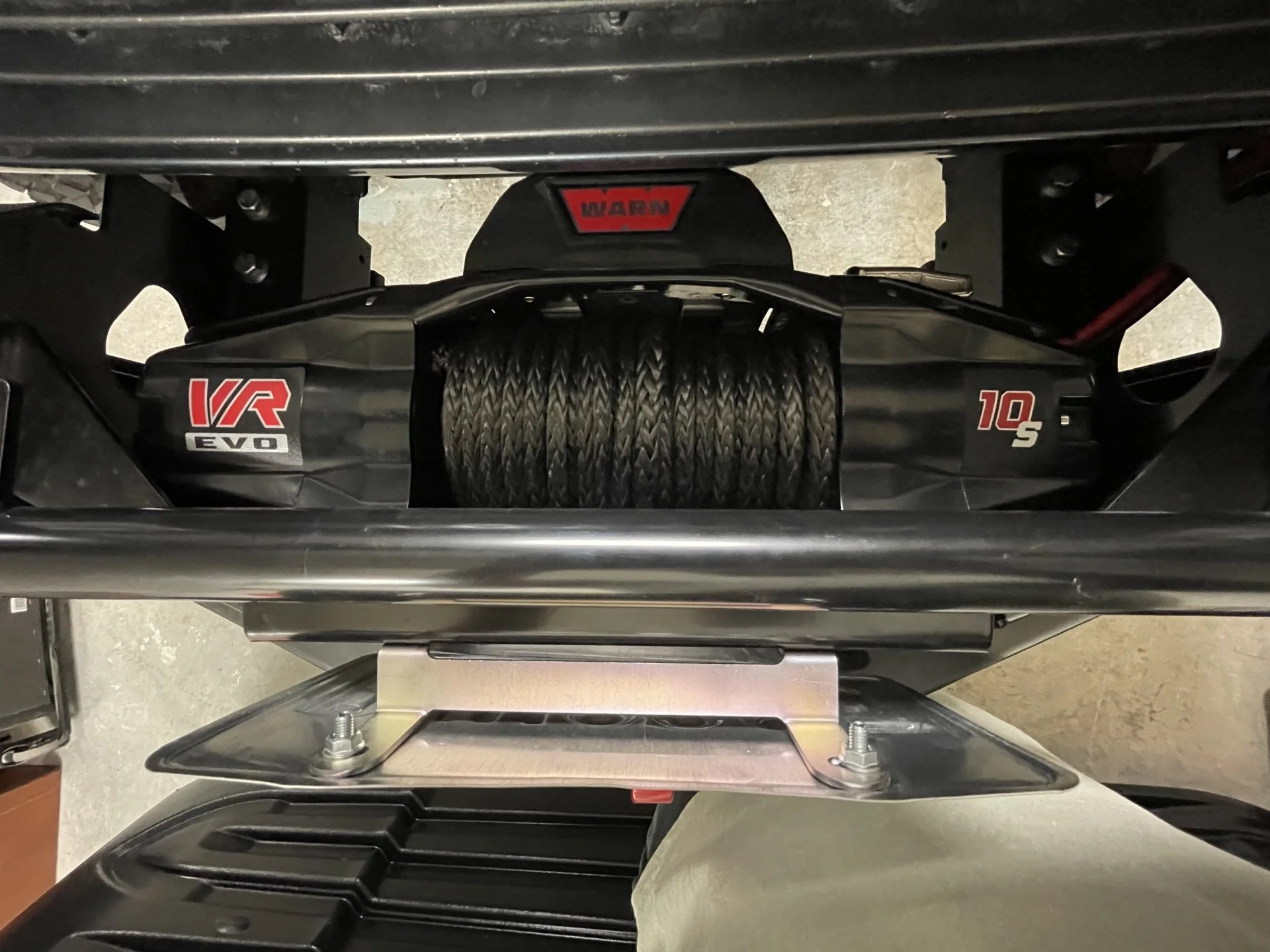

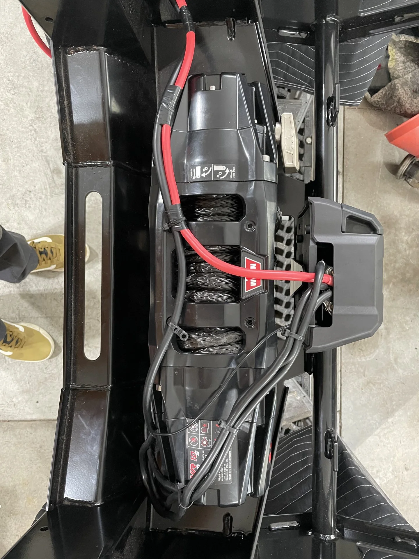

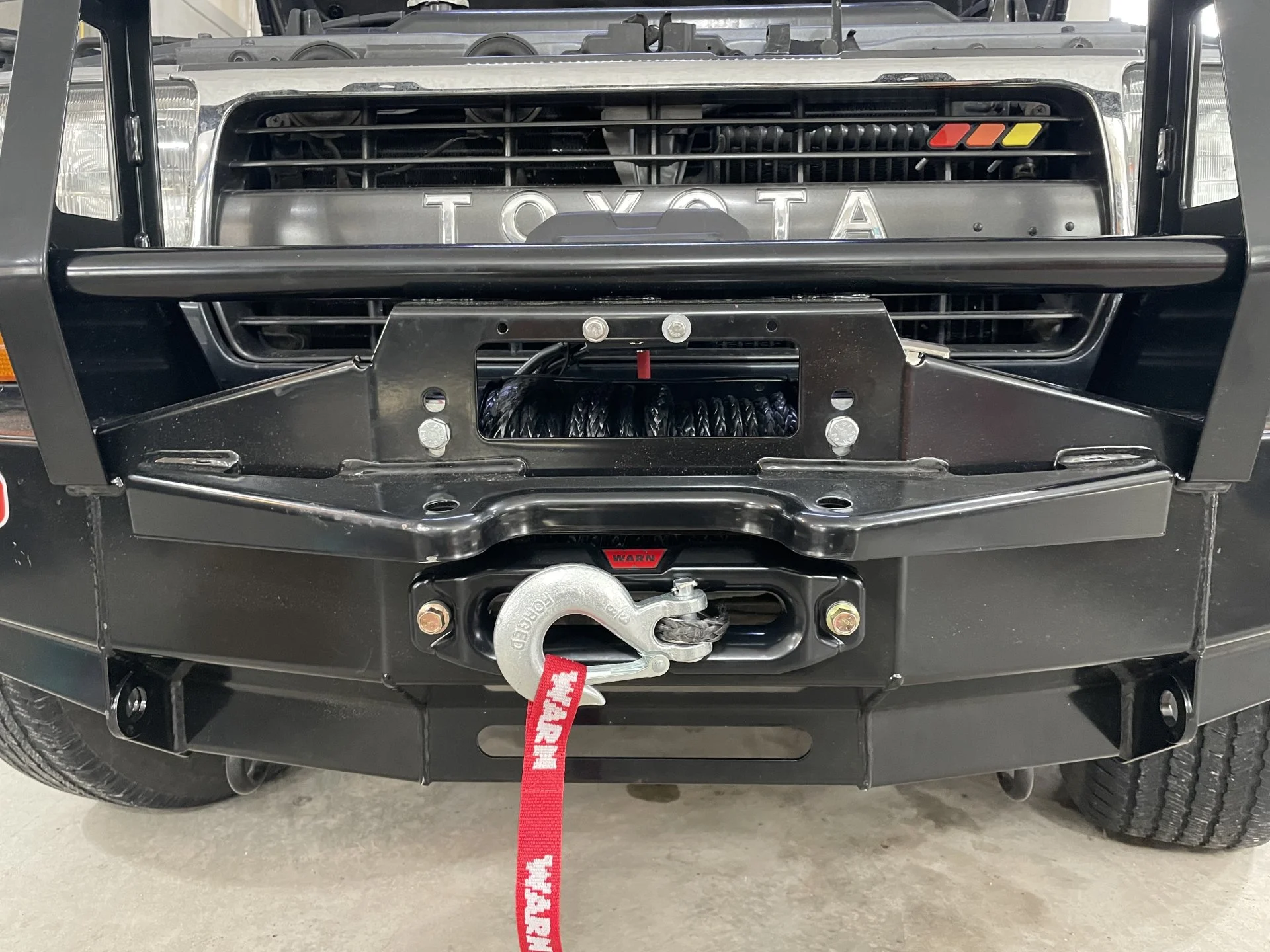

Well in case anyone else is wondering, the VR 10 Evo mounts perfectly foot forward (about 3/4” spacers needed like what Roket mentioned). Control box and clutch in default setting with good room and easy access to the side
I was having a good amount of work done on the 80 and decided to throw this in there with the garage. They did it in no time, without having to remove the bumper.

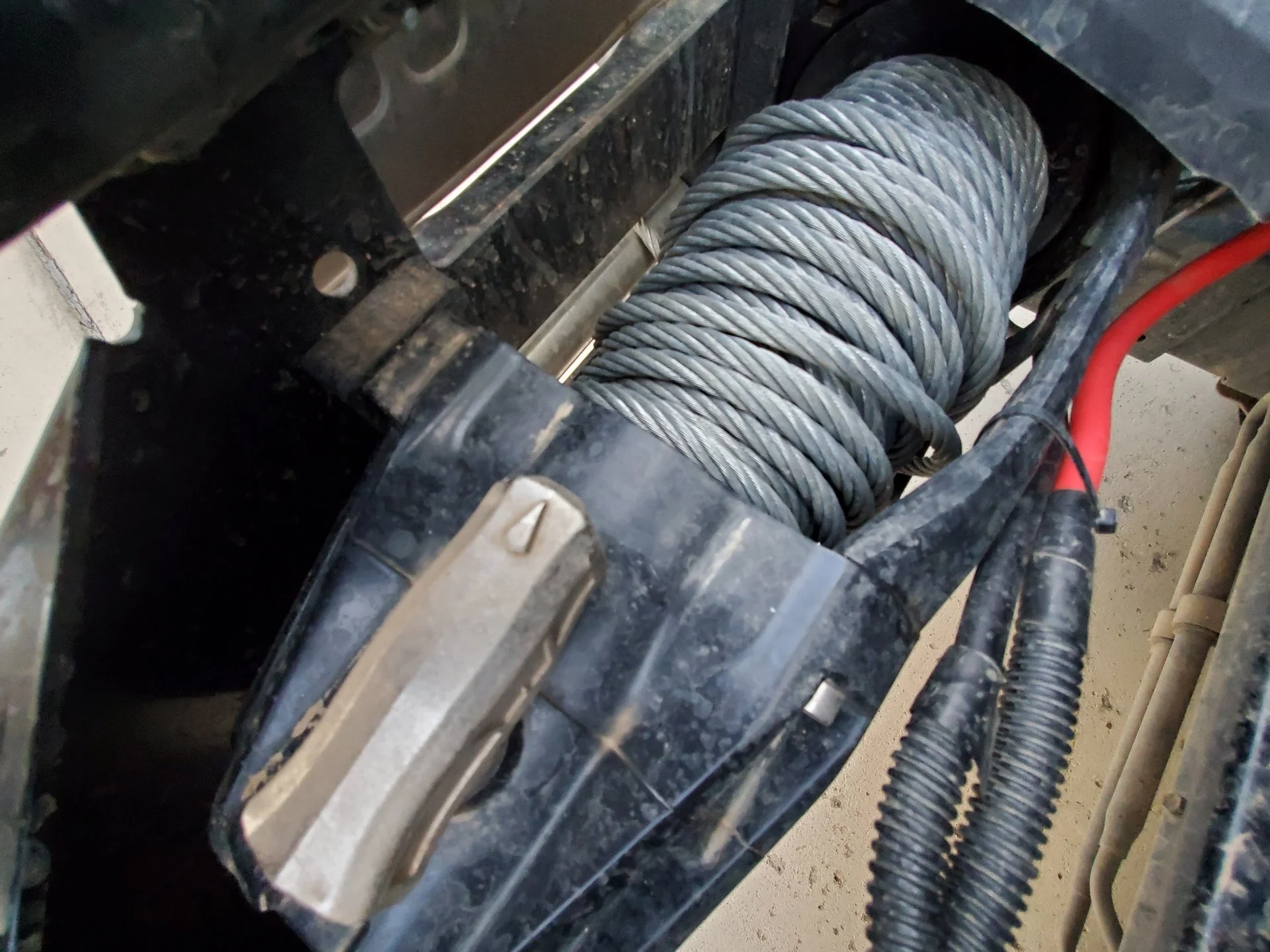

I was looking at the same winch and wondering the same thing. Did you have to make the spacers or did you buy them? Why do the photos of the 12k look like the winch is in a different position than your pics of the 10k? Almost like yours is mounted to the front to the bottom of the winch? That is the standard position?
My install looks different because I clocked the free spool lever and made a bracket for the control pack.

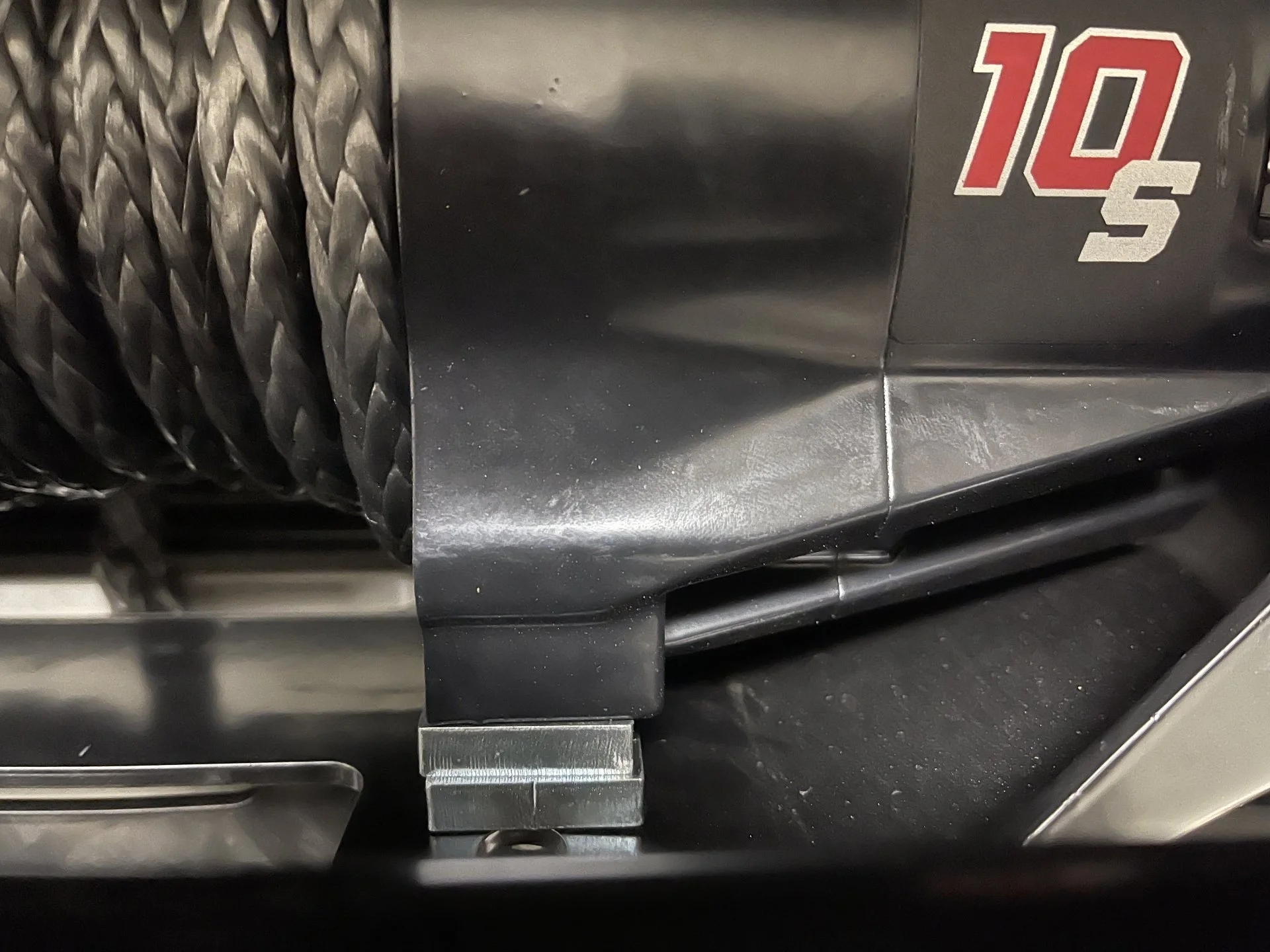

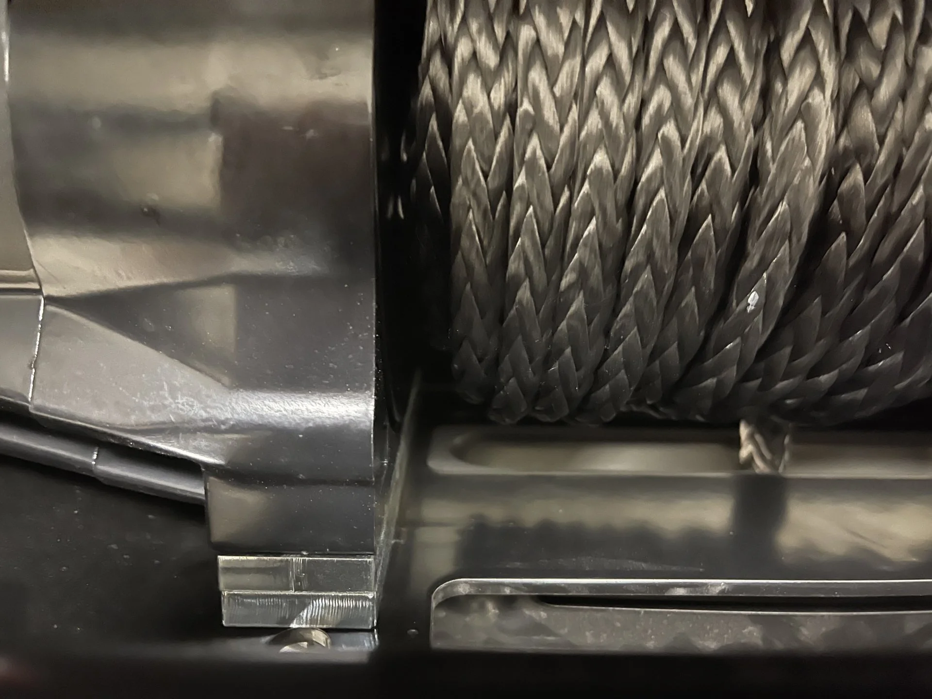

I had already made the decision to run a Warn Evo 10S when I came across this thread so I figured I'd share what I did to make this work. I installed my bumper and winch this morning. I also ordered the ARB winch spacer kit #3500050 which comes with some bolts, 4 spacers and a control unit bracket.
I couldn't see how you could mount the winch without a bit more spacing than the two per side. @2000cruiser was able to looks like, but there must be some variance in bull bars, mine was making contact with the bar. So i got some 1/4" steel and made two more spacers.

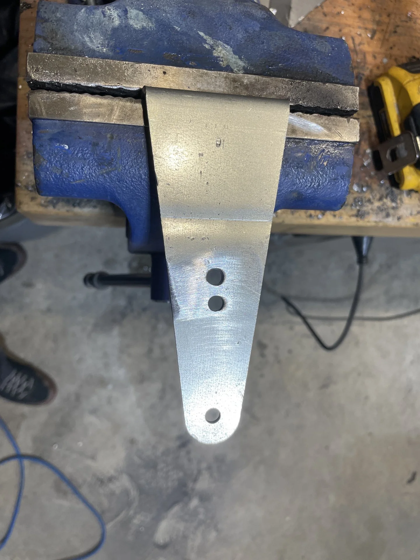

The bracket that comes in the kit is bent at an angle. I threw it in the vise and straightened it out.

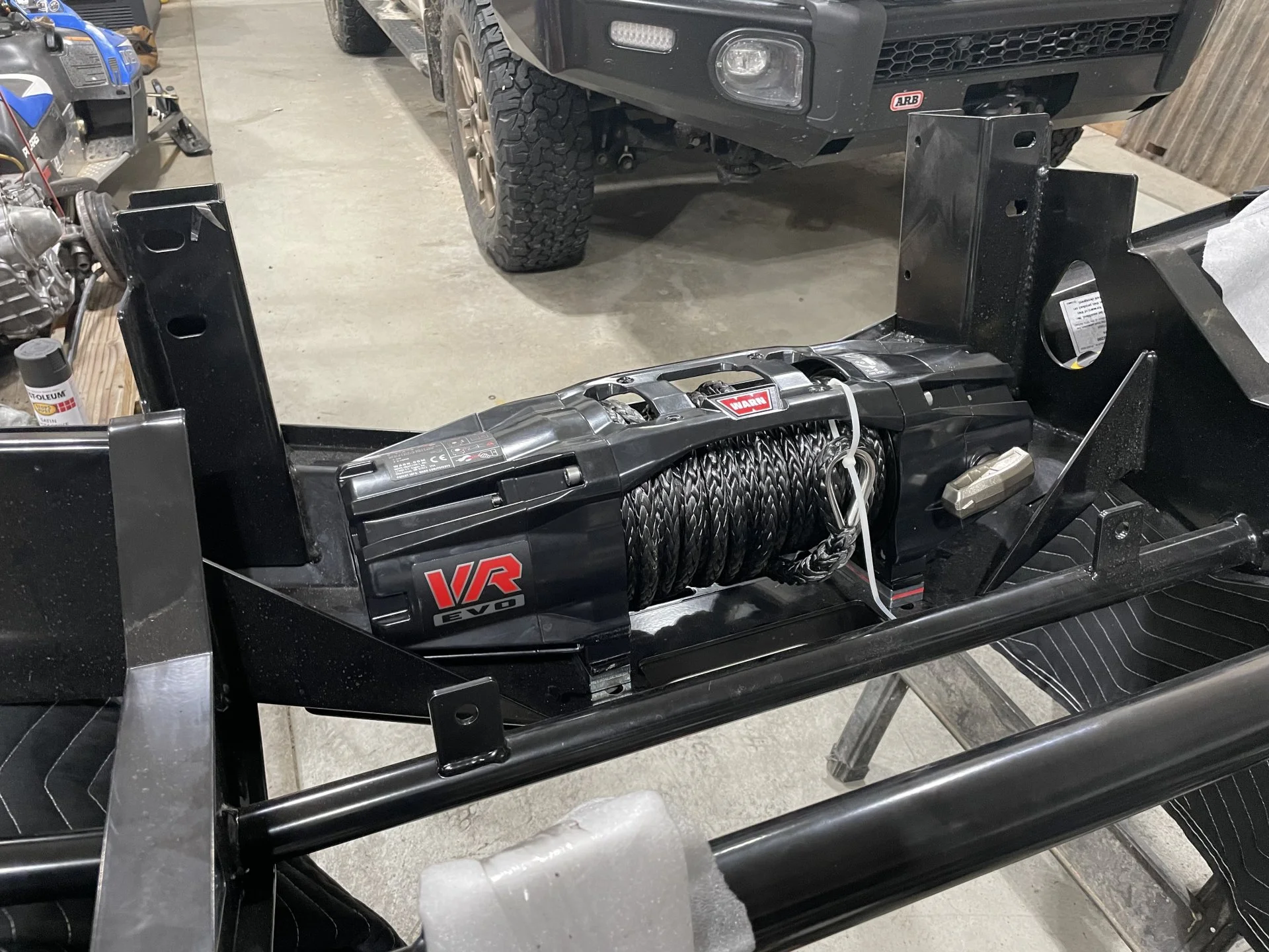

With the three spacers it mounted up nicely. Before mounting I clocked the winch to position the handle where it would be easy to access. As with every winch I have mounted, none of the bolts with the winch or in the winch mount kit were the right size. Either too short, or too long. So i had to go find some bolts the right size.

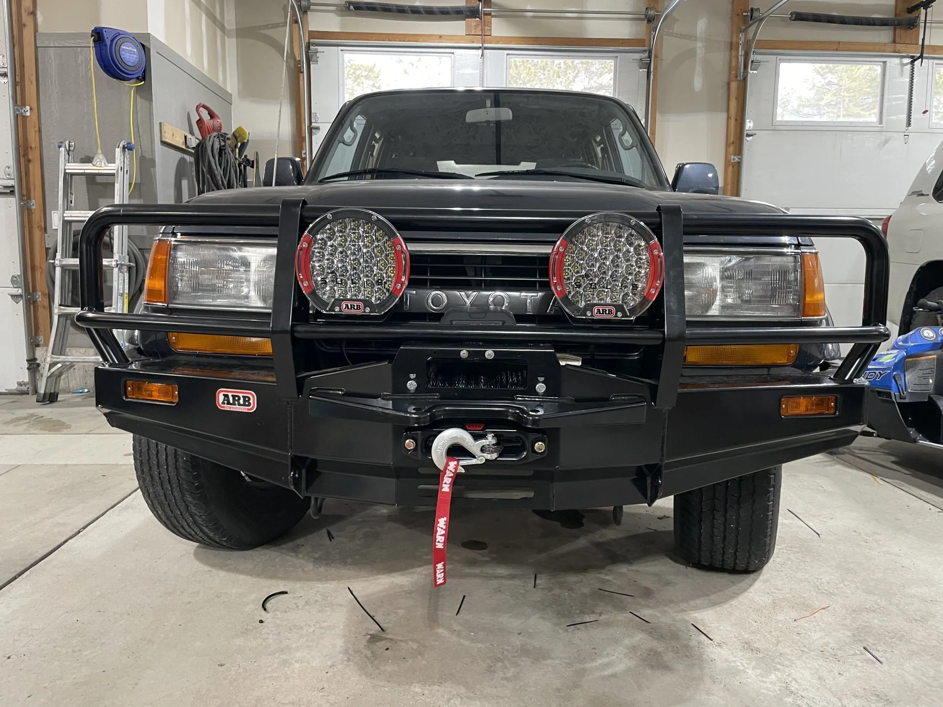

ARB Solis lights fit too if anyone in wondering. Just required 1/4" spacer between the light and the bracket on the bumper. The shape of the rear housing on the light curves just right to miss the bar above.

I installed my EVO 10K winch in the default position and mounted it with the bumper installed. I used a piece of wood and lifted it from the bottom and set it on the wood then fought the bolts for an hour or two. Requires the 3/4" spacer plates. On the left side the housing is touching the bumper so might need to add a 1/16" plate to that side. I like how it is hidden in the default position. BTW, it doesn't come with instructions on how to clock it.
