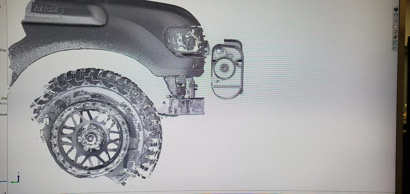

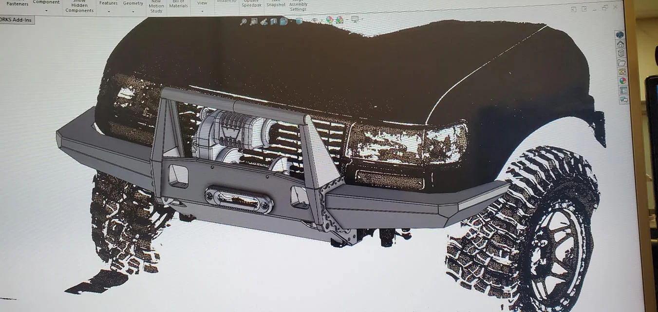

I scored a 70th Anniversary addition 8274 a few months ago. Got a buddy designing me a bumper for it. Going to have to cut the grill a little but the clearance will be worth it. Can't wait to get it installed.

I was trying to maintain the best approach angle, if you look closely you can see we are notching the frame just slightly as well. Pics showing tucked vs untucked:

Your call of course. But we are probably talking just a few inches which would not require the entire span of the bumper be moved forward just the area where the winch resides. Unless you were to encounter dips or stair-steps that HAD to be met straight on (instead of angling across them) its doubtful it would cause you any problems. I'm assuming you are already (or will be) 'lifted' some amount?
If you are building for 'hard core' off-roading and approach and departure angles will be common limiting factors....then a different winch might be a better choice. If you are in the moderate to advanced group then I wouldn't think butchering the grill, bumper or frame would be necessary just to accommodate the 8274.
But its your project. Love to see it when its all done. Good luck with it.

Well I’m not too concerned about cutting anything. I’m already lifted a few inches and on 35s, it’s just a woods toy. And a different winch would be better but I had a friend growing up that his dad had a 8274. I bought mine because I thought the world of his dad and I always smile and remember the good days when we were kids when I see one (stupid I know but it’s the little things in life that bring you joy).

I too would extend the bumper out some to accommodate without grille interference, it would also make reaching the In/Out handle slightly easier.

Understand the winch model choice it is far and away my favorite. Been running the same one since 1983 (bought new).

The In/Out handle is a concern. Also a little worried about blocking cooling to the radiator since the winch is so huge... Guess I'll tackle that next if it becomes an issue.
Not to derail the excellent 8274 thread, but I am working through a couple of mods to improve the cooling of my 80, one is to remove the giant Lights I had mounted on the ARB that I felt blocked some airflow.
If you are using as a woods truck, it may not block as much air and be as critical, but space between may not hurt.

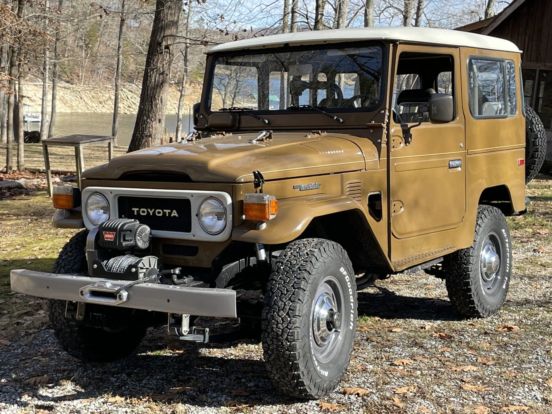

Oh man.....my favorite color on a Fj40 !
IMO the 8274 looks better on a FJ40 bumper than any other vehicle. Its not hidden behind of bunch of tubing, lights, etc...
Just standing there in all its majesty. Great pic.
