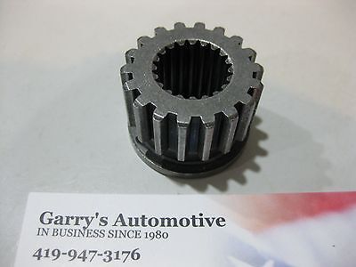

Looks like it's still somewhat available on amazon:
Amazon product ASIN B001U7K2NW
EDIT: This is the gear to go on the new motor you're putting in. This works to retrofit to an 8274, not sure on the older bellviews.
I rebuilt my 8274 following the mud threads, using the 9.5 and new spline gear, direct bolt in.. Easy. I kept my old solenoids and switch and they work great as a unit. . Had to run a separate ground. No worries. I'll eventually go to the newer solenoids, but why if the old ones are still pulling the load.? My thinking anyway.. Good luck
