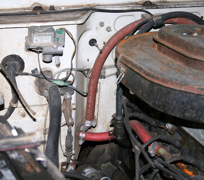

Here is a photo of mine, note the cable poking thru the firewall right near the red heater hose.
Was there supposed to be a valve there? Does this mean that hot fluid flows thru the heater core nonstop - and is that a bad thing?

probably mounts where those two bolts are just up and in from the cable. i'll get a pic of mine tonight or tomorrow when i get home.

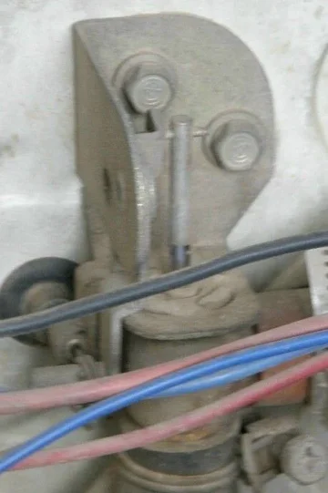

My heater valve rusted out, I just bypassed it (just like pic in post #4). No problem, not even in the summer. I did notice that an FJ60 heater valve looks very similar, mounts in the same location and might be an easy replacement...
