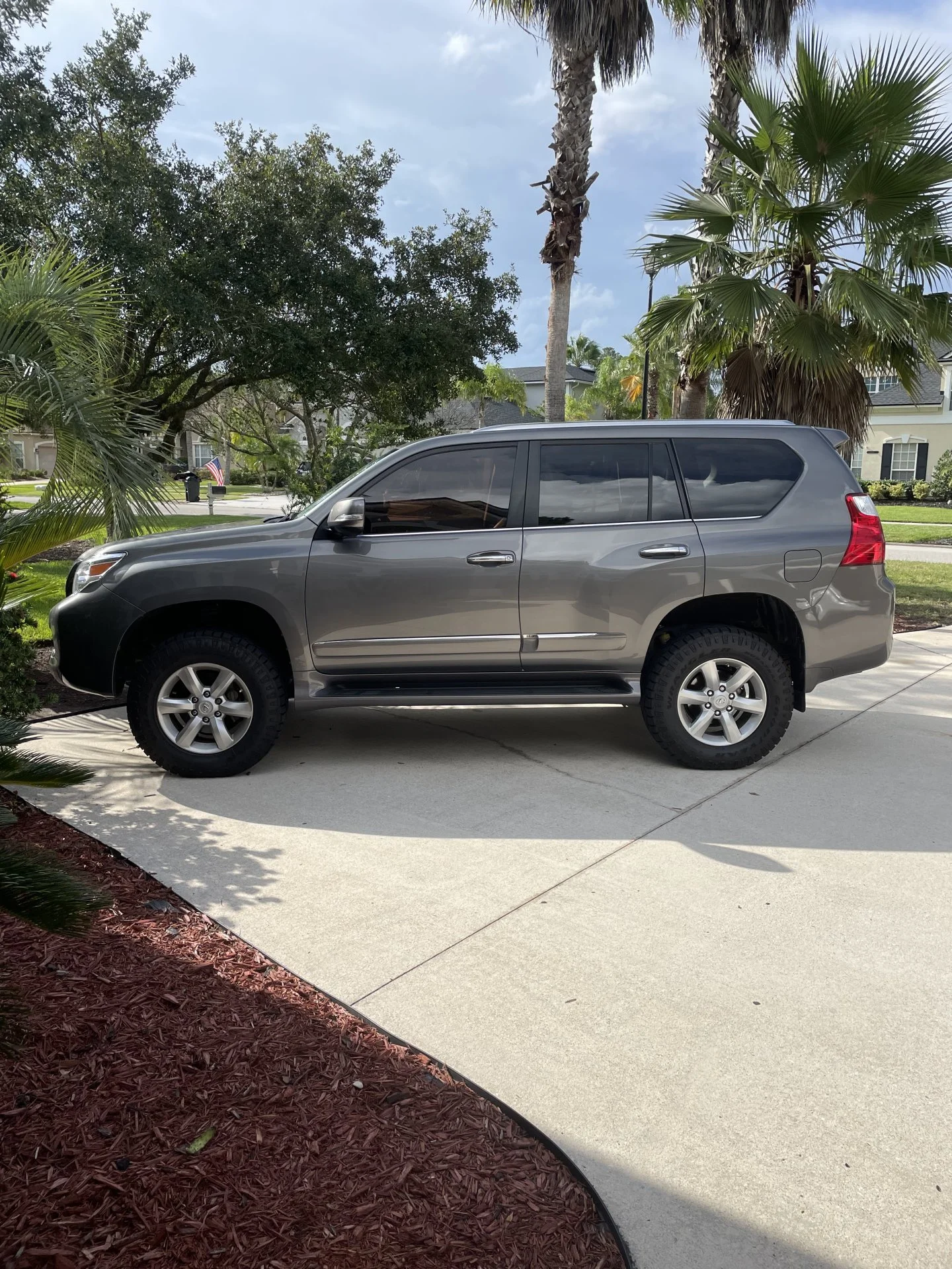

The spare does have a sensor, so if you deflate it, the light will be on constantly. I have 31.5" falken wildpeaks on stock gx470 wheels, spare tire barely fits fully inflated with class III hitch for me, but I have ironman lift. idon't think a 32.5" tire will fit, but I would be happy if someone proved me wtong. Don't all GX460's come kdss?

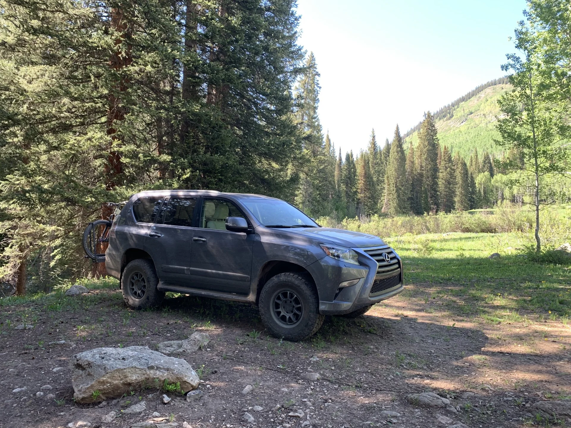

Here's a photo of my 2016 Premium with Dobinsons 2.5" lift and 275/70/R18 Goodyear Ultraterrains. Just a little bigger tire than you requested, but hope this helps.

Tire size look great! Are you getting any rubbing on the body mounts? (Assuming you haven't done a body mount chop yet from the looks of it.)

@sbacon I really like this look. I'm also curious if you have to do anything other than the lift to fit the 33s on the factory wheels.
As I mentioned, with 33's you'll need a body mount chop, even with a suspension lift. Not too expensive, should be less than a couple of hundred dollars.
Pretty much anyone with a 5thGen 4Runner or GX460 and larger tires will have done this.
Any shop that works wirth off road Toyota's (e.g. 4Runners) will have no problem doing this.

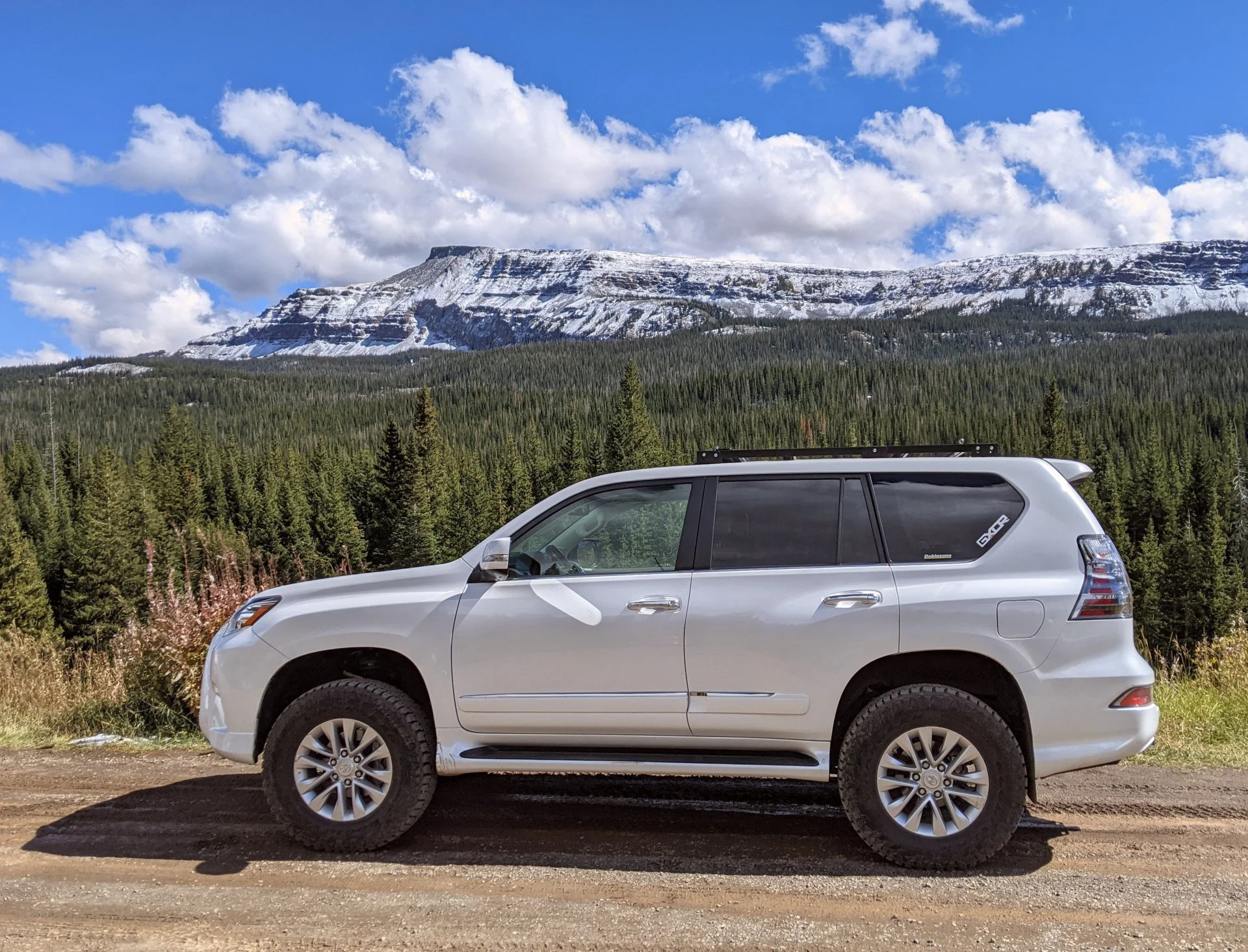

275/65/18 Goodyear duratracs, I was able to fit a no-name 275/65/18 in the spare location with all towing brackets removed.
I forgot to mention that I also added Spidertrax 1.25" spacers. I did just a bit of trimming and heat gun treatment on the wheel well plastic. No BMC needed though.

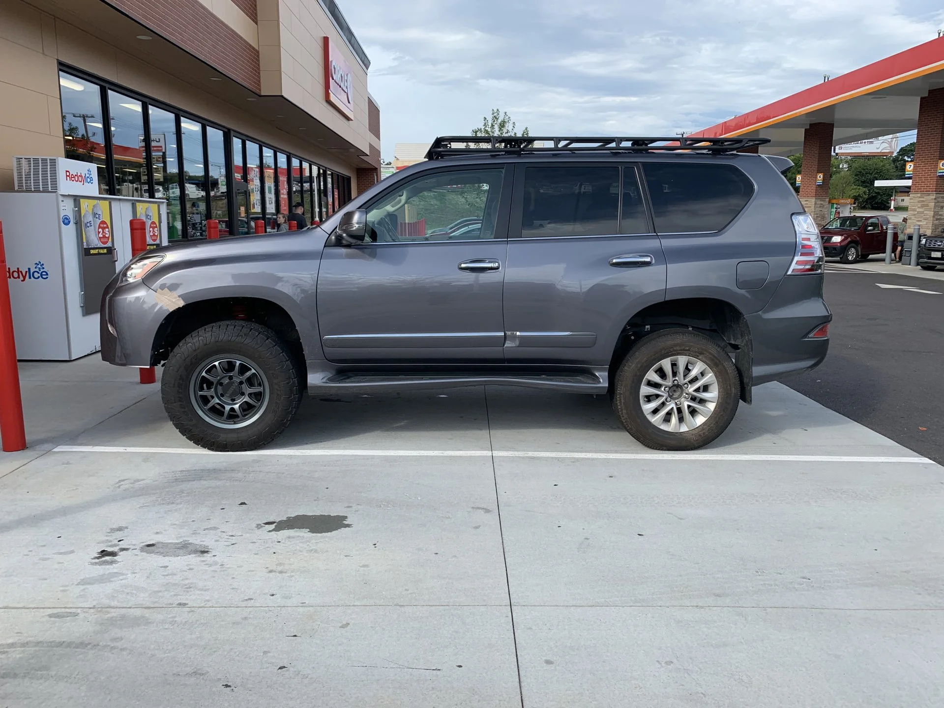

285/70r17 1.9” front lift 2” rear Dobinsons. No BMC here never rubbed. Lots of fender chopping up front. Recently had a flat and used my 265/75r18 which was the biggest tire I could get in stock location. I’d get smaller tires if I had to do it over again. But they do look good and perform great off road.
