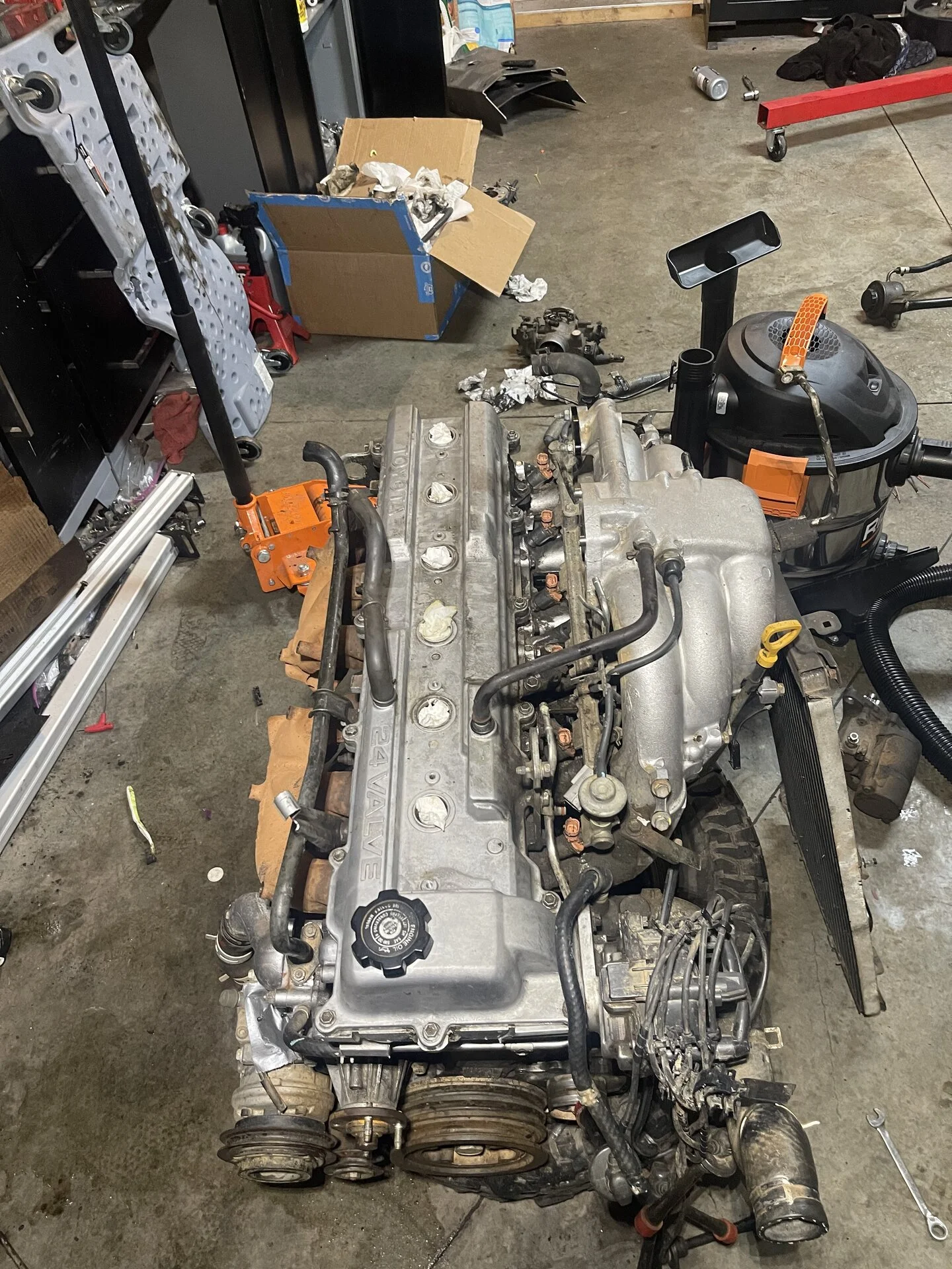

The new engine was prepped to go in

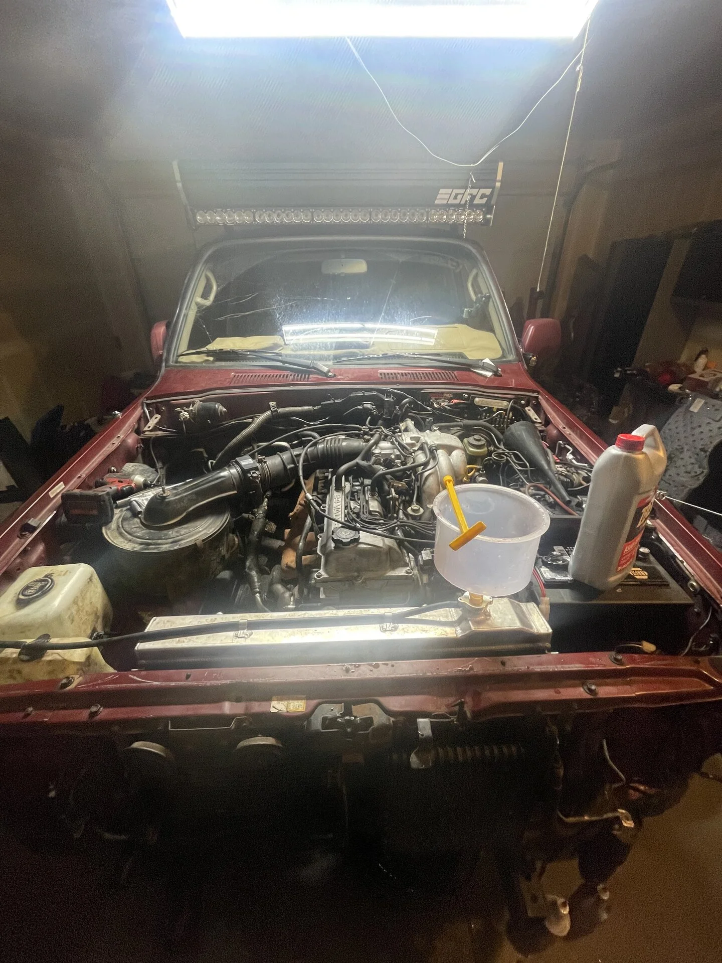

We flat towed the 80 to a nearby car wash to really clean the engine bay and do our best to get the east coast undercoating off of everything.
Came out quite well!

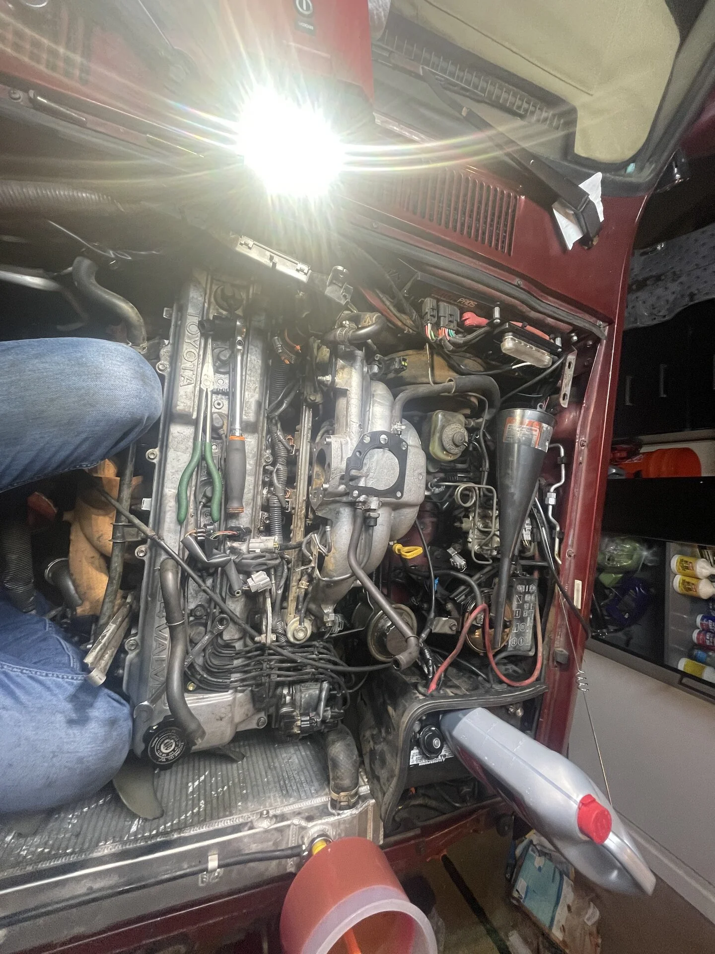

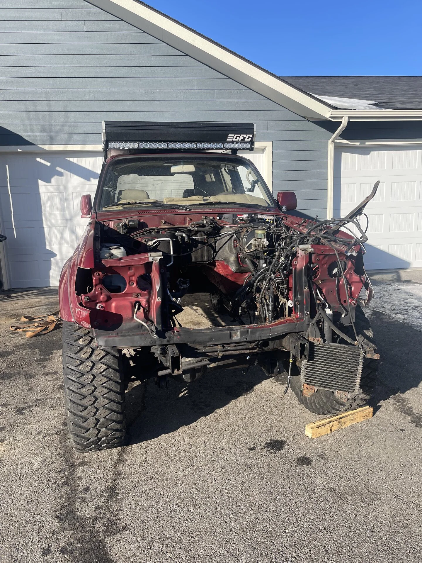

We put the new engine in and it immediately had issues when we tried to start it.
It misfired horribly. Got scared for a little bit, but quickly diagnosed it as broken injector plugs which did not allow the harness to clip on fully. Luckily I had plenty of extra injectors from the engines that I ...ahem... collected. I exchanged the bad injectors and the engine ran beautifully!

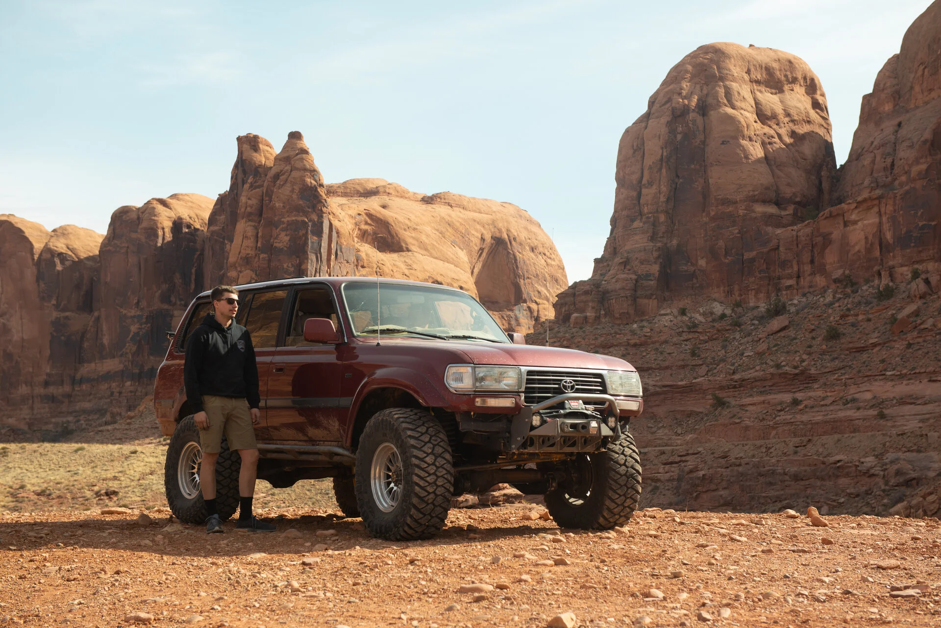

And then took some photos

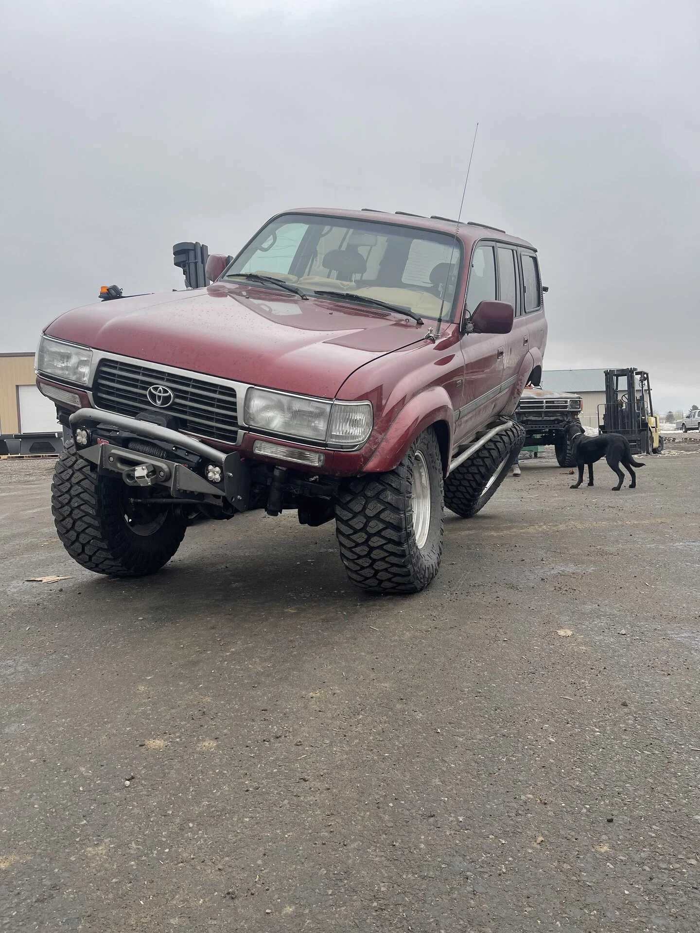

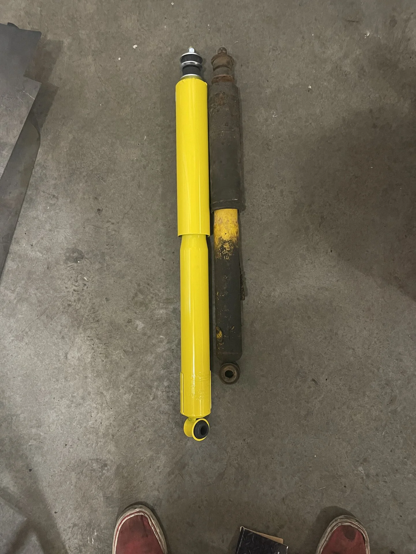

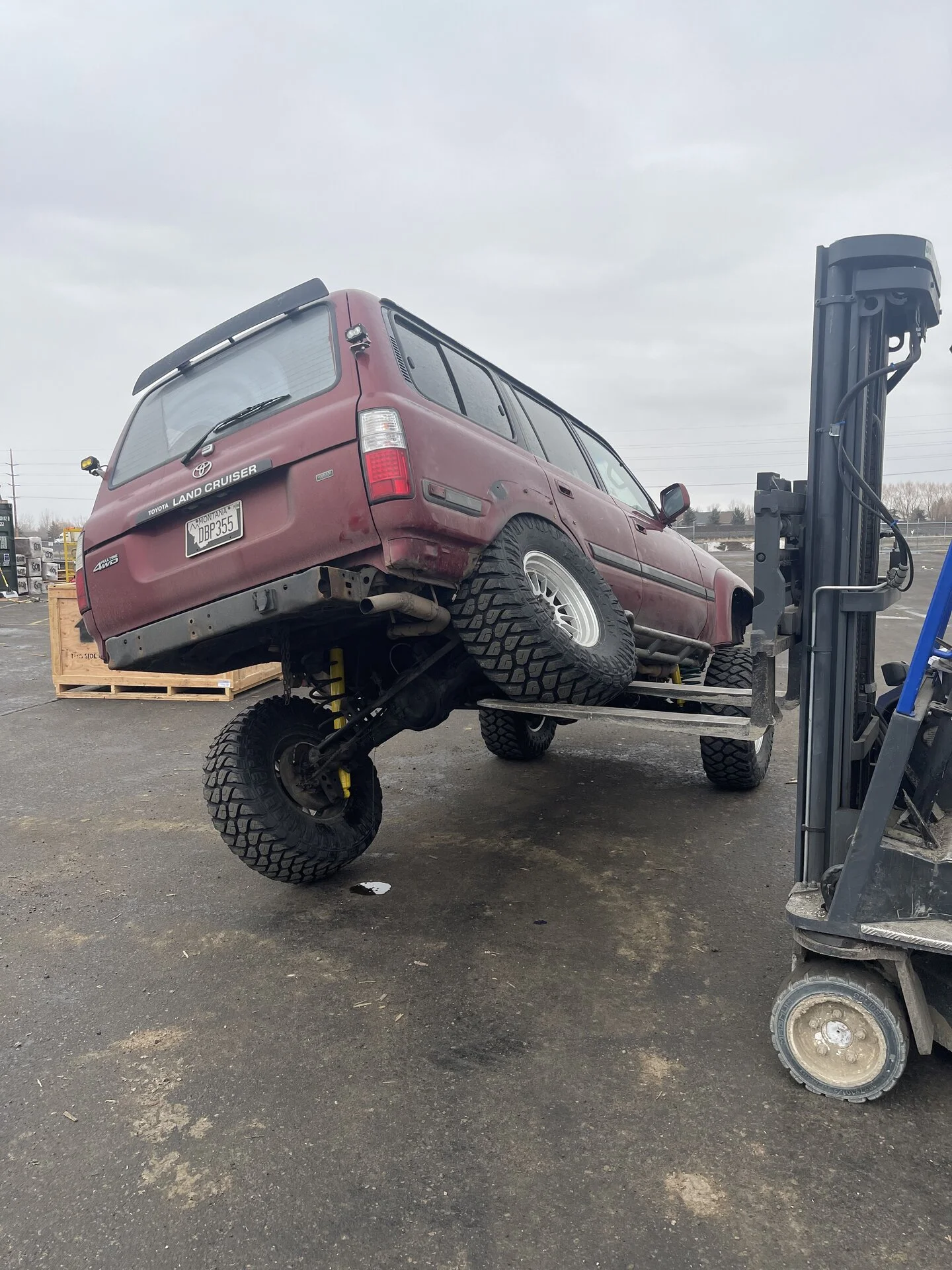

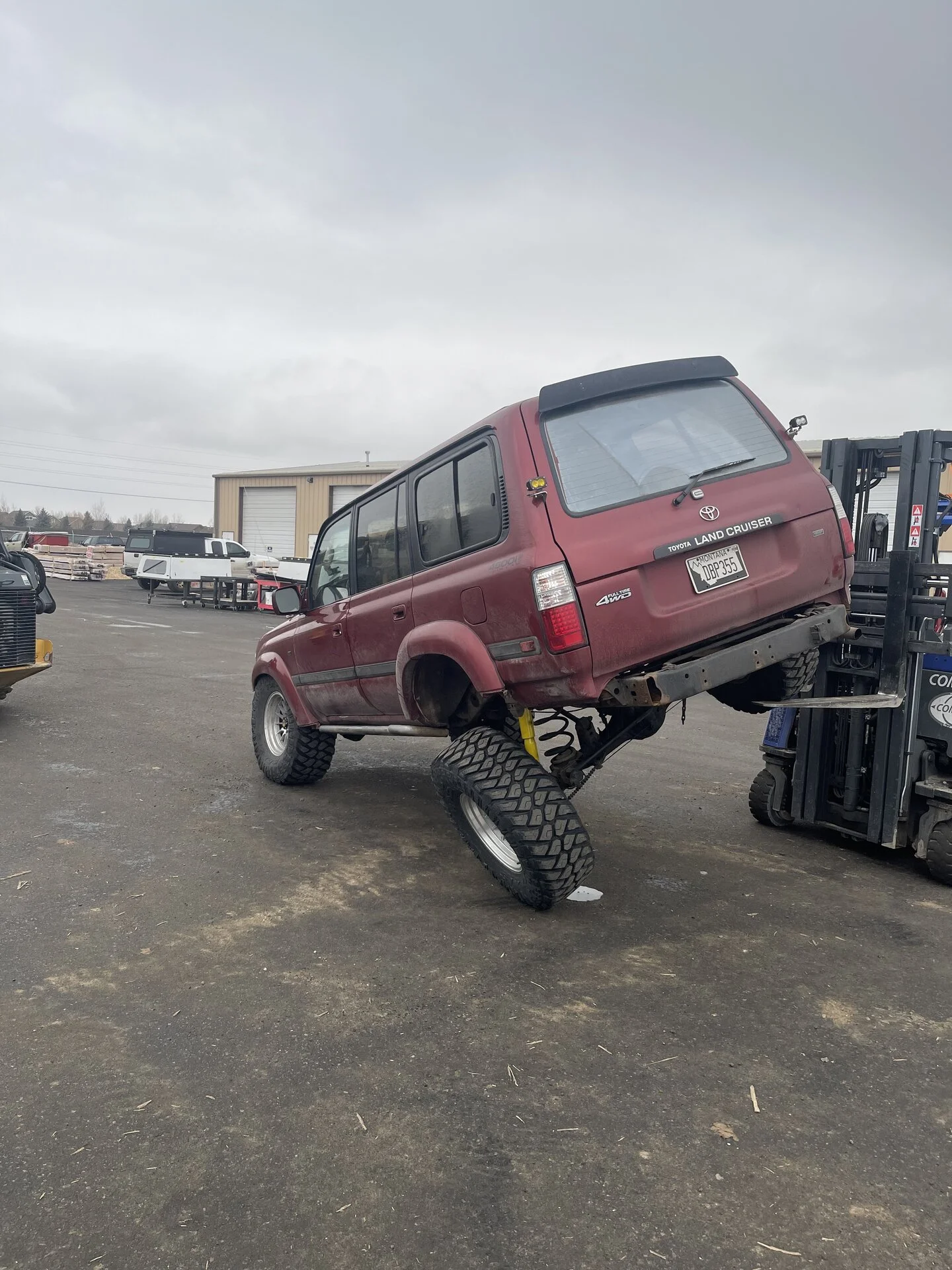

This would have been March 2022 at this point. With the next Moab trip just a couple weeks away, I decided to get some cheap, long shocks from Dobinsons.
I, of course had to cycle them.

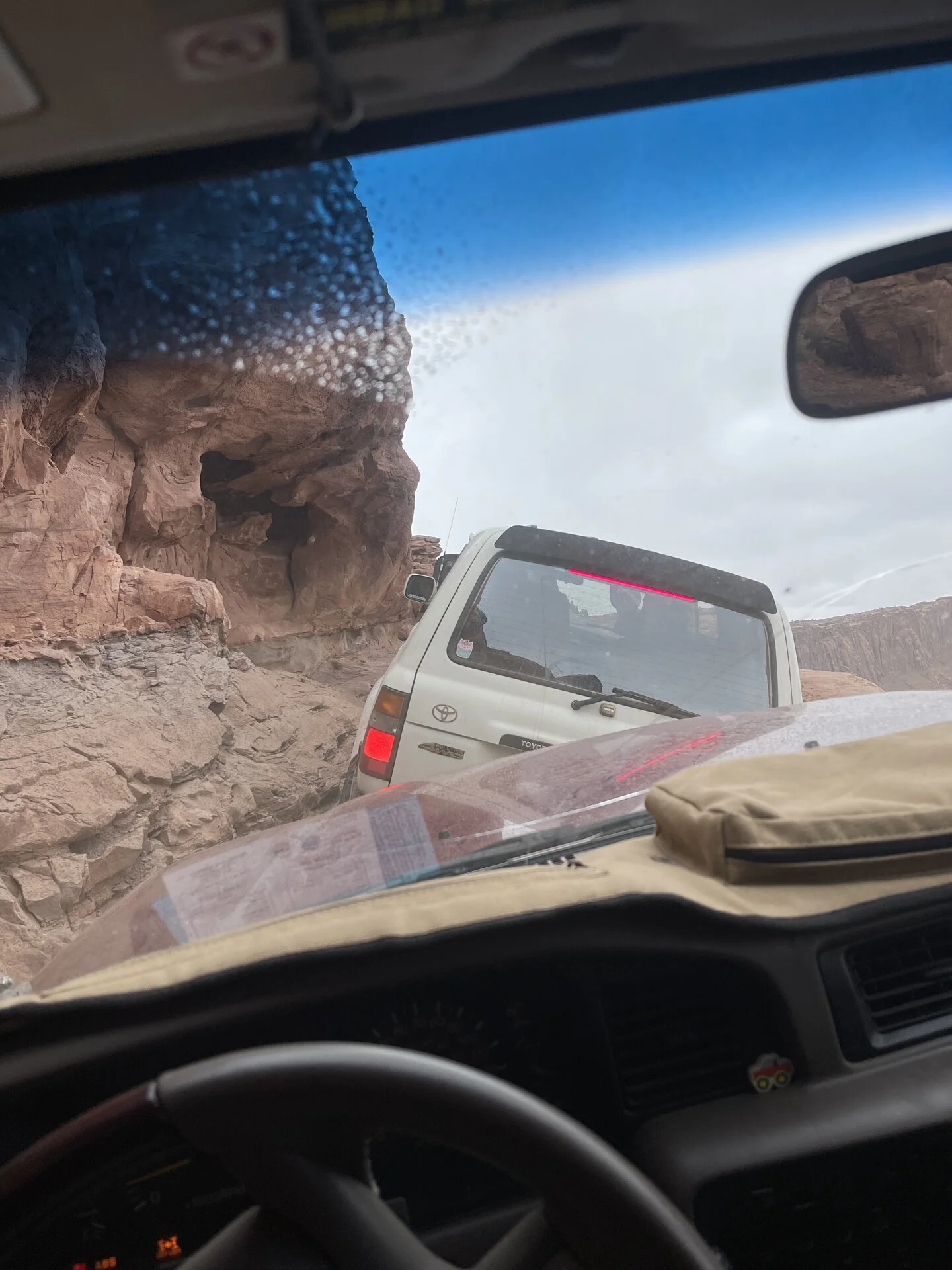

We were "ready" for Moab once again and headed out. It typical fashion for us, we had to drive through a blizzard most of the way through Montana and Idaho.

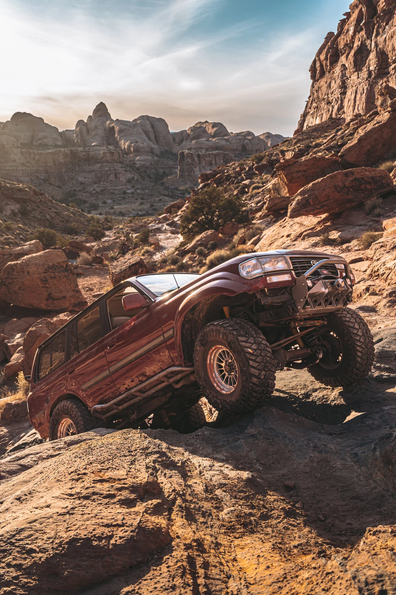

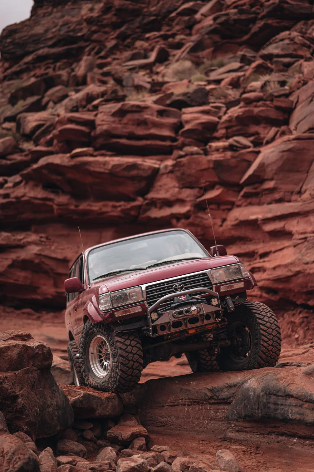

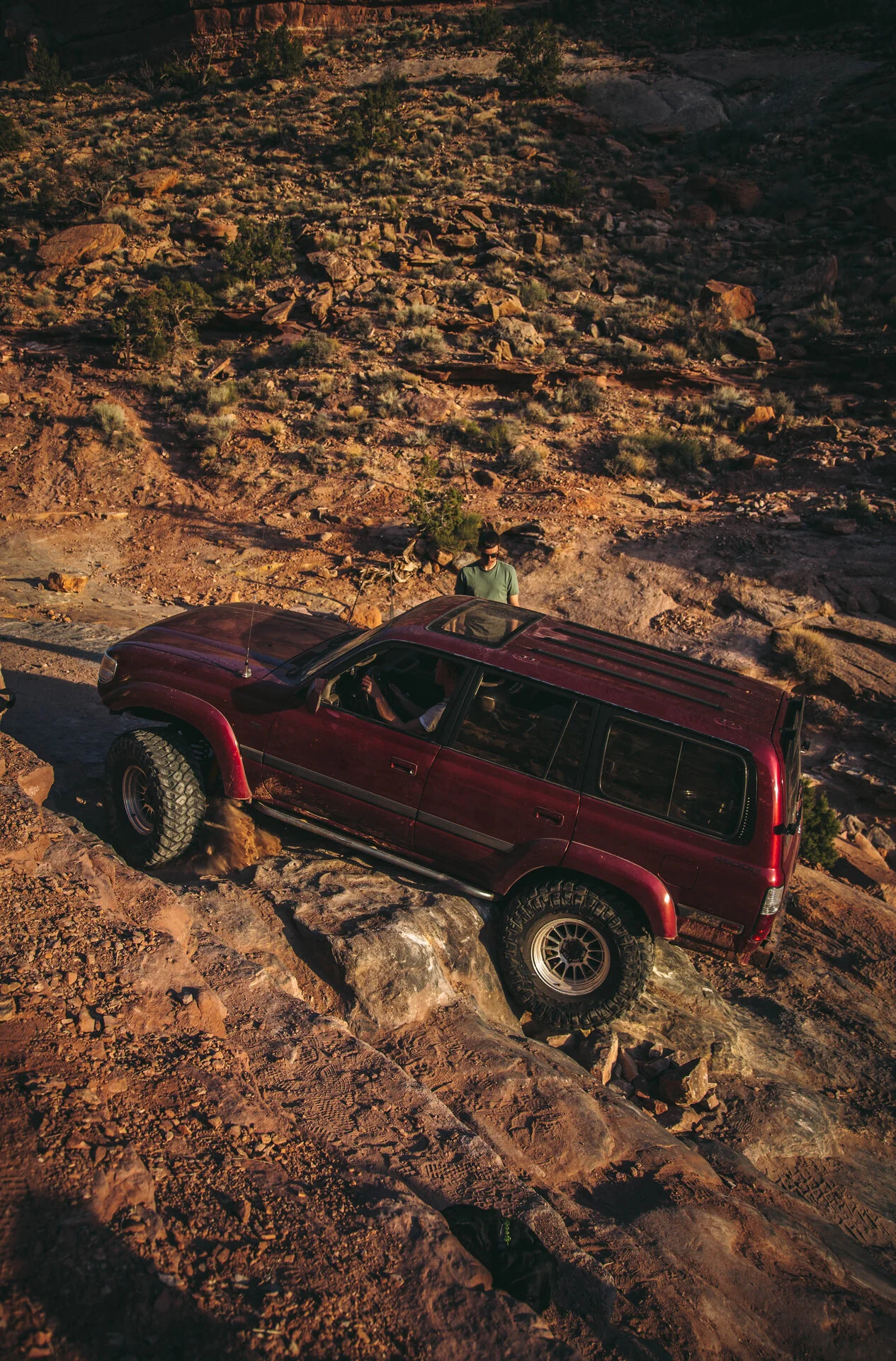

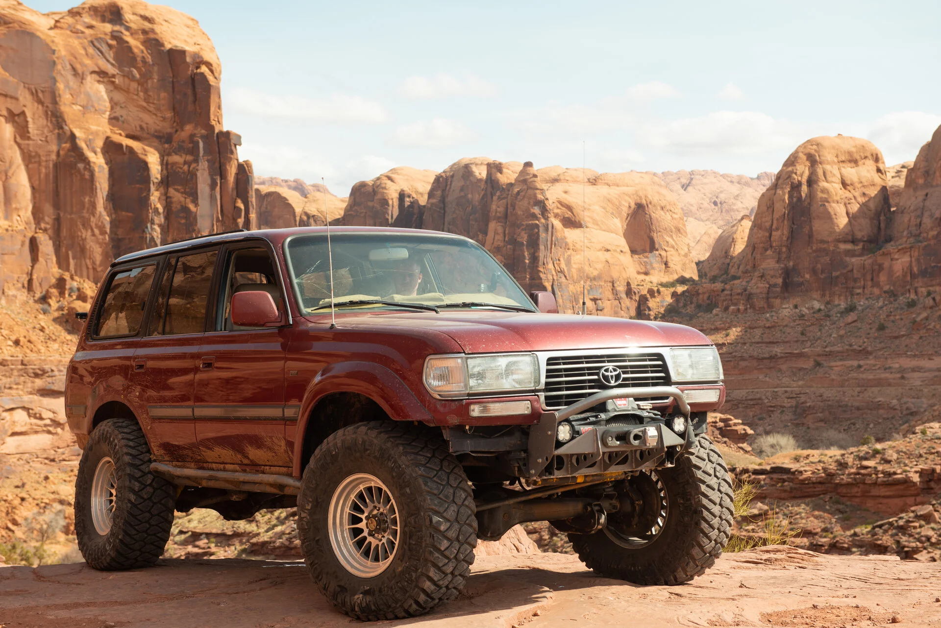

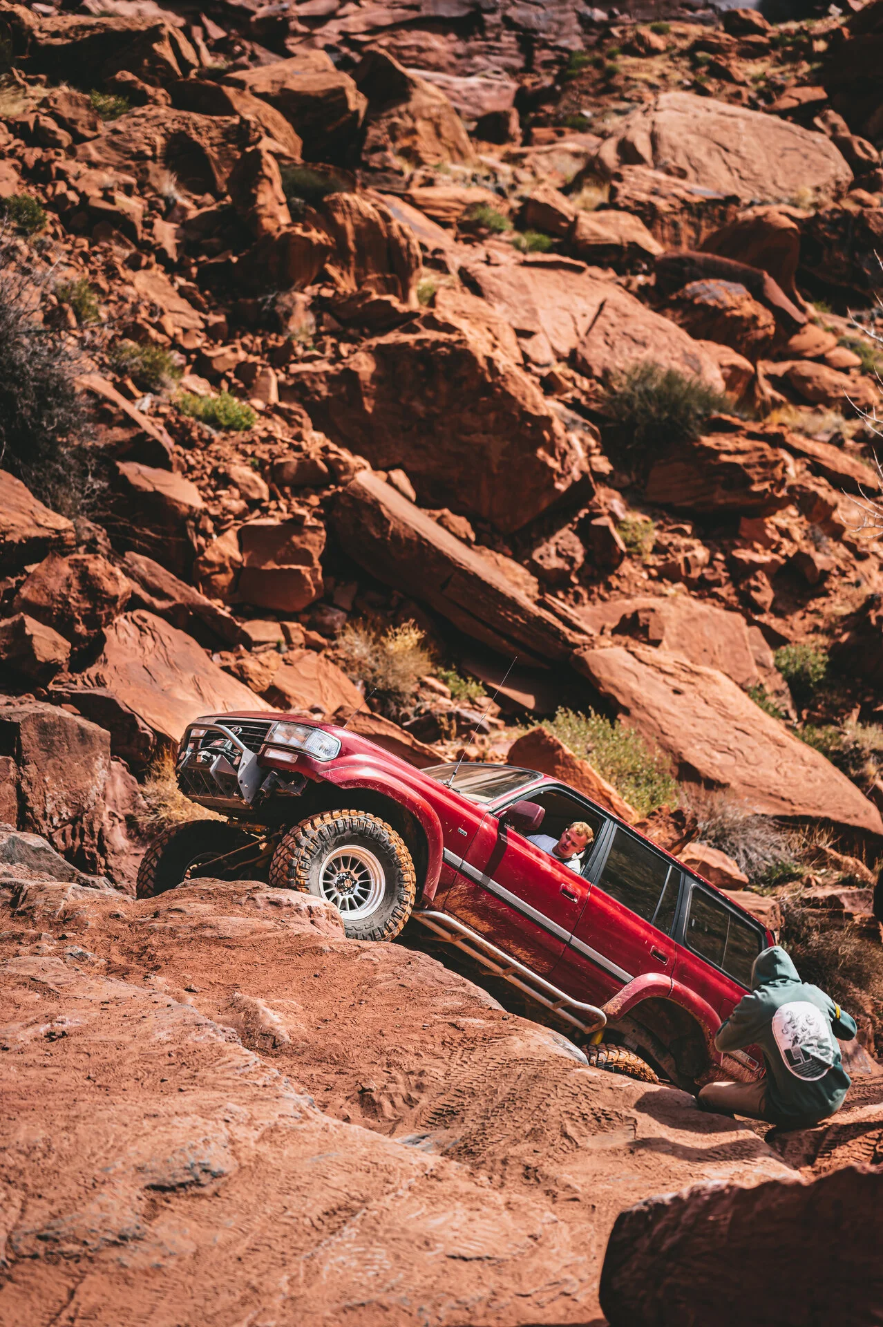

Here are some trails we hit.
Cliffhanger

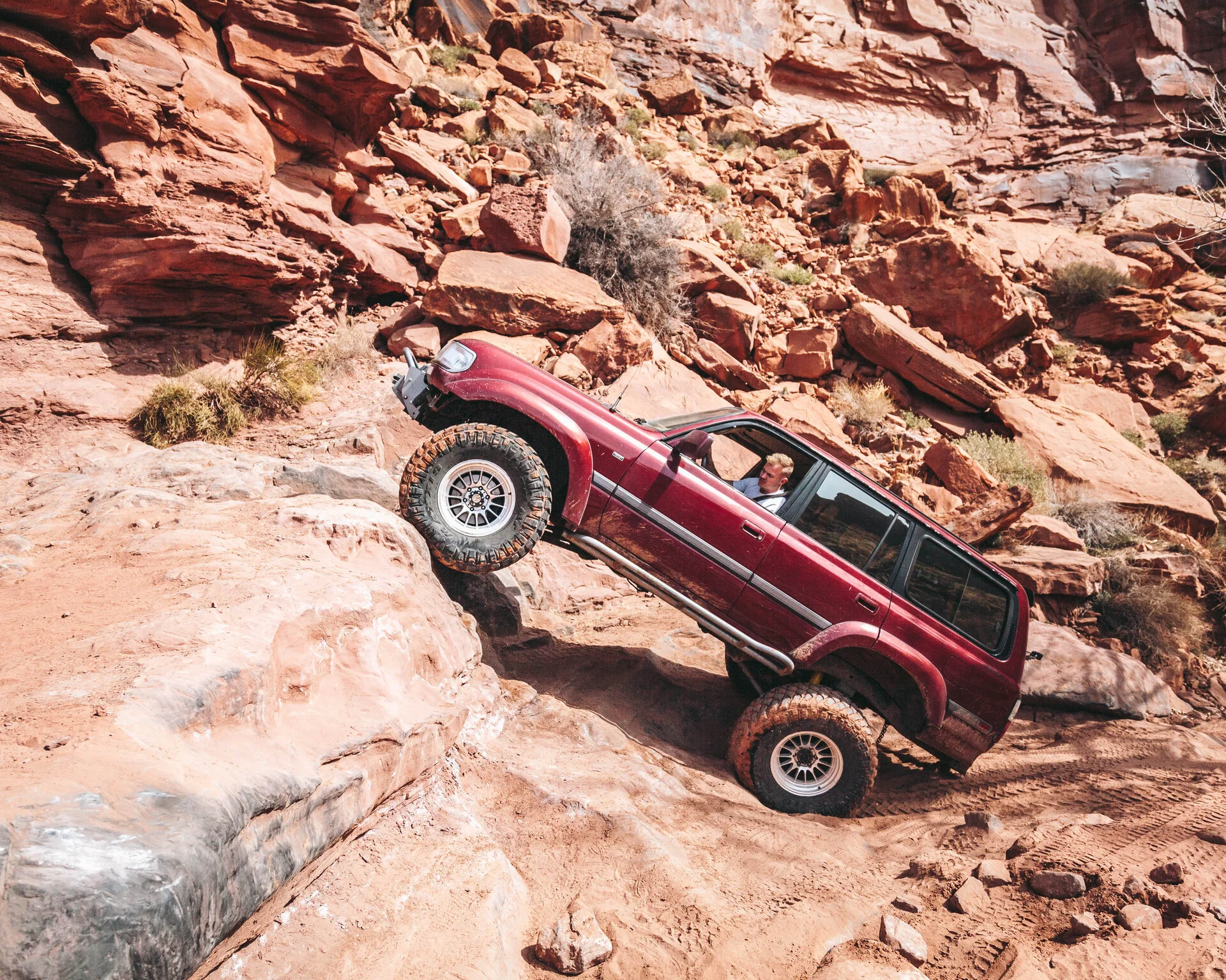

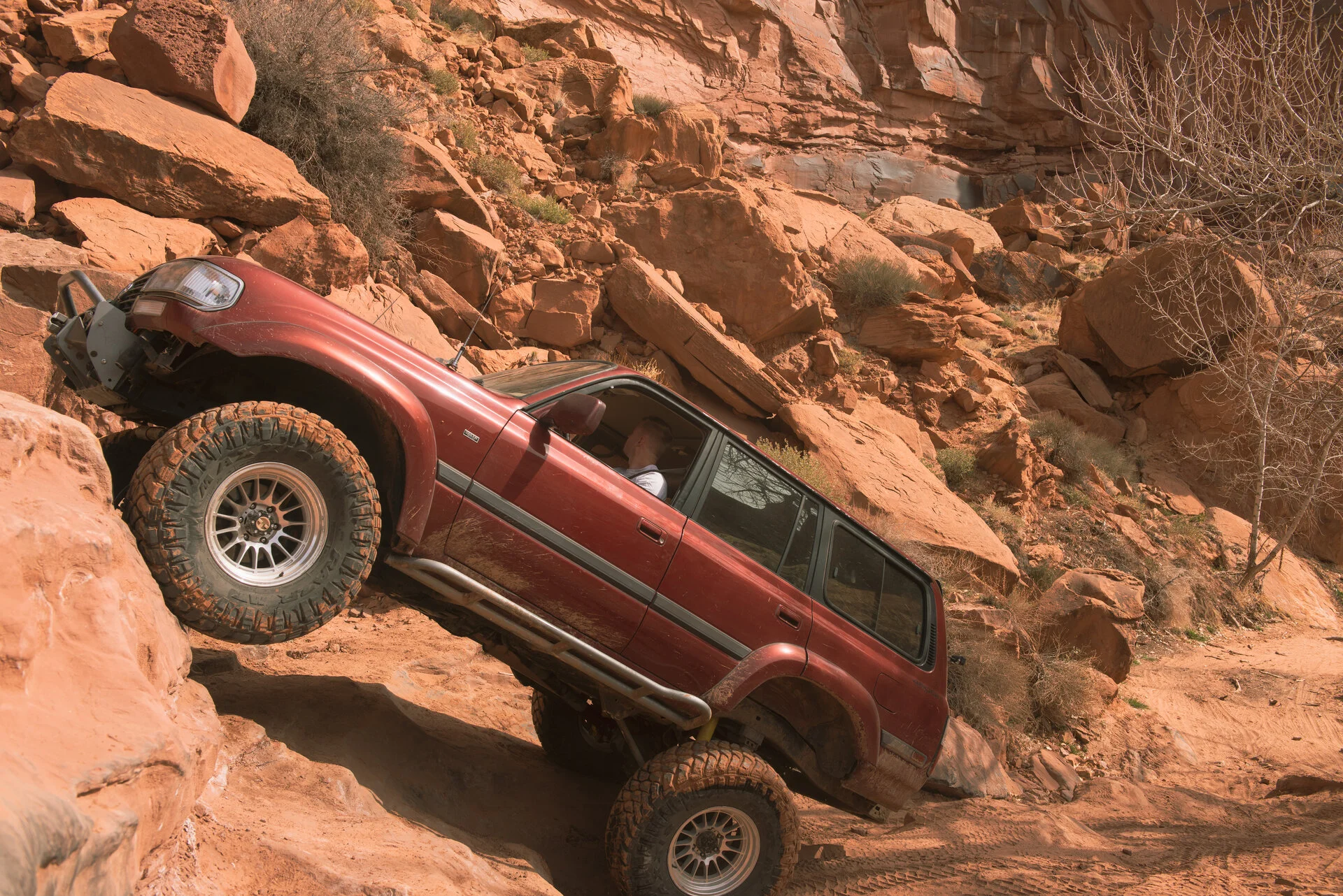

This also happened on Steelbender

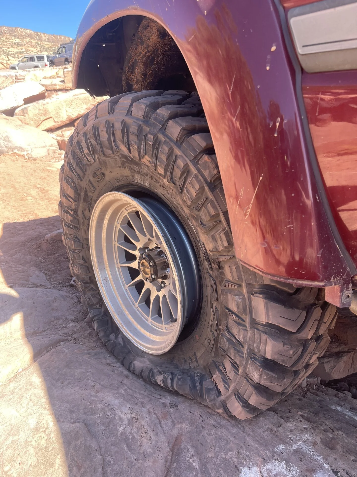

Tire was wedged in a hole and I had to turn into a rock to try to climb up. Was able to back down, reseat the bead and hit it again.
