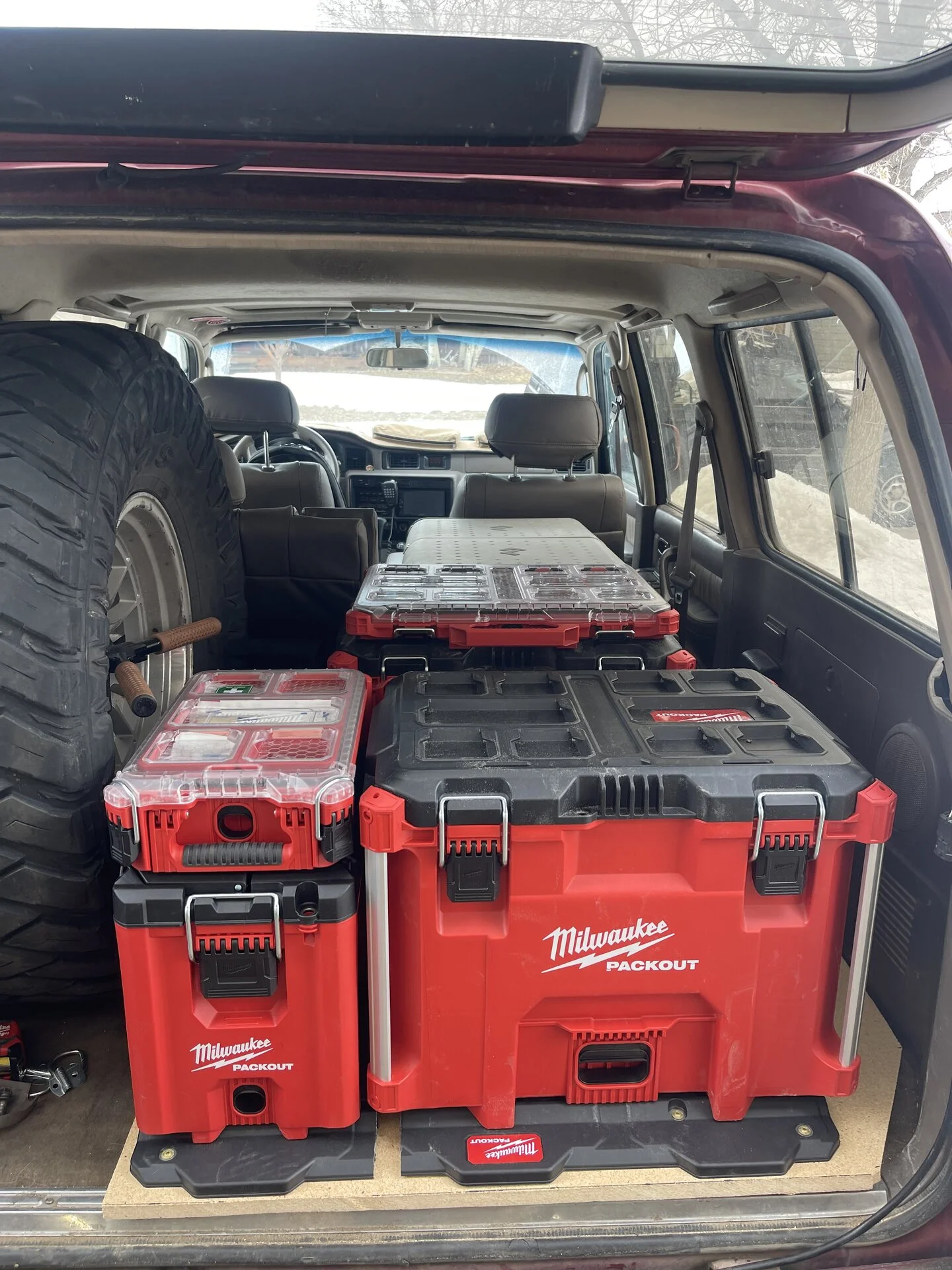

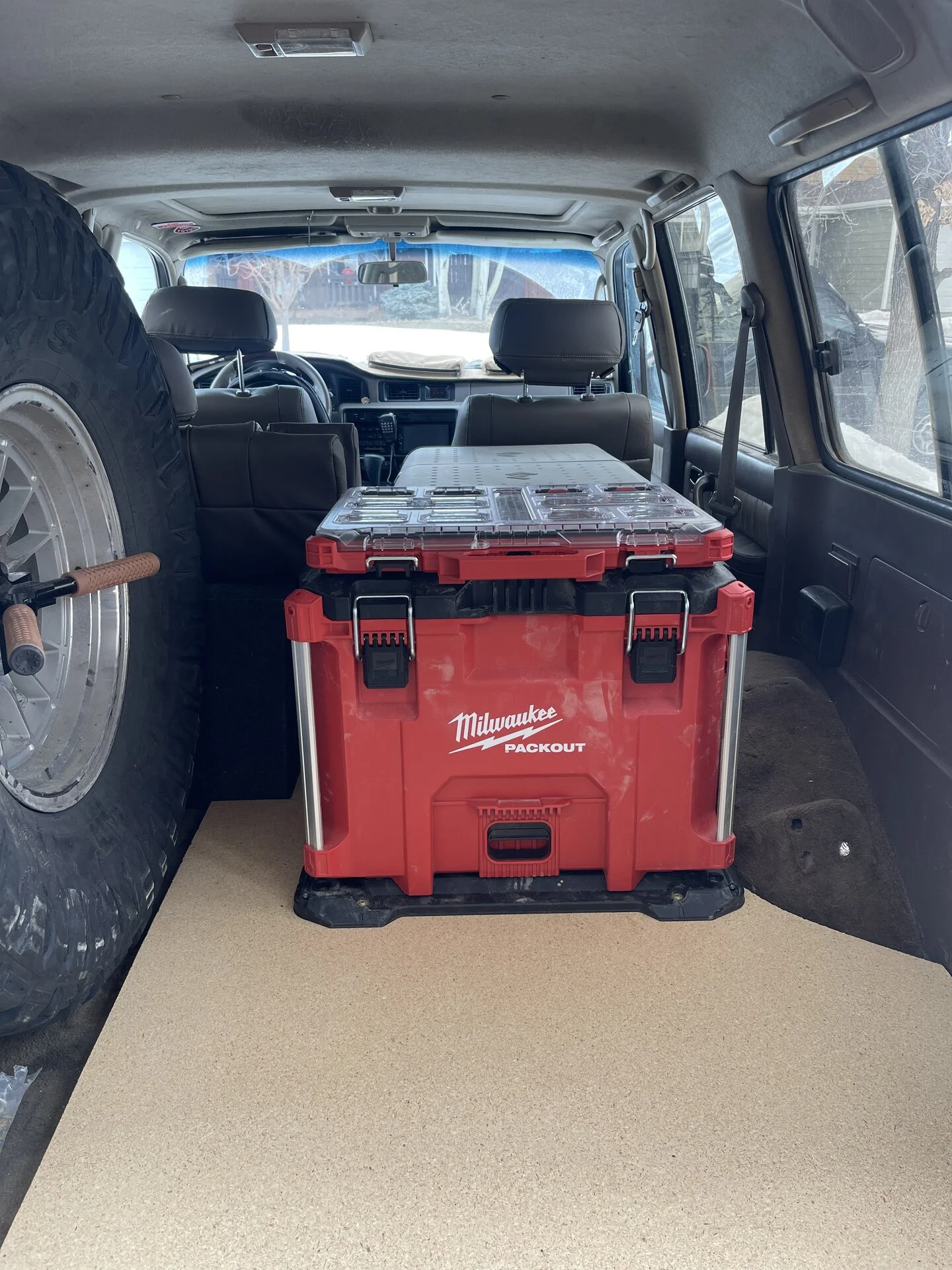

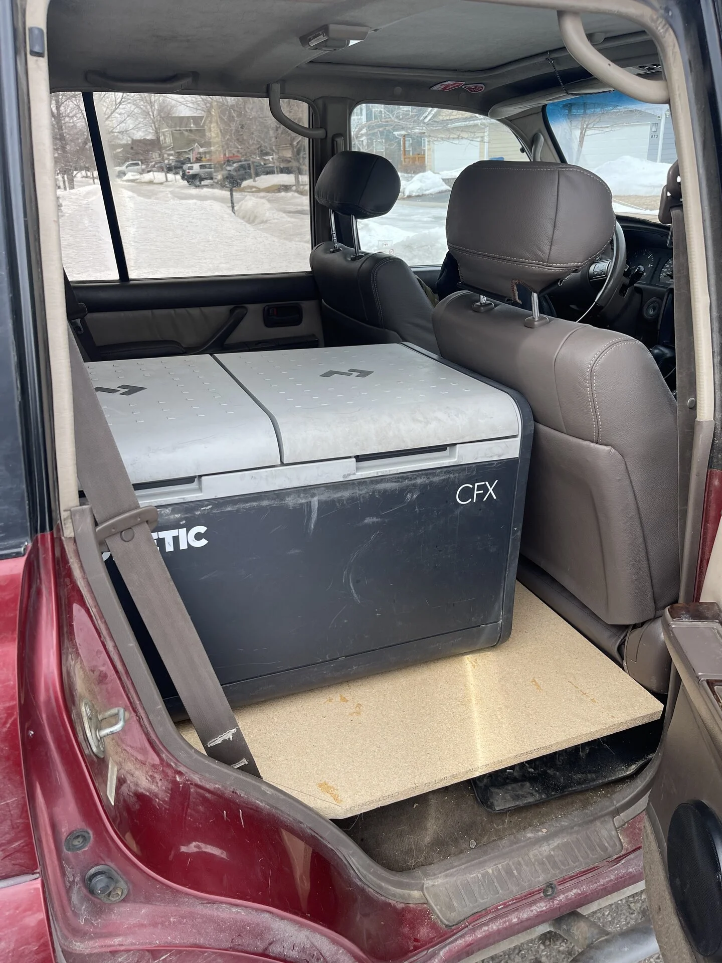

Then, I made a little platform for the fridge and some packouts. I used particle board because it's cheap and a temporary solution.

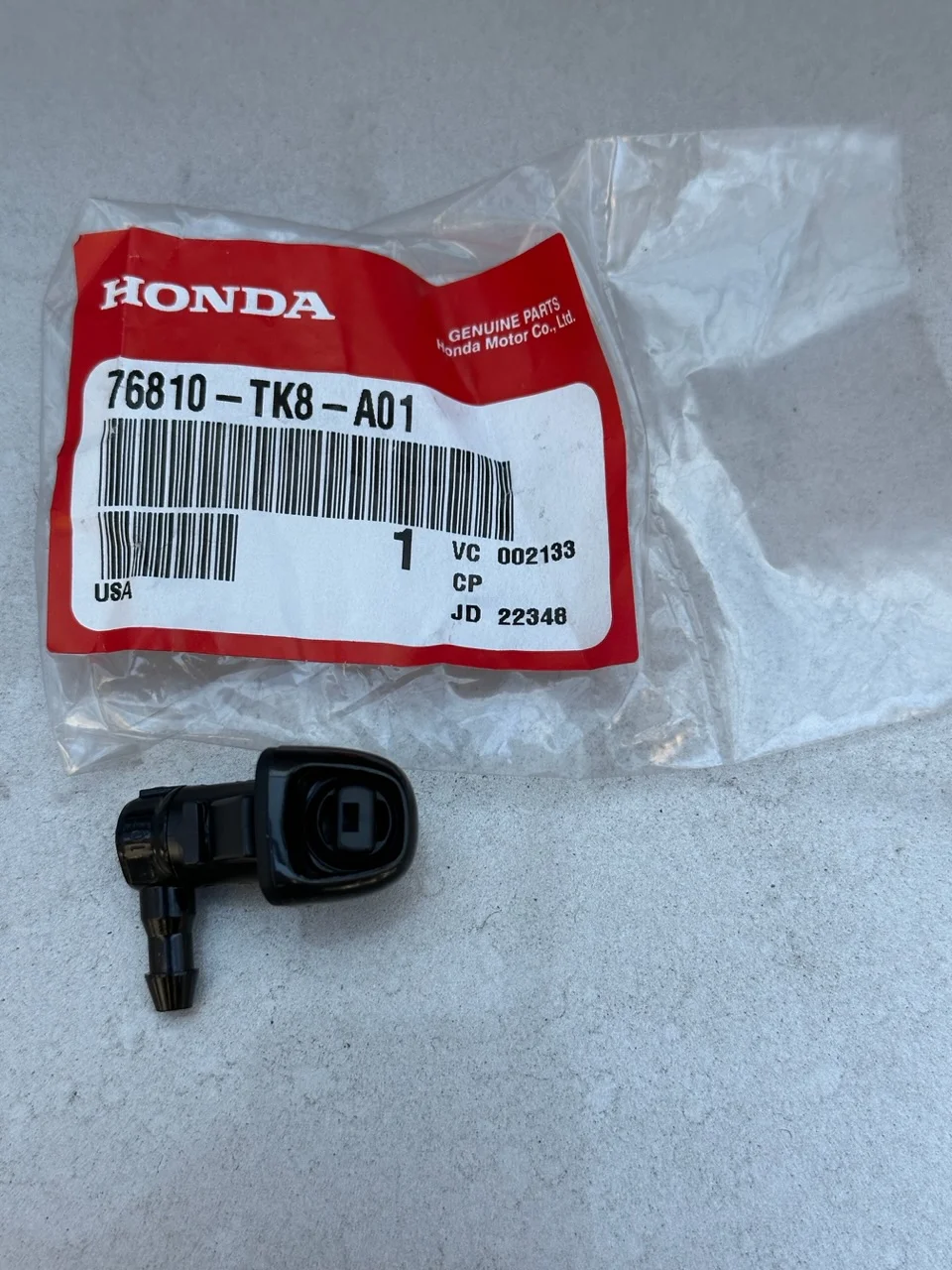

Question - I bought the Honda nozzles, put them on, but I get just a little trickle out of them. Tried blowing with my mouth and can’t get air to go. Is it possible they need much more pressure than the OEM pump is providing?
Hmm, it’s possible your pump is just tired. I just hooked mine up and they work great.
Hmm. Super odd. It’s brand new though - that was one of the myriad parts I replaced. I wonder if there are multiple versions of the pump, like a weaker and a stronger one?
Any chance you could try blowing through the nozzles see if you can do it with your mouth? I’m just curious if mine are both somehow defective.
I like the three nozzle versions out of a scion. 8538142070
Is it three nozzle or mist? I can try this next I guess since the Honda ones are probably just fine and my pump is probably weird.
Check your diverter valve (drivers side near the brake booster). Mine was swollen and coming apart. When I activated the nozzles, I had dribbling coming out. I couldn't figure out what was wrong and was about to replace the pump when I saw leaking from the diverter valve.
